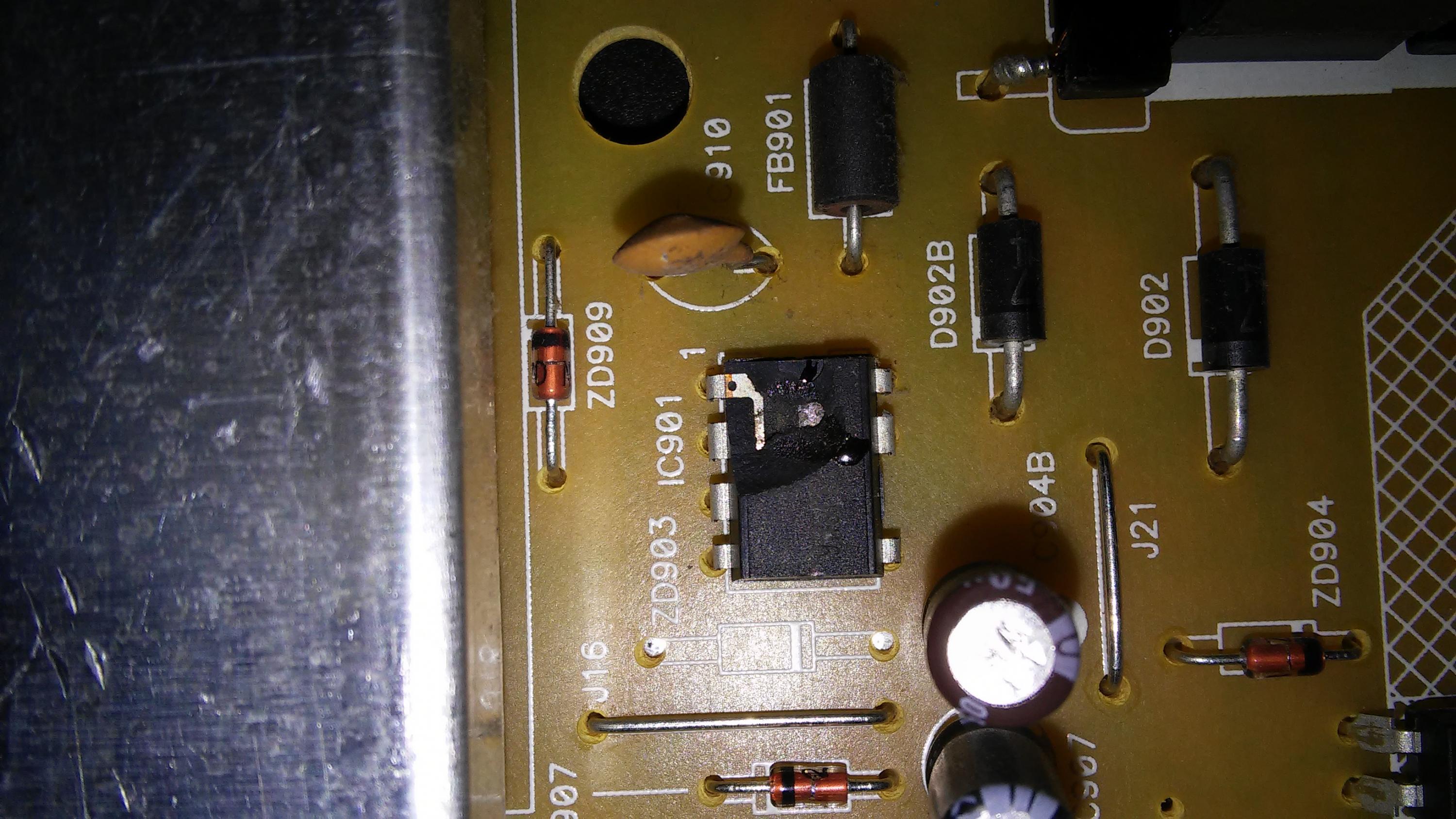

    Vizeo E550-B2E wont power on. When I looked at the power board I found part ic901 had the corner chipped off ? Cant read the actual # on the part cause of the chip missing. Does anyone know what part this is ? Could it cause the tv to not power on ?

    Which one is your board?
    http://www.shopjimmy.com/catalogsear...t/?q=E550i-b2e
    It looks like there are still some printing left on that SMPS IC for standby power supply.

      Thanks for reply, yhis is my board
      Vizio 056.04167.1071 Power Supply Board E550I-B2 E550I-B2E
      So could this likely be my problem , & if so is it easiest just to replace the board ?

        Yes that is a major problem and need to be replaced once identified. However there may well be another problem that caused the IC to blow up.
