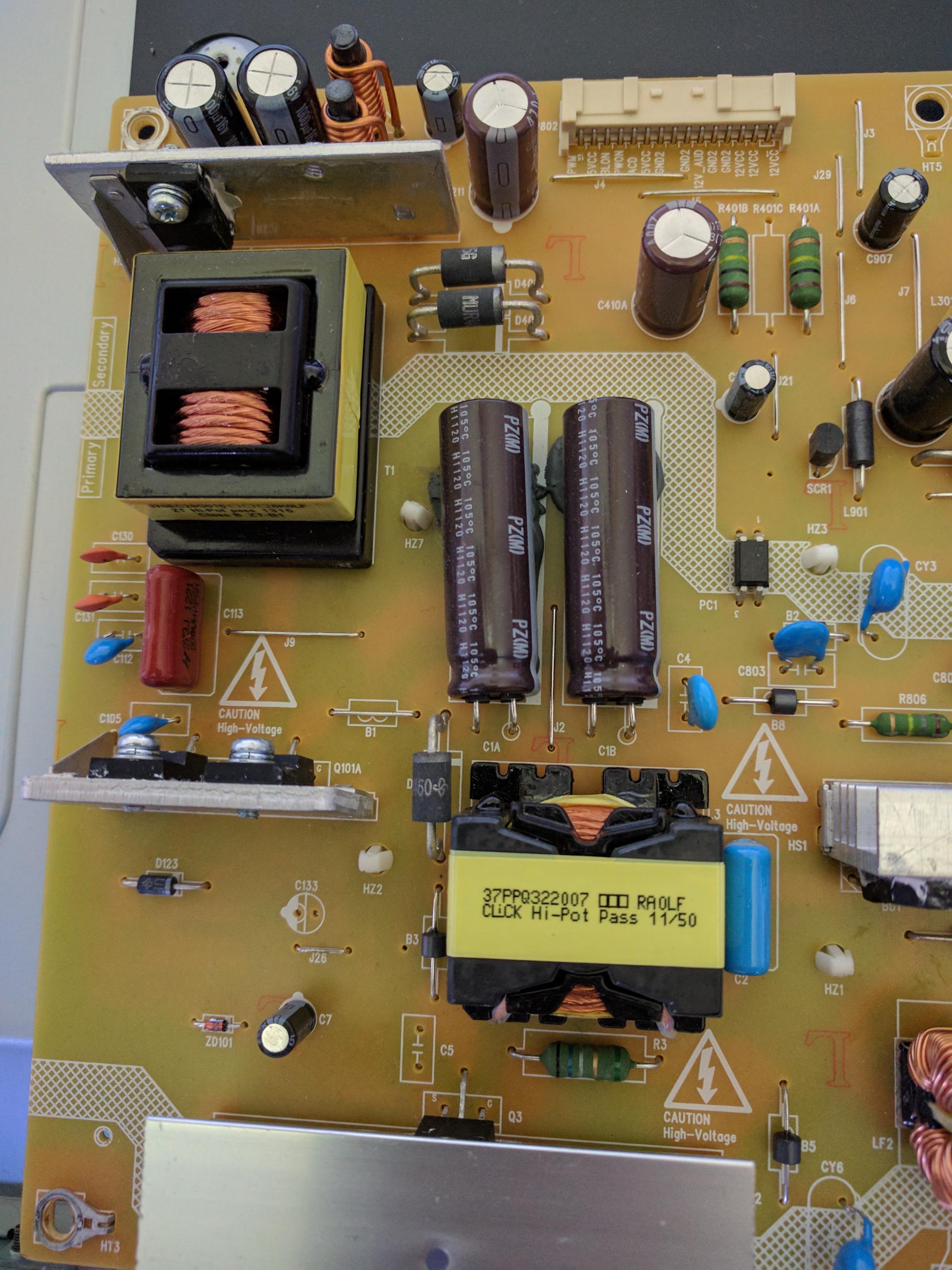

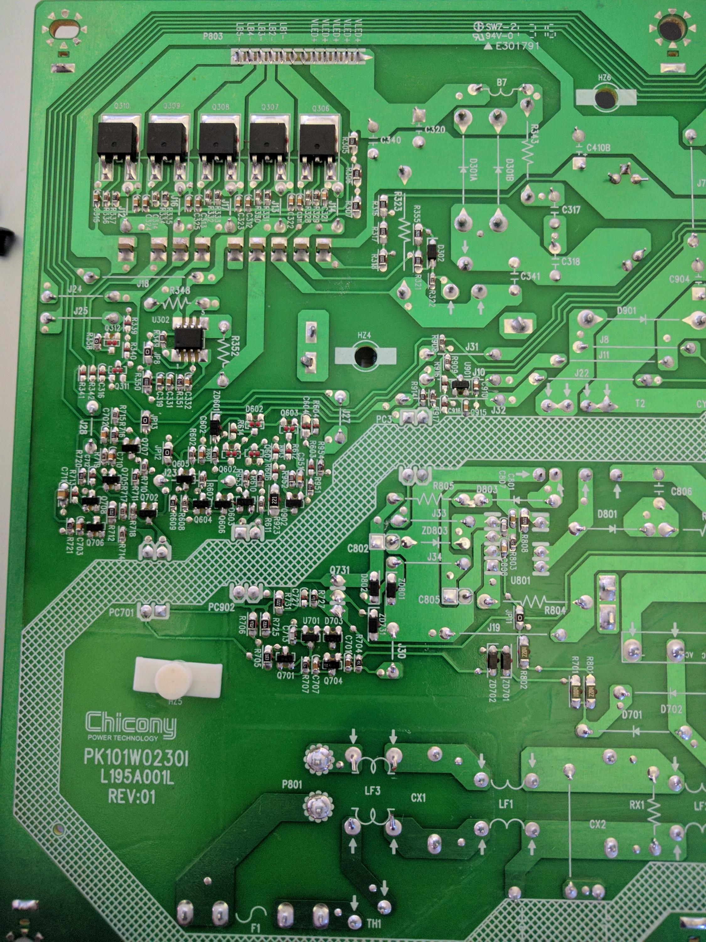

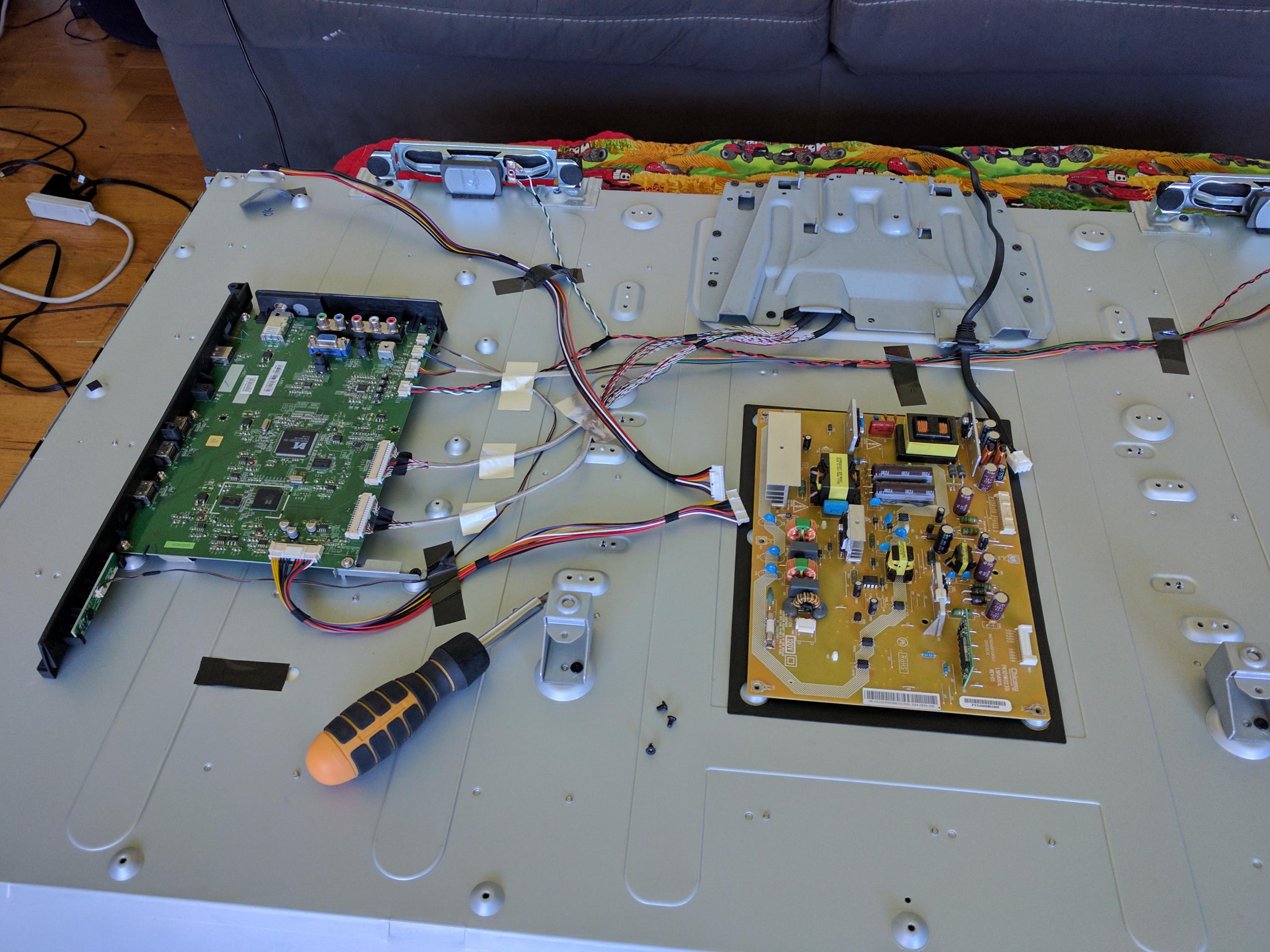

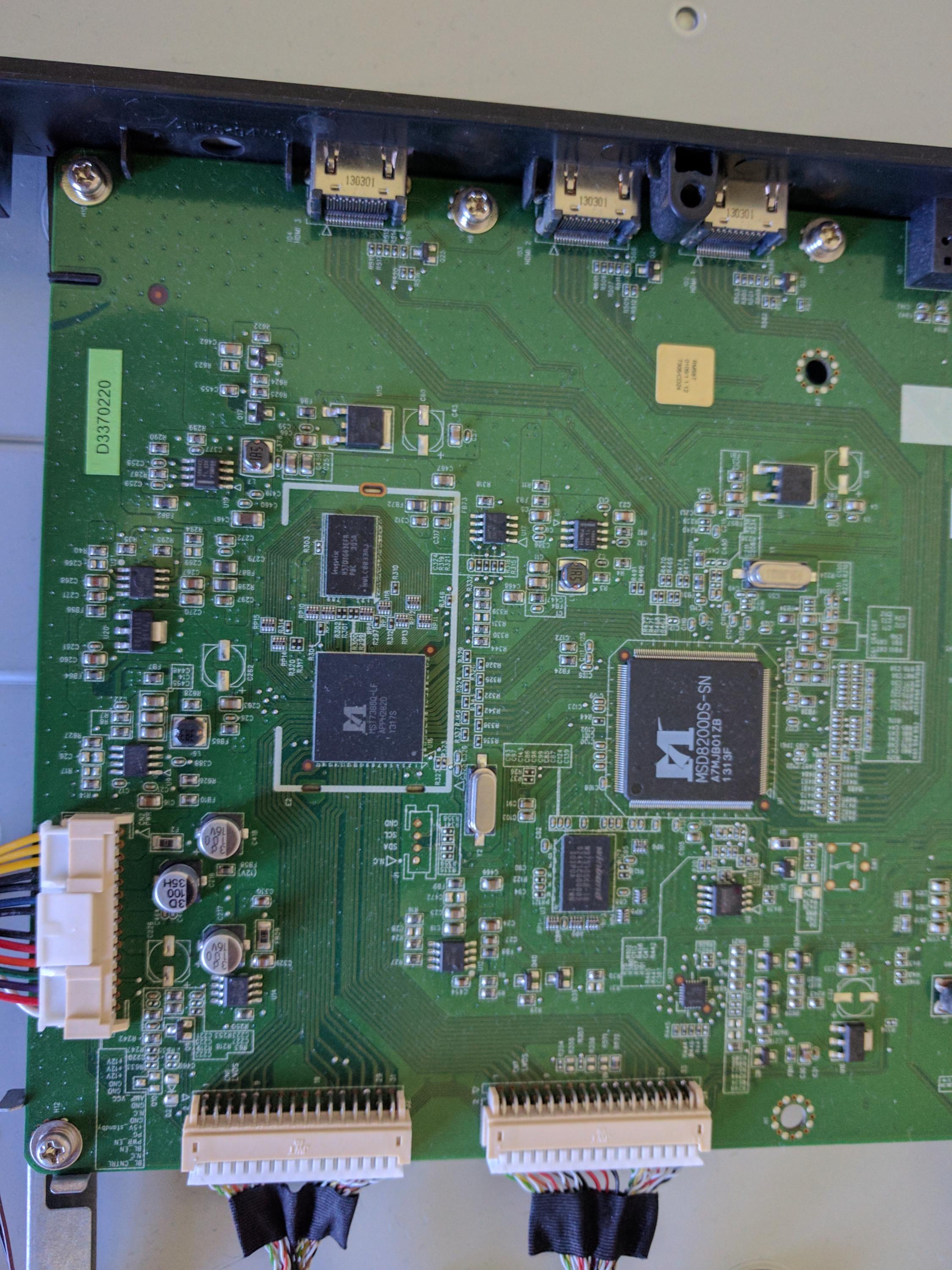

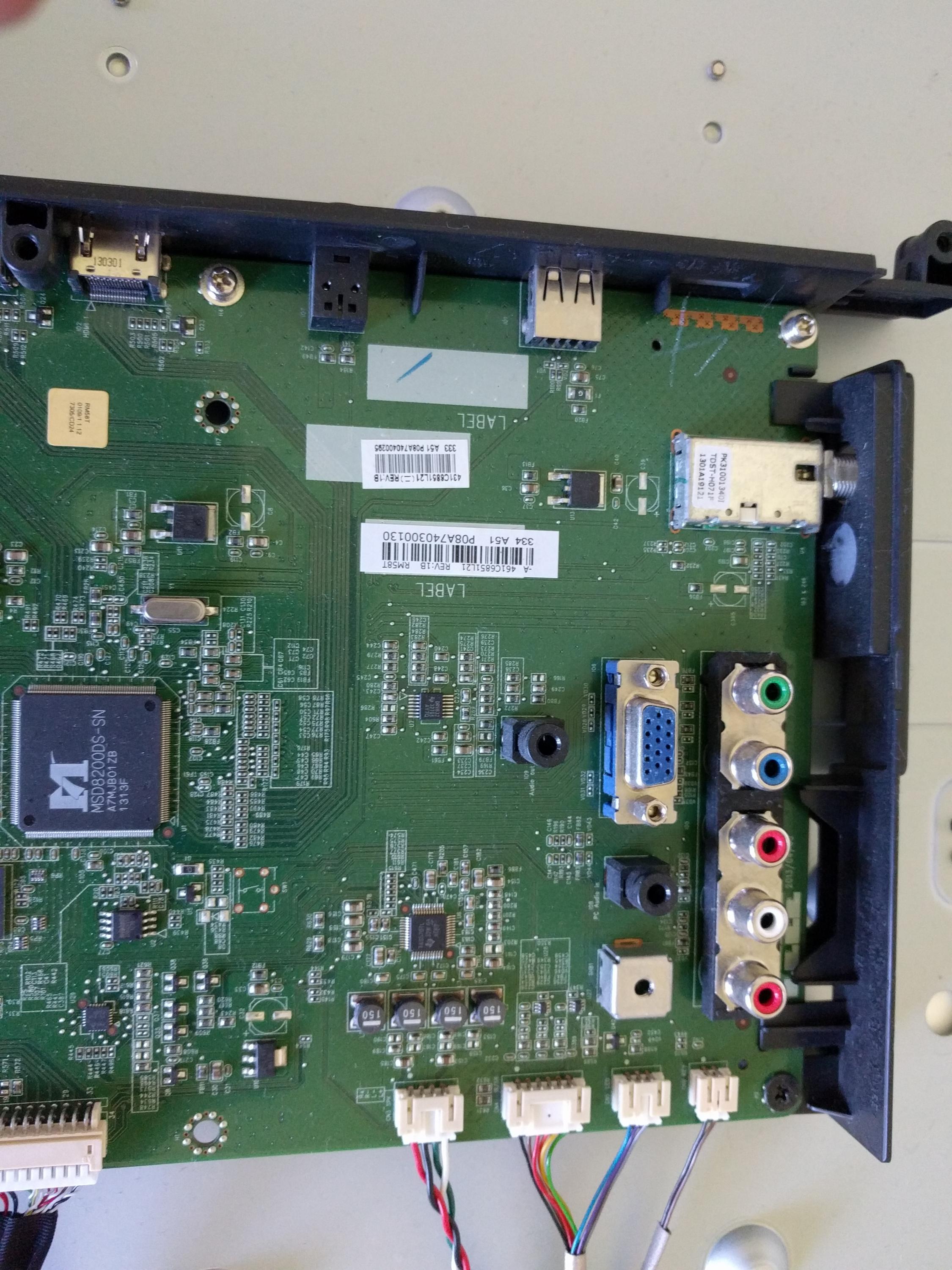

          Need good clear straight on pictures of back of tv with cover off and each board.

              Some good photo's of your power supply board would be useful.

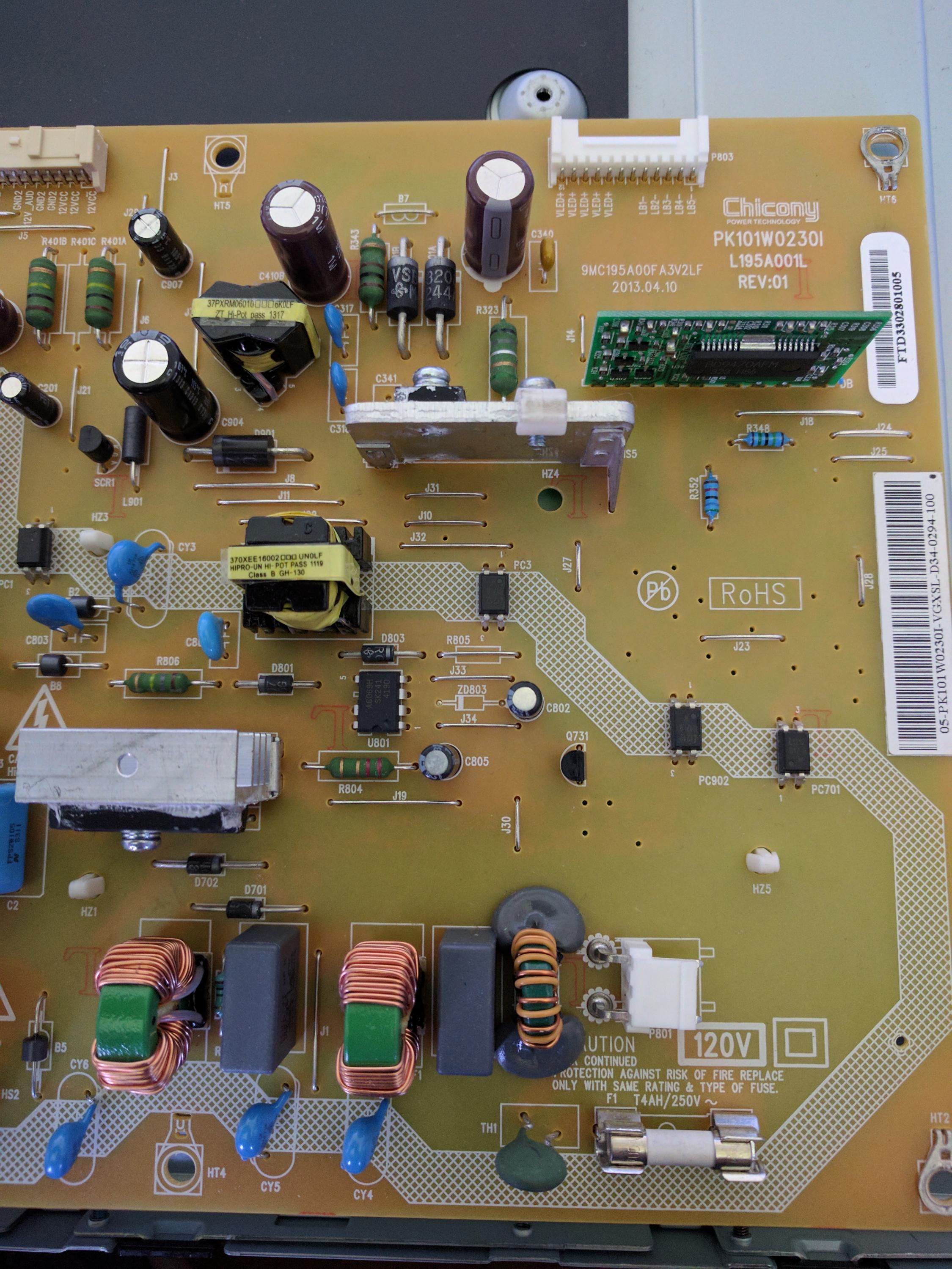

                  Re: 58l1350uc no power/lights
                  Let me know if these are good enough

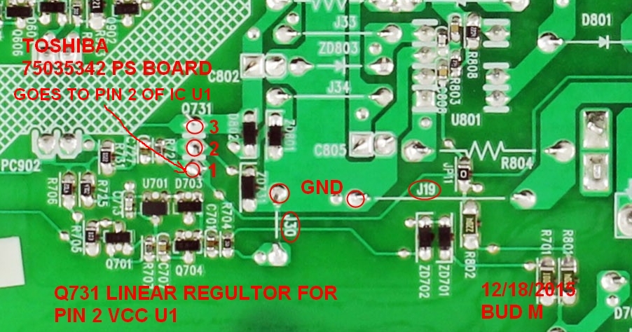

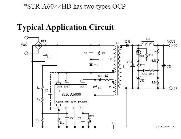

                      another thing to note is when i take Vdc readings across pins 1/2/3 from this pic here from previous thread on my board i get voltage readings of 0/0/16.5 but that is with power board only plugged into wall and no other boards, dont know if that matters or not...pic is from previous thread

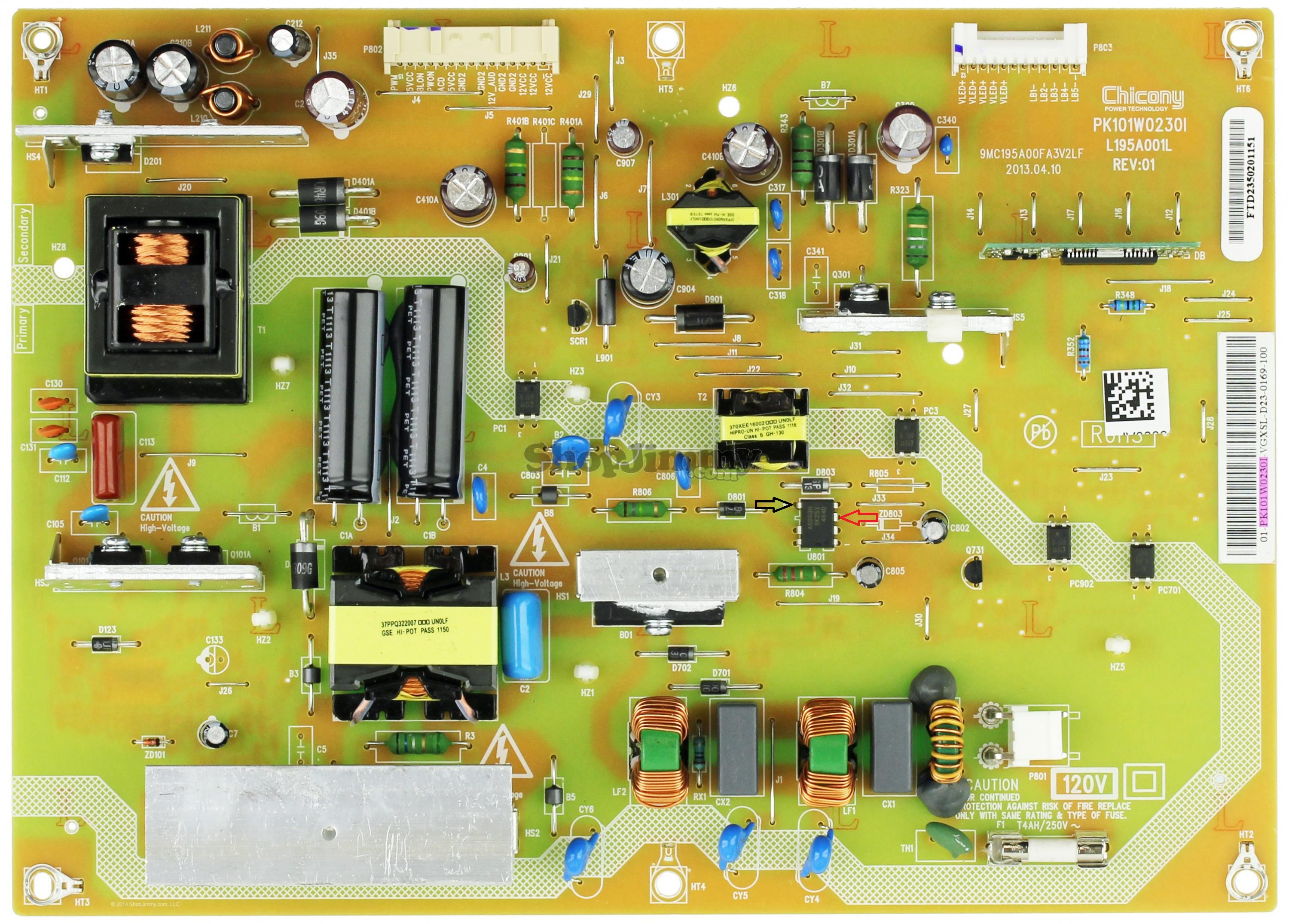

                        • dick_barton
                          • Aug 2015
                          • 6643
                          • Wales
                          Ooops sorry but I got the probe connections the wrong way round in the photo so just need to reverse the voltage reading to +15.8V
                          The STR-A6069H has a maximum operating voltage of 16.8V so the voltage seems to be correct as per post #10
                          It looks as though the PFC circuit is working (360V) but it's not bringing the supply voltage across those capacitors C1A/C1B fully up to 390V.
                          With the set powered off and unplugged from the wall socket I would check the resistance of R801, R802, R803, R808 & R701 and ensure they match what their supposed value.
                                    My thoughts here are that when reading other threads where the PFC voltage was not quite up to what it should be, it often came down to the fact that one or more of the resistors in the resistor chain was out of tolerance. Replacing them brought the supply back to it's normal working value.
                                    In the attached photo it would be the resistor chain feeding the BR pin of the IC
