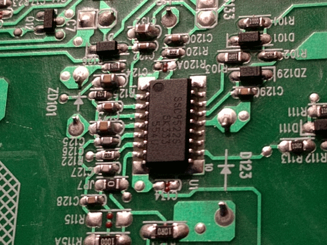

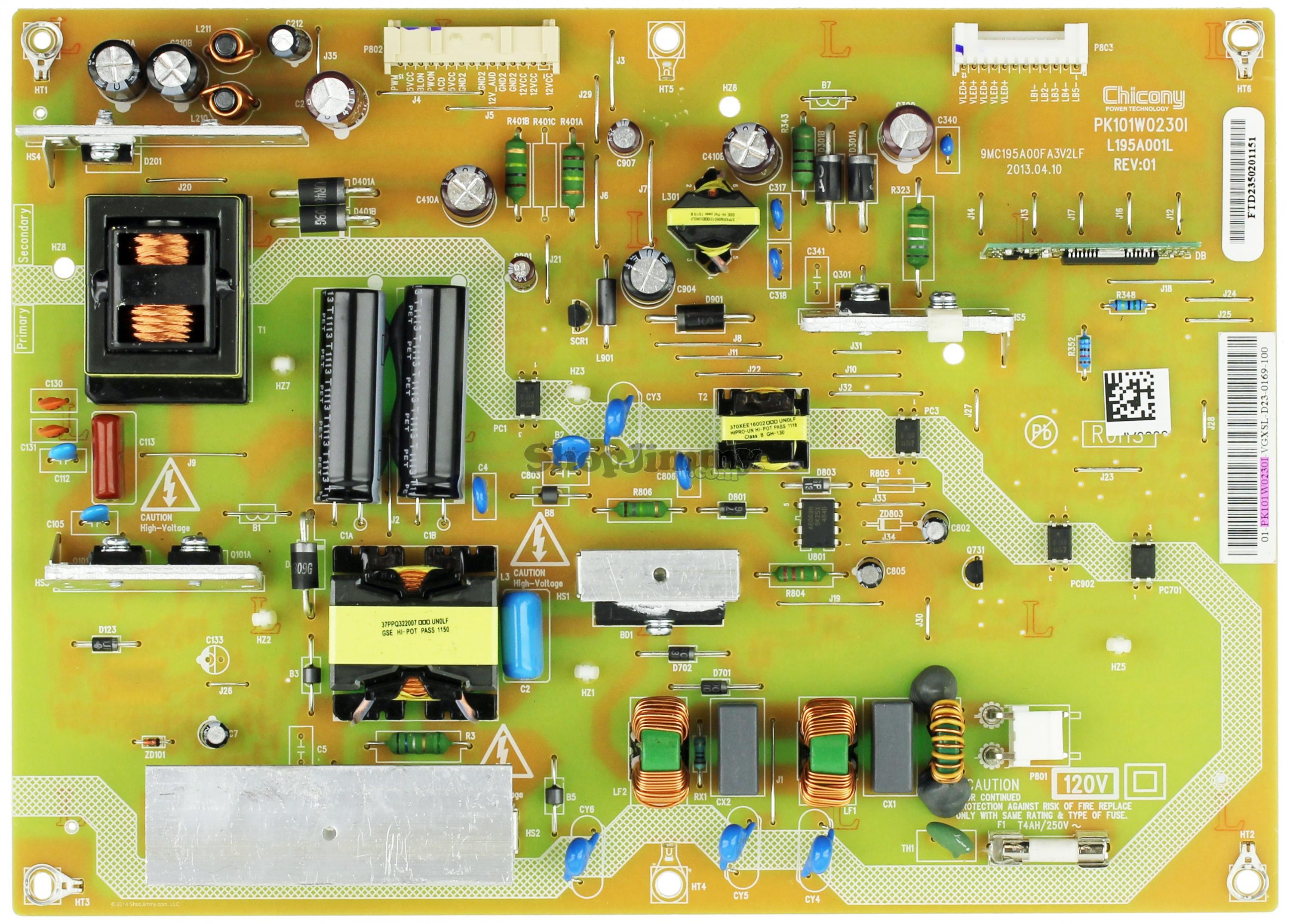

    Looking at the link you provided in the first post, BudM suggests in that post that if you have PW_On and 5V standby then to check C113. Best if you can remove it and test the capacitance is correct.
    He also suggests to start troubleshooting around U1 (SSC9522S) by checking the voltage between Pin 4 (GND) and Pin 14 (VCC) of that IC. Unfortunately without the schematic the problem was never resolved but it would be worth doing the checks just mentioned.
    • tmlfan
      • Jun 2011
      • 109
      Re: 58l1350uc no power/lights
      changed out final resistor to what i assume is 274 stamped on it, swapped with a 270k resistor also pulled c113 out and the capacitance is supposed to be 27n and measured at 26, still nothing, might be easier at this point to admint defeat and either chuck it or buy a new power board, but i have looked and parts for this tv are either hard to find or more than i want to spend to fix it

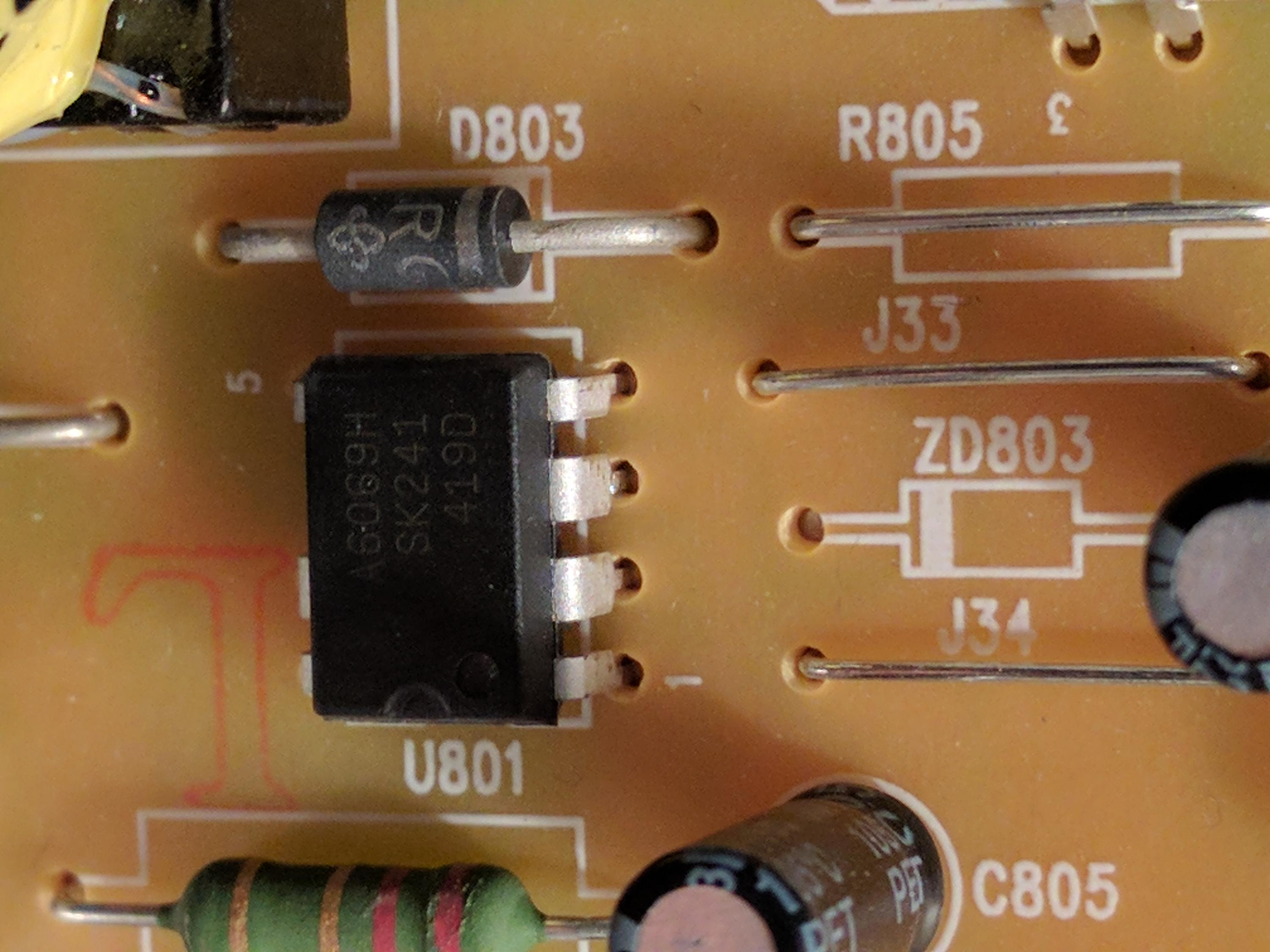

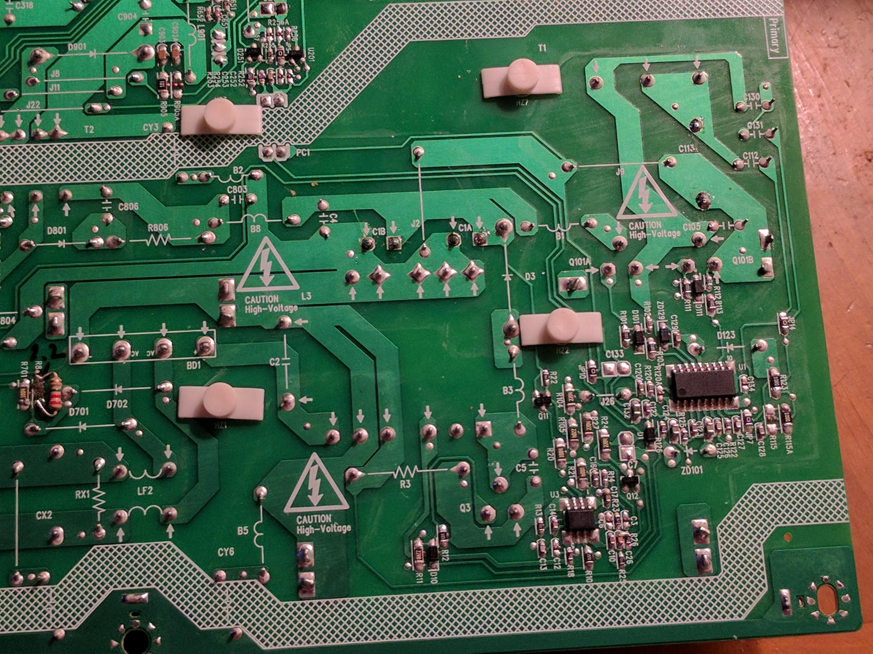

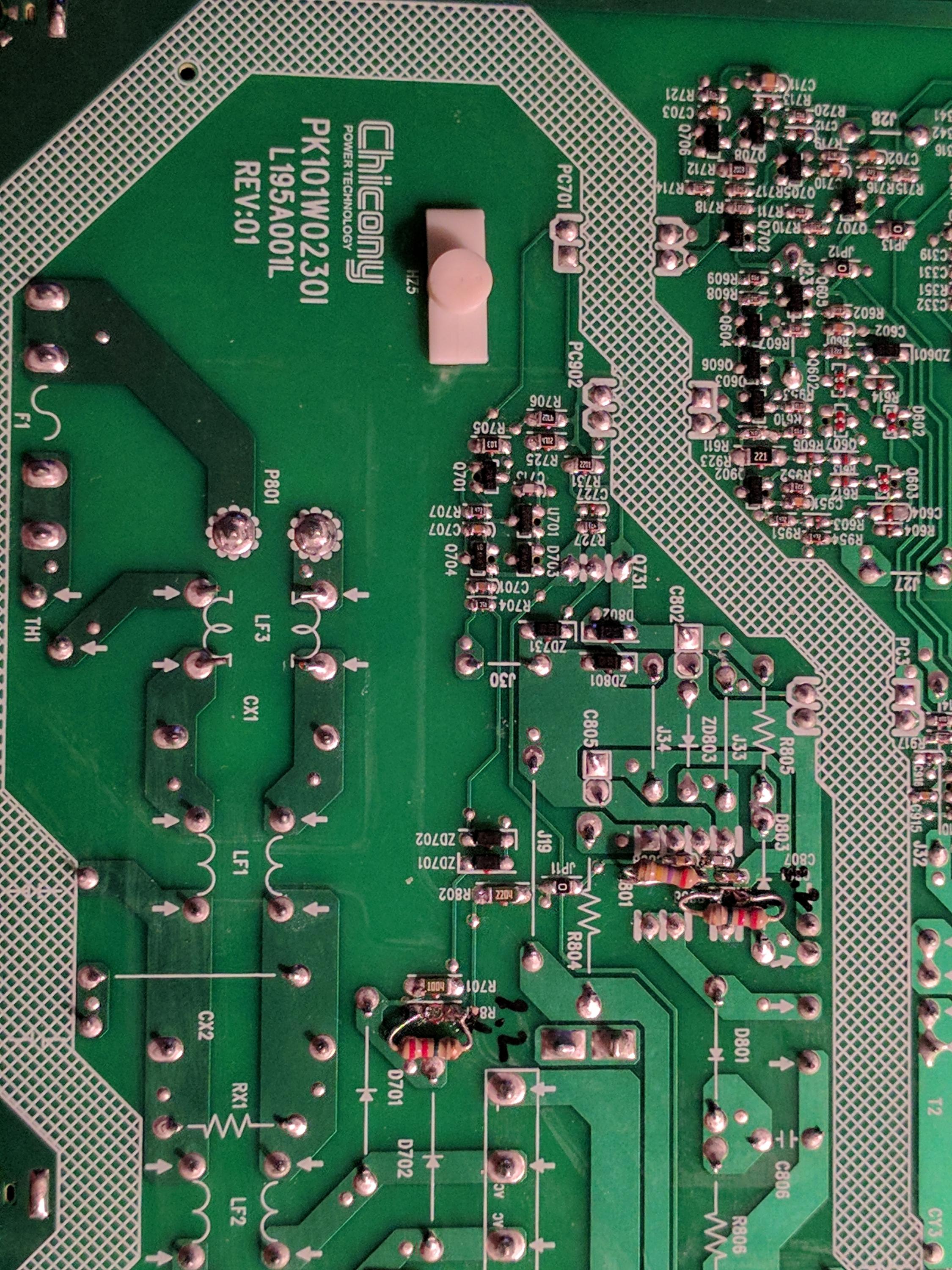

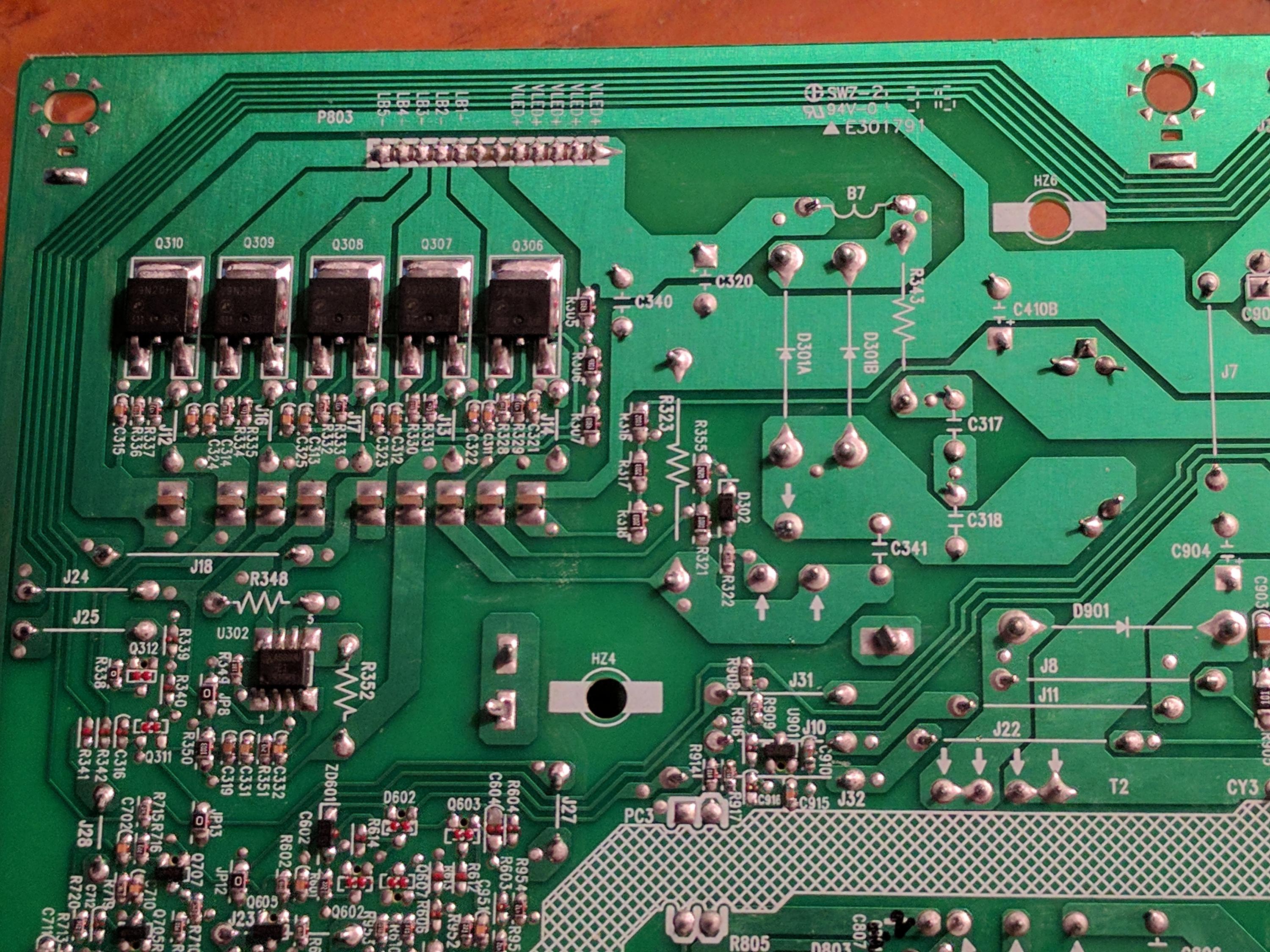

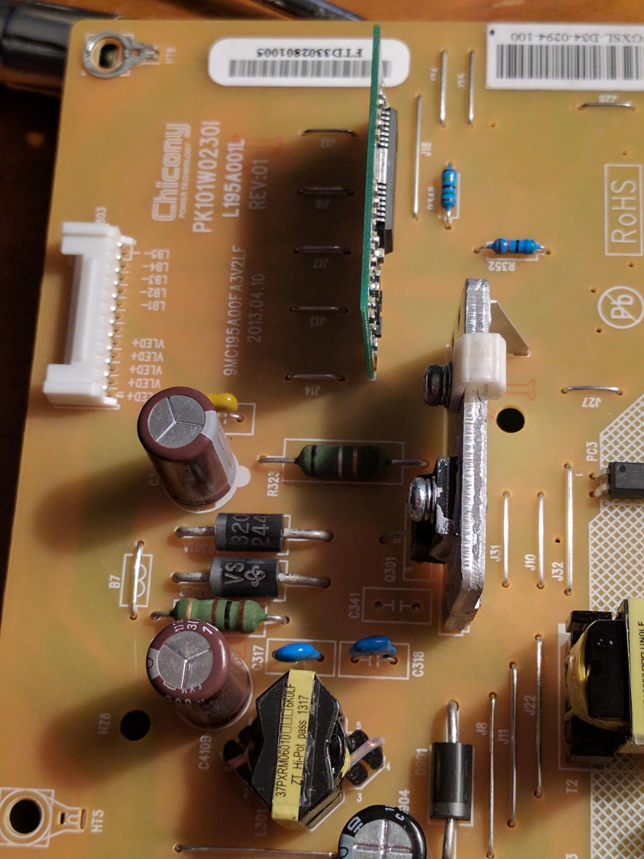

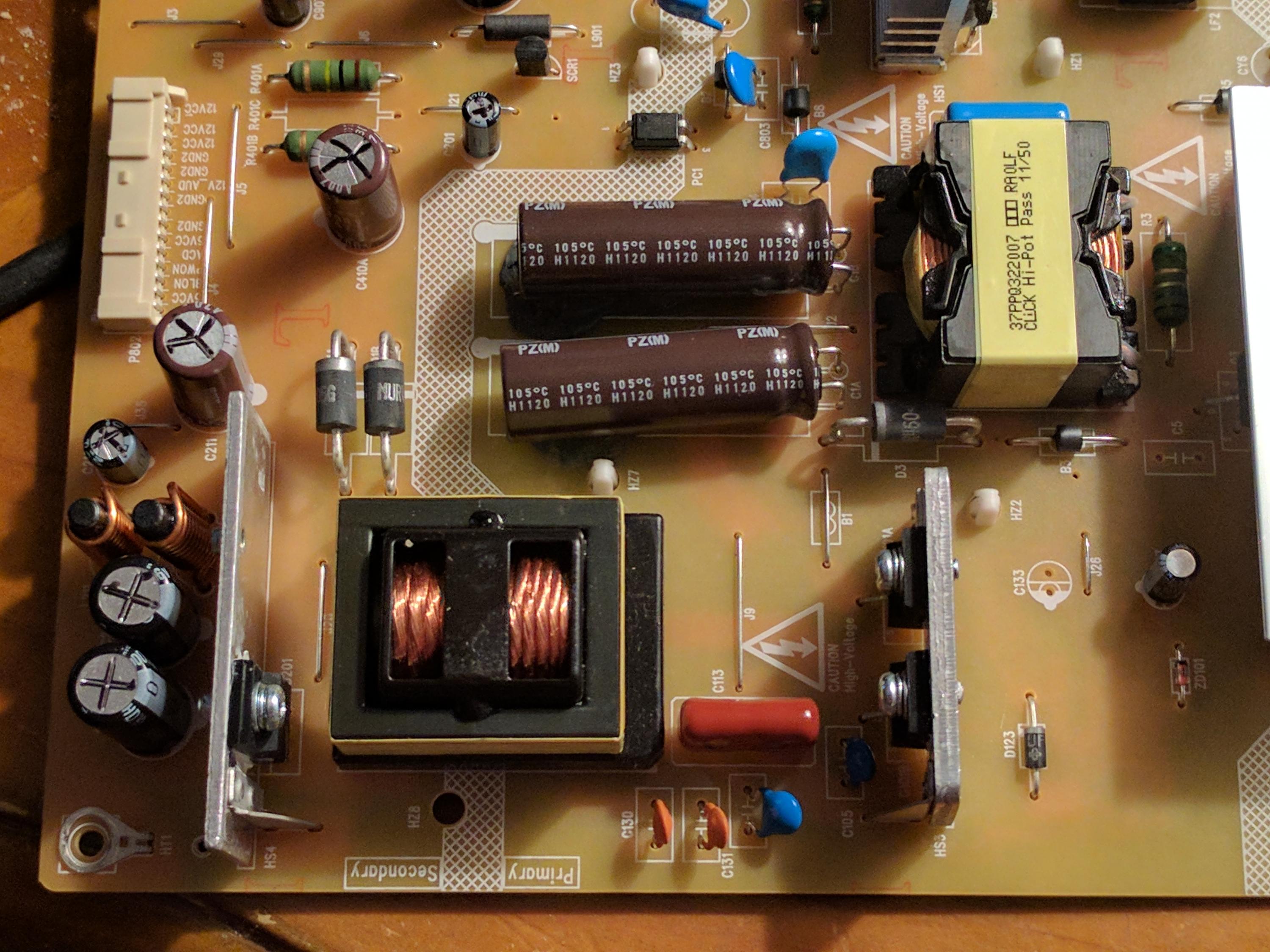

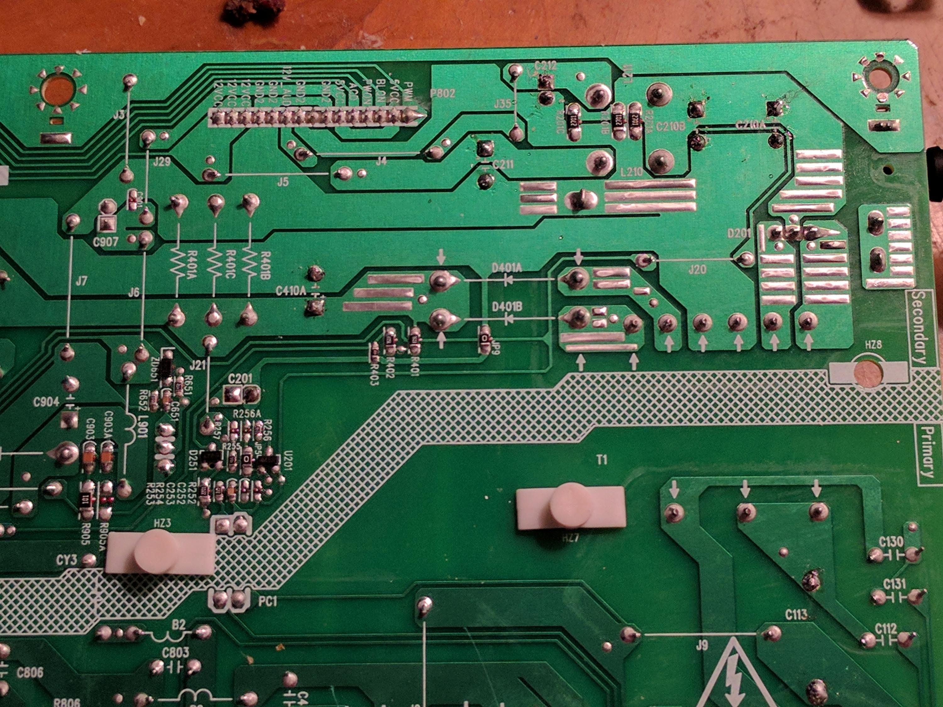

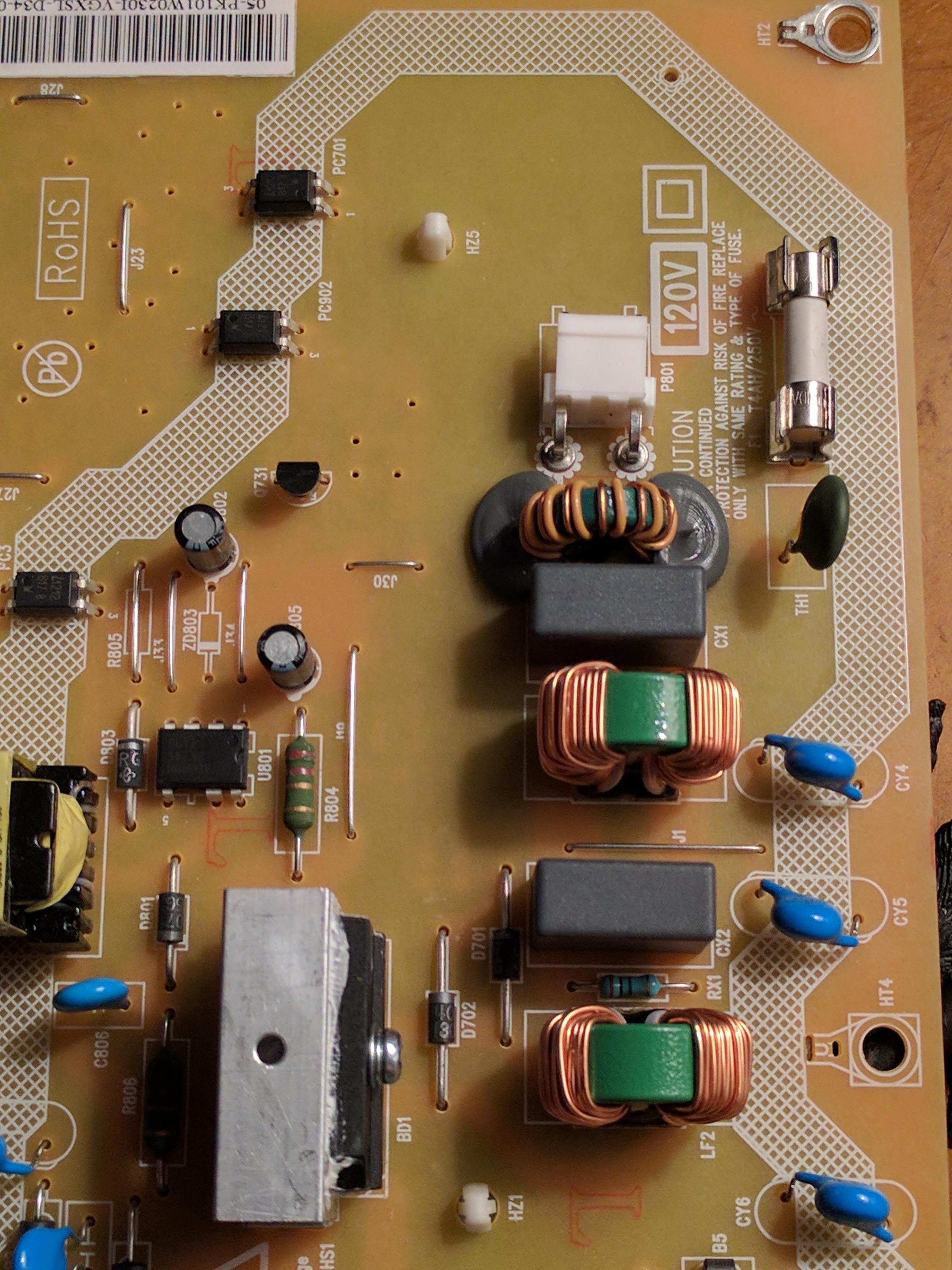

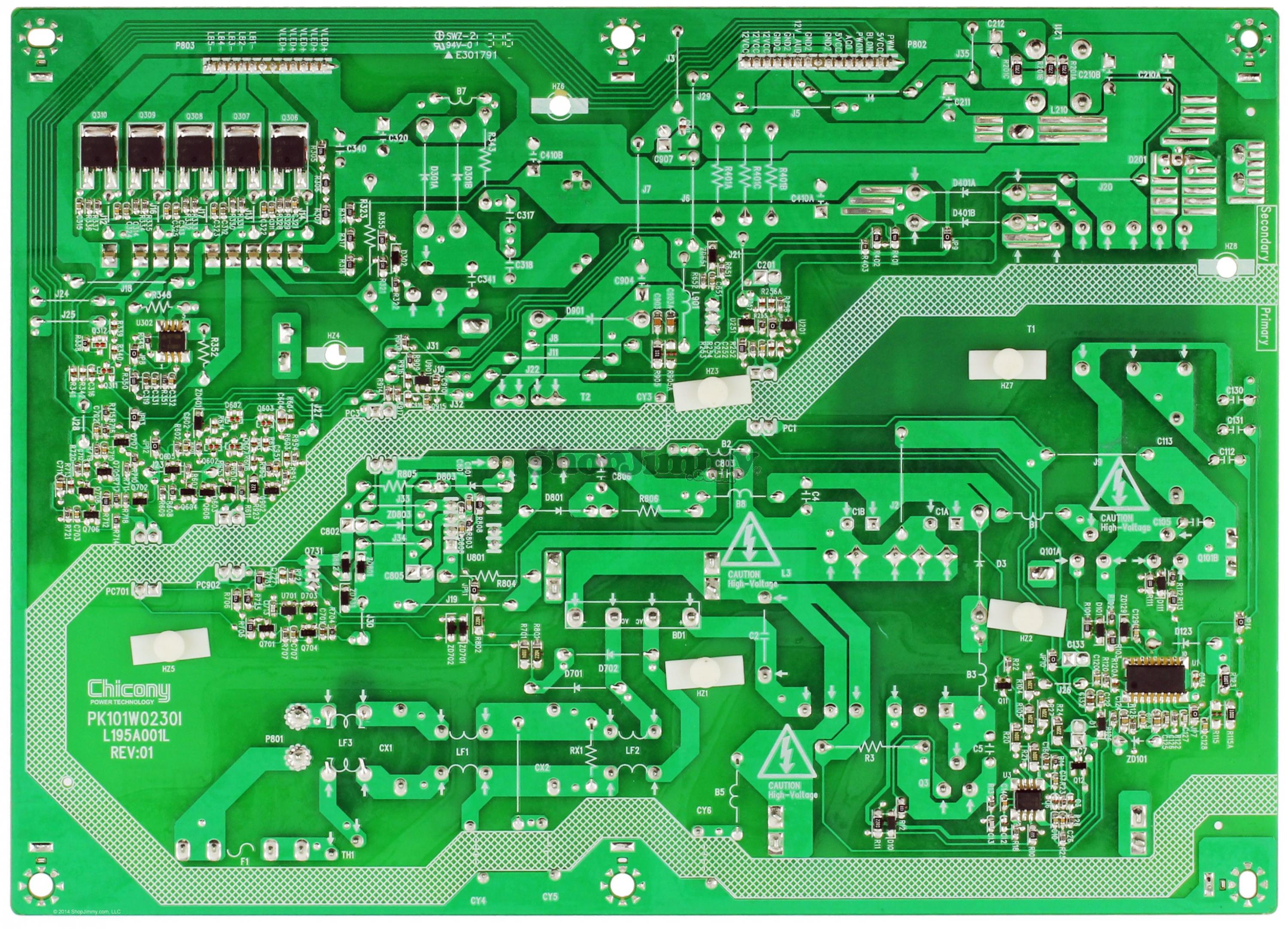

              See my disclaimer. Your pfc is low and I think the ic801 is for your standby voltage not your boosted voltage. Pictures and info is scattered between two posts so confusing for me. If you could post some clear pictures of your power board front and back and ic numbers from back of board would help.
              • tmlfan
                • Jun 2011
                • 109
                How are these ?
                • dskall
                  • Oct 2016
                  • 2905
                  • usa

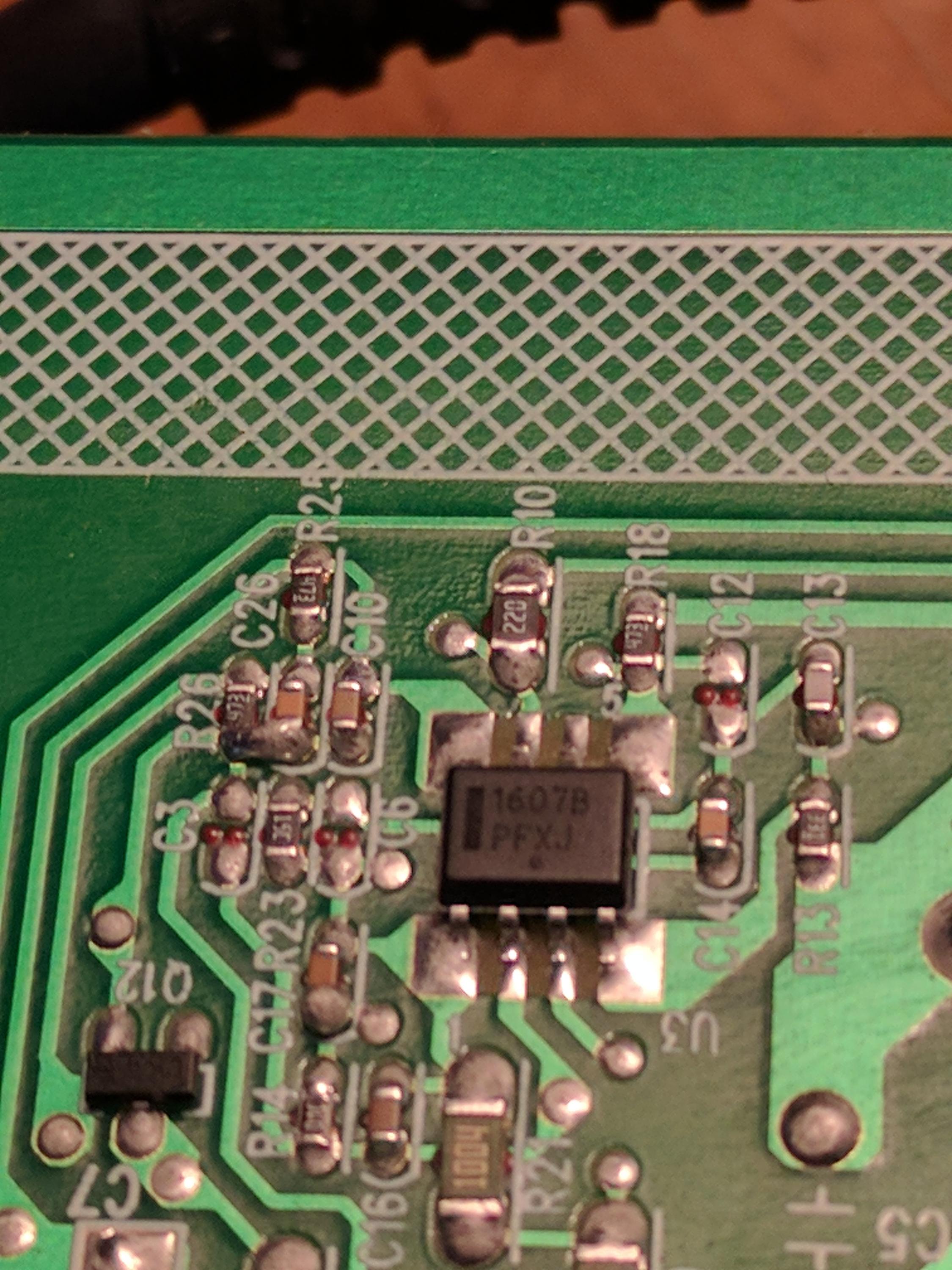

                  What is number on u3?
                  • tmlfan
                    • Jun 2011
                    • 109
                    #29
                    1607b
                    pfxj
                    • dskall
                      • Oct 2016
                      • 2905
                      • usa
                      #30
                      There's a couple resistors on pin 1 of u3 that make a voltage divider to set your pfc voltage you need to check
                      • tmlfan
                        • Jun 2011
                        • 109
                        #31
                        i have been trying to find a pinout for this chip so i can determine what pin is ground so i can use that to figure out what pin is pin 1 because there's no indent on ic to label pin 1 but the funny thing is when i set my meter to test continuity it beeps if there's a connection and when i ground my black probe on the board the red probe doesn't beep on any of the 8 pins on u3
                        • dskall
                          • Oct 2016
                          • 2905
                          • usa
                          #32
                          On picture of your board looks like there is a 1 lower left and 5 upper right printed on board

                            Checked r20 and r21, both 1M resistors and both measure 0.846M ohms
                            • dskall
                              • Oct 2016
                              • 2905
                              • usa
                              #34
                              I would replace them and check you voltage again on main cap
                              • tmlfan
                                • Jun 2011
                                • 109
                                #35
                                169V on both caps and 169V dc across power transistor

                                    That must be in standby because you had 360v before
                                    • tmlfan
                                      • Jun 2011
                                      • 109
                                      #38
                                      yeah i dont know what happened, voltage dropped once i put both of those 1M resistors on pin 1 of u3 (R20/R21)
