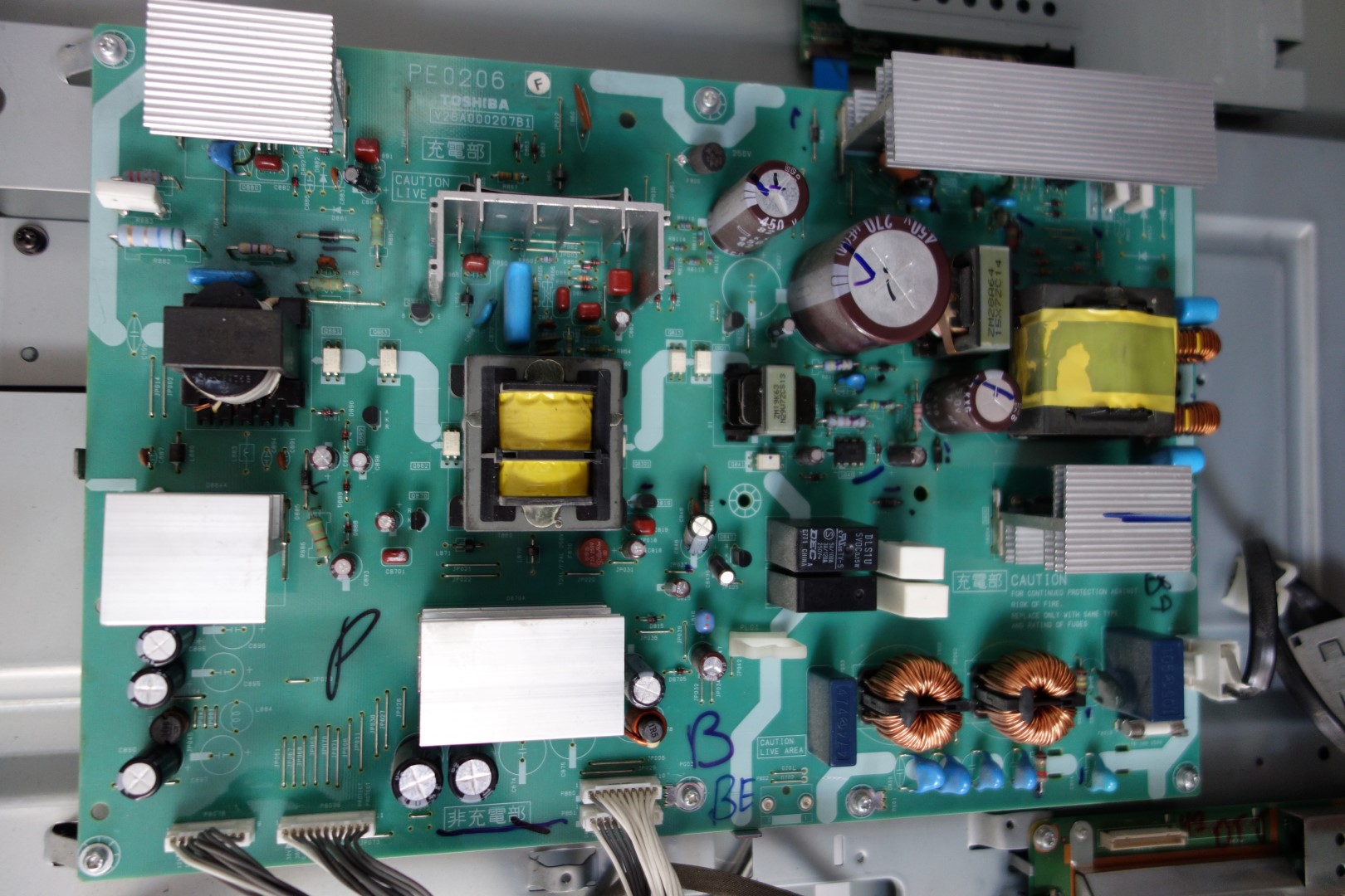

    Inspected PS board - no bulged caps, no burnt components, no cold solder joints, fuses ok
    Master and slave inverters - fuse ok and electrolytic caps ok

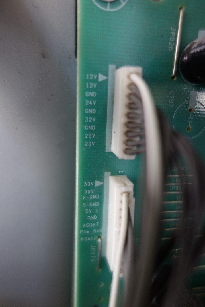

    Power on voltages at PS board connector
    12V: 12.3
    24V: 0
    32V: 31.5
    20V: 0
    24V to backlight inverters: 0
    30V: 0
    5V1: 5.1
    AC_DET: 3.55
    PWR_SIG: 4.91
    POWER: 4.61
    PROTECT: 2.65 ***
    PROTECT: 0

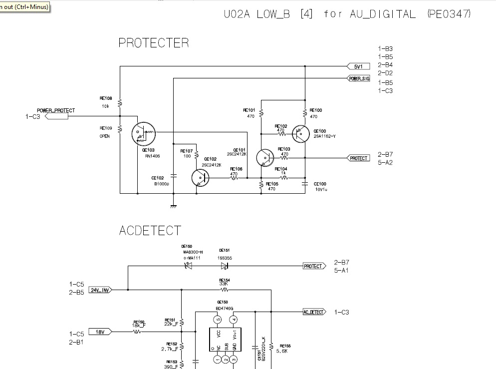

    The PROTECT 2.65V line goes to a pin labelled POW_PRO on the Low B board. I've enclosed the schematic for the protect circuit from the service manual. Again, board doesn't match (PE0348 vs PE0347) but guessing it should be close.

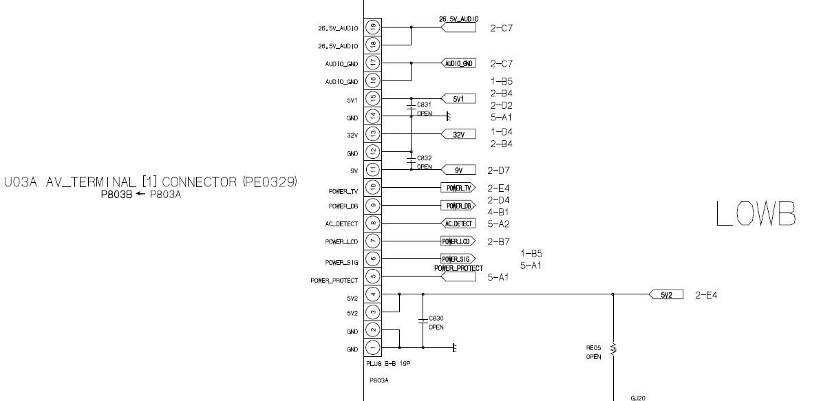

    From the main board to low B
    GND: 0
    5V2: 5.2
    POWER_PRO: 2.6
    POWER_SIG: 4.9 (input to protect circuit)
    POWER_LCD: 3.2
    AC_DET: 3.5
    POWER_DB: 5.0
    POWER_TV: 4.7
    9V: 9.0

    Power_Sig is the same as PS-ON and in your case it is working, if there is PROTEST ERROR (goes high) at 2-B7/5-A2 to turn on the latch Qe100/Qe101 then Qe102 will be on which will take Power_sig (PS-ON) to GDN through that Re107 100 Ohms and that cause the main power supply not to come on, at the same time Qe103 will also be ON so the POWER_PROTECT will also be low. In your case the your POWER_SIGNAL and POWER_PROTECT are high so that means PROTECT ERROR signal is not present and you also show as 0V.

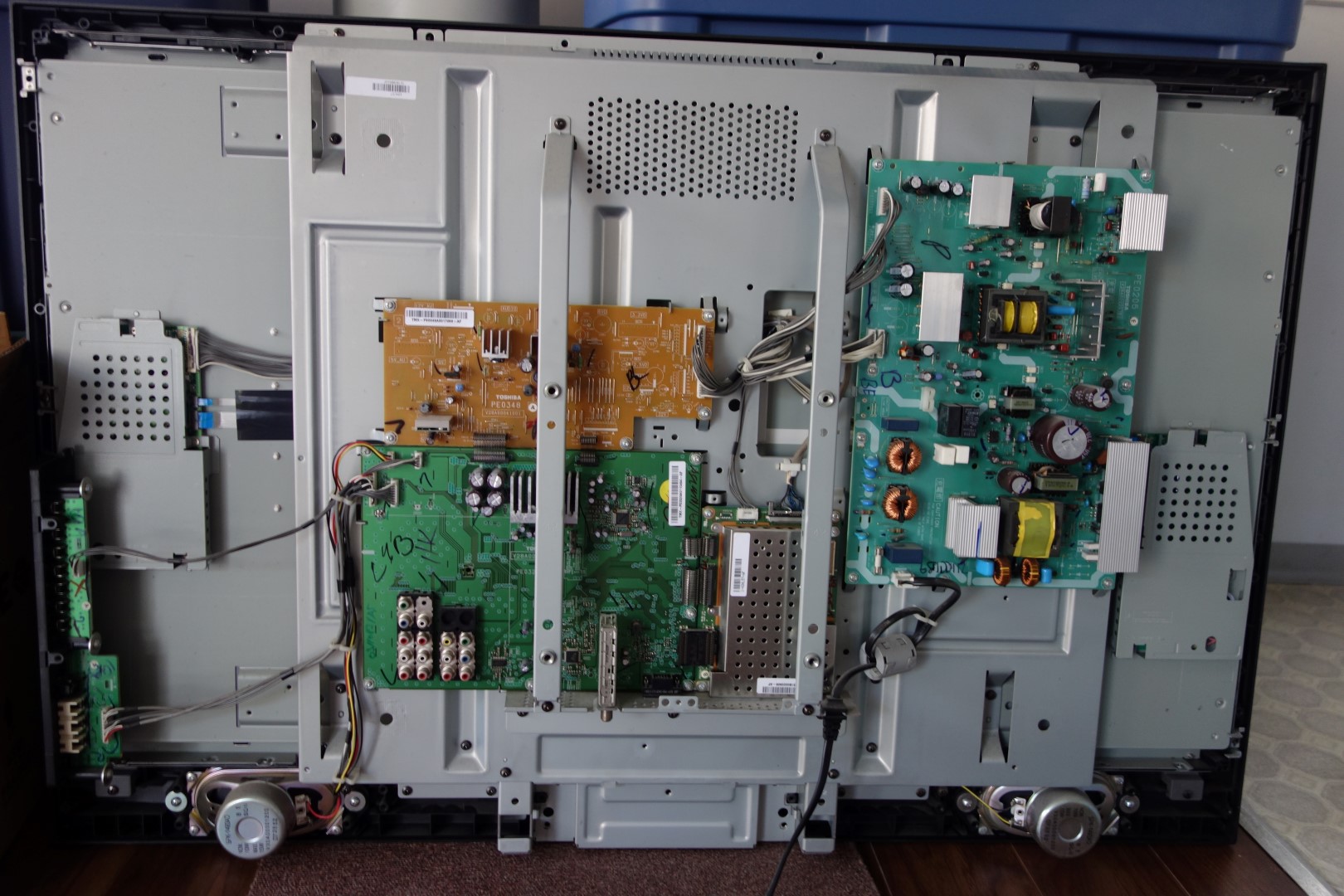

    We need good closed straight shot of the power supply board and the inverter board, and bottom side of the power supply board.

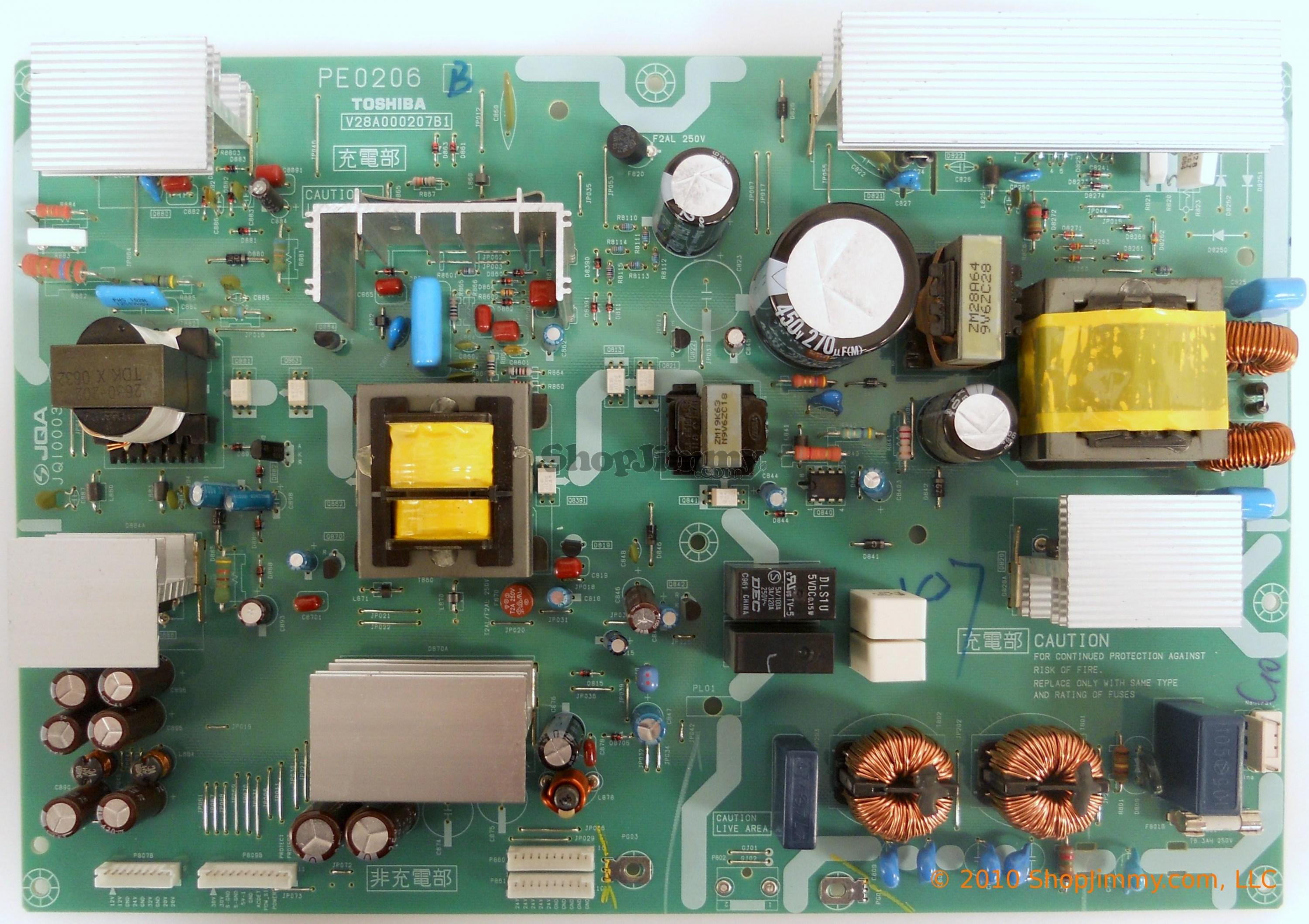

    Is this where you get the service manual?
    http://elektrotanya.com/?q=showresul...oria=&kat2=all
    http://www.shopjimmy.com/toshiba-pe0...wer-supply.htm
    Toshiba PE0206B Power Supply
    Picture provided by shopjimmy.

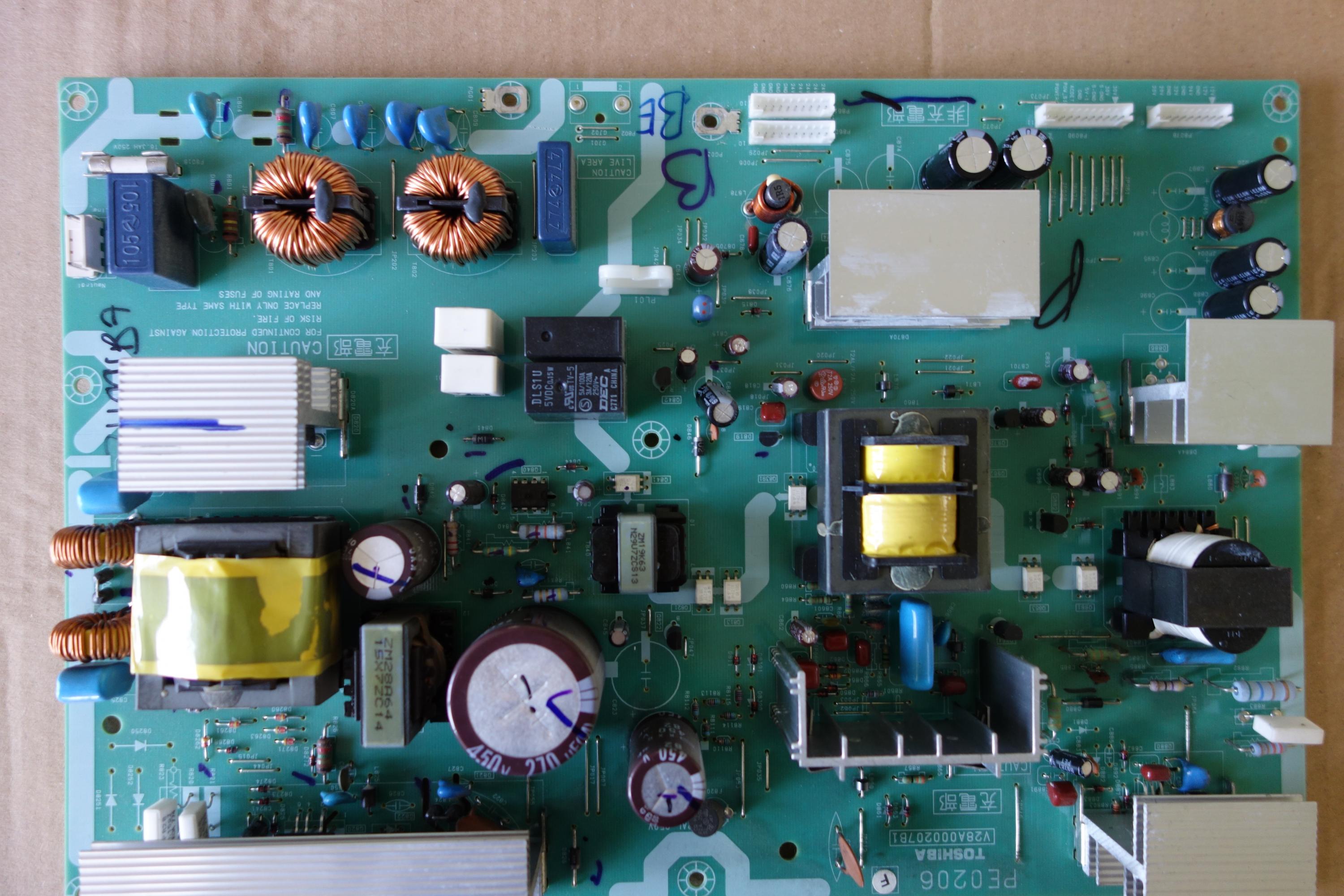

      Re: Toshiba 42HL57 No picture No backlight
      BTW, do you hear the relay on the power supply board come on?
      How about the two white power resistors next to the relay, are they OK?
      Right now we need to find out why you do not have the 24V for the inverter board.
        Looks like one of the elektrotanya links (Toshiba 42HL57 SM - zip) has the correct service manual but the dwf files are barely unreadable. The rest of the links are for the portugese (though it was Spanish) Brazilian model with different boards. The service manual is HTML and all the dwf files have red circles on all the components and red lines spreading out from the upper left corner. Tried an online viewer and a dwf conversion program but they all have this problem. Aargh...
        The power resistors beside the relays measure R830 - 2.0 ohm and R831 4.9 ohm in-circuit. They match the values in the component list which I was able to view digging into the html files.
        R830 76120001 RESISTOR, CERAMIC COVERED, 2.1W 1.8 OHM K
        R831 76120003 RESISTOR, CERAMIC COVERED, 5W 4.7 OHM J
        On pushing the power button, I hear the relay click once and can turn off as well.

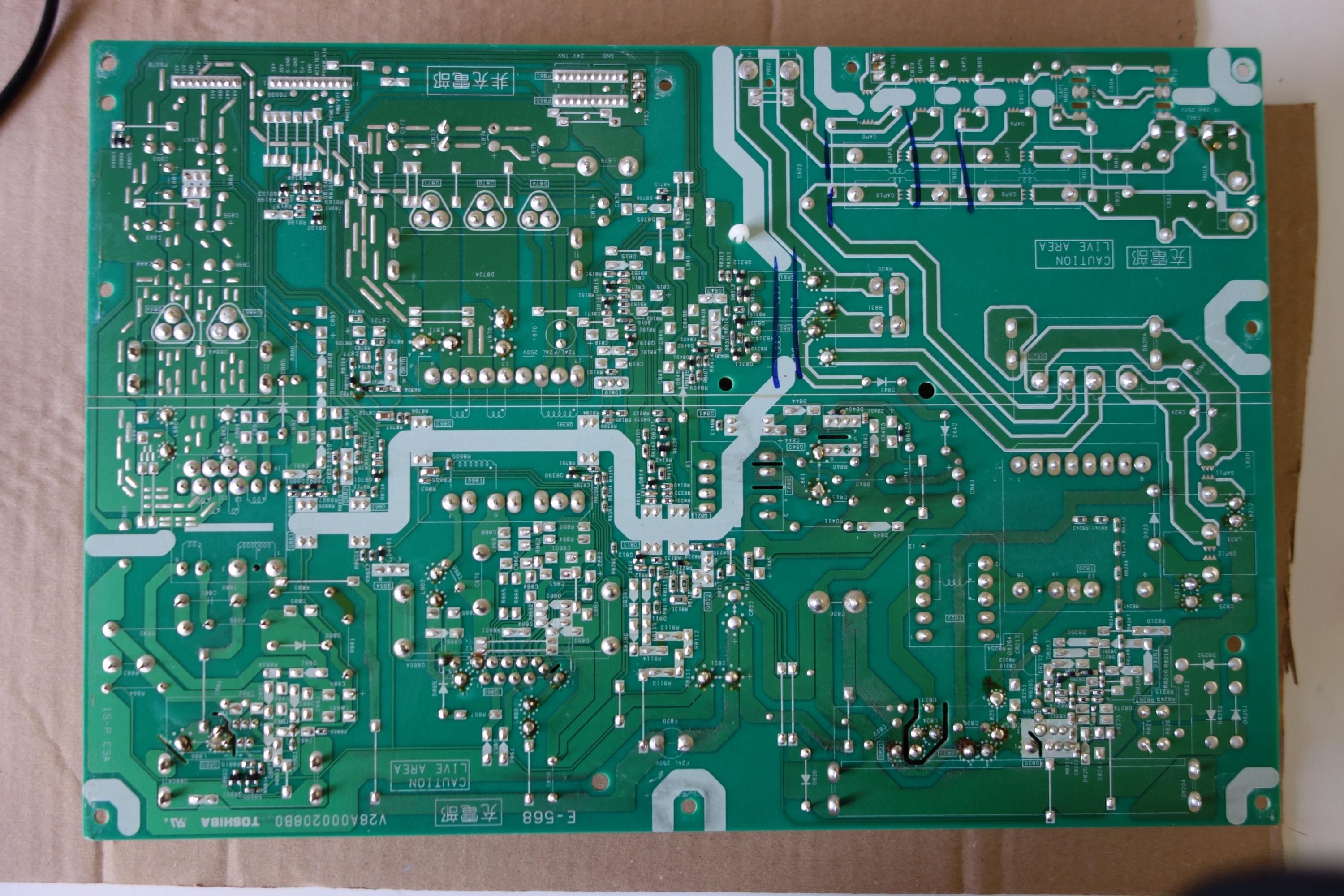

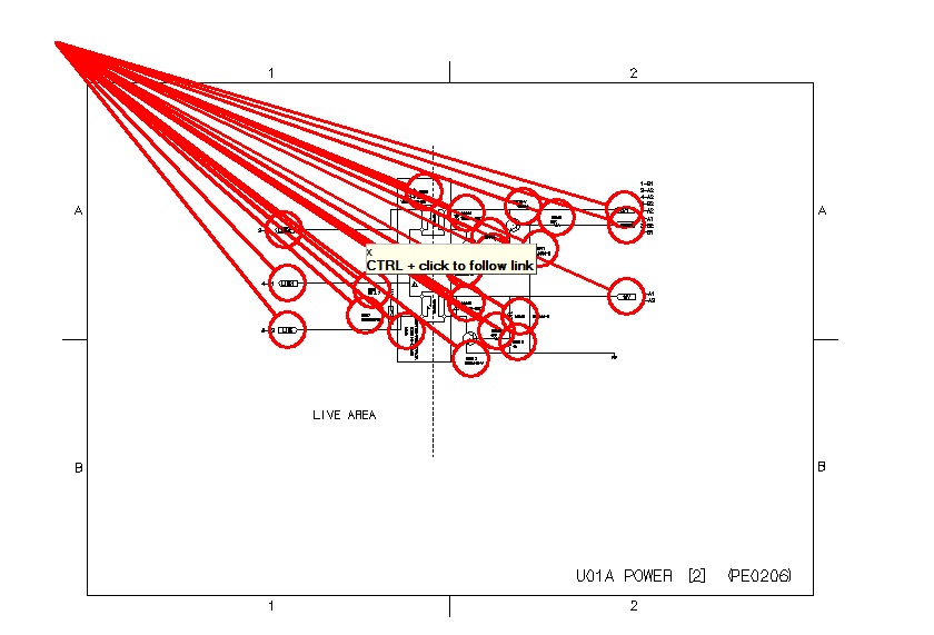

          A was able to make the DWG schematics more readable using a PDF conversion program so that the red lines come out much thinner.
          PFC OUT measures 367V so that is ok.
          STR-W6765 outputs 32V, 12V and 20V but the components for the 20V line are all marked open so it is probably not used. I am getting 32V and 12V.
          STR-Z4579 outputs 30V and 24V which both are reading zero. Likely suspect?
          These regulators are common components in Toshiba power supply repair kits. Guess I'll order a STR-Z4579 from China on ebay and wait a couple of months to get here.
          Edit: Enclosed a PDF conversion of the power supply schematic for PE0206
            PFC seems on the low side. What is voltage printed on main cap?
              The PFC is kind of low.
              STR-Z4579: see if it is getting VCC for it to run.

                  The replacement STR-Z4579 arrived today, I put it in, but still not getting 24V nor 30V out.
                  Can't find a datasheet. Carefully probing, I get the PFC voltage of 370VDC at the input, VCC is 22V and output is 0 which feeds into a transformer. The 24V output of the transformer turns on an optoisolator which connects two pin of the regulator IC.
                  Next steps are probably to pull the output caps and check them in my esr meter.
                  • neilc6
                    • Nov 2015
                    • 1550
                    I checked every diode and resistor and pulled off and tested every capacitor in the regulator circuit and didn't find a bad component.
                    I suspected that the circuit was shutting down into protection mode so I disconnected the 24V connectors for the backlight and checked voltages and found that the 24V for the backlight and 30V were now present. The circuit and regulator are not the fault.

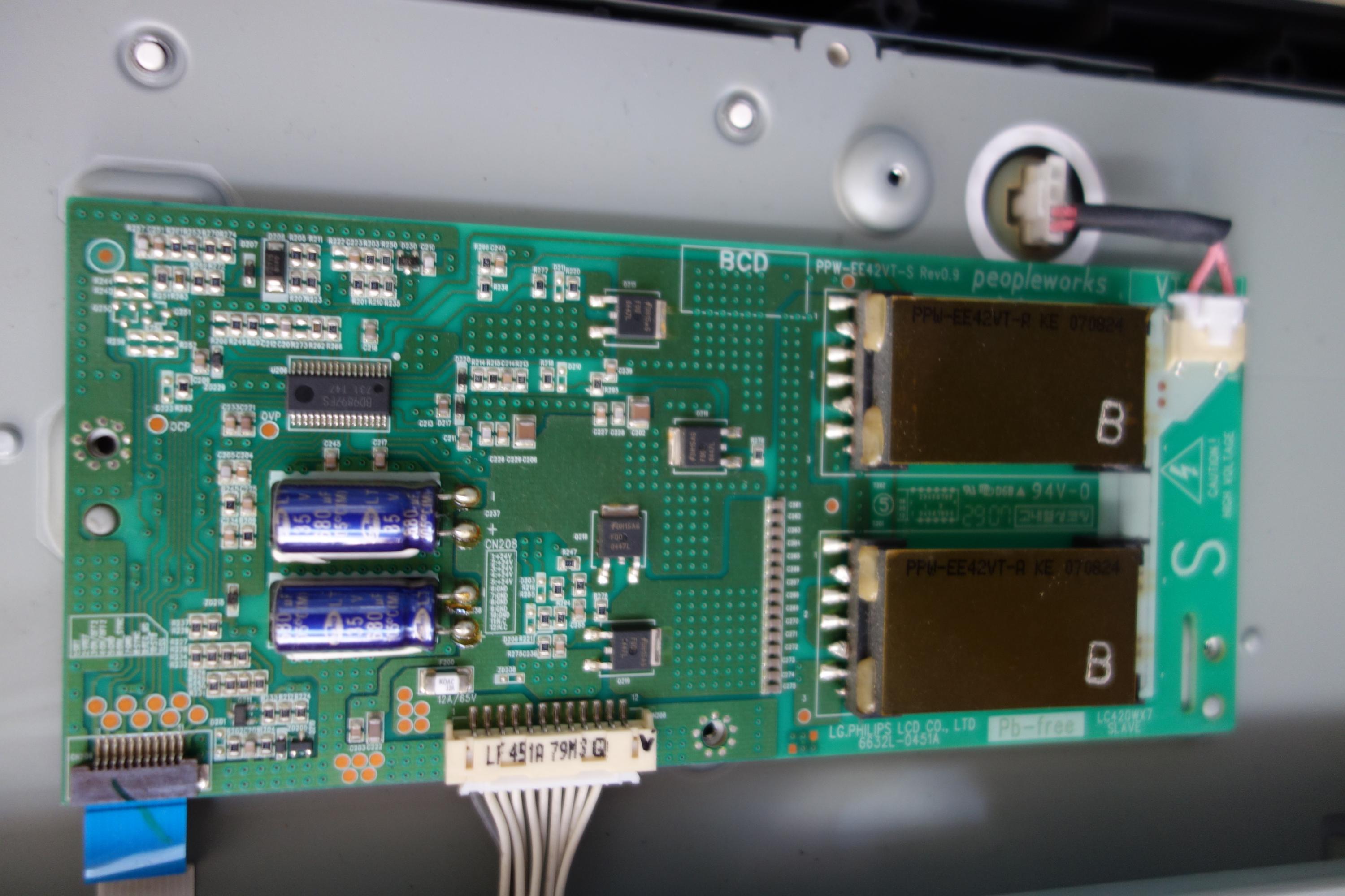

                    Need to further investigate further down the line. Electrolytic caps on the inverter boards look ok.
                    Could burnt out ccfl bulbs cause a shutdown??

                      Sure bad ccfl's can cause shutdown. I am still suspicious of 370v and would check feedback resistors to your pfc controller for low resistance

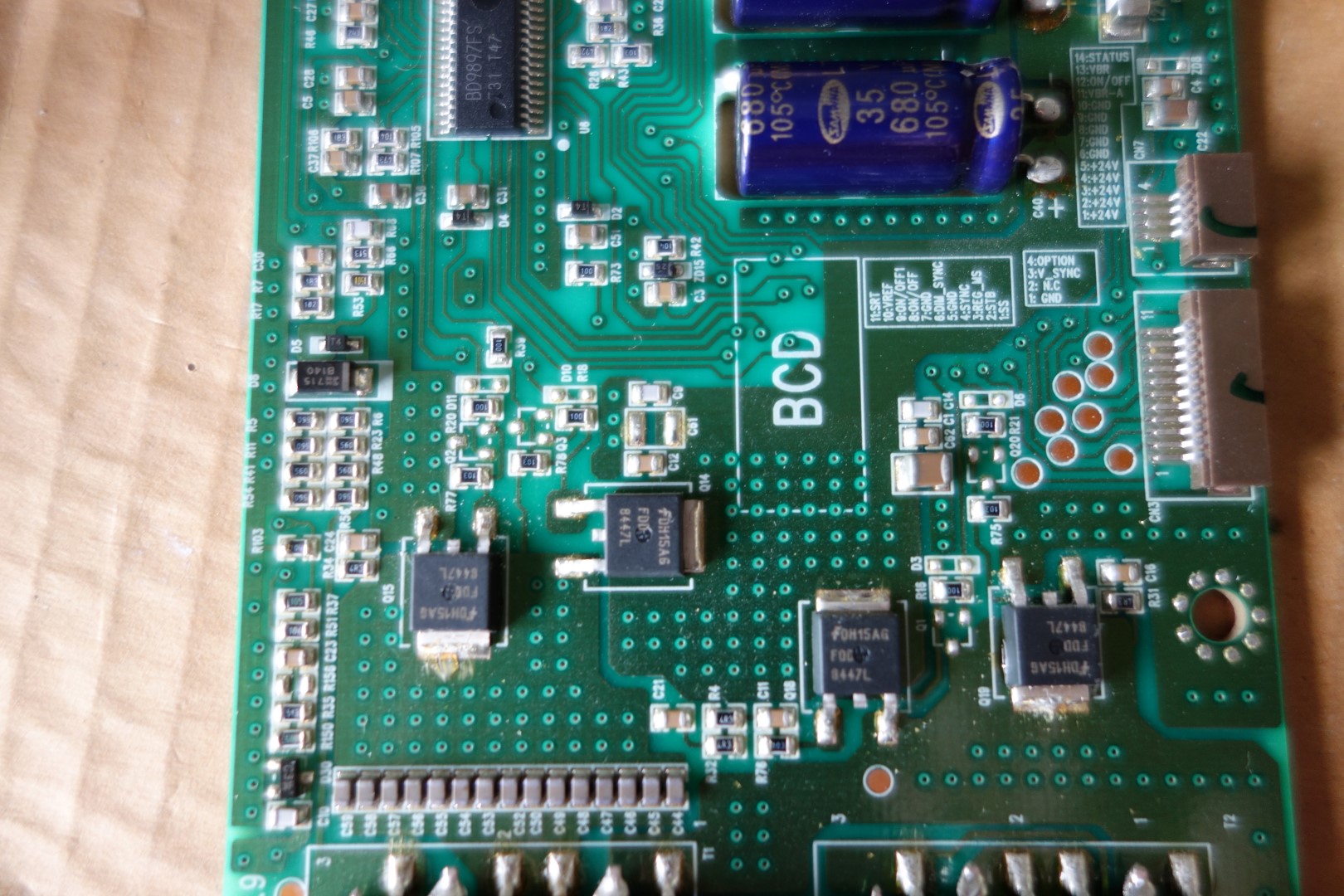

                        So I disconnected the pink wires to the backlights and the voltages still shut down so probably not the bulbs.
                        I removed and tested the samwa caps and they were all ok. Surface mount fuse was ok as well.
                        Next I checked the four transistors on both boards. The slave transistors seemed ok but was getting shorts on the master board transistors.
                        Can't find a datasheet on this part. Looks like Fairchild DH15A6. Edit correction: parts are Fairchild FDD8447L
                        Edit add: Confirmed the short on the master board checking the resistance 24V to gnd.
                          FDD8447L.
                          https://cdn.badcaps-static.com/pdfs/...76ac2c733d.pdf
                          The IC on the Inverter board has no sign of damage? And none of fuses are blown?

                            The IC's show no sign of damage and fuse is not blown. The fuse rating is market 12A so I guess the regulator shuts down well before it gets to that point.

                              Ordered the part from digikey but just did a search on ebay and found inverter repair kits with 4 FETs bundled with a BD9897FS IC. If it still doesn't work after replacing the FETs, I guess I will need this IC as well.
                              • neilc6
                                • Nov 2015
                                • 1550
                                Replace two shorted FETs and they shorted again once I plugged the board back in. Looks like I need to order the controller IC as well.

                                  Replacement IC came today (8 days epacket from China) and still no go. TV is looking like a lost cause. The FETs are stable now (replaced 3 out of the 4) and so is the 24V and 30V line. There is a blue LED on the board that does a slow flash on when the TV is powered up but still no backlight. Will recheck my soldering on the IC pins and maybe replace the one remaining FET. If it has bad bulbs, then even a replacement board probably won't help though they are pricey on ebay.

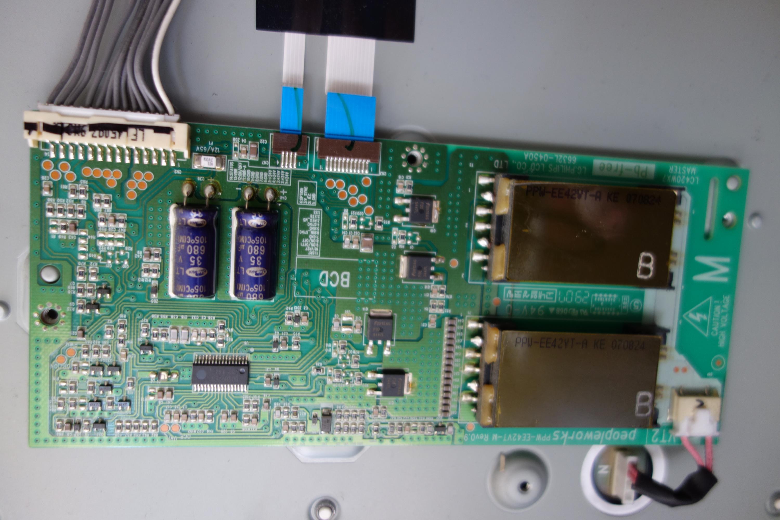

                                      Voltages to the board are stable. I may have had bad soldering on the replacement IC so have reordered it. Replacement inverter boards for this model are fairly expensive but found an Aliexpress listing indicating the following parts are all the same
                                      6632L-0450A / 6632L-0451A
                                      6632L-0371 / 6632L-0372
                                      6632L-0448A / 6632L-0449A
                                      6632L-0474A / 6632L-0475A
                                      6632L-0470A / 6632L-0471A
                                      6632L-0465B / 6632L-0466B
                                      Can anyone confirm? Since some versions of this board are much cheaper, I may try a different pair as well. This TV has the 0450A/0451A pair.
                                        Took one last shot and ordered a 474A/475A pair from an ebay seller for $13USD. In contrast, a 450A/450B set was $65.
                                        Checked for shorts before popping them in and now have backlights. Guess my soldering wasn't great when I first replaced the IC. Slight bad news, there are five equally spaced dark spots on the top edge of the screen.
