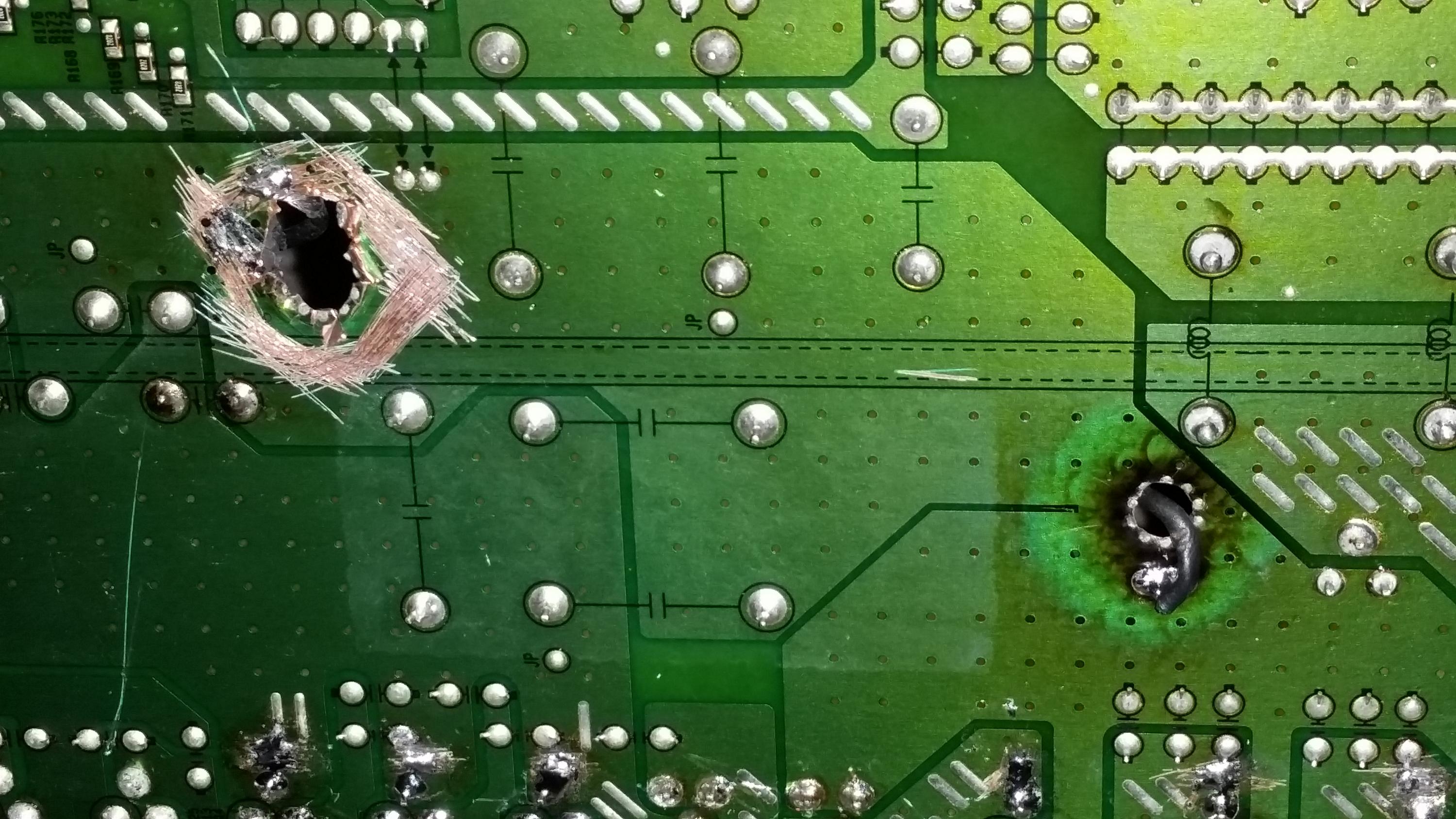

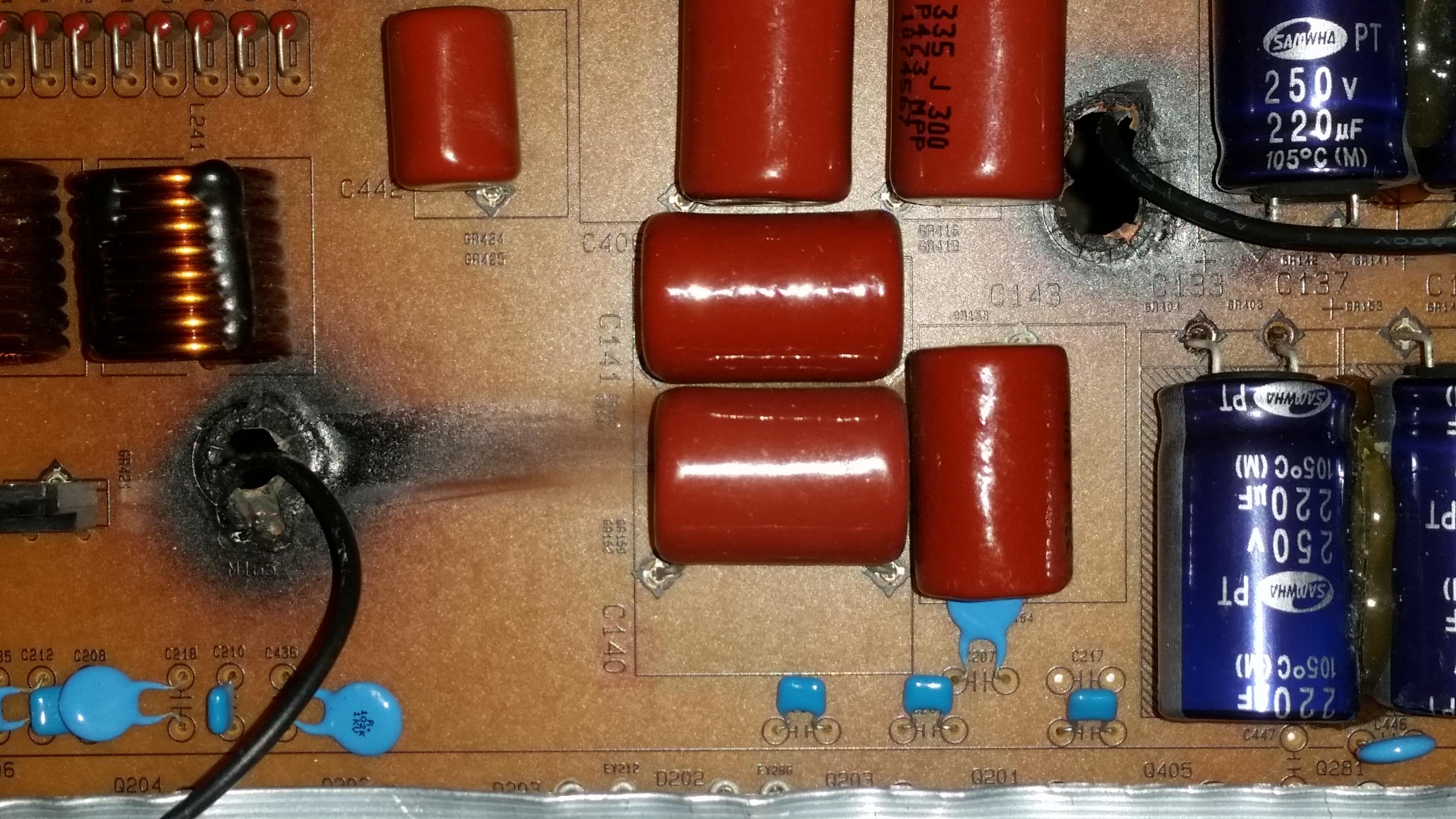

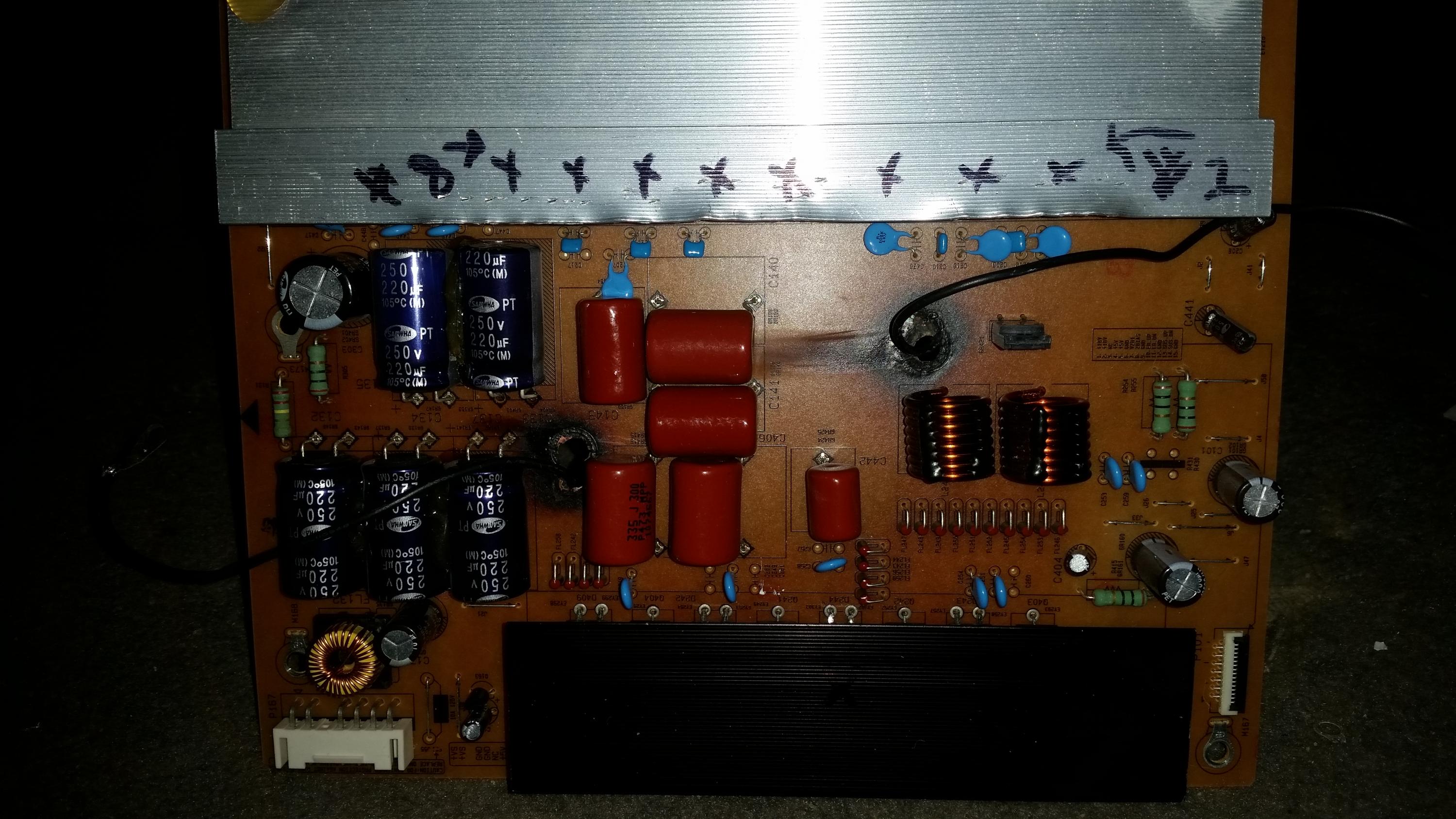

Im working on a 2012 lg plasma tv that has 6 blown 30f126 mosfets and one bad rf2001.
I think they failed because the 2 ground/mounting screws in the middle of the zsus board have burned through the board itself. Must have been arcing for a long time!
I checked to see if that part of the board goes to common ground, but it dont.
My question is, can I just get to the bare copper, solder on a piece of wire, and tie it to another ground point. Maybe i can use a ring connector and wire soldered to the pad.
The board is too damaged in those two spots to repair, frickin' charcoal holes twice the size of orig. holes. So..... what do the pros think?
