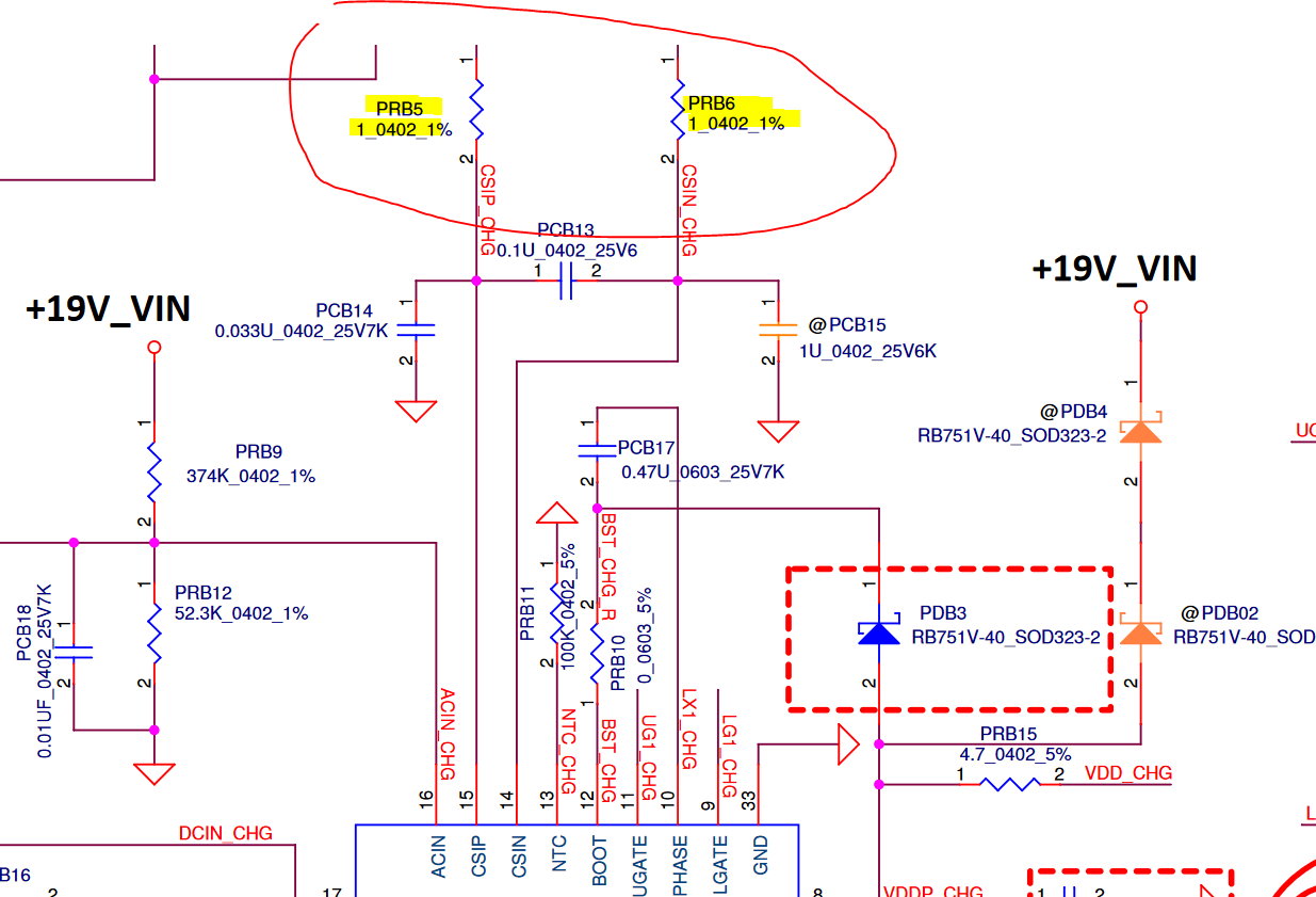

    Hey guys, I'm new and have an incredibly stupid question, but I'm second guessing myself. I'm working on a laptop charging circuit on an Alienware m15 R5 Ryzen, Mobo LA-KB9542 that has had water damage. The schematic is showing the CSIN and CSIP resistors as 1_0402_1%. That does mean they are 1 ohm resistors, right? I'm getting 6.7m and 1.9m on them, and it seems suspicious for two resistors labeled as such. Any advice would be greatly appreciated!

      1 ohm and is 1% accuracy in an 0402 SMD footprint. The values are critical as they are in the path of the current sense circuit. Always buy spares as the parts are tiny and easy to lose. Be sure to have nice tweezers + flux + use low air pressure to melt the solder and not disturb the nearby parts. Good luck and may the (hot air) force be with you.
      if your measurements are correct - yes this is a root cause and will cause the unit to shut down as the current draw measurement will not match what was expected from a known good unit.

        Thanks a million (ohms)! I have a feeling the liquid damage is more extensive, but this is definitely a good start. I've been using a JBC C210 knockoff soldering iron, and it seems to work a treat with the small stuff. I'm sure it won't be long before I'm back with more embarrassingly basic questions. Thanks again, mon2!
