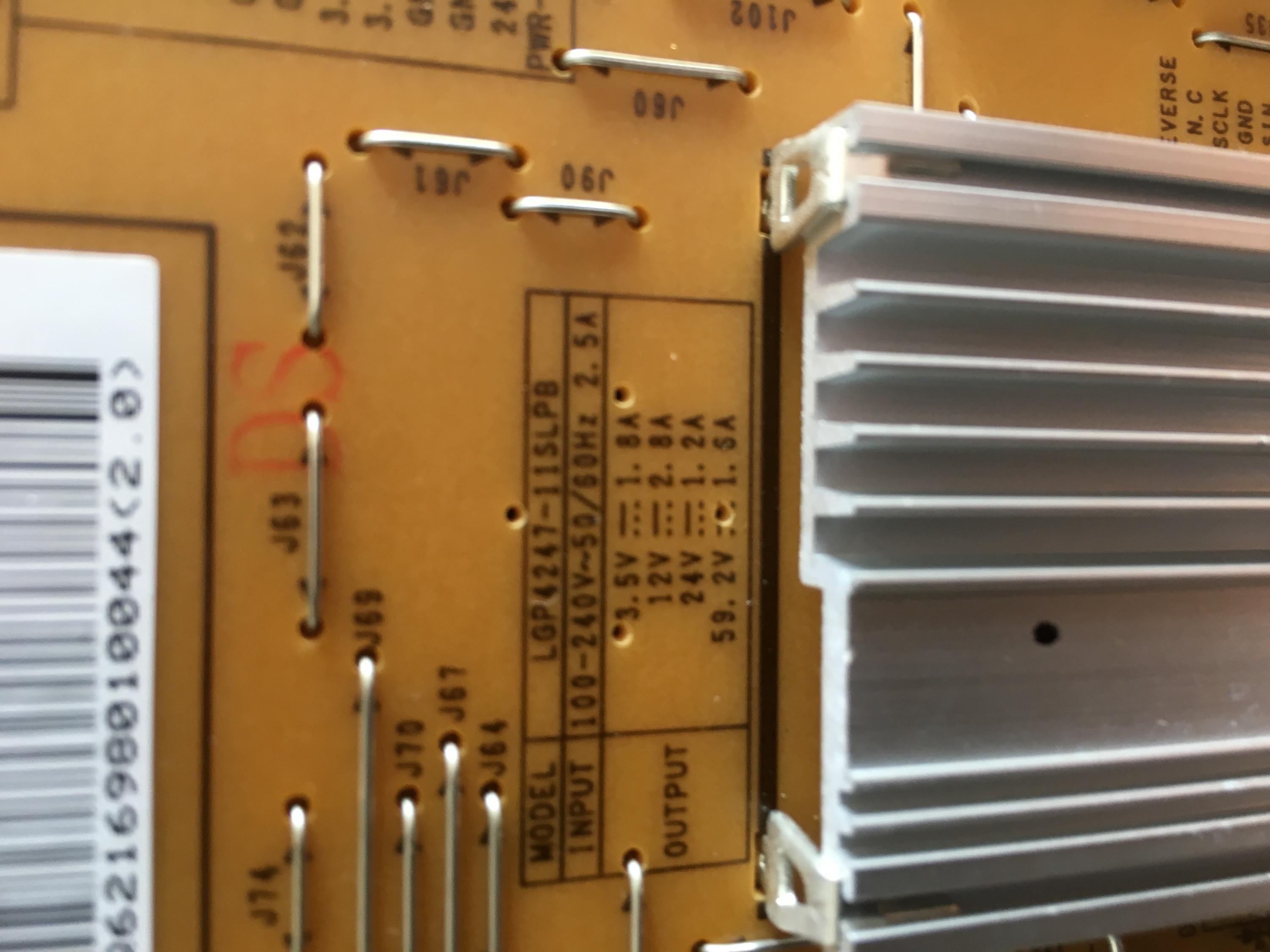

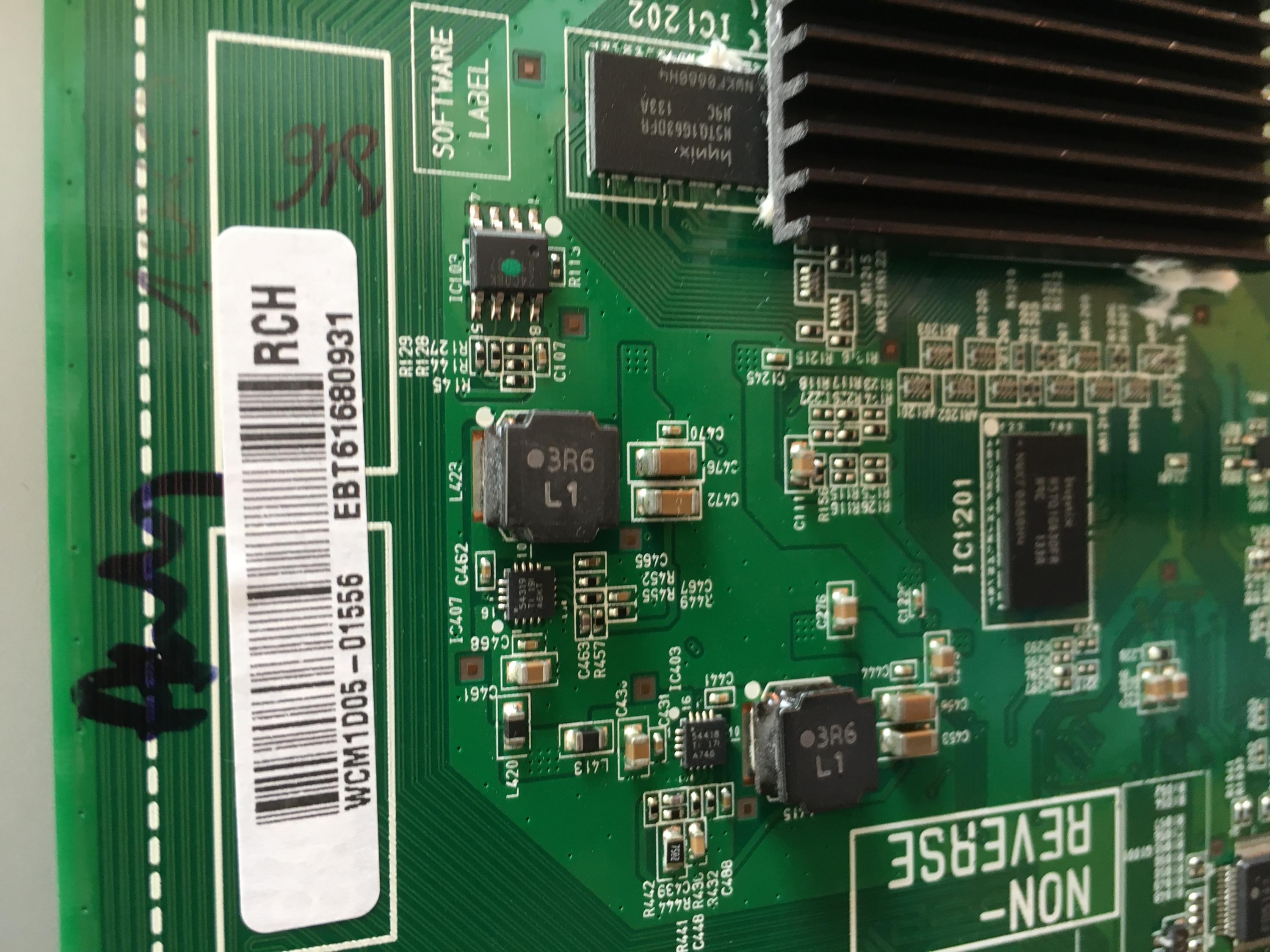

        Need good clear straight on pictures of back of tv with cover off and each board. and picture of connector on power supply board.
          I will post tommorrow tv is at my parents house.

              Here are pictures

                Re: Lg 47lw4500
                Originally posted by Jimmy1979
                Here are pictures
                Pwr-on 3,3v. 24v = 23,8
                24v= 23,8v. 24v =23,8
                Gnd Gnd
                Gnd. Gnd
                3,5v = 3,4. 3,5v = 3,4
                Gnd. Gnd
                Gnd. Vsync = 0
                12v = 11,7. Drv-on = 3,1
                12v = 11,7. Nc = 0
                12v = 11,7. Pwm = 1,0
                Nc = 0. Error = 3,4v
