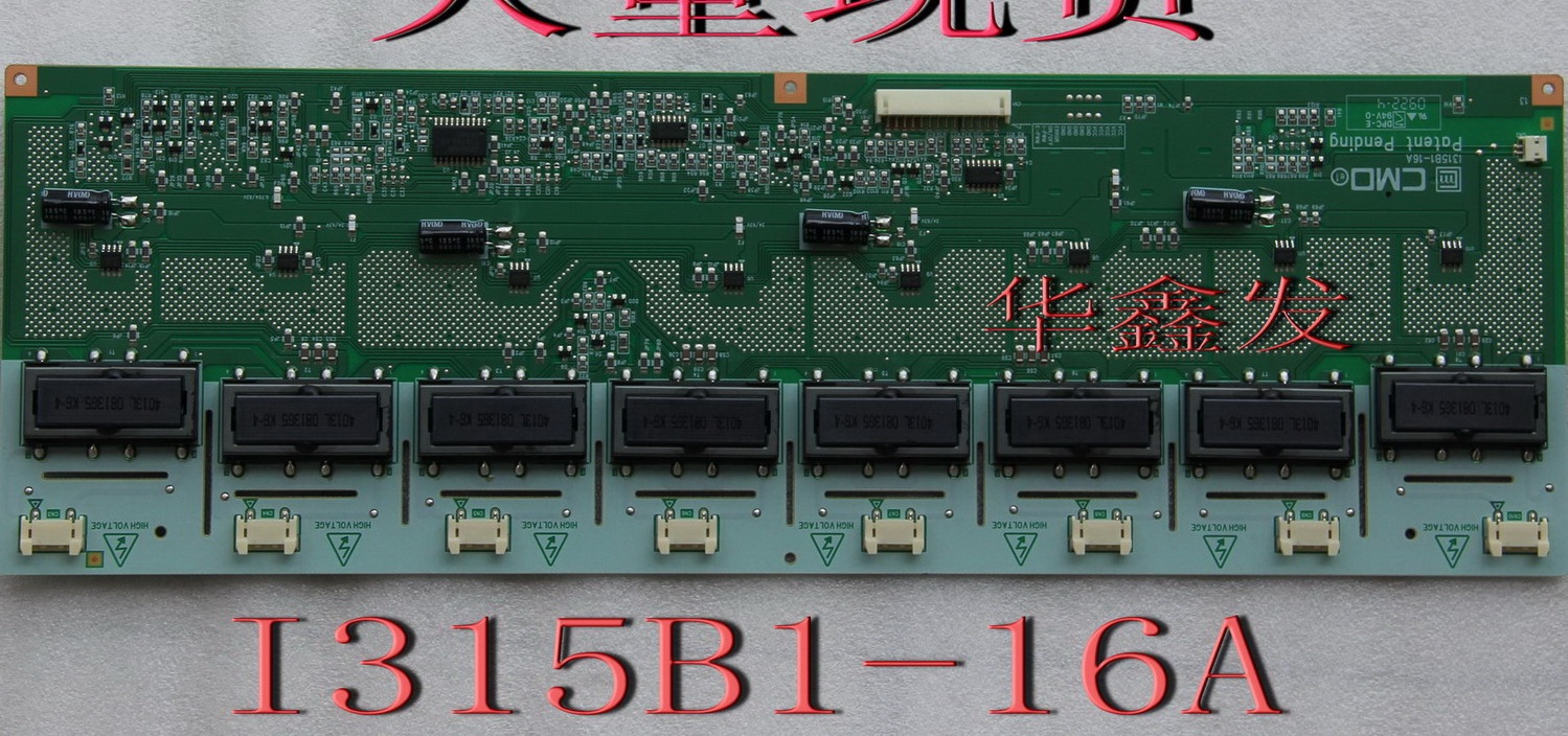

    I noticed on switching on a slight tick tick sound coming from the inverter board, so I removed cover didn't a few checks 1st been visual.
    Theres 5 smd fuses
    Fuse 1 - 3a/63v check Ok
    Fuse 2 - 3a/63v check open
    Fuse 3 - 3a/63v check open
    Fuse 4 - 3a/63v check open
    Fuse 5 - 0.75/63v check Ok
    Think these most definitely need replacing F2-F3-F4.
    This is were I could do with some help been on flea-bay but not sure on the correct part number.
    Circuit Side
    I315B1-16A
    The inverter board has so many numbers underneath green side has
    The big sticker
    27-D019399
    0741HF
    008332
    I315B1-16A-C302G
    The little sticker
    27-D019399
    T871029.11 LF
    E200000743-00
    Many Thanx inadvance

    for three fuses to be blown other parts on that board may/must be faulty too upload a picture/part number of the invertor board so we can see what were dealing with
      Re: LG 32L46 No Turning On
      The circuit side number brings up the following board.
      It looks as though the 8 pin devices (mosfets maybe) are faulty.
      This could be because of the transformers being out of spec and operating at a higher current.
        Cheers dick barton that looks like the correct board

          Quick update still not found camera will use phone.
          By chance found the exact board all numbers matched on fleabay good bargain price £6 lol @ £5pp so great.
          Before plugging the (new used board) into Tv i check it against the faulty board, found it to be shorted to ground around those little capacitors where they are seated 3 in a row across the board if thats the correct terminology. So not sure if replacing the mentioned fuses above would of fixed that issue.
