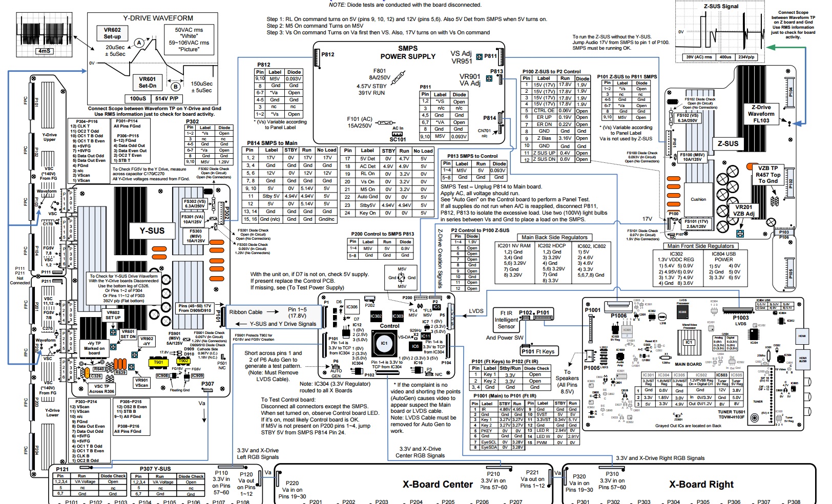

    Just wanted to pop back on and give a slight update.
    I did find a troubleshooting schematic and it said that I need to jump pin 1&2 on the 'Auto-Gen' (P6) while having removed cable LVDS. I did try this but I had to assume what pin 1&2 were; was not able to produce the test pattern. Should I be using R52 & R53 instead?

      pin 1 has the little triangle above it.
      what are the run voltages?
      VS
      VA
      VSC
      -VY
      VZB
      the test points are shown on the manual you've uploaded

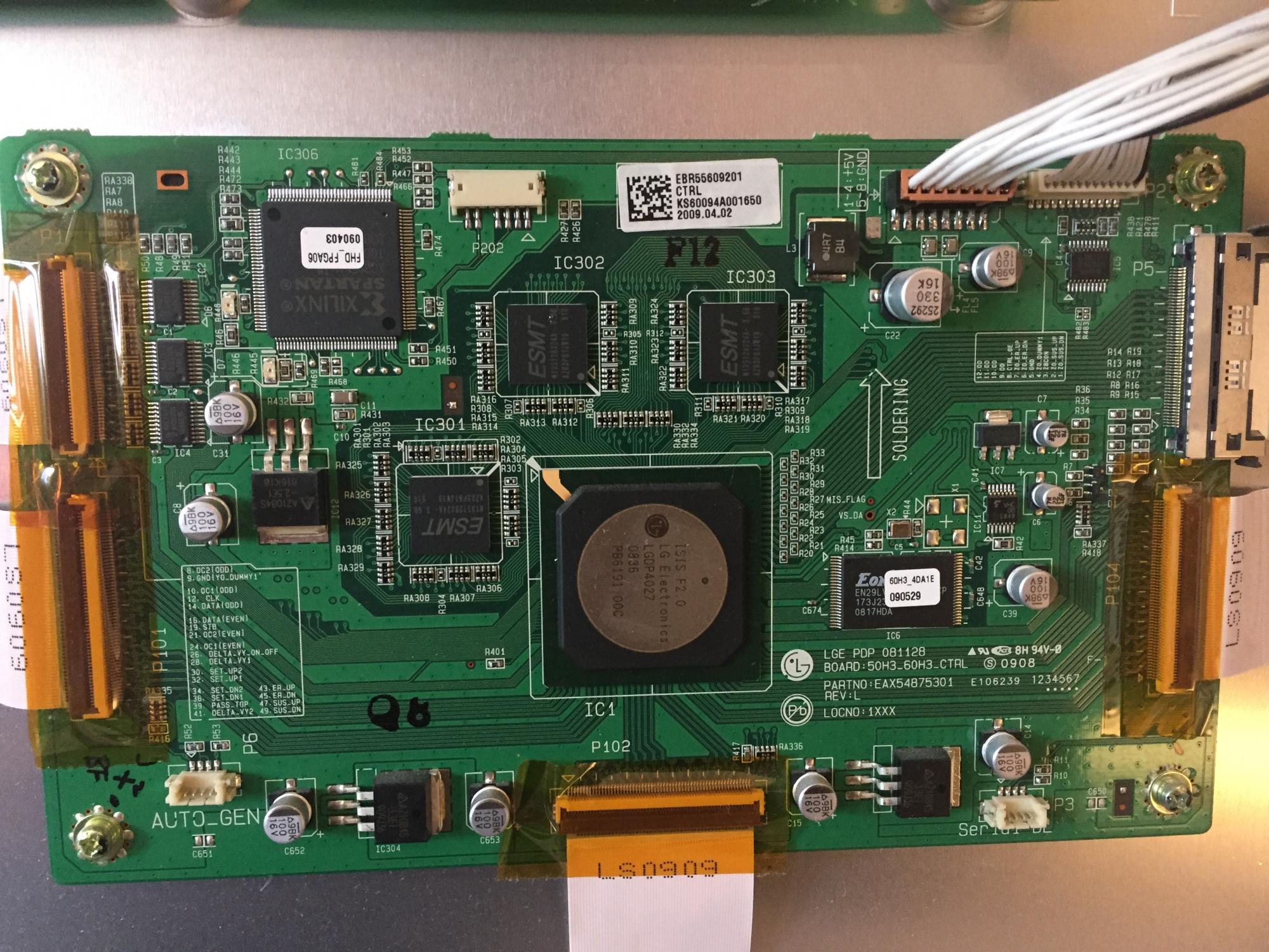

                Okay. Back to the drawing board.
                - unsuccessful at reflow; might try again
                I have noticed that I get a bit of hiss out of the speakers which I didn't notice before.
                Have still not been able to get a test pattern.
                Did a test on the logic board according to the instructions posted and was okay.
                Not sure where or what else to try. I'm sure I'm missing something!

                            The main board will sometimes develop cracked solder joints between the BGA chip and the board itself which can cause picture problems. The heating portion with hot air can make it temporarily work again but I would advise against it as you could ruin your board and best case scenario only make it work for an additional few weeks to a few months. A new BGA chip or re-ball should be performed in order to have a successful repair. However as mentioned prior, the voltages on the sustain board seem weird. What really should be done is disconnecting the main board out of circuit and with every other board in circuit perform the color pattern test by shorting the auto exgene on the logic board. If the pattern test appears, then you know for sure bad main board.
