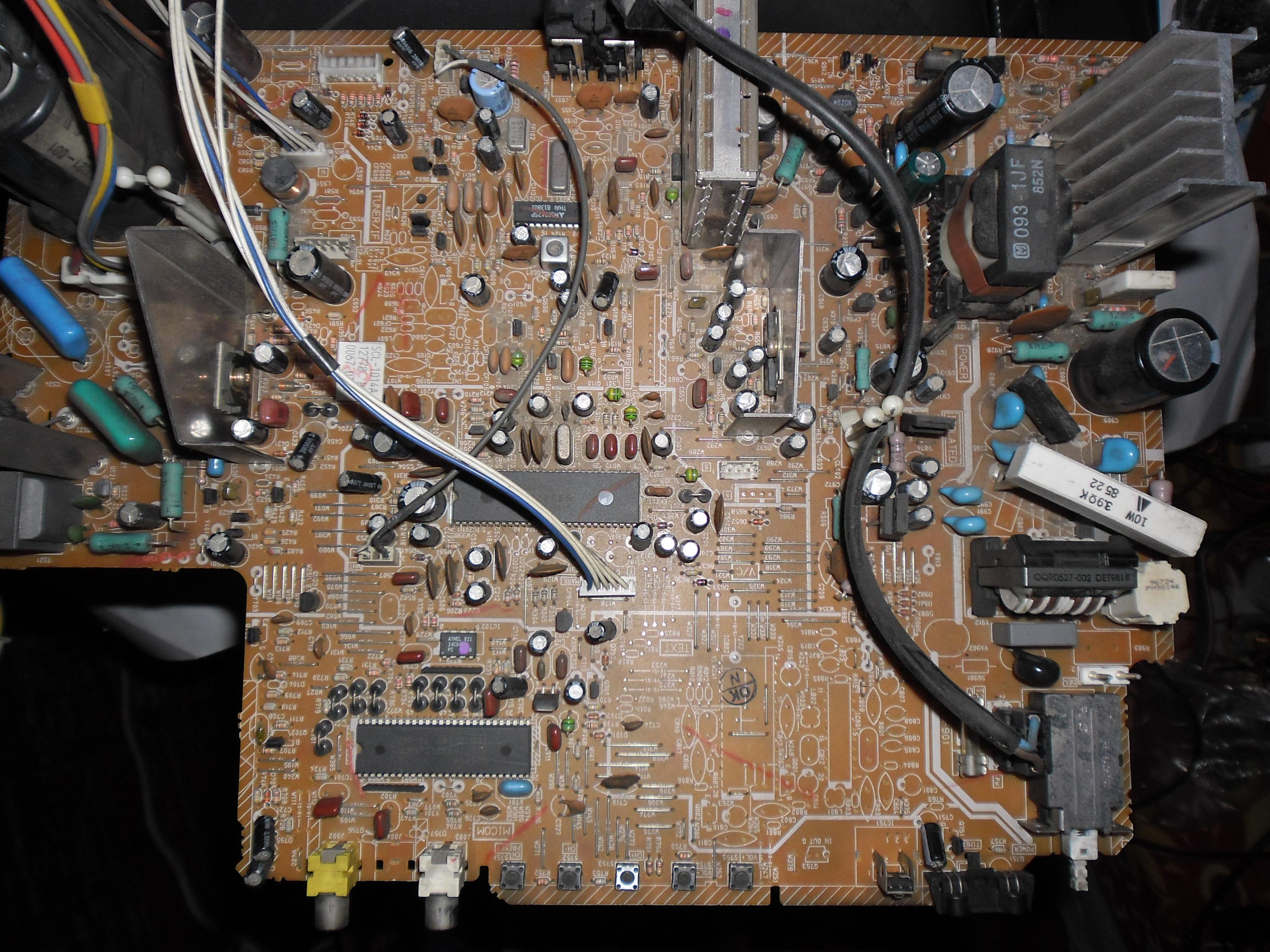

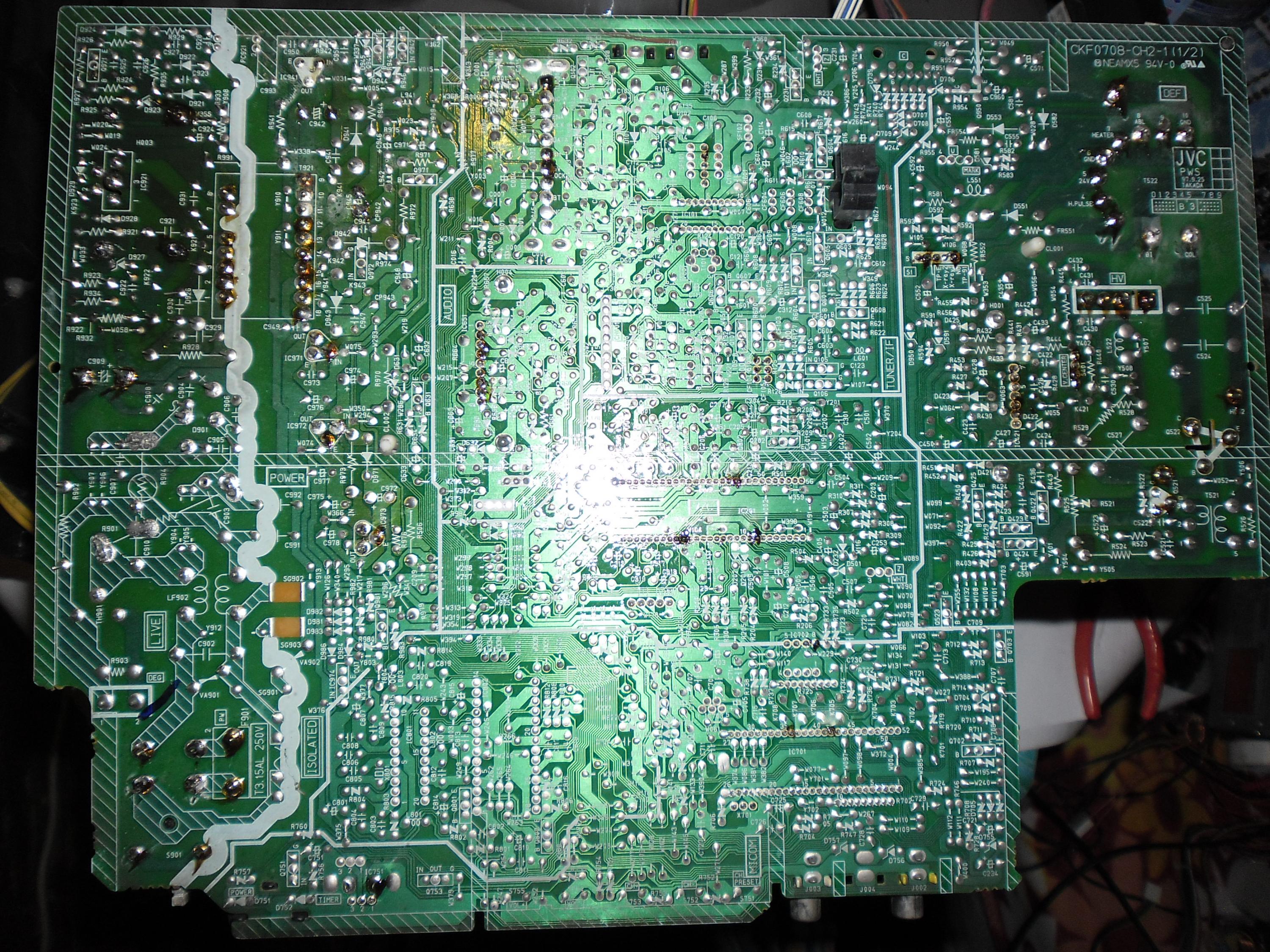

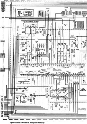

    Hi folks, today i have a problem with an old CRT TV
    It turns on but after turn off it's completely dead, even if i unplug it and then try go turn it off it stays dead.But after 2-3 hours unplugged it can turn on again and then dies after shutdown...
    Here are the specs:
    Chassy: CKF0708-CH2-1
    STR F6653
    TB1226EN
    M37212M6
    AN5265
    LA7840
    D1878
    I replaced:
    C942 - 100uF/160V
    C924 - 100uF/25V
    C945 - 1000uF/16V (replaced with 2200uF/16V)
    STR F6653 with a new one..
    And also resolder all ICs and flyback
    All this with no luck
    If you have some ideas please share with me...
    Best regards, ragis

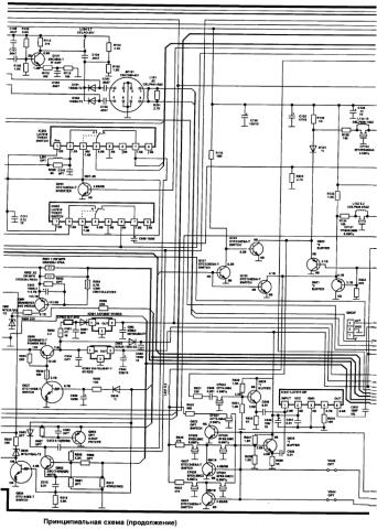

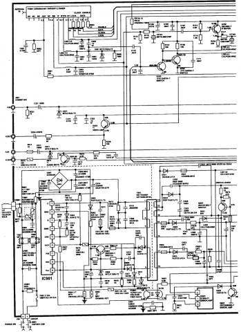

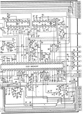

        I have these service schematics hopefully they will be of some use, I will look through them later when I am more awake.
        Regards

            Ok, some news guys found that the PTC(posistor) is burned up, it says:
            96724 PH98146 and it's 3 pin
            I have 2 pin posistor solder it and nothing happens again..
            Should i purchase the same PTC or i can bypass it somehow to turn the tv on... ?

              Try and find a replacement. I seem to vaguely remember it stops the inrush current to the degauss coils.
