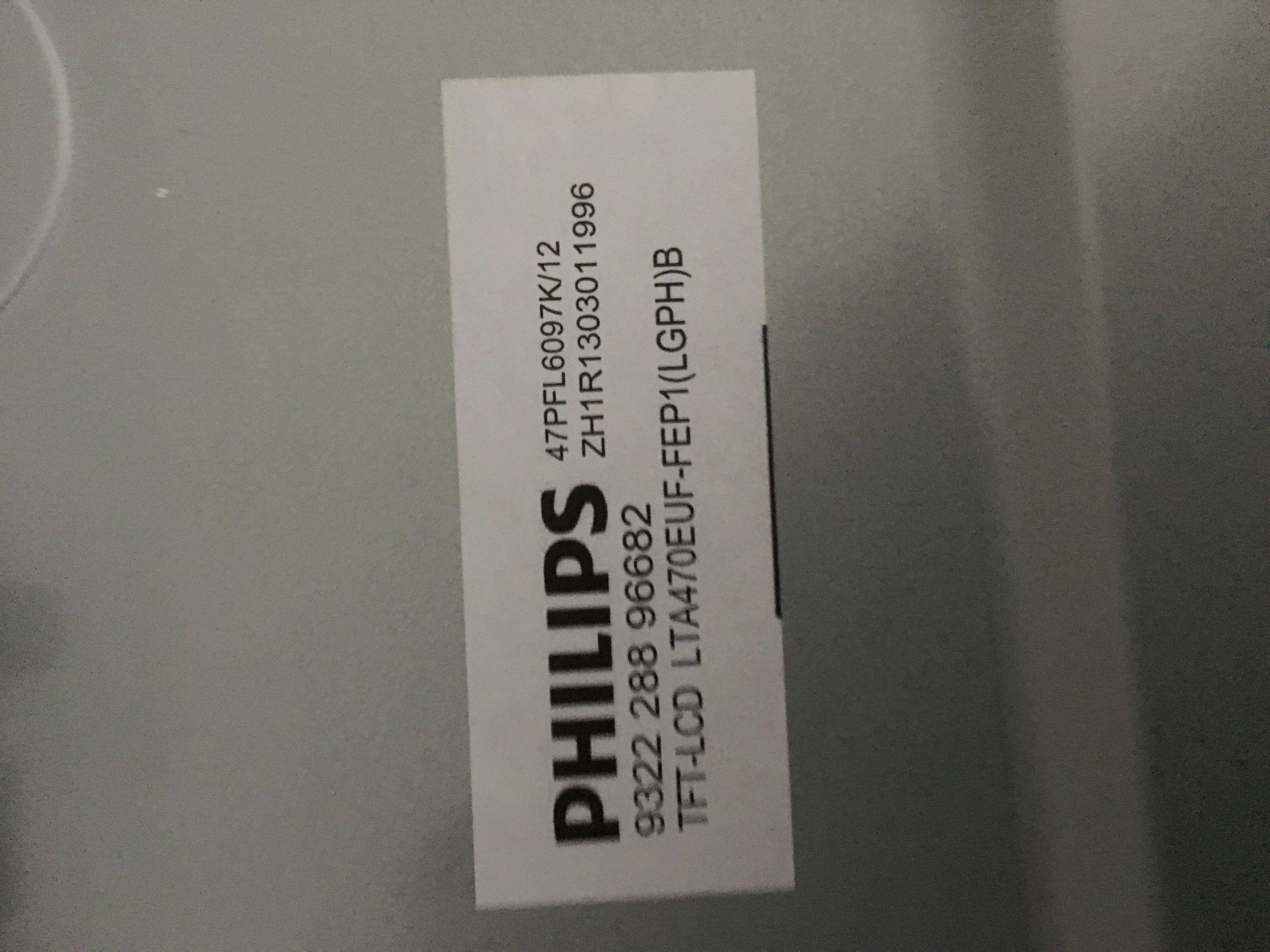

                  Originally posted by rickou View Post
                  062598 MENU and then 426. Normally this number can also e find in the back side of the mainbord
                  I think this tv had a panel swap
                  Before because i see an onther number on the panel.
                  I will post a picture.
                  Does someone know's if it is the same panel code 426
                  This panel has a sticker with type 47pfl6097k/12
