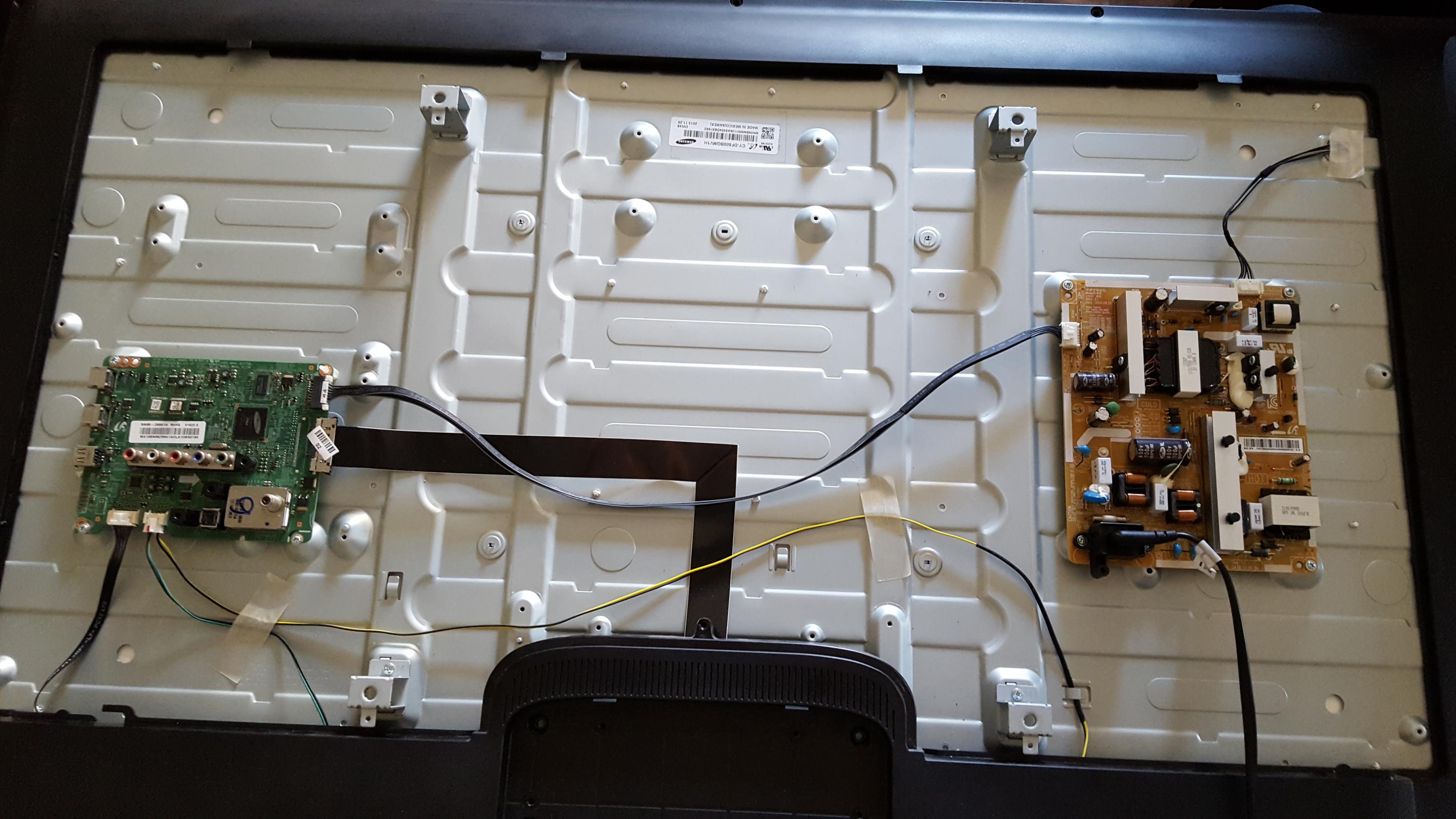

    Samsung 50 inch LED no picture model UN50EH5000
    I have done a little bit of trouble shooting and am hoping someone here can maybe give a diagnosis. I have sound but no picture. In a dark room with a flash light i can faintly see the picture. i have no back lights. The TV has had problems with randomly shutting off. Sometimes it comes right back on, Sometimes it does a few power cycles. Sometimes i can't get it to come back at all and just have to walk away. I don't see any bad caps on any of the boards and no obvious damage to them. Below are the Power board and T Con. Any suggestions are welcome. I'd rather not buy a new TV if i can fix it.

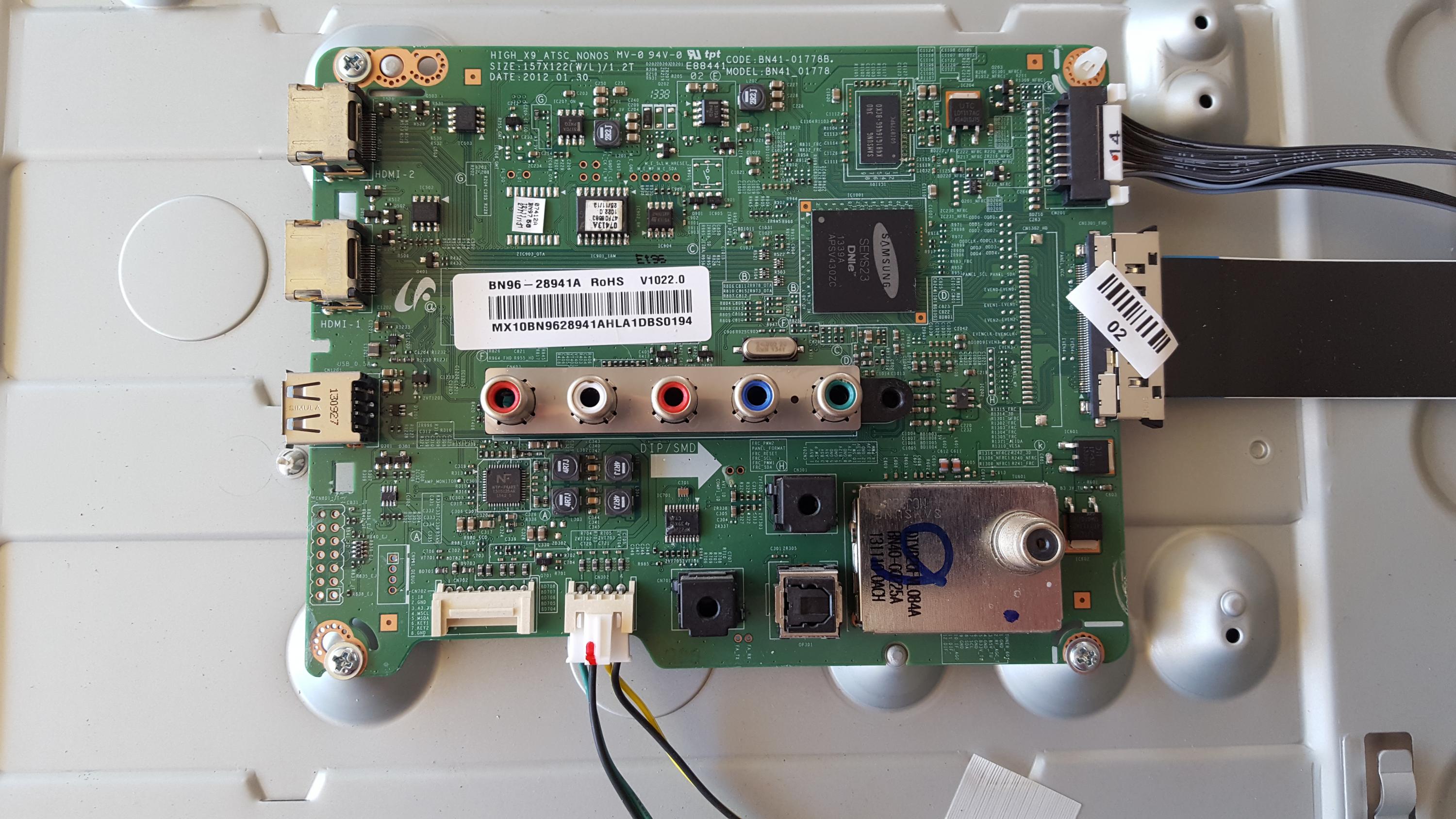

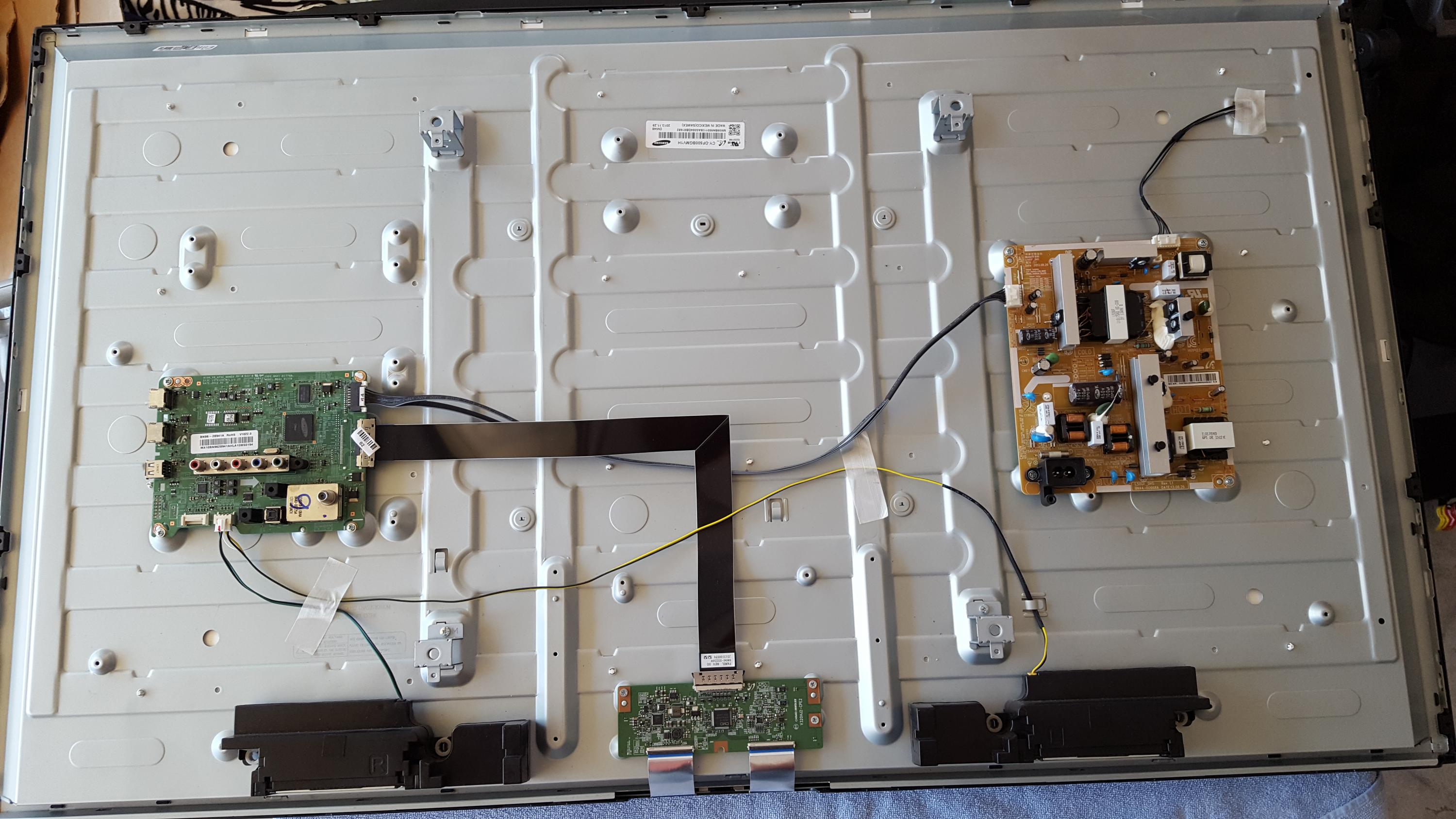

    Re: Samsung 50 inch LED no picture model UN50EH5000
    Can we get a picture of mainboard and whole back of tv
      absolutely!
        If you disconnect the main board connector labelled "14" (the cable running between the main board & power board) & apply power, do the backlights come on?

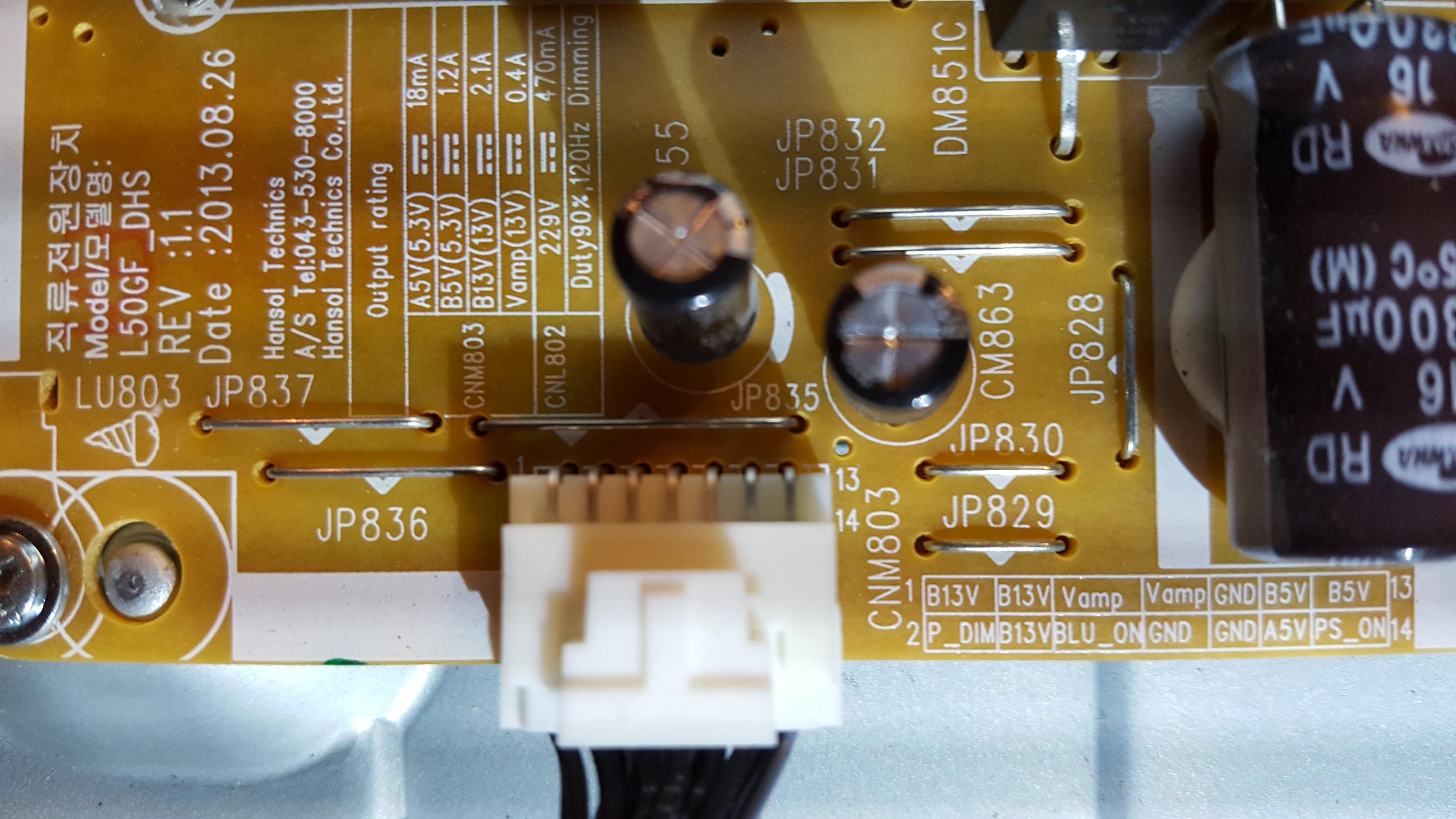

              Need to post some voltages from your connector from power board to main. With the pin id and voltage. Looks like there is a bl-on can't quite read. If so that is your signal for your backlights
              • JohnO FL
                • Mar 2017
                • 14
                is this the part you are talking about? i dont see a bl -on
                  BLU-ON = BL-ON
                  That power supply board may have the pull-up resistor for for the PS-ON , BLU-ON already so check the DCV too on those pins when that connector is not in place.
                  We also need the DCV on the LED connector pins with ref to the chassis GND when TV is off and when TV power switch is activated.

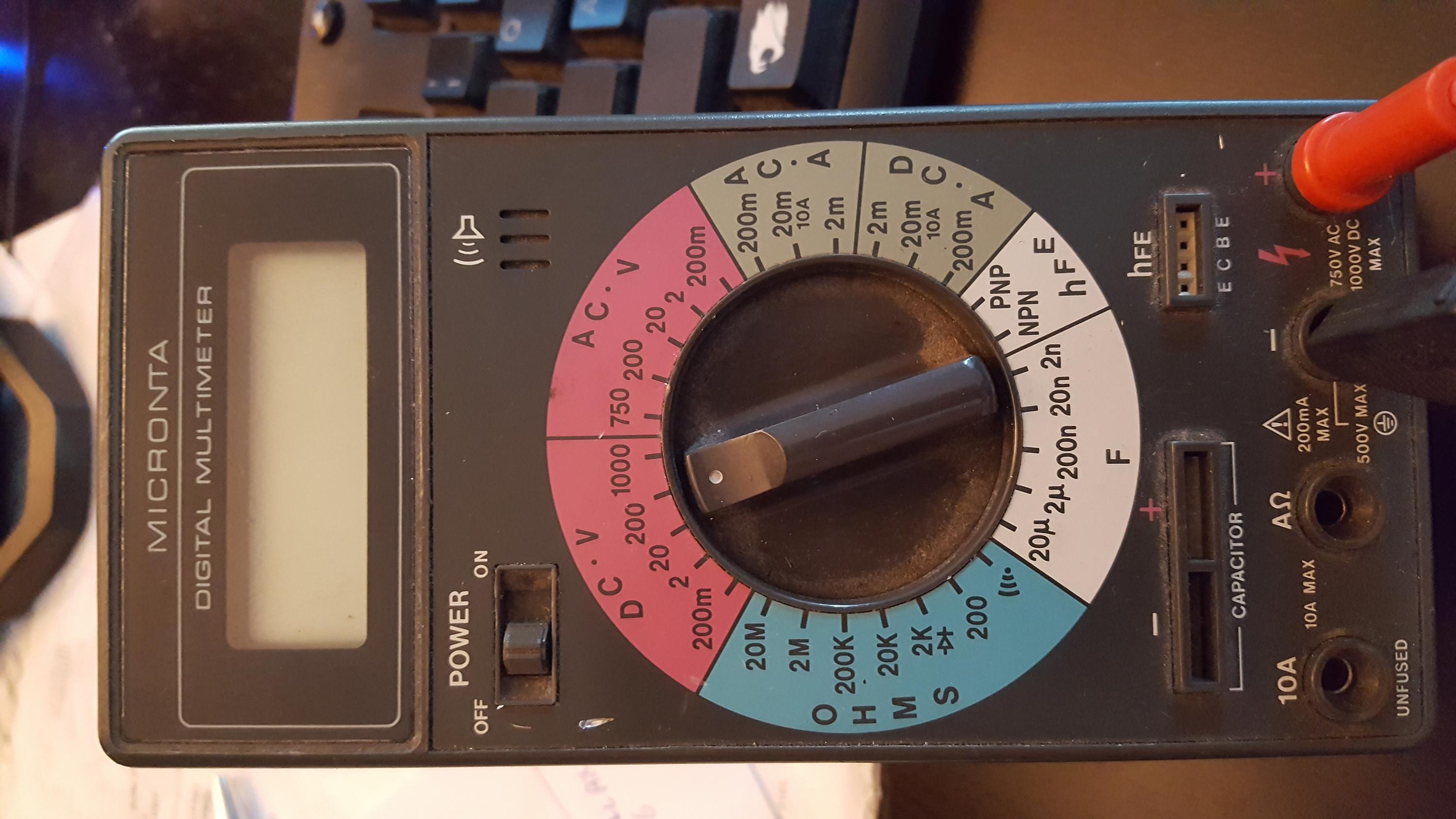

                          below is the voltmeter i have. what setting do i put the dial on?
                          and when you say on the pin, do you mean the metal pieces that come out the back of the connector and goes down do the board? and i assume the diagram next to it with the 7 boxes shows me which is which right?
                          Please be specific as to when i should have it plugged in and or turned on/off while doing this. i am a little nervous of sticking metal probes in something that is live with electricity.
                            Setting in the picture should be fine. The brown power board is marked hot and cold. There is a line dividing them. The hot side has dangerous voltages. You will be measuring on cold side so little danger. On cold side you will put black probe on metal back. Red probe will go on each terminal of connector that goes from power board to main board. Record each reading. The tv will be plugged in but not on. The probe will go down alongside the wire on the connector till it makes contact.
                                So i got some measurements then reconnected plugged in and get no red light indicator and no response when trying to turn on. see pic it's all connected back the way it was and seems dead. Does this indicate anything? i dont think i broke any parts either. It's almost like i mentioned in my original post. Sometimes it would shut off maybe it comes back on in a second maybe it takes a minute maybe it takes hours. then it will go months without it happening. now it's dead.
                                    sorry i did that earlier should have posted the numbers.
                                    P_DIM - 12.4
                                    B13V - 12.4
                                    BLU_ON - 12.4
                                    GND - 12.4
                                    GND - 0
                                    A5V - 5.2
                                    PS_ON - 5.2
                                    • dick_barton
                                      • Aug 2015
                                      • 6643
                                      • Wales
                                      There are 14 pins as shown on the legend alongside.
                                      7 top row and 7 lower row
                                      The top row you can see as in post#8 left -> right are
                                      Pins 1,3,5,7,9,11,13
                                      and the lower row left -> right
                                      Pins 2,4,6,8,10,12,14
                                      The readings you have given are not correct.
