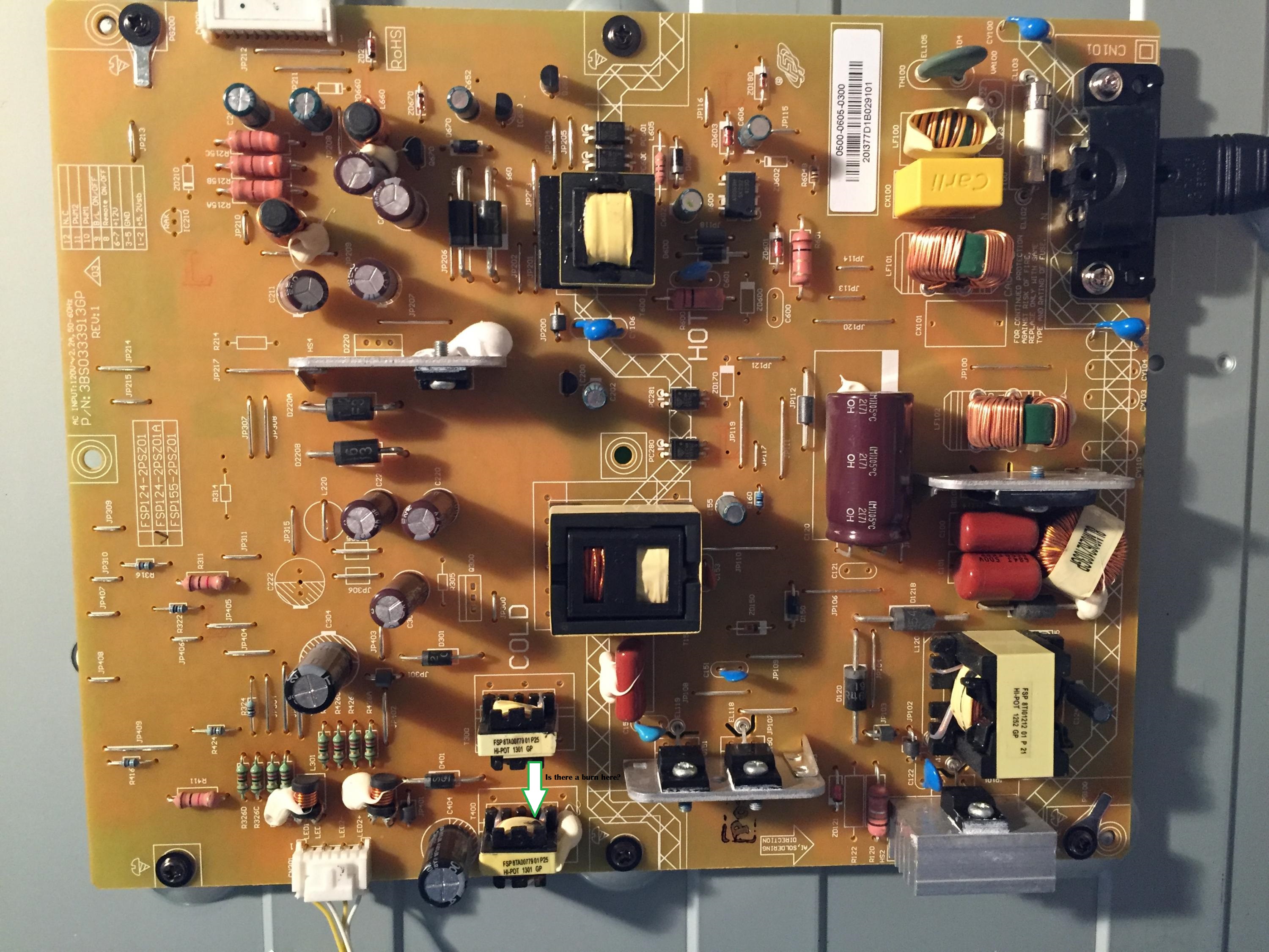

        Power supply board is 0500-0605-0300. Here's a pic http://www.shopjimmy.com/vizio-0500-...-led-board.htm (This board is interchangeable with 0500-614-0300)
        I agree with the bad LEDs assumption. But the PS board is only putting out 66v on +Vout1 and +Vout2, at the connector with the LED supply cable disconnected. Shop Jimmy's video on testing this specific board (https://youtu.be/W2PFEdrL4lU) says it should be putting out something like ~87v on v1 and ~128v on v2 with the LED cable disconnected. The board they sent me has the same bad readings. They are sending another PS board.
        Thanks for the tip on firing up the LEDS with the panel removed. That's my next test once I get good power to the LEDS. I'll also look on EBay for an LED strip tester.
        Sure would like to know what components are associated with the LED supply voltages on this board. Since the output is identical on both pins with the LEDs disconnected from the board, seems suspicious that an LED is at fault. Would like to do some troubleshooting on this board. Hate just throwing parts at this thing, especially when a replacement acts the same as the bad one with the same bad readings. I may just be paranoid and received a bad replacement board. That 66v number pops up in other strings on this board and now I have 2 doing the same thing. Would like to solve that mystery. Caps and diodes are cheaper than entire boards.

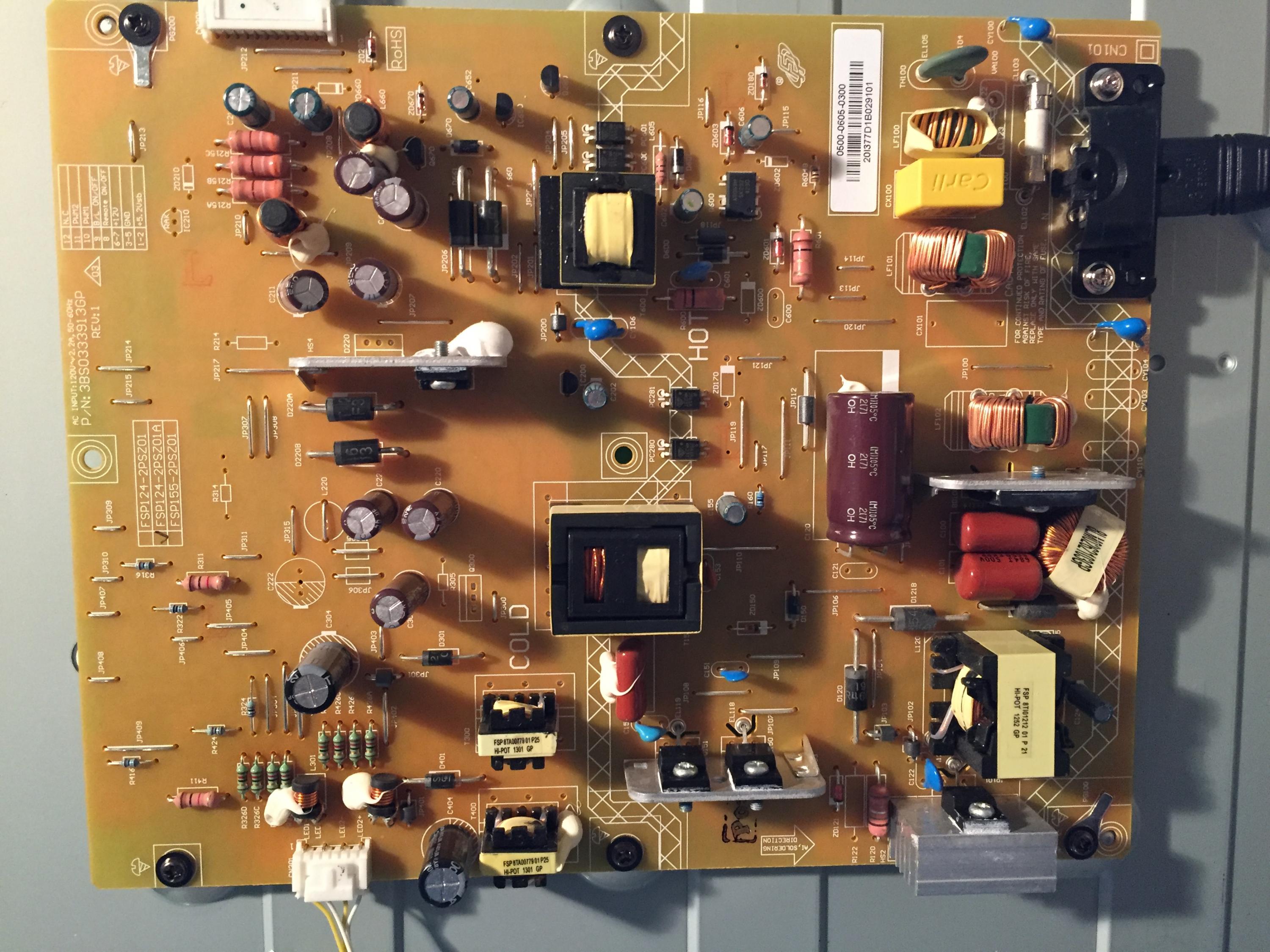

                  Re: Vizio E420i-AO tech help?
                  I up loaded pics. Again, 3 boards, same 66v on the 2 LED outputs. Prob not a PS issue.
                        You say you have all the output DC voltages and also the Backlight On voltage, however the Led voltages are low at 66V and not showing the 80V & 120V as shown in the shopjimmy video.
                        This would lead me to believe that you may well have a LED boost voltage problem on the power supply board.
                        Can you supply a picture of the underside of the power supply board especially the led driver IC and give its part number.
                        Edit
                        Is there a burn mark on the transformer?
                          I think what he needs to do is to put black probe on the chassis, red probe on the LED+ one at a time THEN turn on the TV to see if the Voltage jumps up higher than 66V or not and then settle down to 66V..
                          You have two boost converter circuits for two set of LED strings.
                            Bud,
                            Yes, that's exactly what they did on all three PS boards, the original plus 2 from shopJimmy. So suspected it wasn't caused by the PS boards. I just put another logic board in and got the same result - sound, picture but no backlight. Outputs on +Vout1 and +Vout2 settled after initial power-up to 66v.
                            But now I've screwed myself. As I was checking and comparing voltages on the PS board must have pissed something off and got a loud crack and everything silent. Checking voltages on the ins of the logic cable to the PS board, I'm. Now missing the 12v. So I'll get yet another PS board (sent the other ones back to ShopJimmy). Then we can re-visit this whole issue if the new PS BD doesn't solve the issues.
                            THanks guys!! I'll get back to you soon.

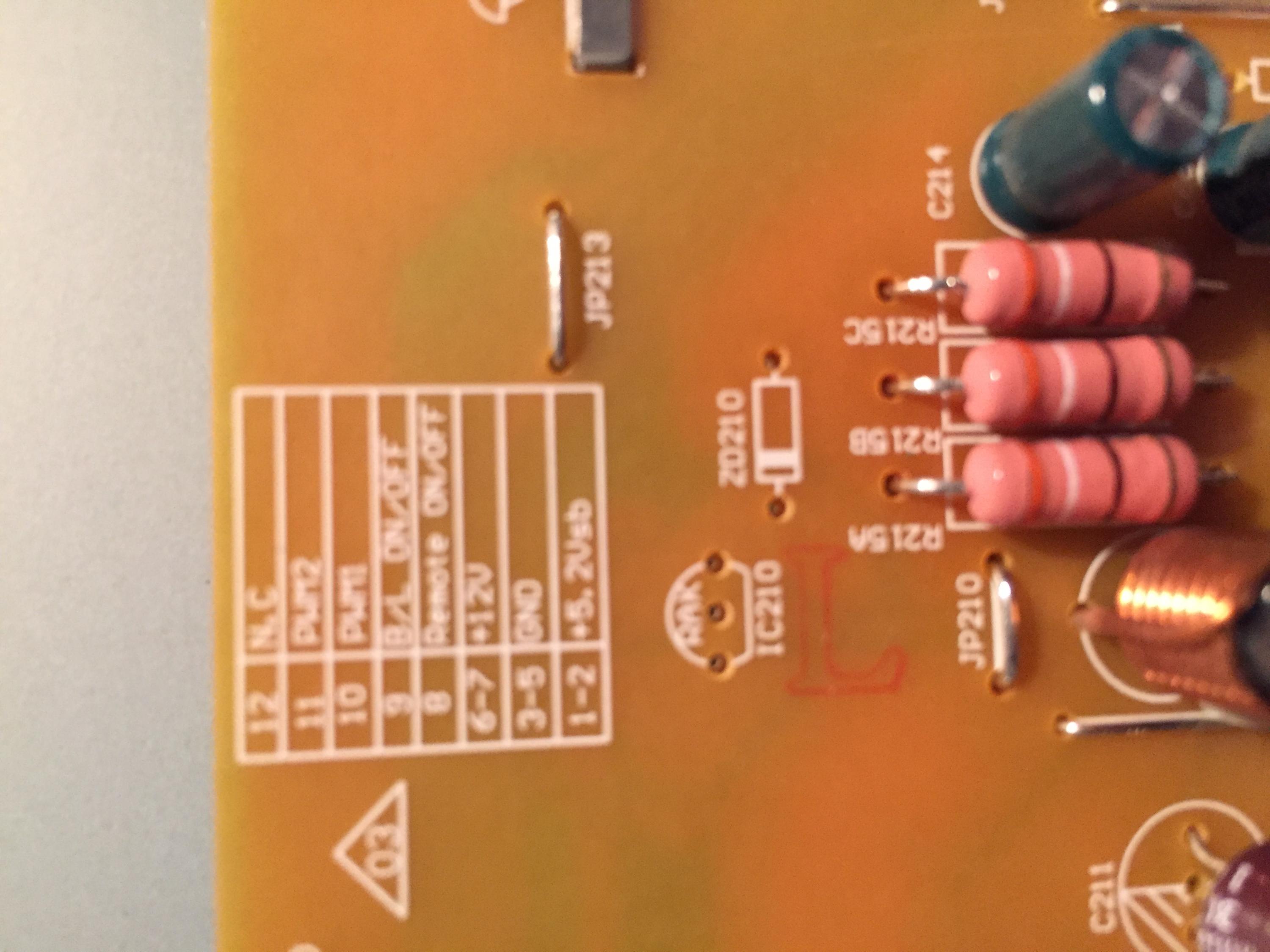

                                  OK Folks, we're back in problem mode again. I replaced the PS BD that I fried with a probe slip, and this board measures EXACTLY the same as the other 3 did. There is no backlighting. I have sound, a picture (seen with a flashlight) and all other functions that I can tell with no backlight. I have replaced the LOGIC board and the symptom does not change. When the unit powers on, the voltage on Vout1 and Vout2 of the LED connector goes to 128v and decreases to 67.1v and holds there - with the LED cable connected or not. In fact, with the latest PS bd, I left the LED cable disconnected and measured the voltage before connecting it (after power-down, then up again). It's as if the BL is turned off. But with a different Logic bd and PS bd, this shouldn't be the case. Also, both LED arrays would need to be OPEN for them to cause the same reading as a disconnected cable - highly unlikely.
                                  So I'm suspecting something else. Does the Tconn bd have any influence on the backlight?
                                  Here's the pin readings on the PS to LOGIC cable -
                                  Pin. Function. V Reading
                                  1 and 2 SBv. 5.15
                                  3-5. Grnd
                                  6. 12v. 11.9
                                  7. 12v. 11.9
                                  8. Remote on/off. 3.2
                                  9. BL on/off. 3.2
                                  10. PWM1. 3.2
                                  11. PWM2. 3.2
                                  12. N/C. 0
                                  These all seem normal per the ShopJimmy video on this exact board and model TV.
                                  Anybody have any idea how to make the backlights come on?
                                    The fact that the led boost voltages initially rises high before falling back to 66V would be indicative of open circuit led(s).
                                    "Highly unlikely......" no it isn't unfortunately. It could also be a fault between the strip connections of which there have been lots of threads about this sort of problem.

                                      AHA! Thanks Dick. Could you give me a hint what to do a search on or how trouble shoot to verify the problem. Is there a way to use a meter at the cable connector end? Otherwise I'm assuming I'll need to open the screeens to get to the LEDs and driver strips. I don't have a 24v DC power supply so I thought maybe I could Isolate each half of a strip (by unplugging them from the boards and each other, and use a 12v battery to test them. Not sure how to check the driver/distribution strips that are fed by the LED cable of the PS bd. Does this sound reasonable?
                                      I've found one other thread on this no backlight problem where the LED driver voltage was 66v but there was no solution given. The thread just died. So I'm stumped.
