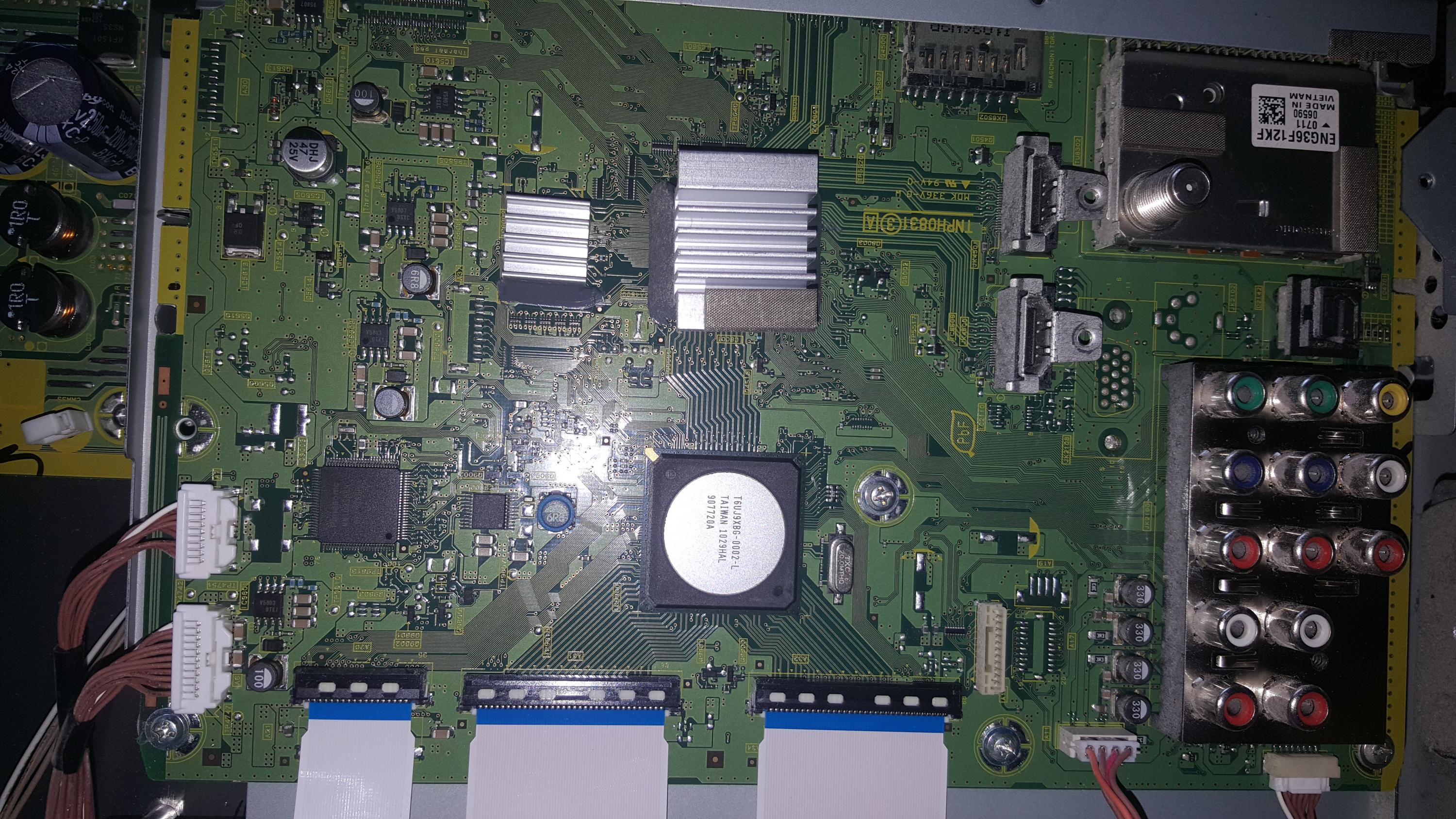

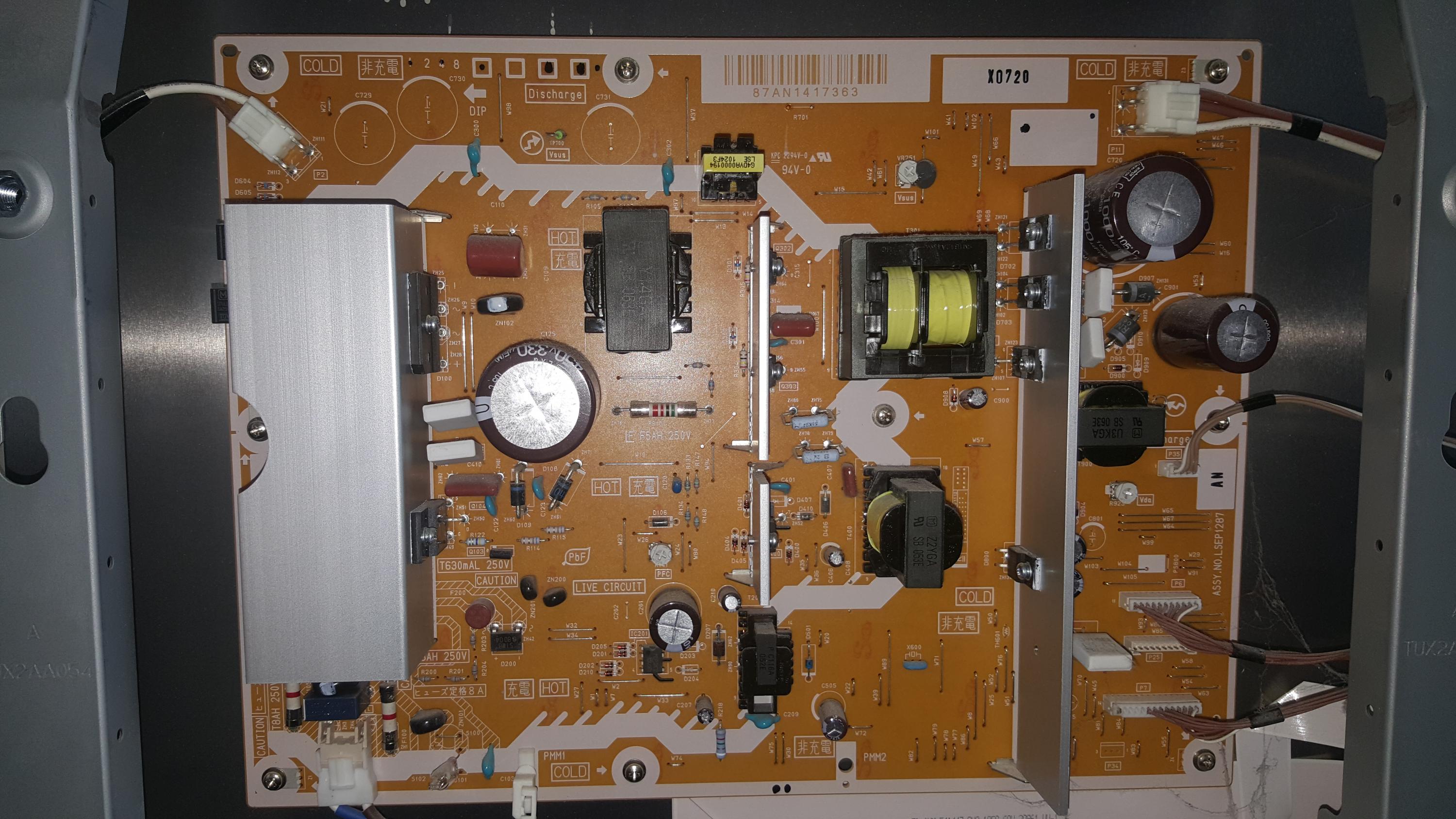

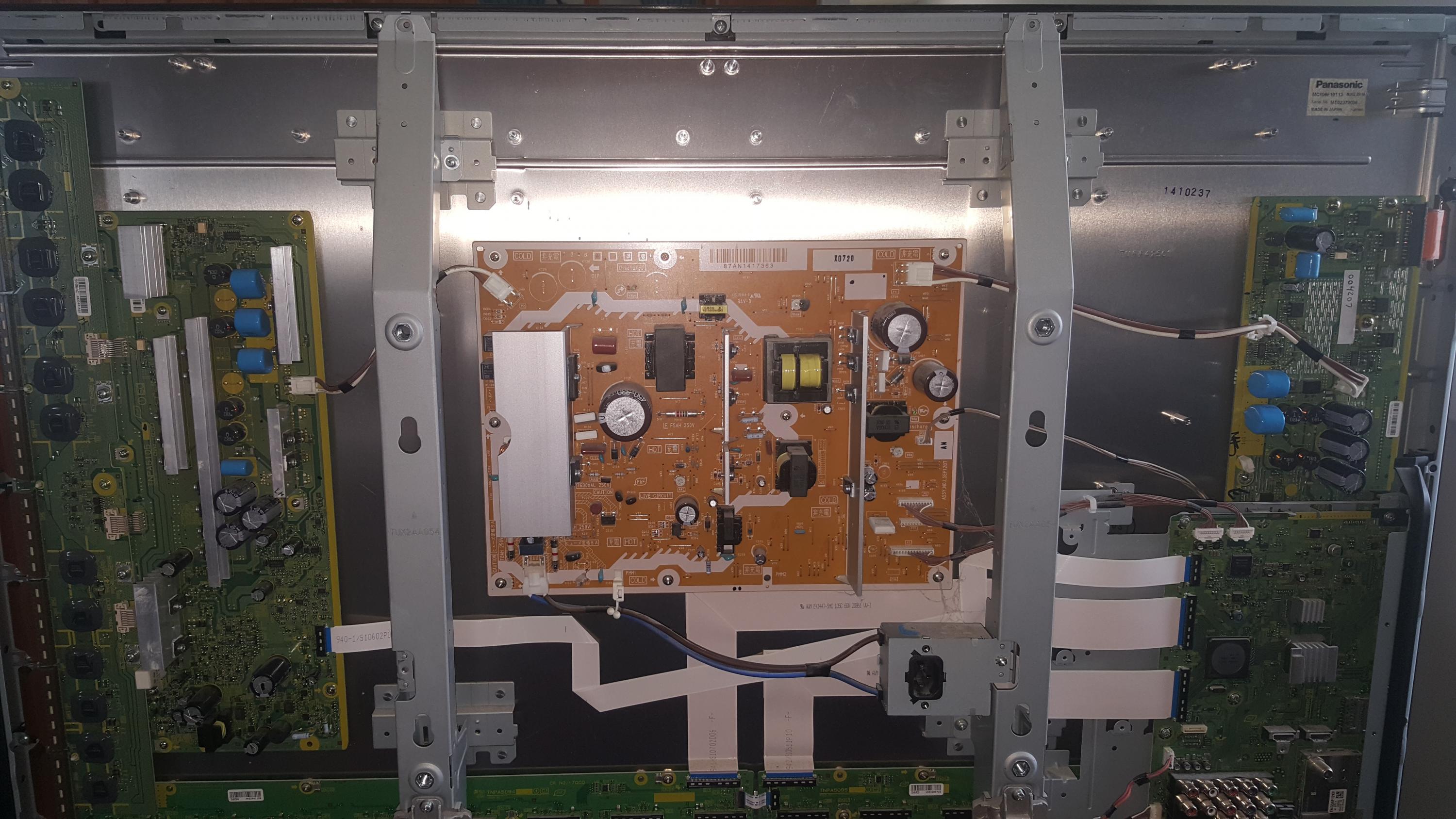

    I have a 42u2 with 10blinks replaced sc and ss. Buffers tested good. Removed cables still 10 blinks . Took voltage readings with TV plugged in and during power up.
    Connector P6 plugged in
    Pin 1 0v pin 2 0v pin3 0v pin4 0v pin 5 0v pin6 0v
    Pin7 15.73v pin8 15.73v pin9 15.73 pin10 0v pin11 0v
    Connector p6 plugged power turned on same readings as above
    Connector p7 plugged in
    Pin1 4.96v pin2 0v pin3 0v pin4 0v pin5 0v pin6 3.27v
    Pin7 0v pin8 0v pin9 0v
    Connector p7 plugged in turned on
    Pin 5 changes from 0v to 3.27v pin6 changes from 3.27v to 0v all other pins no change.
    SC ss vda connectors have no voltage present.

    Have you tested the SC and SS boards input connectors for shorts to ground first .
    • microvibe
      • Mar 2013
      • 275
      • canada
      Re: Panasonic tc-p42u2 psu or main issue
      I have and I have also powered on with them disconnected stays 10 blinks.

                Yes there is away to 'self test' the PSU. Disconnect all connectors from the PSU bd. P2 P6, P7 and etc.
                Connect two (2) 120Vac light bulbs in series. Then connect a 1k resistor across P7-pin1 labeled STBY5V and pin5 labeled F_STBY_ON.
                Connect another 1k resistor across P7-pin1 labeled STBY5V and pin7 labeled PANEL_MAIN_ON. Take the light bulbs previously connected in series and connect that across P2-V-sus voltage. Connect 120vac to the PSU. If the PSU is good the 120Vac light bulbs should glow bright. If you get the lighted bulbs, measure Va on connector P35...BE CAREFUL as there is the risk of shock hazard present.
                • microvibe
                  • Mar 2013
                  • 275
                  • canada
                  Power supply just clicks then clicks off again when jumper and with a board disconnected and bulbs hooked up no glow. I have 5v and 15v on psu so I guess problem is in vsus voltage circut

                                I swaped in donor power board no different swaped donor a board not same model was 54gt25 but panel lights up stays on but board is wrong for TV panel . Original a board does nothing but 10 blinks when u press power not 10 blinks plugged in

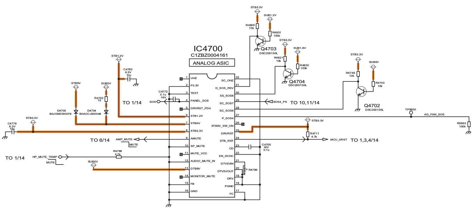

                                  Might be worth taking some readings around IC4700. Looks to be responsible for sensing sub voltages and triggering SOS. Awkwardly located on the back of the board unfortunately.
