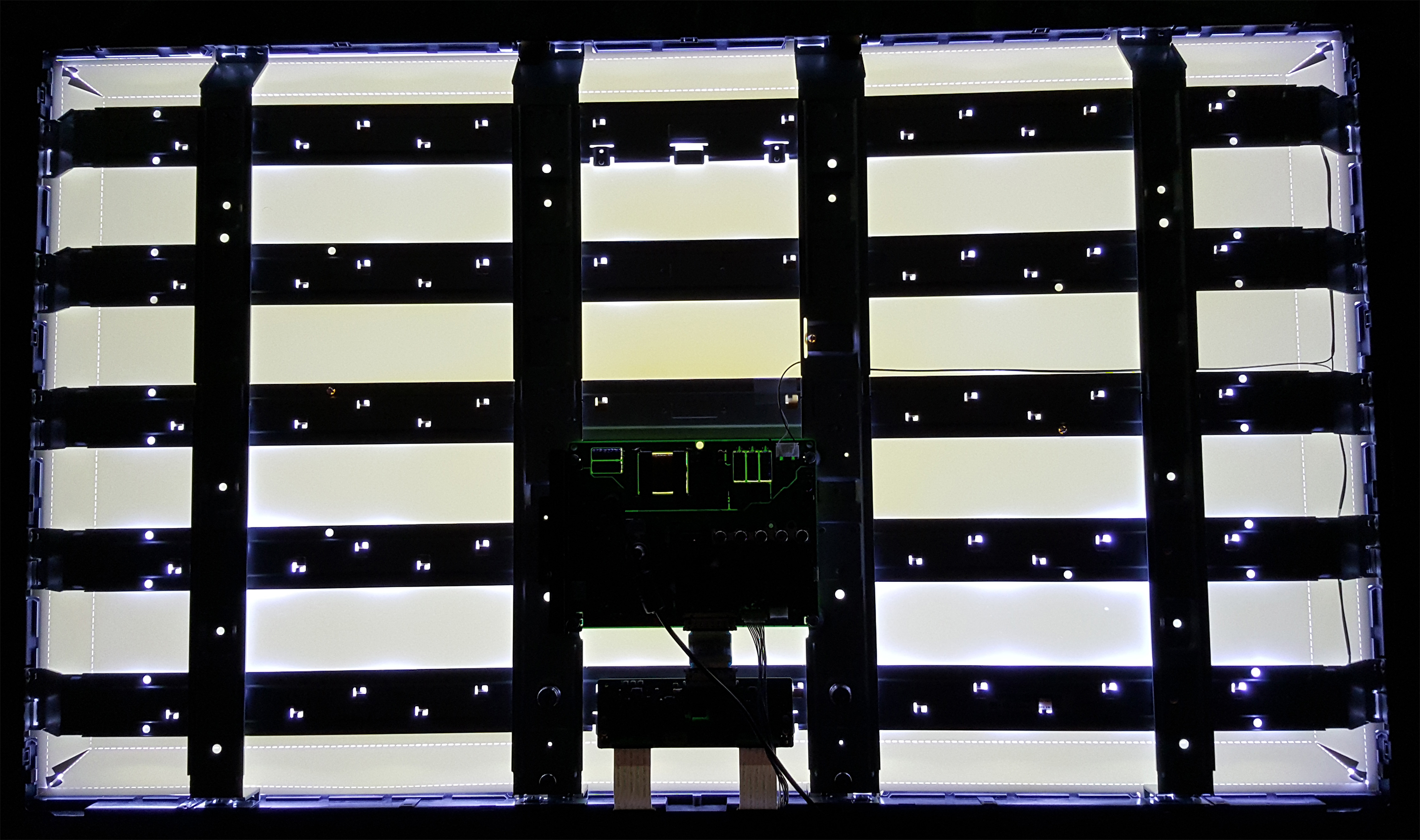

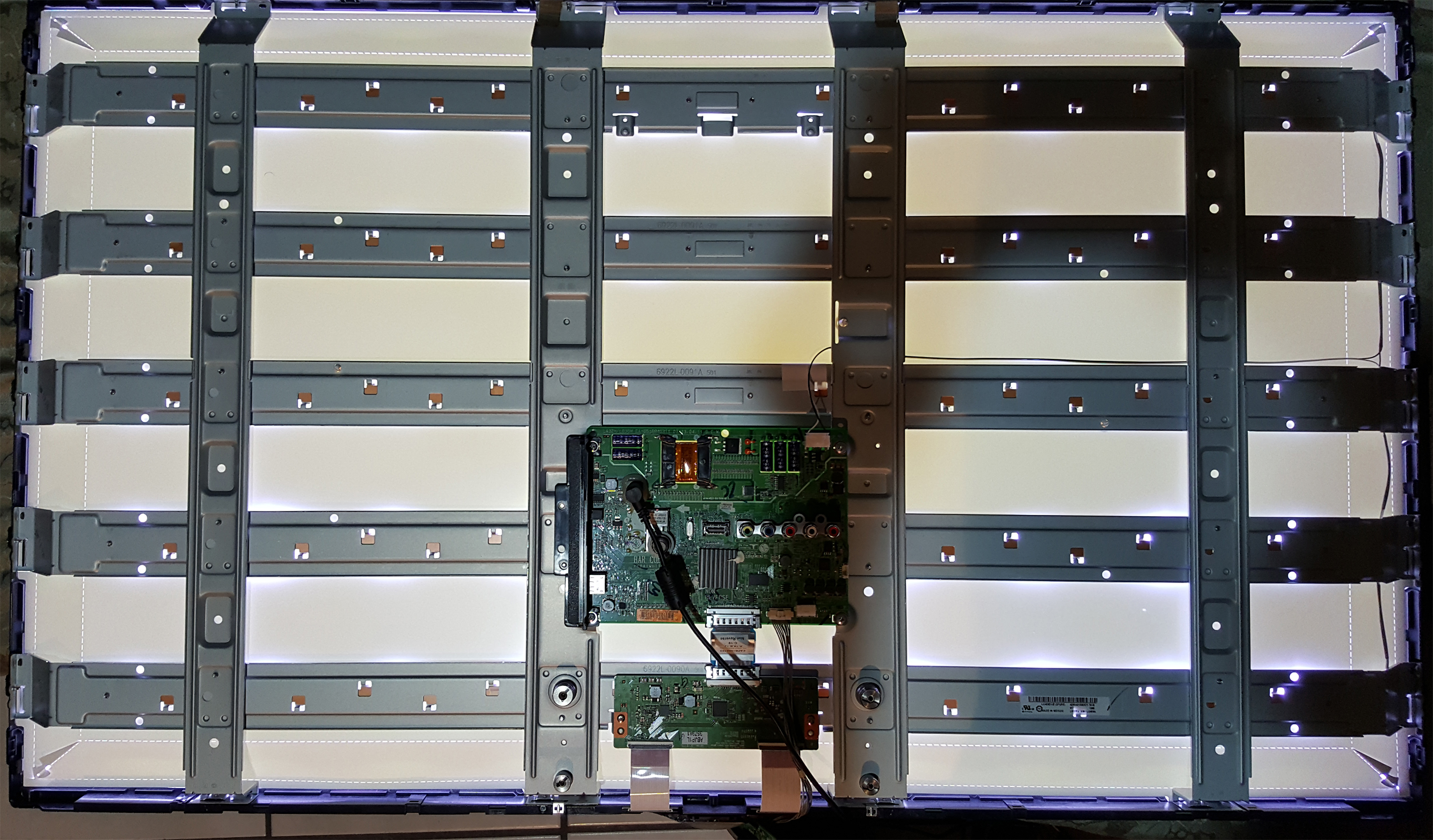

    I have acquired an LG 42LN5200-UM TV from a family member. I want to see if I can get some help finding out what's wrong and seeing if a repair is worth it. I was told that a couple of days ago when they turned the TV on, the only thing they got was sound. I opened it up and took some pictures with my phone, I don't have a real camera so I hope those will work OK.

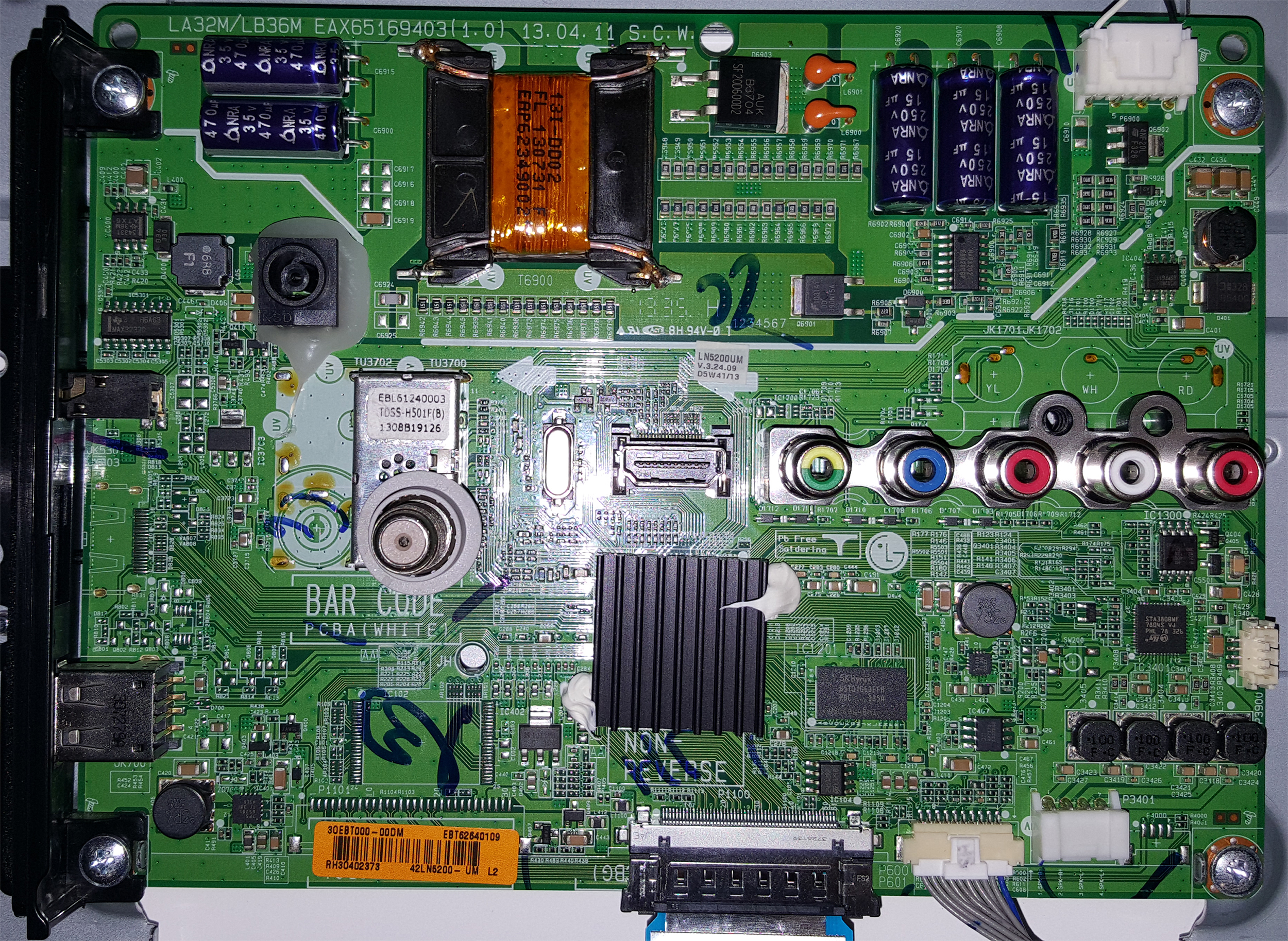

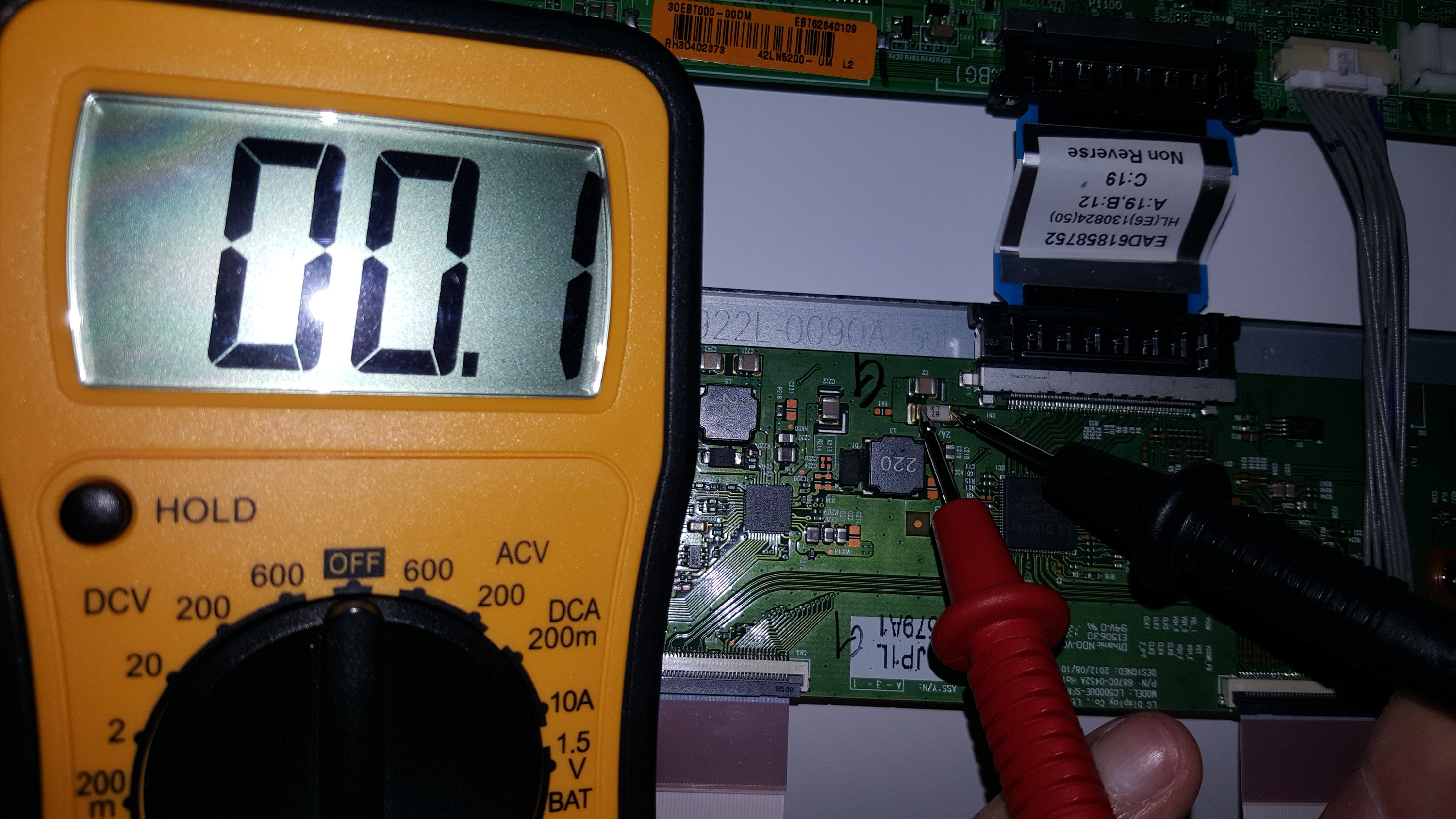

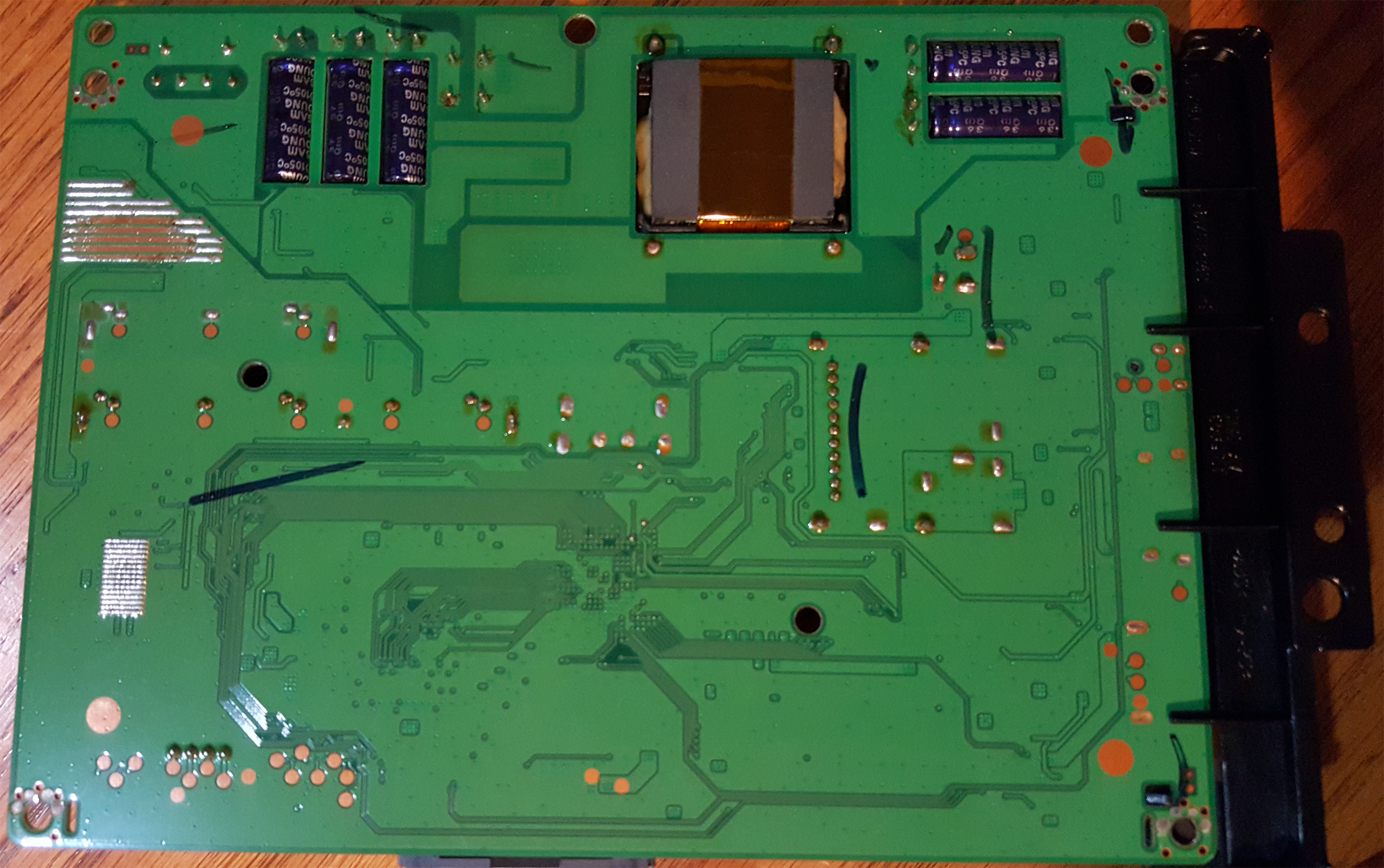

    I don't see any blown/bulged capacitors or any obvious signs of burnt components. The TV turns on, the backlight and sound are working and it appears to respond to inputs from the remote control. I tested the fuse in the t-con board and I get 0.1 Ohms, also tested it for continuity and it is OK. The only thing that I see is in the second picture, you can see some of the solder lines on the top left are missing; is that it?
    Any input is appreciated. My level of electronics is not that advanced. I only did two semesters of circuits in school, it was 7 years ago too. I am more on the software side of things but if you need me to do/test something, I'll do my best.

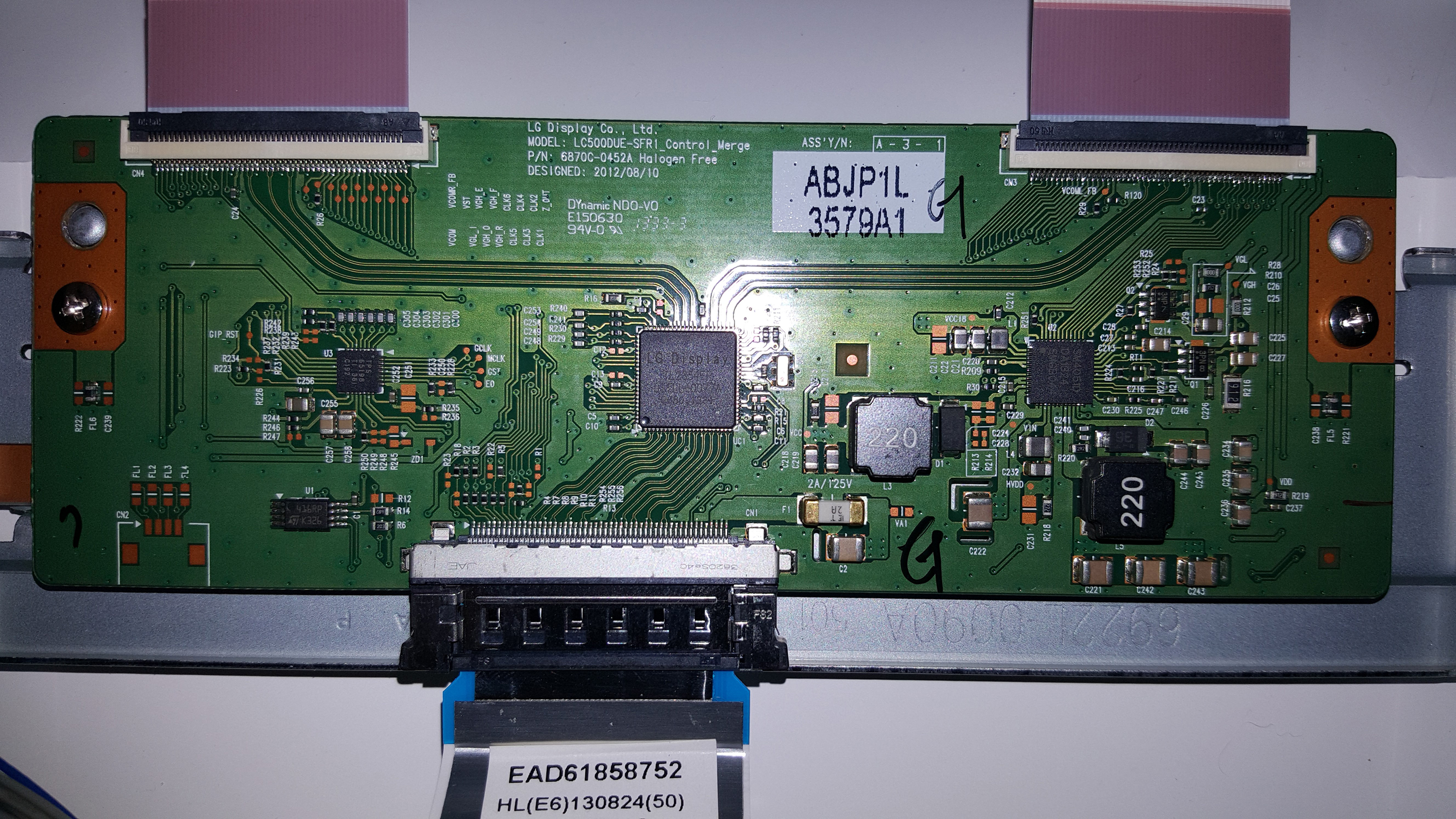

    On the TCON you have various test points.
    Post results for
    Vcc
    Vdd
    Vgl
    Vgh
      Re: LG 42LN5200-UM Has backlight, audio. No picture
      Thank you for the reply and sorry for the delay. I hope I am doing this right: Negative probe on ground screw, positive on test point while TV turned on.
      Vcc: 2.05v
      Vdd: 0v
      Vgl: 0.009v
      Vgh: 0v
      Vcc18: 0.97v

        They don't look to good. What voltage have you on both sides on the white ceramic fuse F1.
          TV on, negative probe to ground, positive probe in turn to each side of fuse.
          I have 7.99v on each side of F1

                  Which are the boards that matched your boards?
                  Since you are able to read the 24V power supply correctly then your meter is probably OK.
                  I believe you have at least 4 Buck converter circuits on that main board, and the Voltage for the T-con should be around 12VDC.
                  I also see some 3-pin Vreg ICs.
