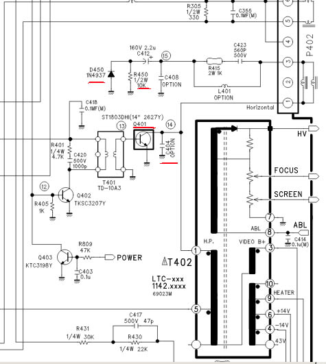

      I opened it but didn't power it up, so I didn't check voltage at I801.
      But I found a short circuit (B and E) in Q401.
      So I removed Q401. Out of the circuit, Q401 is not shorted.
      But the short on the board remains (at the pads where B and E of Q401 go).
      So I removed C404, the short remains.
      I checked C408, R450, D450 for short circuit, they are ok, but the short remains.
      What cold be the reason for this?
      I have put a red line near the parts in the attached image.
      EDIT: I took a second look at the schematic, I guess the short is normal because of the ST1803dHI, right?
      Should I power it up without the Q401 or is it dangerous?

        Re: Daewoo 14V1G S (chassis CP-185G/GU) won't power up
        There is no short circuit between B/E. You are measuring the resistance of transformer, point 13 to ground.
