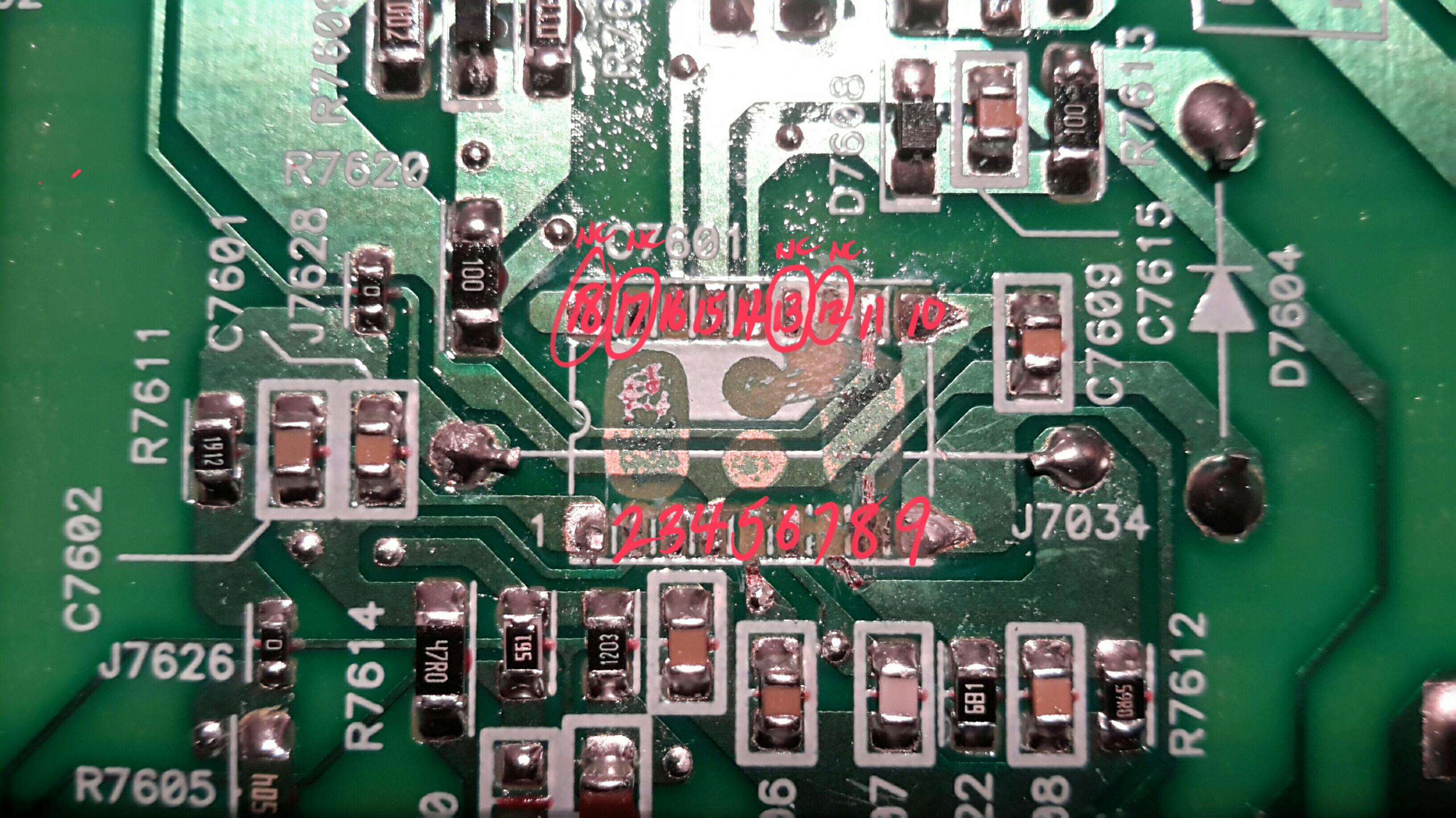

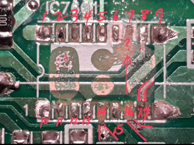

    Delta RUNTKA932WJQZ power supply for Sharp
    Does anyone know thesepoiwer supply's? I desoldered the 18 leg integrated circuit and had thought I had all the legs lifted ready to remove but 4 copper sot came off and I couldnt save the or even find 2 of them. Anyway, all but one I was able to scrape off the green solder mask from three of the traces leading to the spots which I can blob onto but the 7th on top in the picture shows no evidence of a trace. Does anyone have an idea why this is?

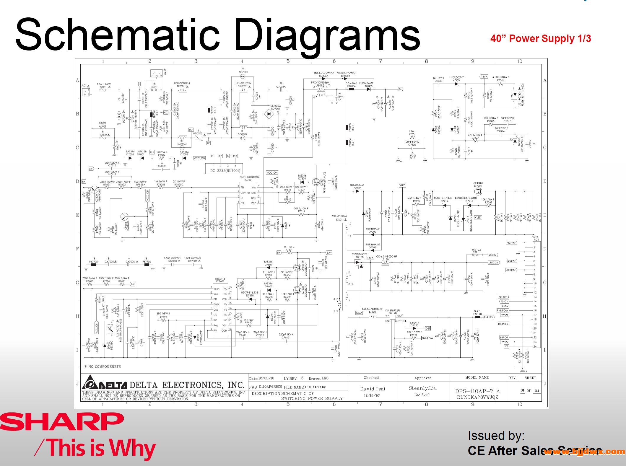

        Re: Delta RUNTKA932WJQZ power supply for Sharp
        The attached schematic showing a DDA014 should help in identifying which pins are or are not used.
          Thanks- with the correct pin numbers it appears 12,13,17 & 18 are "no connection" so those legs don't need to be soldered to the board and can be snipped back even?
            That's what it looks like. Yes.
