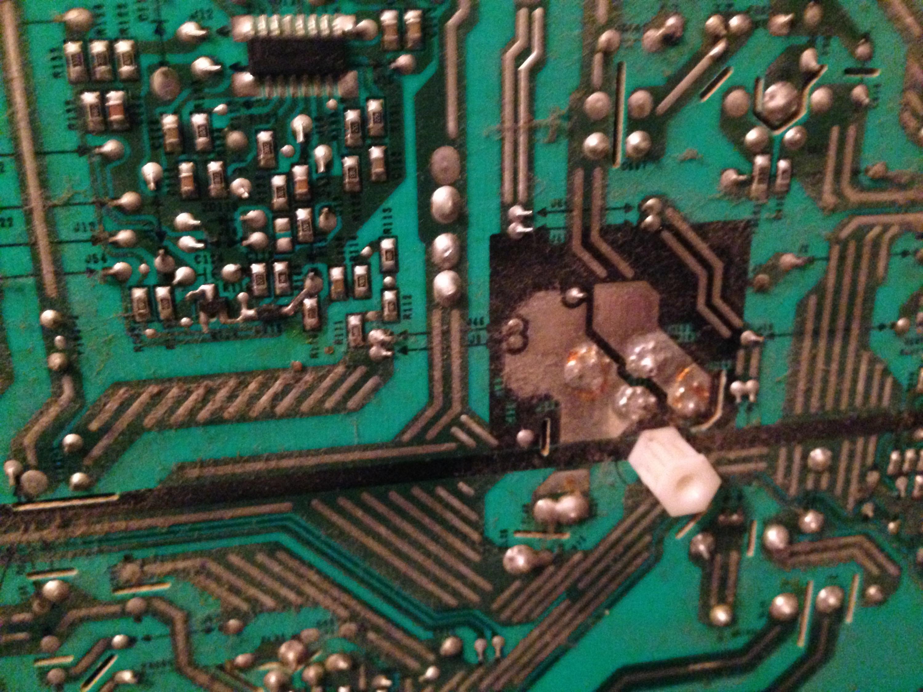

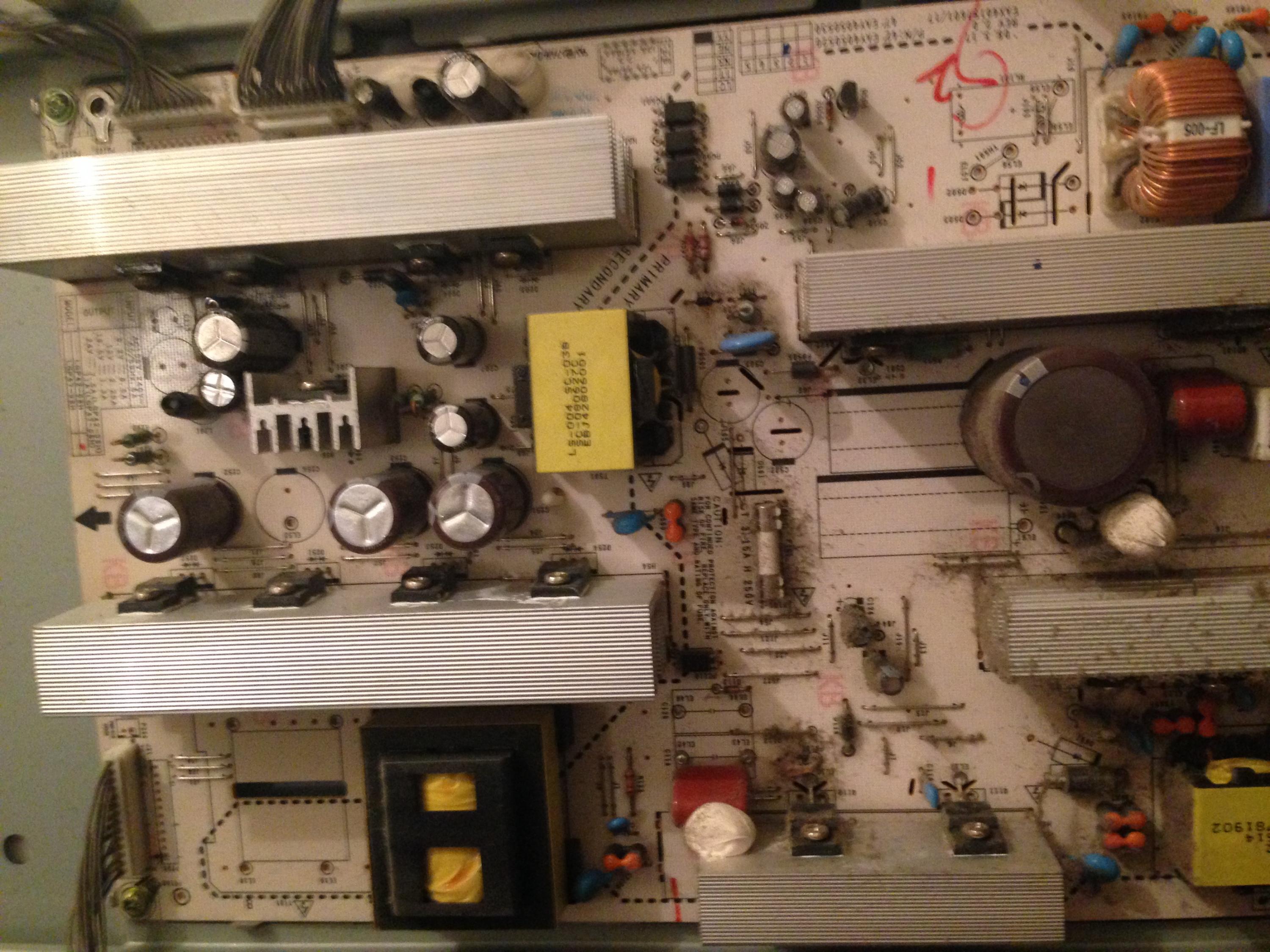

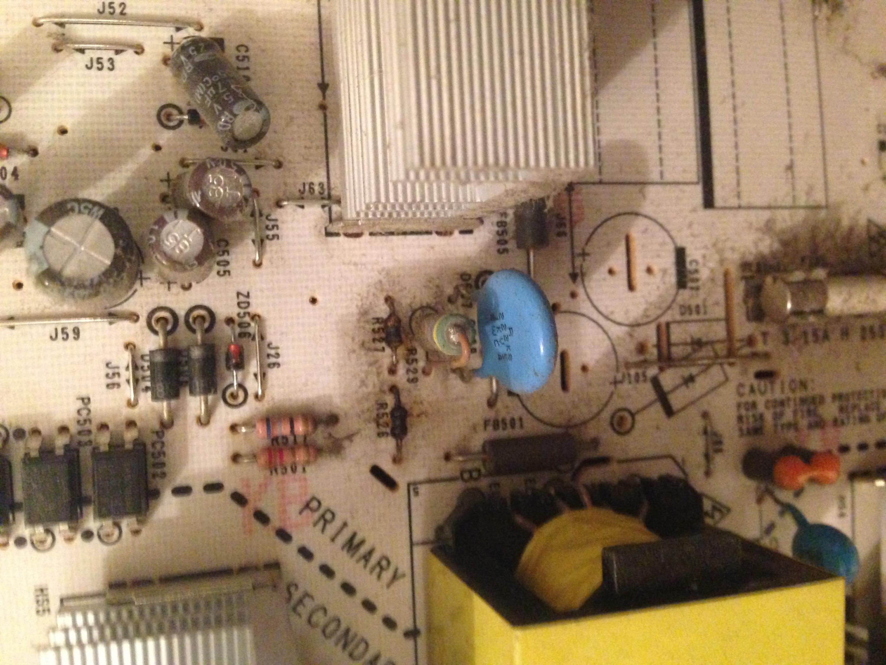

    Hi forum,I have not stated model but will re edit at later stage,yet another faulty TV set,on switching the television set on,it displayed a pure white screen,then I heard a crackle,I then briefly switched it off incase it blew my electric box,
    Left it a hour opened it up and noticed a couple of blackened out parts along with underneath the psu some kind of iffy soldering or is this normal for Lg,can I ask what would have caused this ? Was in dry storage

    Model is 42lg3000

      Re: Lg 42 issue
      Firstly I would check the gamma voltages across the tcon board
      but it may also be bad tab bonding issues

        Re: Lg 42 issue
        Checked mains fuse and other major parts for shorts using a DMM ?

          Re: Lg 42 issue
          Dare not switch it back on,might have to invest in a newer psu,
