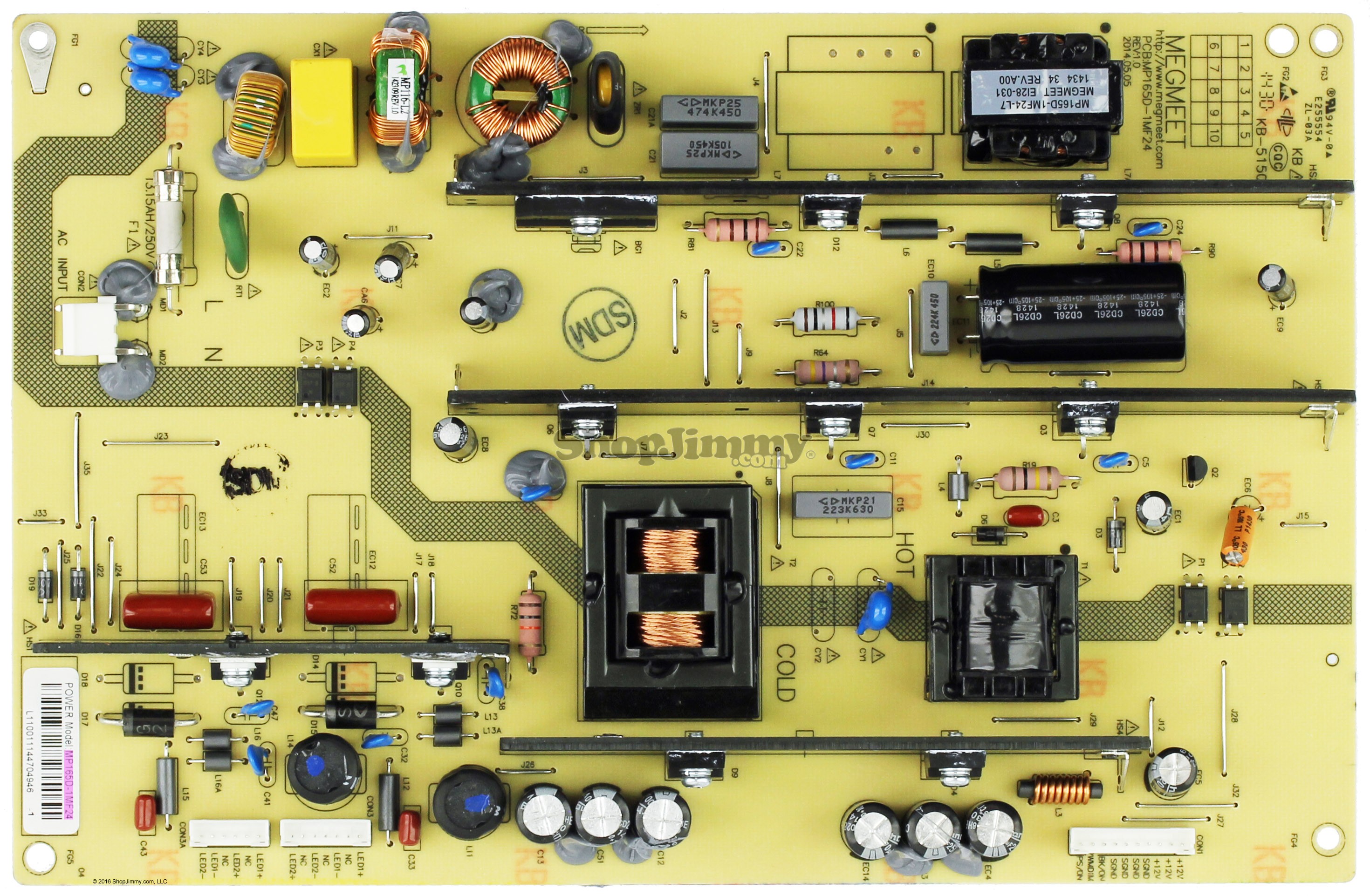

    I am able to test both led circuits with a LED tester. Powering the LEDs when the set is on shows an image on the LCD. So even though I'm getting voltage on the power supply, I'm thinking the supply is bad. How can I further test the power supply other than voltage at the connectors? Thanks, Jim

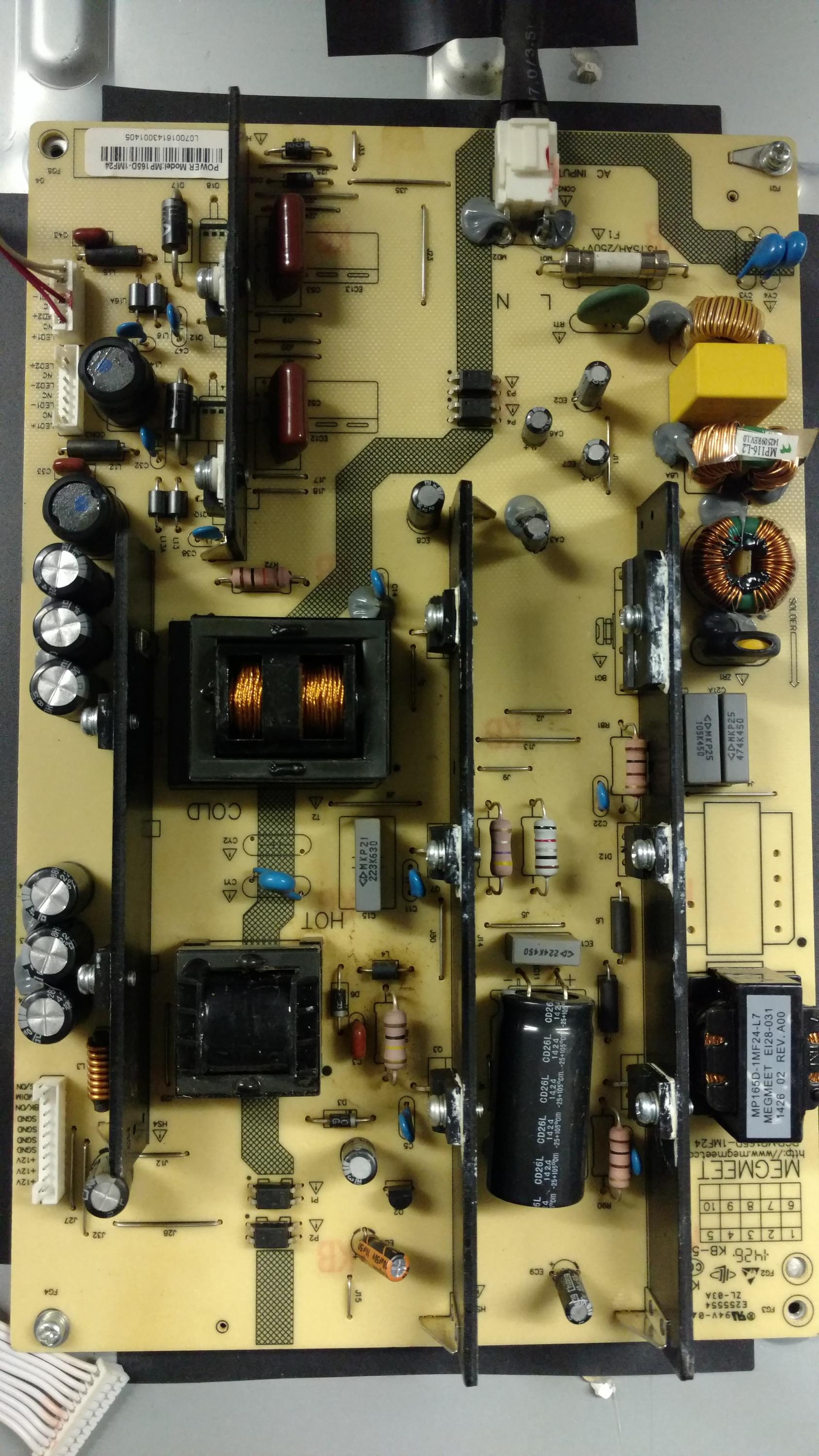

    Attached is an image of the power supply:

          Oh and yes only one led connector. I haven't opened the panel but the the led connector wire is taped and looks intact. Maybe power supply?

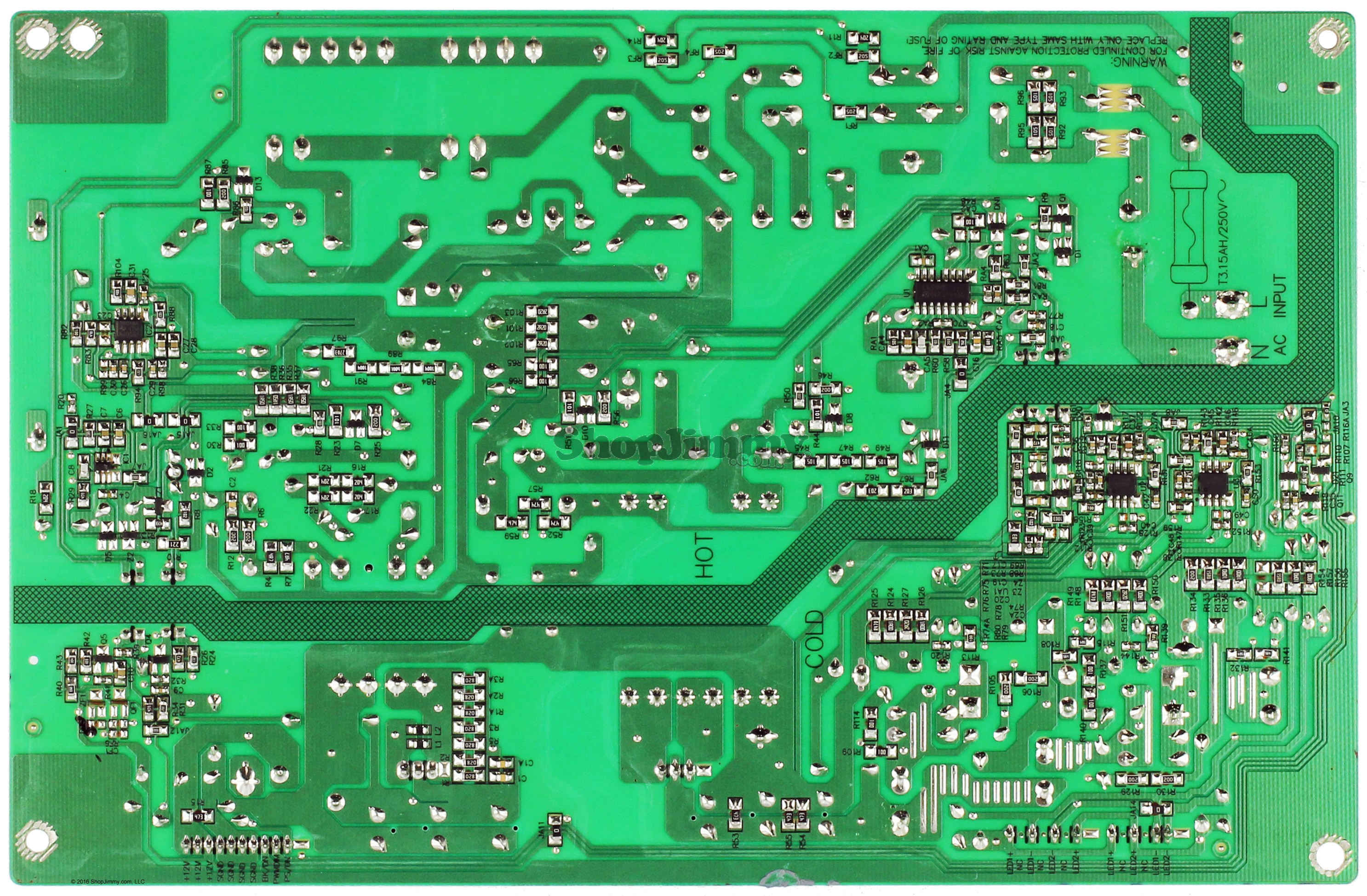

            OK, I found good pictures of your board at shojimmy.
            Hitachi MP165D-1MF24
            http://www.shopjimmy.com/hitachi-mp1...er-supply.htm#
            The two LED connectors are connected in parallel so there is no problem.
            We need the DCV of filter cap C13 by the LED connector, we need to see if it also has about 66VDC at that cap too, if it shows 66VDC too then the boost converters are not working.
            What kind of LED tester you have?
            Pictures provided by shopjimmy.
