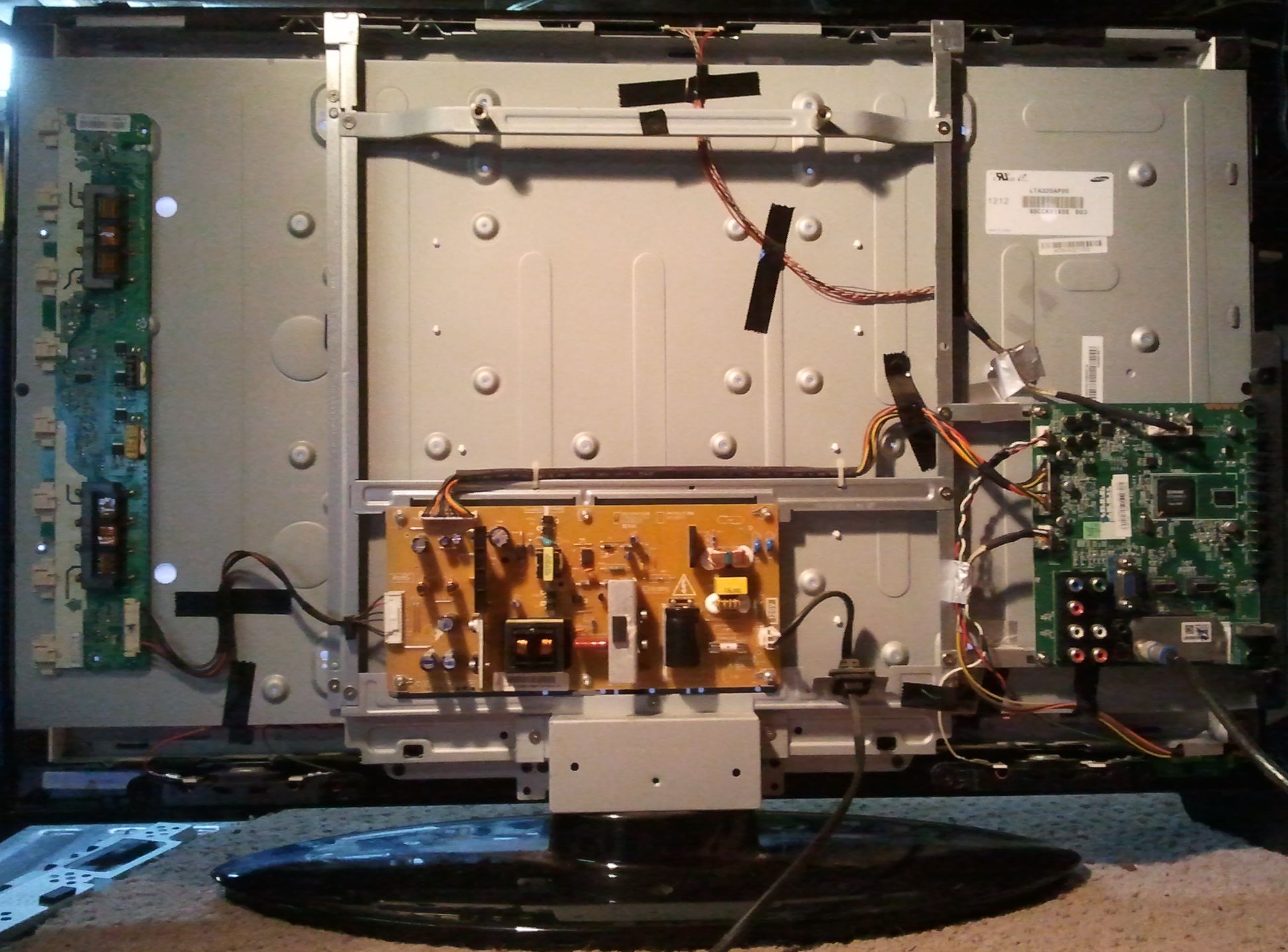

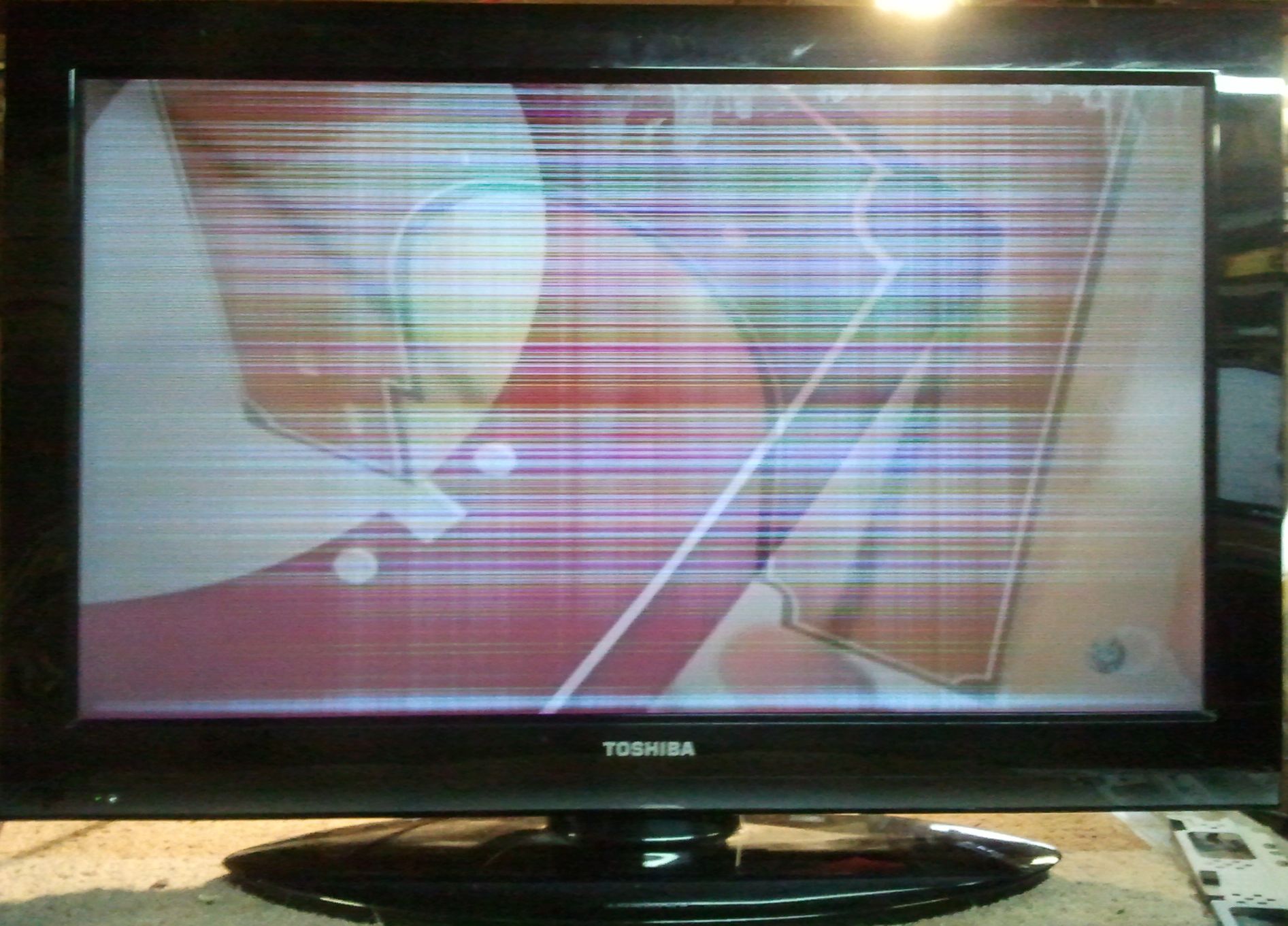

    I have a Toshiba 32C120U that has a normal LCD screen when turned on.
    After a about a minute horizontal lines begin to appear on the screen which eventually covers the full screen with mainly horizontal lines with ghostly vertical lines.
    I would appreciate knowing if someone has seen this problem before and can tell me a solution or if someone has any idea what is causing these lines to appear on my TV?
    Thank You

    Re: Toshiba LCD TV horizontal lines
    The problem is between Tcon and the panel connections, but the first is integrated so you cannot do near anything.. apart trying to preheat the tcon in many points and see when pops up the defect, if you have luck you can isolate the culprit.

        Do you where I can get a diagram or schematic for the
        Tcon and the panel connections on this TV?
        Toshiba 32C120U
        Thank You
        • Davi.p
          Hobbist Tech
          • Sep 2009
          • 4537
          • Italy - Milan
          There's only few schematics out there on net about some models of AUO panels, yours is a Samsung panel so nothing..
              You may be able to apply the Cut-off Method......but your soldering skill has to be good as you may have to re-solder cut lines in the process.
                        it is unlikely that multiple horizontal lines on a set is a side driver issue and is more likely some other component such as a tcon or cabling. Look very carefully at the cabling first to ensure that it is properly connected ... if in doubt, clean the connections / connectors. IF the tcon is replaceable, then it is also a possible candidate. Since your problem appears to be "time sensitive", perhaps using a heat gun / hair dryer to direct heat towards a portion of the card / set / connector might yield a clue as to where the problem lies.
                        further disconnect one cable at the tcon, input a well known signal to the set, what happens? try a different cable. Go from there.
                            Since the T-CON is not replaceable and there are no external side drivers look at the T-CON/Driver Bd again and see if there is any possibility of a slightly couching component to the chassis or metal. You issue does seem heat related and therefore the TFT in the Panel could be overheating with time also indicating a Bad Panel.
                              what is "couching"? Anyway if you at tv cold, heat the glass ic's on the tabs before switching on, with hairdryer, you see if are them faulty , if yes, remeber, i saw on youtube, just in Canada it exists a lab. that changes those faulty tabs..
