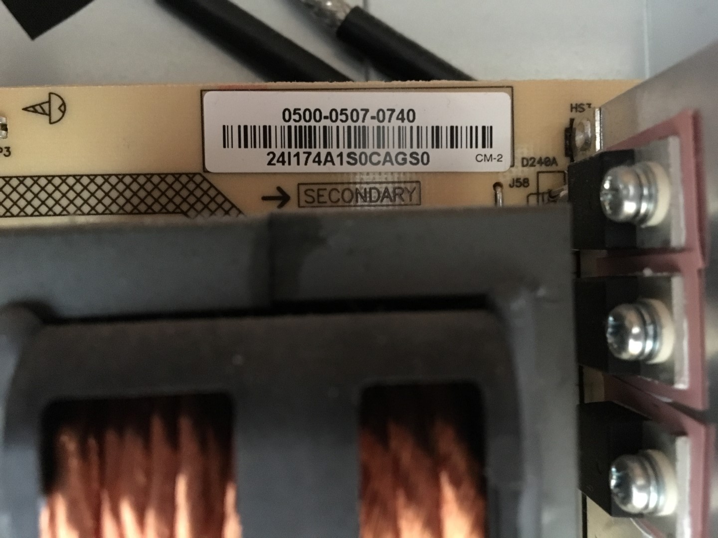

    Power Supply: 0500-0507-0740

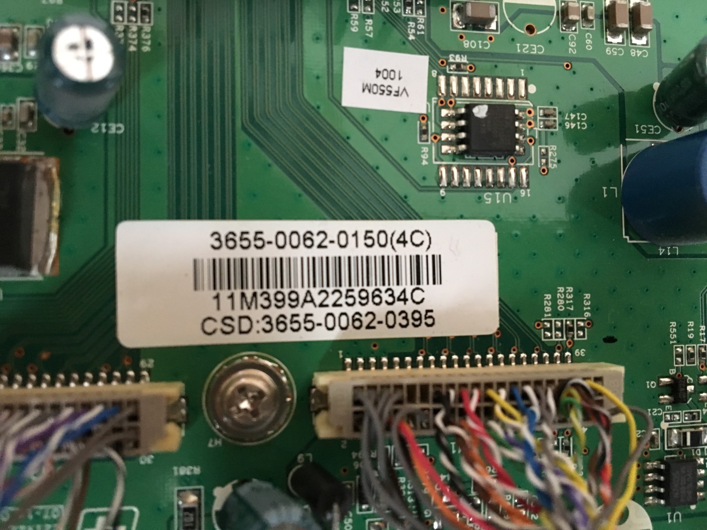

    Main board: 0171-2272-2964 or 3655-0062-0150(4C)

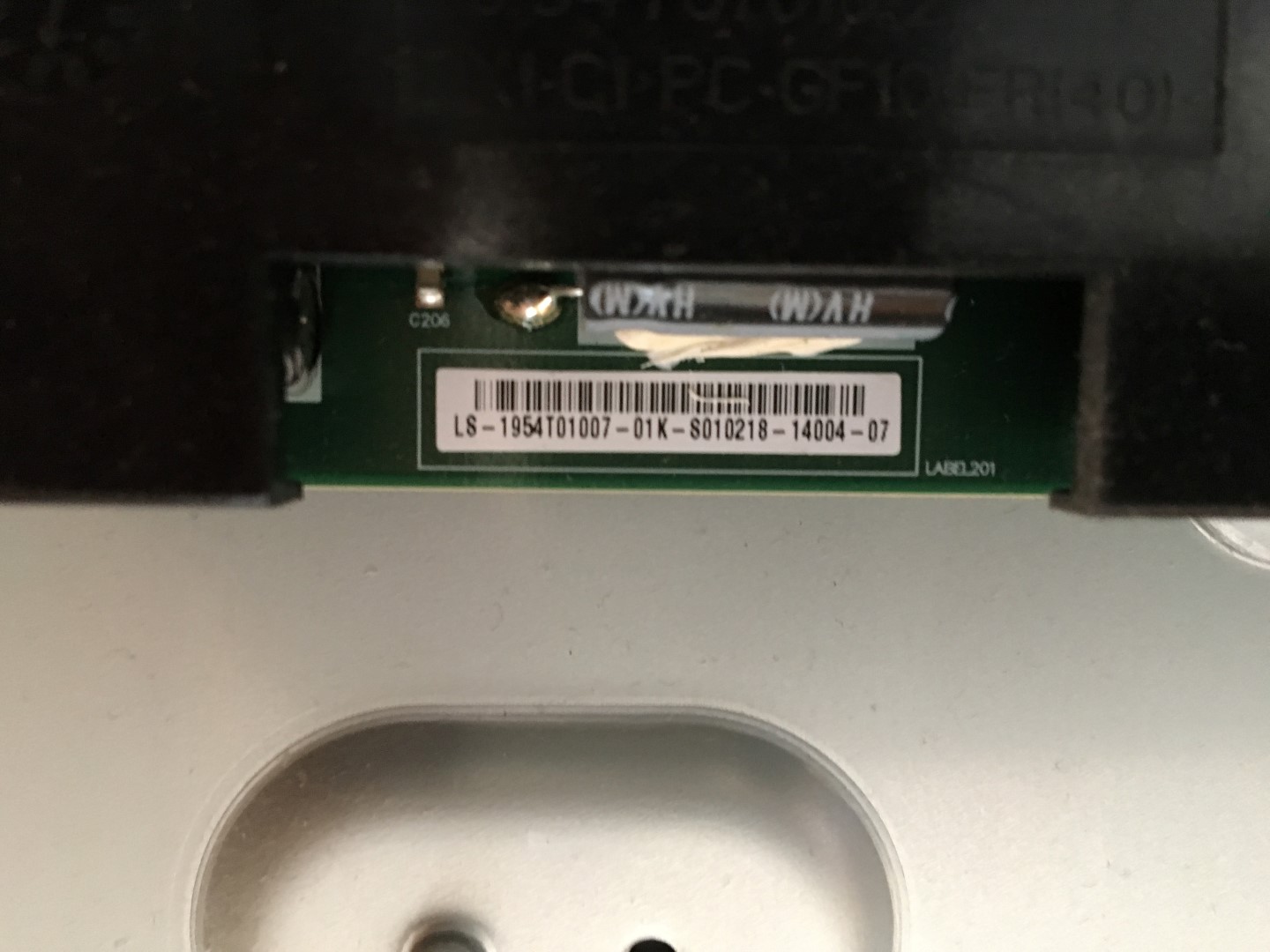

    When plugged in, the Vizio logo on the front is illuminated orange. There is no response from the unit when the on button is pressed via the remote or the manual on/off button on the side of the unit is pressed. The Vizio logo does not glow white and there is no other response from the unit.

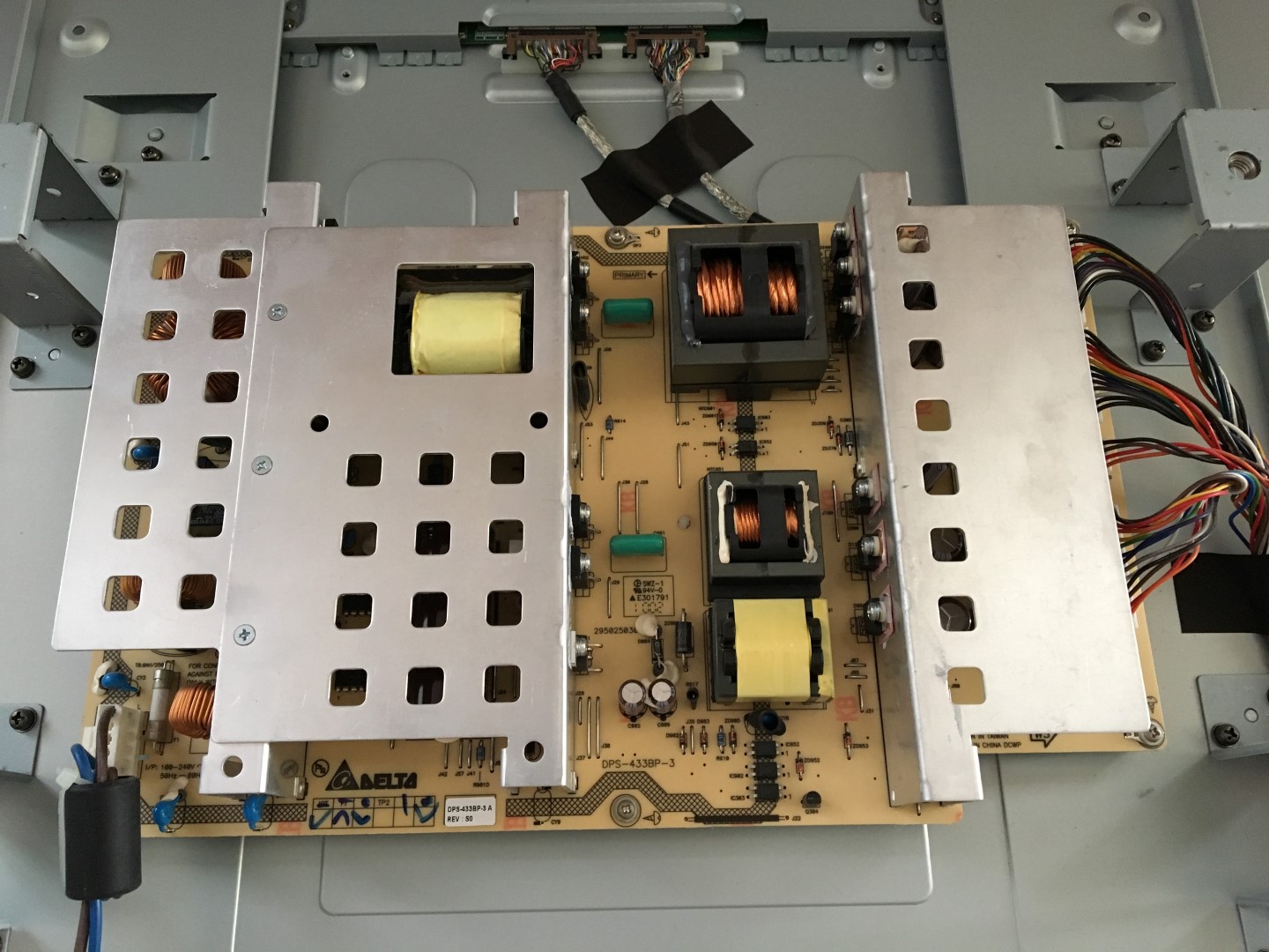

    I first checked the power supply board:
    It looks like there is a single fuse on the power supply board. I tested it with a multimeter (in circuit) and I measured 0.1 ohms. It looked like I might have to unsolder it from the board to test it out of circuit, and I did not want to remove the board from the chassis at this time. I placed a jumper across it and turned the TV on. The effect was the same. The Vizio logo was illuminated orange but the TV would not turn on either via the IR remote or the manual button on the side of the unit. I then removed the jumper.
    The power supply board appears to be on as there are output voltages. It also appears that the PSON signal is active. I took some measurements with a multimeter:
    CN5 connector: measured 5V standby, 12V, and the PSON measures 3.16V
    CN4: measured 18V where indicated
    CN3: measured 24V where indicated
    CN2: measured 24V where indicated
    The PSON voltage remains at 3.16V when I depress the manual on/off button on the side of the unit. It appears that the PSON signal is active and the board is on. I have read that PSON is active at approximately 3.2V.
    I have seen a YouTube video which says that there is a secondary enable which goes from one of the inverter boards, to the power supply board, which tells the power supply to turn on fully. Is this correct? What pin is would I check on the Power Supply board for that signal and what would be the voltage?

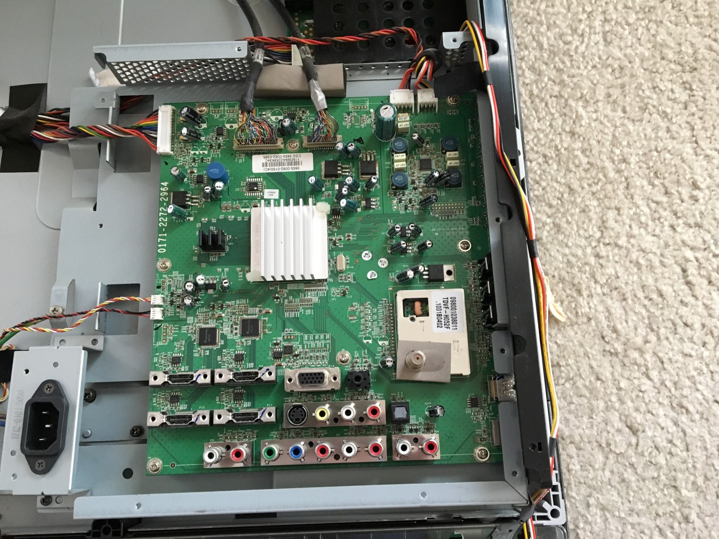

    I also checked the three small fuses on the main board. I checked them in-circuit. They all measured 0.1 ohms. I have not checked any LDOs.
    I am wondering where to go from here. Suggestions? Thanks for any assistance. I will attempt to upload some photos of the unit with this post.

            Re: VF550M - orange logo only; power supply appears good
            To respond to budm,
            Here is what I have tested on the main board:
            I checked the fuses; F1, F2, and F3, in-circuit, with no power applied. Each read 0.1 ohms.
            I then checked what look to be voltage regulators. I measured the voltages of each pin to chassis ground.
            U8 (7805CT / RAD949G)
            IN: 11.96V
            GND: 0V
            OUT: 5.04V
            U3 (1084 / 0931gL)
            GND: 2.06
            VO: 3.31V
            VI: 5.08V
            U5 (1084 / 0931gL)
            GND: 2.05
            VO: 3.31V
            VI: 5.08V
            U9 (1084 / 0931gL)
            GND: 0.55V
            VO: 1.8V
            VI: 3.30V
            The values on U9 look somewhat suspicious.
            Regarding the history of the TV, I am the original owner. The unit was purchased in 2010. Two years ago, the HDMI1 input ceased to function. I had the inputs assigned as follows:
            HDMI1 : DirecTV
            HDMI2 : Chromecast
            HDMI3 : DVD Player
            HDMI4 : open
            HDMI5 : open
            Once HDMI1 failed, I moved the DirecTV box to HDMI4. I have had no problems since this was done.
            Friday night, I tried to watch a DVD and noticed there was no signal on HDMI2. I took the DVD player and cable and tested them with a second TV. They worked fine. I then tried plugging the DVD player into HDMI4, but there was no signal. This was very strange since the DirecTV box was using this input just minutes before, and it was working fine. I unplugged the DVD from HDMI4 and plugged in the DirecTV box again. I had a signal on HDMI4 as expected. Each time I unplugged/plugged a source in, I would power down the TV and source, unplug/plug the source unit in, and power on the TV and source.
            I then plugged the DVD player into HDMI2 once again, but this time the TV was on, as was the DVD player. Once I did this, the TV shut off, and it's never been on again. I guess the "hot swap" I did with the DVD player and TV both being turned on was not a good thing. As I noted though, there were some strange things going on with the TV prior anyway.

                It appears I missed some of the regulators on the main board. Here are the voltages measured with respect to chassis ground.
                U2 (9ub / 1117)
                ADJ : 2.06V
                OUT : 3.31V
                IN : 5.11V
                U4 (9ub / 1117)
                ADJ : 0V
                OUT : 1.24V
                IN : 3.31V
                U6 (9ub / 1117)
                ADJ : 6.85V
                OUT : 8.09V
                IN : 11.97V
                U7 (9ub / 1117)
                ADJ : 2.05V
                OUT : 3.30V
                IN : 5.08V
                U45 (9ub / 1117)
                ADJ : 2.06V
                OUT : 3.31V
                IN : 5.08V
                  Those Voltage readings are correct, the output Voltage of the adjustable regulator = 1.25Vref + Vadj
                  I.E.
                  U2 (9ub / 1117)
                  ADJ : 2.06V
                  OUT : 3.31V
                  IN : 5.11V
                  1.25Vref + 2.06V (Adj) = 3.31 Vout
                  I suspect something is going on in the HDMI section that is stopping the main board to function properly.
                  • ecking767
                    • Oct 2009
                    • 492
                    Those volt measure are good but, in standby mode all of the regulators shouldn't be active, U9 shouldn't be active.
                    so you could a bad eeprom or a CPU related problem
