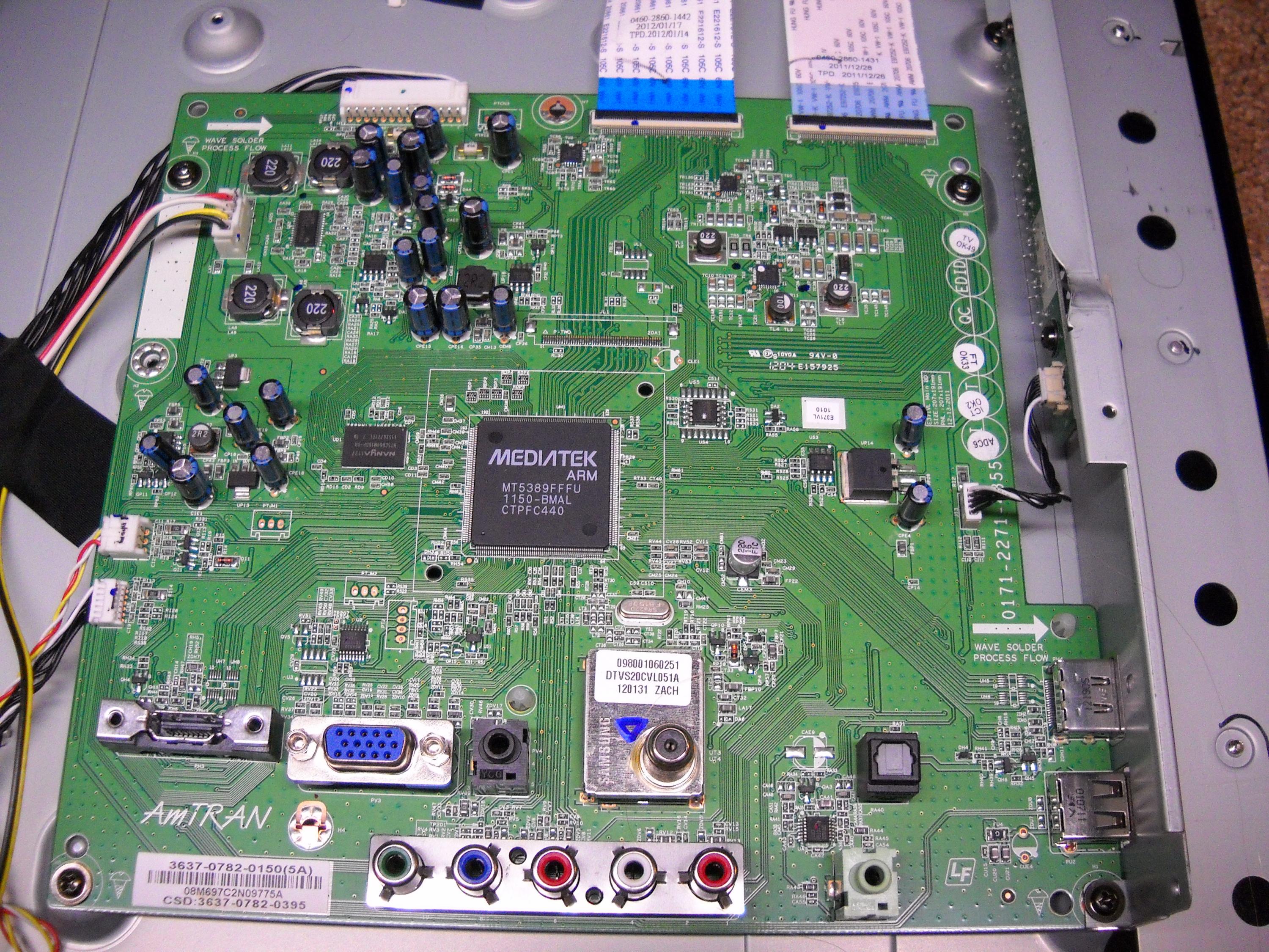

    I've scoured this forum and several others for other E-series Vizio TV's and it seems I've got something unique going on here. I think the way this TV killed itself might grant insight into what went wrong, but I'm hoping some of the folks here might be able to confirm my diagnosis!
    I picked up this TV a few days ago off the curb (a promising start, I know!) When I plugged it in everything looked fine--I had full access to the settings menu, IR panel is functional, and all of the buttons worked fine. "Why would somebdoy throw out a perfectly good flat-screen?"
    I connected a computer via HDMI. The only thing notable at the beginning was that the speakers weren't working, though that may have been a configuration problem on the computer.
    When I played a video at full screen the screen started cutting to black at 'random' intervals. This problem got worse the longer it was plugged in.
    Things got weird when I switched to VGA.
    • If a solid black image was placed in the top left corner of the screen (about a 1"X1" square in-set about 1" from the edges), the entire screen was perfectly fine
    • If the same image was completely white, the entire screen went completely dark
    I switched back to both HDMI ports and the same behavior happened there--random screen cutting to black for a fraction of a second before coming back up.
    I left the TV plugged in but turned off for ~1hr, then turned it back on. At this point the HDMI was crashing completely and the computer was losing the TV as an input. When I tried to turn the TV off, the stand-by power cut out altogether. I left the unit unplugged until this morning.
    This morning the screen is exhibiting a "2-seconds to black" behavior. After a hard power reset the stand-by power came back on. When I hit the power button the amber turns white and the "V" logo pops up for ~2 seconds, then the screen goes black and the unit cuts back to amber.
    I visually checked all the caps and tested all of the fuses and resistors, nothing looks fried. Stand-by voltage looks fine, I didn't get to test full voltage (I'll need another pair of hands for the 2-second window to test that).
    Like I said, let me know what you think! I won't color anybody with my own theories yet, but I'll be sure to follow up if I come up with a solution!

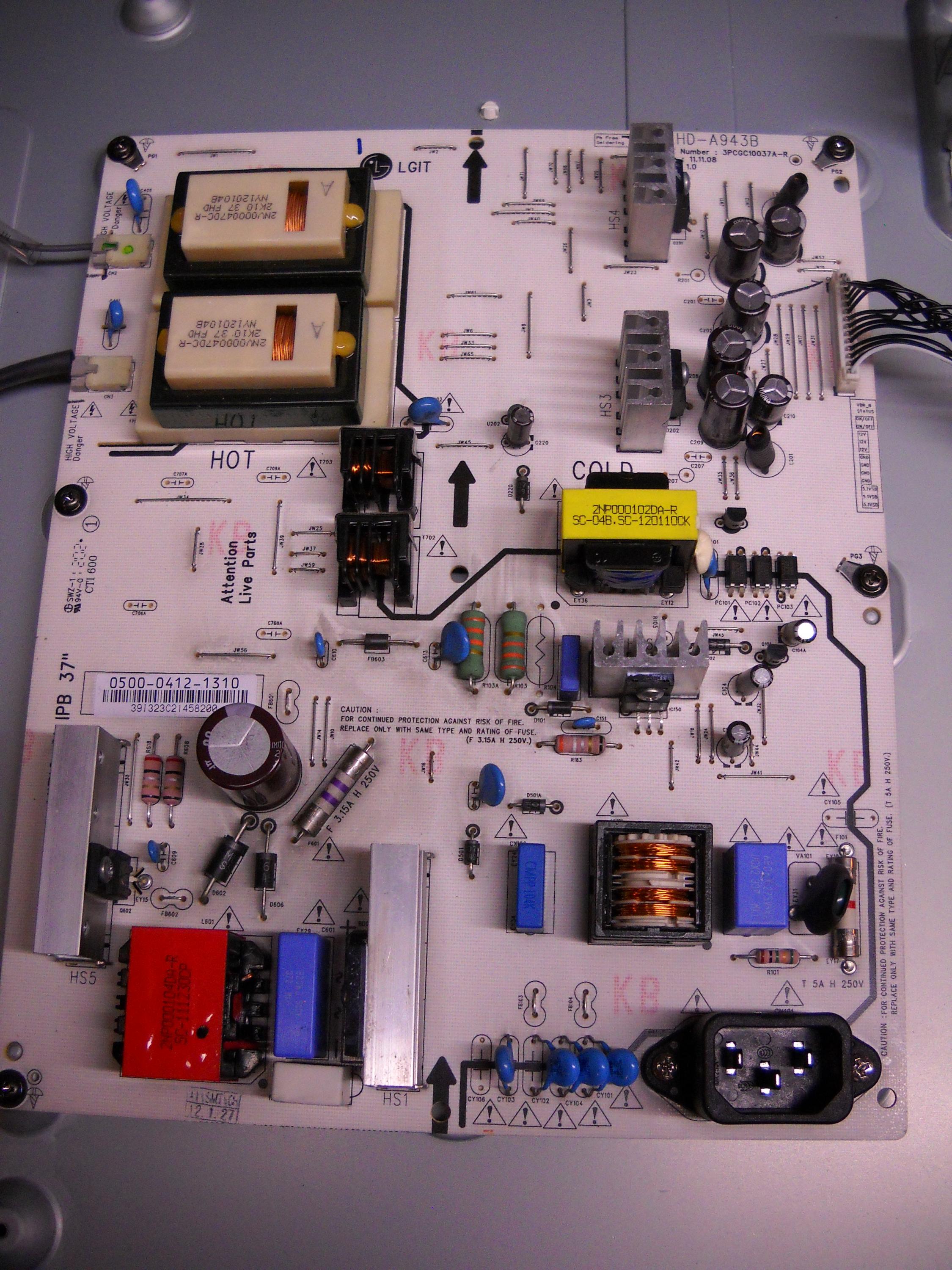

    Post a high resolution, straight shot picture of your main board. That set has like a half a dozen different main boards.

      Pictures attached

              Put some cooling fan on that Mediatek ARM IC and see if that behaves better.
              Next time the unit doesn't boot, freeze the EEPROM with a can of air upside down, then turn the TV on.

                  the HDMI signal going funky is the Mediatek chip. Look how the trace is going from the HDMI directly to the Mediatek IC.

                      try cooling it with a fan first, then reflow, after that either new board or new IC.
                      Not booting may be a EEPROM issue. So maybe it has 2 quirks. So if it doesn't boot, take a can of air upside down and freeze the EEPROM good. Then turn the TV on with the EEPROM frozen. If it comes back, you need either a firmware update or a new EEPROM.

                            Finally got a chance to freeze the chips. The TV had been unplugged for ~2 days so it was functional when I turned it on.
                            Worth noting--the computer I used to connect to HDMI detected the TV as an output whether or not the TV was turned on.
                            While displaying HDMI on the screen I froze the EEPROM--no apparent change. Shortly after I started chilling the main chip the image cut out, the computer lost the HDMI output, and the TV powered down.
                            So, it looks like this is a main chip problem. I don't have the equipment to reflow at my apartment, and the only thing I can get my hands on is a heat gun which is a bit barbaric.
                            It seems odd to me that the chip would have errors both when it has been on for an extended period or when it is chilled. What exactly would be causing that problem?

                                You only need flux, solder and a soldering iron to do the Mediatek IC. However I have a feeling that it won't help.
                                • DoorOfTime
                                  • Jan 2017
                                  • 18
                                  Re: Vizio E371vl--Decline to failure (diagnosis?)
                                  So I finally got around to reflowing the mediatek chip this weekend. After being turned off since my last post, I reflowed the VGA side of the chip (which I had solder bridged before).
                                  The TV worked for a good half hour on a VGA input. I tried to switch to an HDMI and the same old behavior cropped up--power cycling, standby ticking off, etc.
                                  I reflowed the remaining sides of the chip and it kept behaving the same way, until... standby power cut out for good. There was a faint but audible crackle (was that there before?) with the TV plugged in, and 125V AC was going over R101 which was unsurprisingly cooked.
                                  I replaced the resistor and unthinkingly plugged it back in for just long enough to see smoke coming off my new resistor as flux burned off.
                                  The only other component that looks like a short is FB603--does anybody know what that component is supposed to be? No marking on it, though it looks like it may be cooked too.

                                        Looks like I lost the 12V rail but not the 5V rail. Still haven't tracked down my faulty component, open to suggestions.
