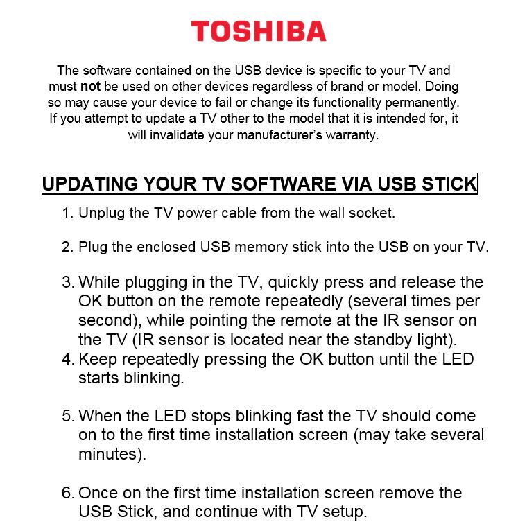

Name:	Toshiba update via USB.jpg
                                  Tv stuck on Toshiba Splash screen.
                                  Guys here is the Software provided by Toshiba. ## Can someone help as I keep getting - Error: PHP Max Post Size has been exceeded. when trying to upload zip file, thanks ##
                                  Toshiba: 55T6863DB
                                  Mainboard: 17MB130S - 23495635
                                  Panel number: VES550QNYL-2D-N01​
                                    SMDFlea commented
                                    Editing a comment
                                    Splitting the attachment might fix that
                                • StephenU
                                  • Dec 2013
                                  • 230
                                  • United Kingdom
                                  #1657
                                  ok will try that now, Thanks

                                    Still exceeds file size for upload. When zipped file size is - 171 MB
                                    • lotas
                                      • Jan 2016
                                      • 4718
                                      • Russia
                                      #1659
                                      When archiving a file there, you can divide it into parts (part 1, part 2, ...) of a given size or upload it to the cloud and post a link to it.
                                      • StephenU
                                        • Dec 2013
                                        • 230
                                        • United Kingdom
                                        #1660
                                        Sorry, I don't have the winzip program on this computer at the moment, only the built in windows zip program. Here is the Link to the Files if someone could kindly download and maybe upload to here?
                                        https://we.tl/t-PUefOOT7Yf
                                        Many Thanks,
                                        S.
