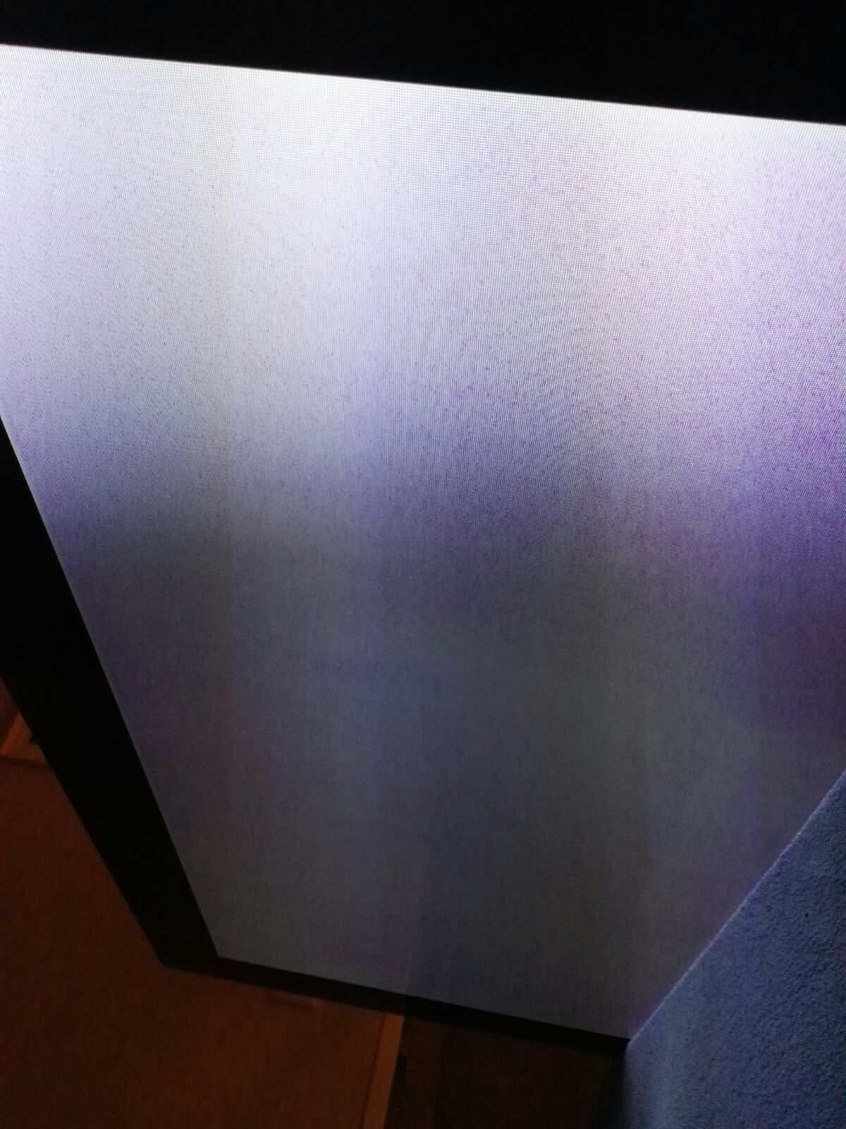

    First time that i got a 65 inch tv , boards are different compared to 42/50 inch. The tv is "dead". With the mains plugged in the relay clicks one time but the tv won't turn on with the remote/power button. Already figured it out that the mainboard is the problem. I put a 50VT30 mainboard in and the tv turns on but the image is all negative/purple. Makes sense as its a 50 inch mainboard in 65 inch tv.

          Can you give us picture of the error, purple image?

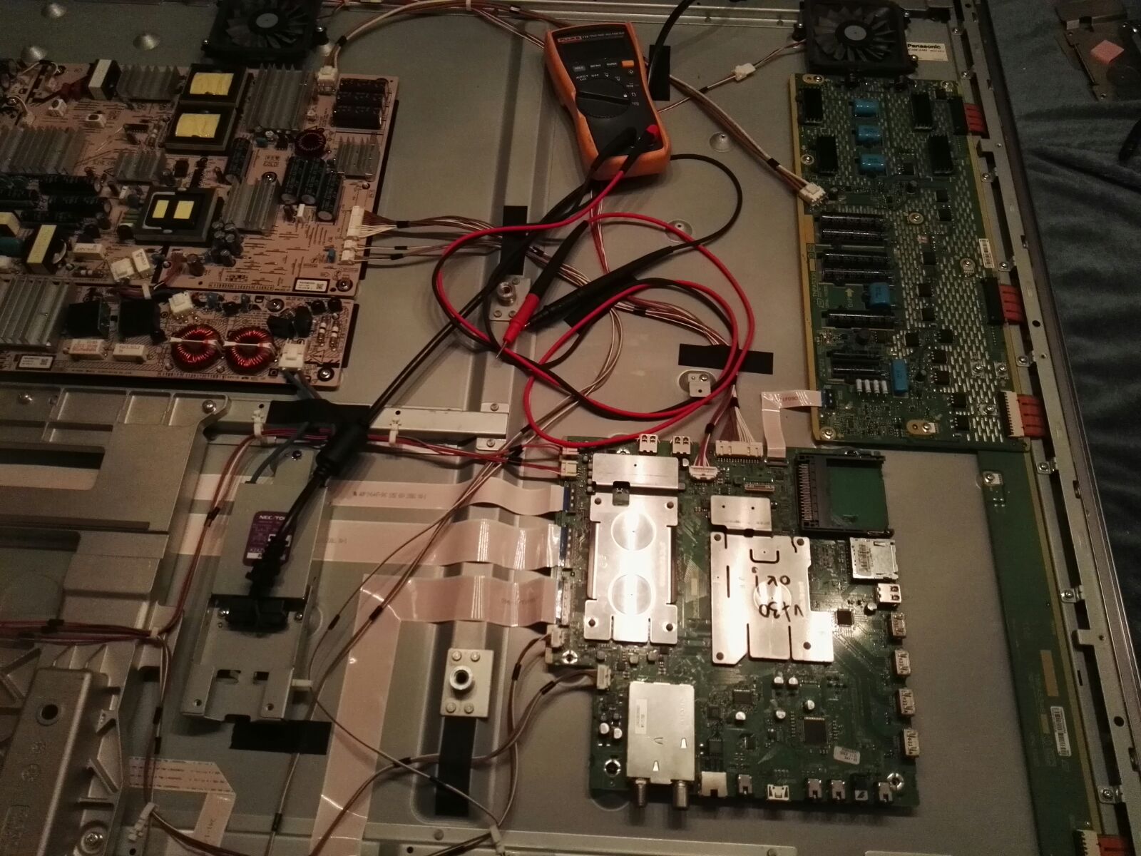

              Well i got a 42GT30 and 42VT30 but no y-sus board because i traded the repaired tnpa 5330 boards and a little money for this tv hoping it had 7 blinks haha.
              Don't have the 50GT30 anymore , sold it yesterday.
              So i have to do it with a 65VT30 and two 50 inch mainboards. ( GT30 and VT30 ).
              The picture you see is "white" with purple dots and it will eventually shut down with 6 blinks which is normal i guess. When i use the 50GT30 mainboard the tv will turn on for a few seconds and it shuts down with 6 blinks. The 50VT30 mainboard lasts longer but shuts down also.
              Vsus is 209V.

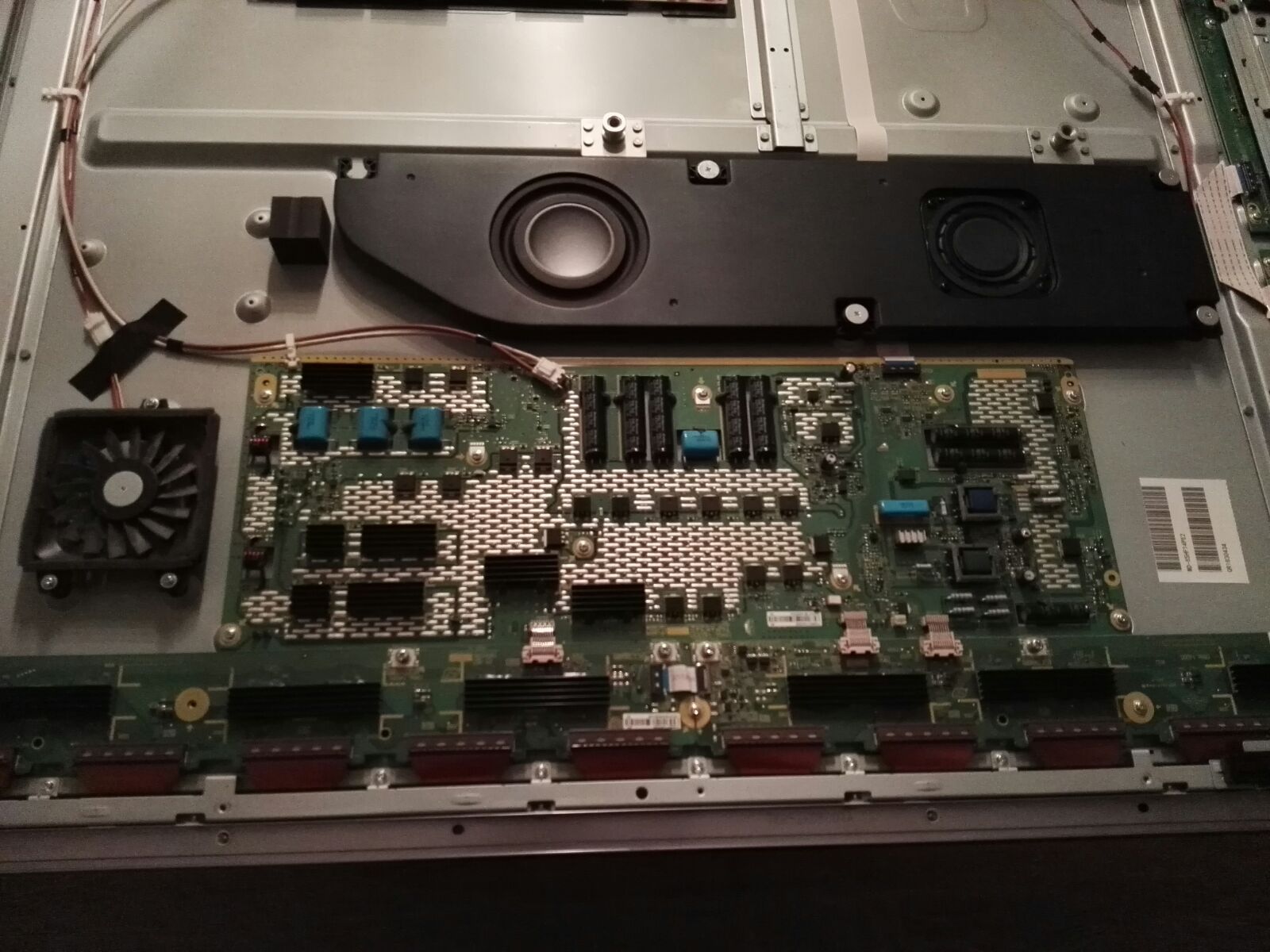

                    I don't know but i think you have either failing sc or ss board, don't think is mainboard problem, but it's just a hunch, don't have anything to support that technically

                      No don't think so. The tv was "dead" from the beginning. The original mainboard does not respond to the power button. The 50inch mainboard from the VT30 stays on when use the SC50 jumper , no problems there.
                      The 50 inch mainboard is not designed to work with a 65inch screen and both mainboards do the same and eventually shut down with 6 blinks. Its definitely some kind of handshake problem. Just need to find a 55 or 65 inch mainboard and the problem is solved.
                      Ps with a SS/SC problem i would have seen "snow" image but its not there.
