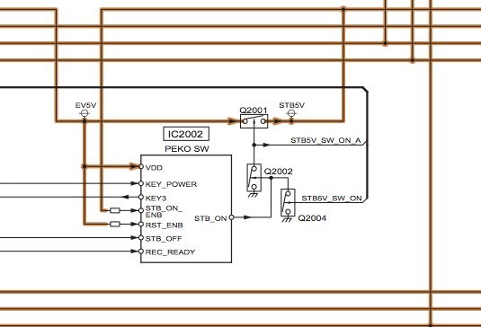

    Ok so not going well - the looping has reappeared.
    Video uploaded to here - http://******/2kddEya
    Any ideas what I can test during this looping ?
    I can check the 5V line but if it's ok then is it safe to say PSU is ok ?
    Would the culprit be the main board?

        Ok , im thinking the mainboard is the bad guy here. Try to heat up the mainboard and turn it on.

            Thanks for jumping in and as i said before , i think its a mainboard problem. The problems with the mainboards from Panasonic are usually BGA problem ( solder under cpu ). I think heating up the mainboard for 2/3 minutes close range will probably turn the tv on.
            Look at the picture from the service manual. the ST50/GT50/VT50 mainboards all work the same way.
            Mains voltage is going into the power supply which generates EV5V only , nothing more is coming from the power supply.
            EV5V is going via pin 6 to the mainboard into IC2002 to Q2002/2004 etc. If that ic is not doing its job you won't see a standby led and the tv is completely DEAD.

              Replaced the power supply.
              Just an update, TV is working fine.
              Prior to replacing the PSU - any Service Adjustment - testing through the colours/patterns would trigger the TV to just reboot or restart (and then eventually the power on looping).
              With the replaced PSU - I can leave the service adjustment menu on flicking through the tests without any issues so far.
              This would've failed within a few minutes but this has been on for the past hour.
              The only subtle difference I noticed when the TV was on with the new PSU is on the P6 reading I was able to read a value off pins 1,2. Perhaps the fault was the areas providing to Pins 1-2 off P6.
              Pin 1-2 = 3.3V (taken only when the TV was switched on).
              Pin 6 = 4.48V
              15vc and 15vs = 15.73V (same as the old board)
              I might see if there's anyone who can review the older PSU and replace any failing components so I have a spare (although this may might be cost prohibitive). From the pictures uploaded previously any specific areas to review off the PSU?

                Good thing you fixed the tv. It was either the powersupply or mainboard , it all depends on the 5V and if the mainboard returns the voltage. Glad you fixed it and you got some spare boards.
