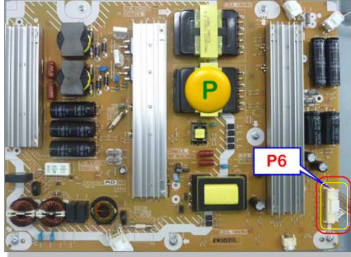

                  • johna8
                    • Jan 2017
                    • 13
                    • New Zealand
                    Re: Panasonic ST50
                    Thanks for the guidance.
                    Here are some photos here: http://******/2kddEya
                    Don't think there are any bad caps / loose screws etc - looks pretty good in general.
                    So I did a test with a multimeter.
                    AC input into power board returning 237/248V.
                    However then at the Y and X power outputs.
                    Standby (red led) - 00.1 / 200V
                    Turned on (no red led) - only 00.2 to 00.4 / 200V.
                    Power -> Mainboard (Video inputs) - nothing at all has a label 15V - could not obtain any readings at all.
                    This would appear to be a power source issue? Odd I don't get a good reading if at all on the X / Y DC outputs. The fuses I haven't bothered to check.

                          • Moreno83
                            • Jun 2014
                            • 2008
                            • The Netherlands
                            Re: Panasonic ST50
                            No , you need 5V on the white connector going to the mainboard. How else is the mainboard getting power?
                            5V into mainboard , mainboard turns on the rest of the power supply and THEN power will go to the SS/SC boards so yes its normal that you don't measure anything because you don't even have LED.
                            So back to the beginning. Do you get 5V on the white connector? Its probably the only voltage you will measure when the tv is off.

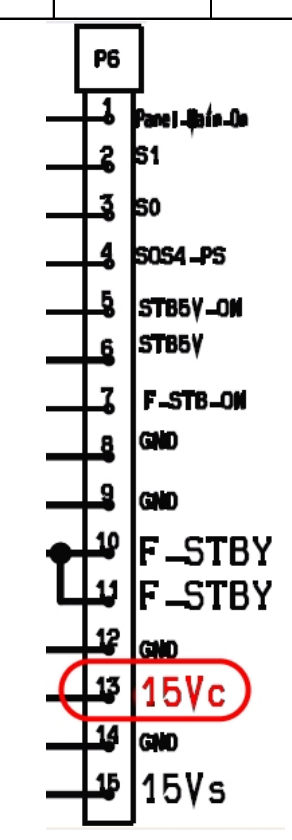

                              Re: Panasonic ST50
                              Any ways to report back - after having TV disconnected overnight.
                              The TV is now powering on again - sigh.
                              So I tested again and when switched on the readings from the power to mainboard - with it switched on.
                              15Vc - 15.73V
                              15Vs - 15.73V
                              Tested 5V - pin 6 - reading only 4.50V - should it be over 5V?
                              I did notice that when I replug in the power, about 2-3 minutes later I hear a click but not sure if related to having the ability to power on or not.
                              This would mean that the intermittent issues could be caused by the main board rather than the Power Supply?
                              I did notice a slight buzzing sound from the power supply when the unit was on (green) but apart from that.
                              Everything else is fine picture, etc - just when it won't switch on there are no red blink fault lights at all.
                              Here is a diagram of the P6 plug I measured - pins 13,15 and 6.
                              • Moreno83
                                • Jun 2014
                                • 2008
                                • The Netherlands
                                Re: Panasonic ST50
                                Those readings are fine. Its not always correct 15V or 5V. For example 5V can be 4.8v.
                                All connectors are seated correctly?
