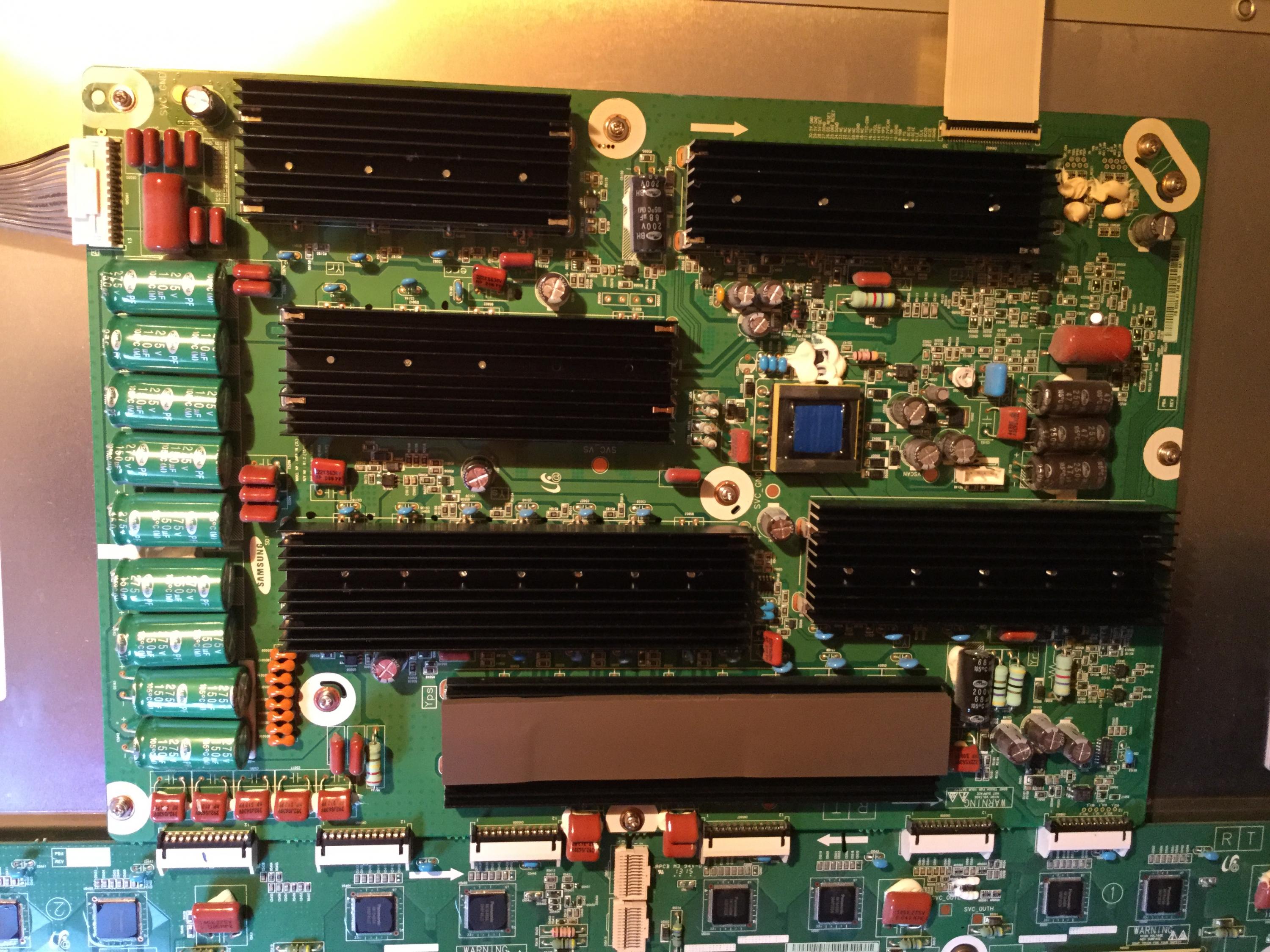

    Hi. I am new to this forum so I would like to thank everyone on this board for helping the community and enabling those that like to fix things while keeping our landfills a little emptier. Also my apologies to not adding pictures yet as I have not started the project. I will definitely post as it progresses and if anyone needs them to help me diagnose the problem. Please don't skip my thread just because I haven't posted pictures yet.
    So I have the TV in the subject and there are times when it doesn't turn on. The red light blinks on the panel (I believe 14 times at first slow and then fast blinks). It seems to happen if the TV has been on for a while and it's turned off and then on again. On the subsequent turn on is when I have noticed this behavior. (that's what she said!!! LOL!)
    From what I have read over at AVSForum it seems to be 3 bad capacitors on the Y board. The thread is: http://www.avsforum.com/forum/167-pl...turning-3.html
    Post #88 shows the caps and where they are on the Y board. Also there is a post there with a mouser reference to order them. I have gone ahead and purchased them just in case, but I would hate to fix it to realize the problem was elsewhere. Especially since they say the caps show no visual defects.
    So I would really appreciate it any advice on how to diagnose my problem and see if it's truly related to the 3 caps mentioned over at AVSForum.

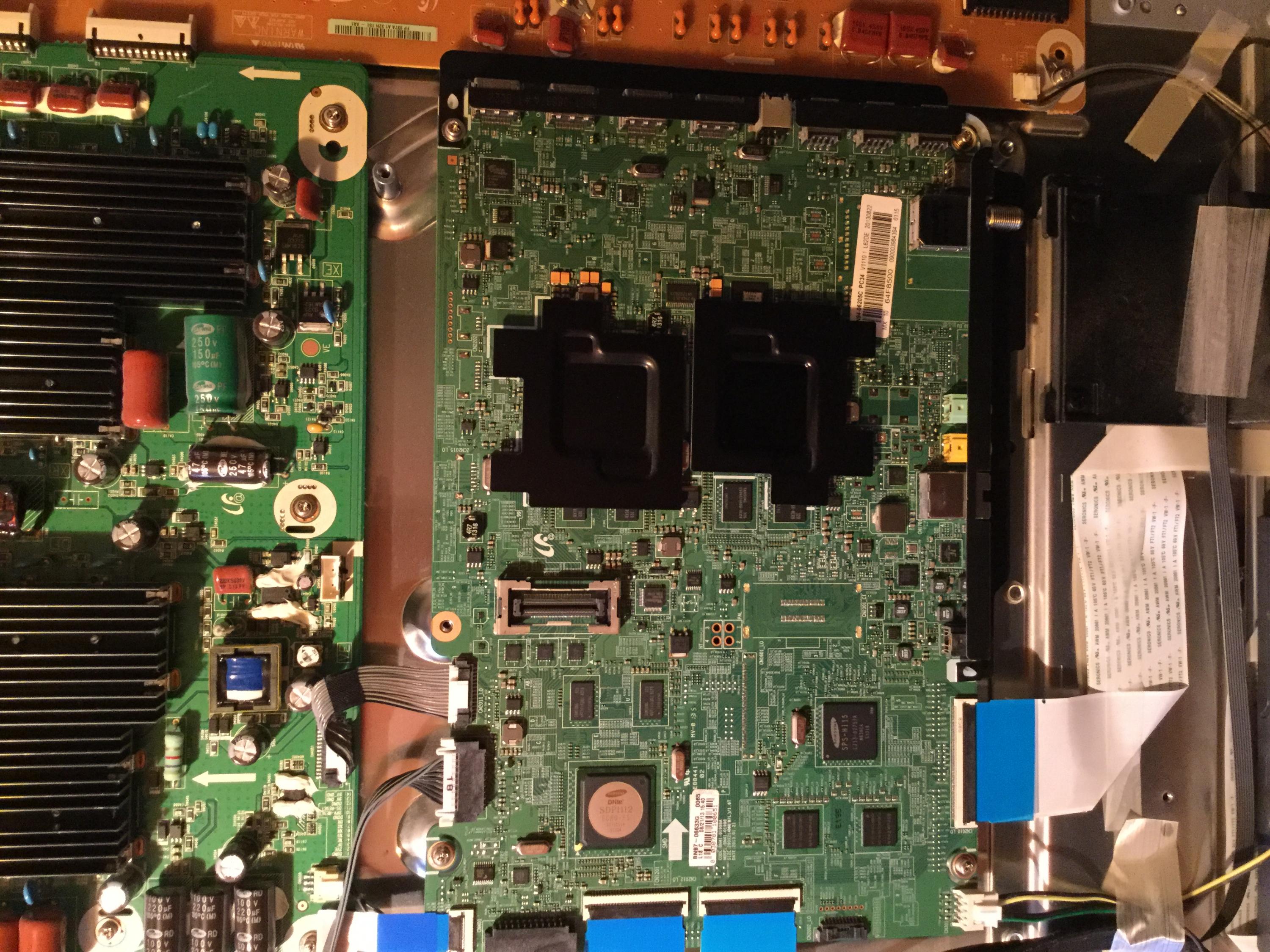

    I have taken the back off and taken pictures of the boards. I even took a picture of the 3 capacitors being reported as problematic on AVSForum. All the caps look visually sound. Any ideas?

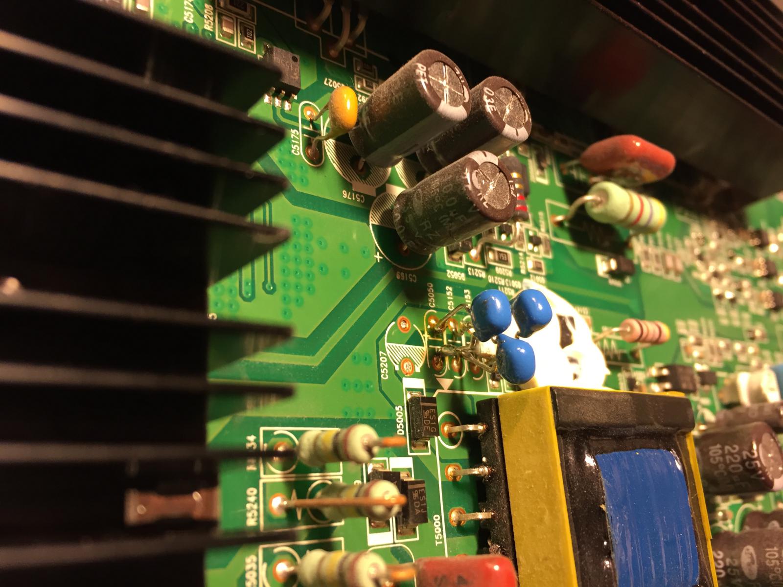

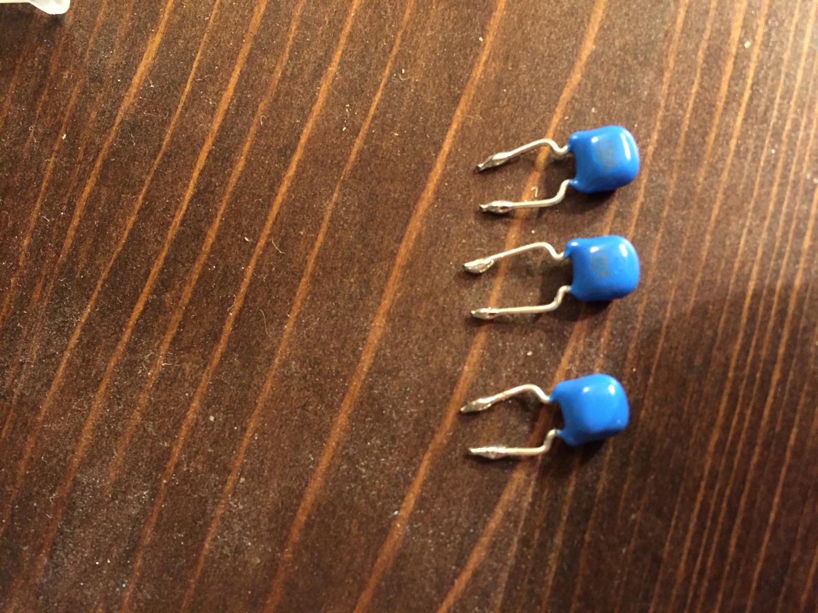

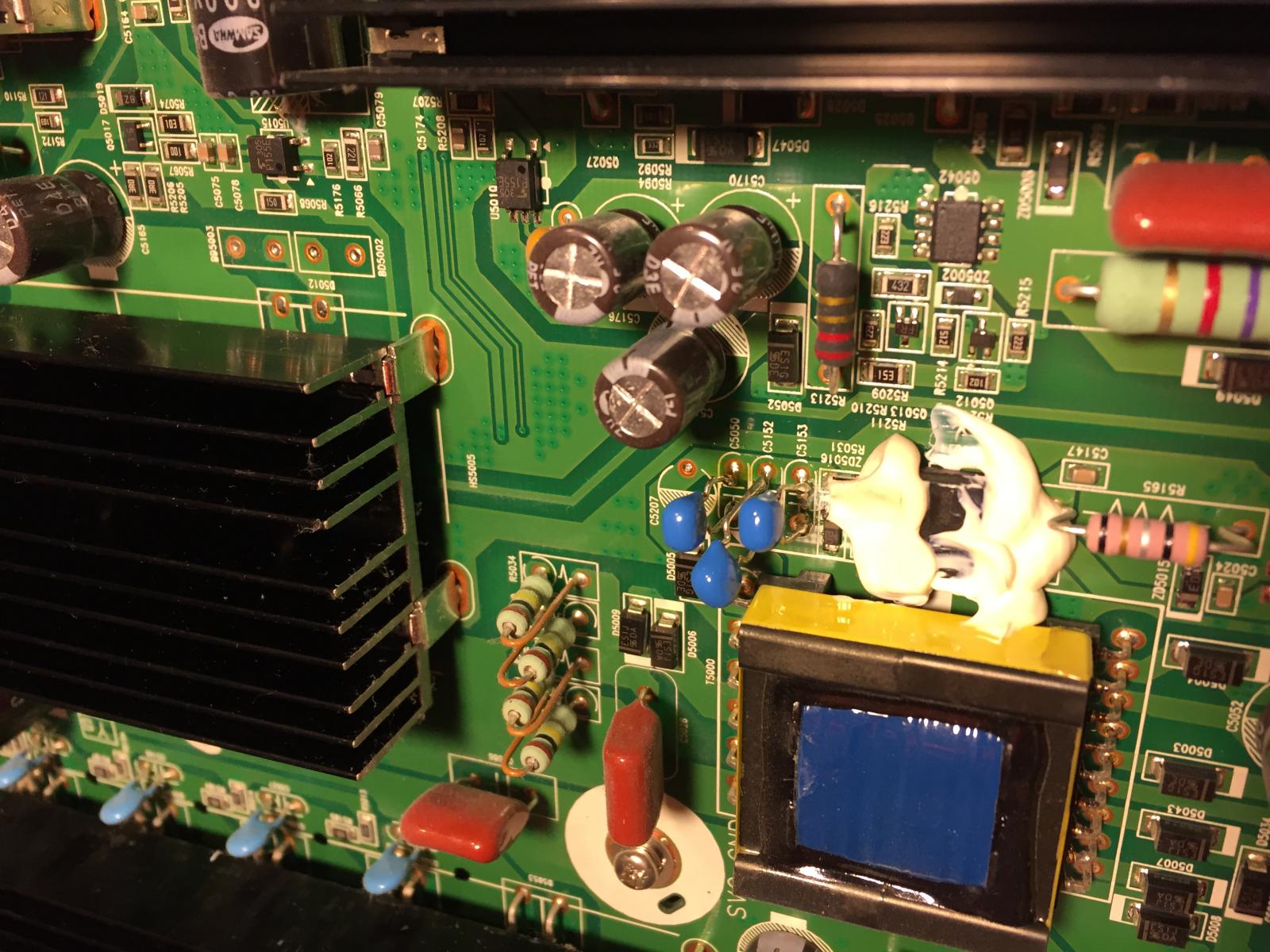

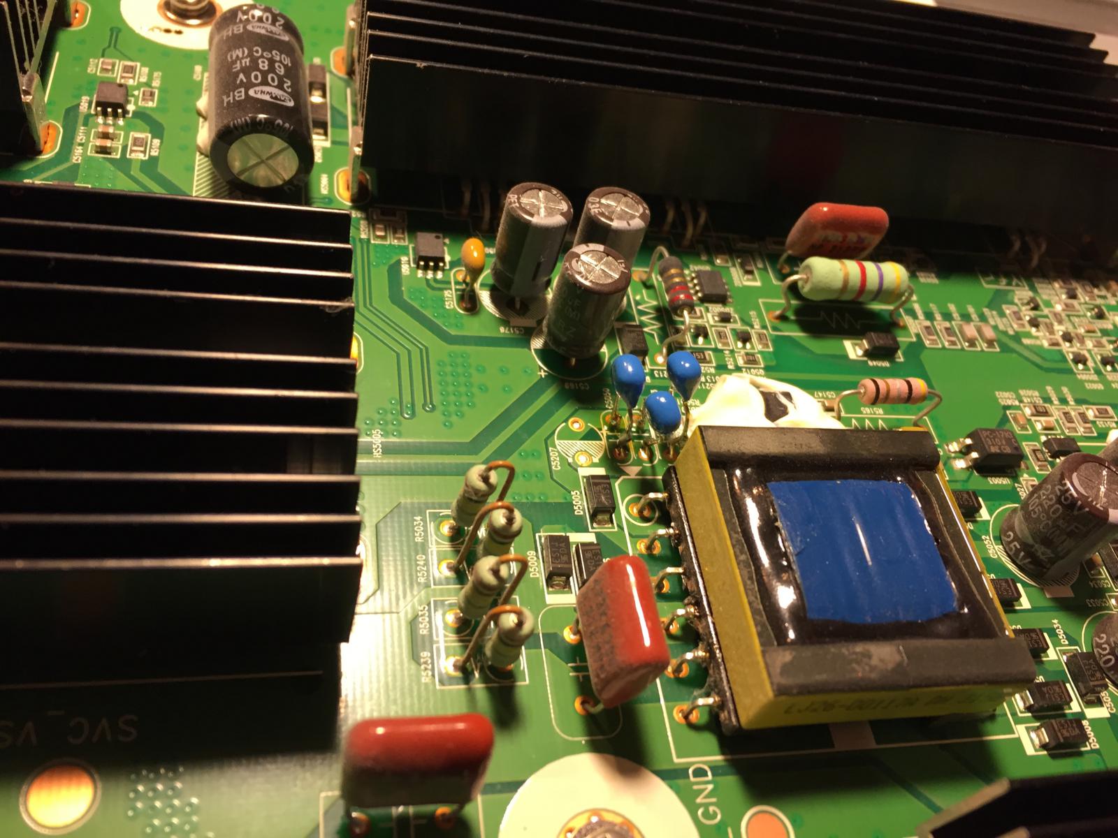

                      Attached you will find some pictures of my repair. First is a picture of the old caps removed. Then a picture of the new caps uninstalled but with solder already applied to the legs. Lastly I took a few pictures of the board with the caps installed. They are not pretty or perfectly aligned or straight but they do work.
                      Some additional comments I would like to add to my instructions above. I did solder the new caps to the legs of the old caps. So when you cut off the old caps leave as much leg as possible. I left one with a small leg by accident and it was very difficult to solder the new cap. I bought this wire cutter which has a fine tip perfect for this job:
                      For the soldering iron I would recommend a very fine tip. I used this one:
                      Lastly I recommend that after you install each cap, that you check the resistance between the points on C5207 and the top of the leg of your newly installed cap. The resistance should read 0 ohms. This means you made a good solder joint. Check both legs against both points on C5207.
                      The rest of the instruction I posted above still apply. I did the job as talb suggested, with the TV upright on it's stand and the Y Board still installed on the TV. I pulled up a chair to the back of the TV, got a magnifying lamp light and got and did the repair. Regarding the white glue that was smeared on one of the old caps I cut it off with an exacto knife, but be very careful since you can easily cut a trace or a component off the board

                        I can confirm that this fix also worked for a PS60E8000 that had the same symptoms. I have now fixed a couple of similar TVs with this method - fantastic! Many thanks to esegan on AVSforum and miamichillin99 and dick_barton for posting the link here.
                        By the way, the offending caps didn't have any visible signs of problems on either of the boards I fixed.
