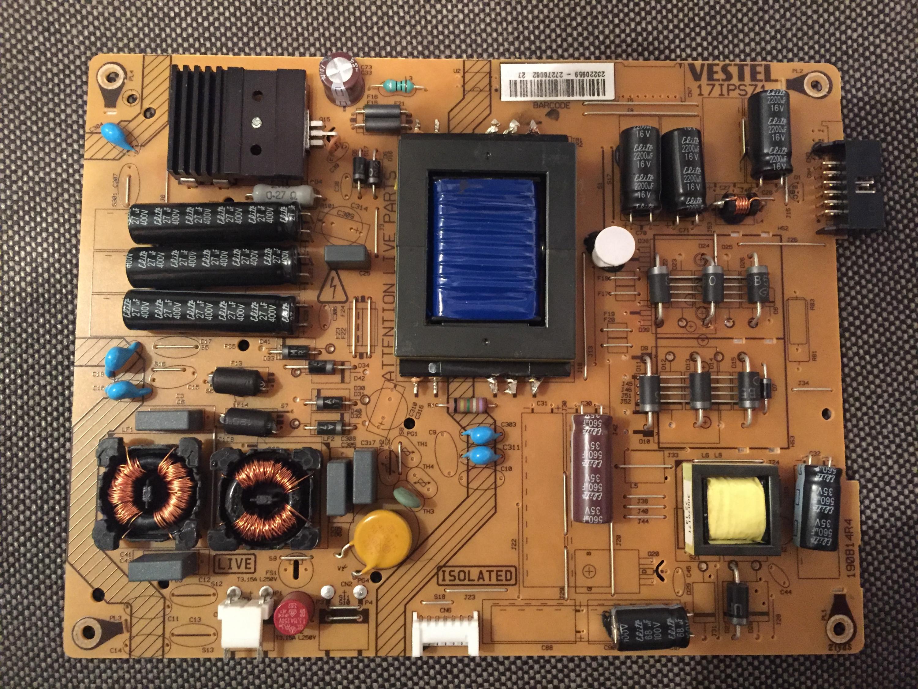

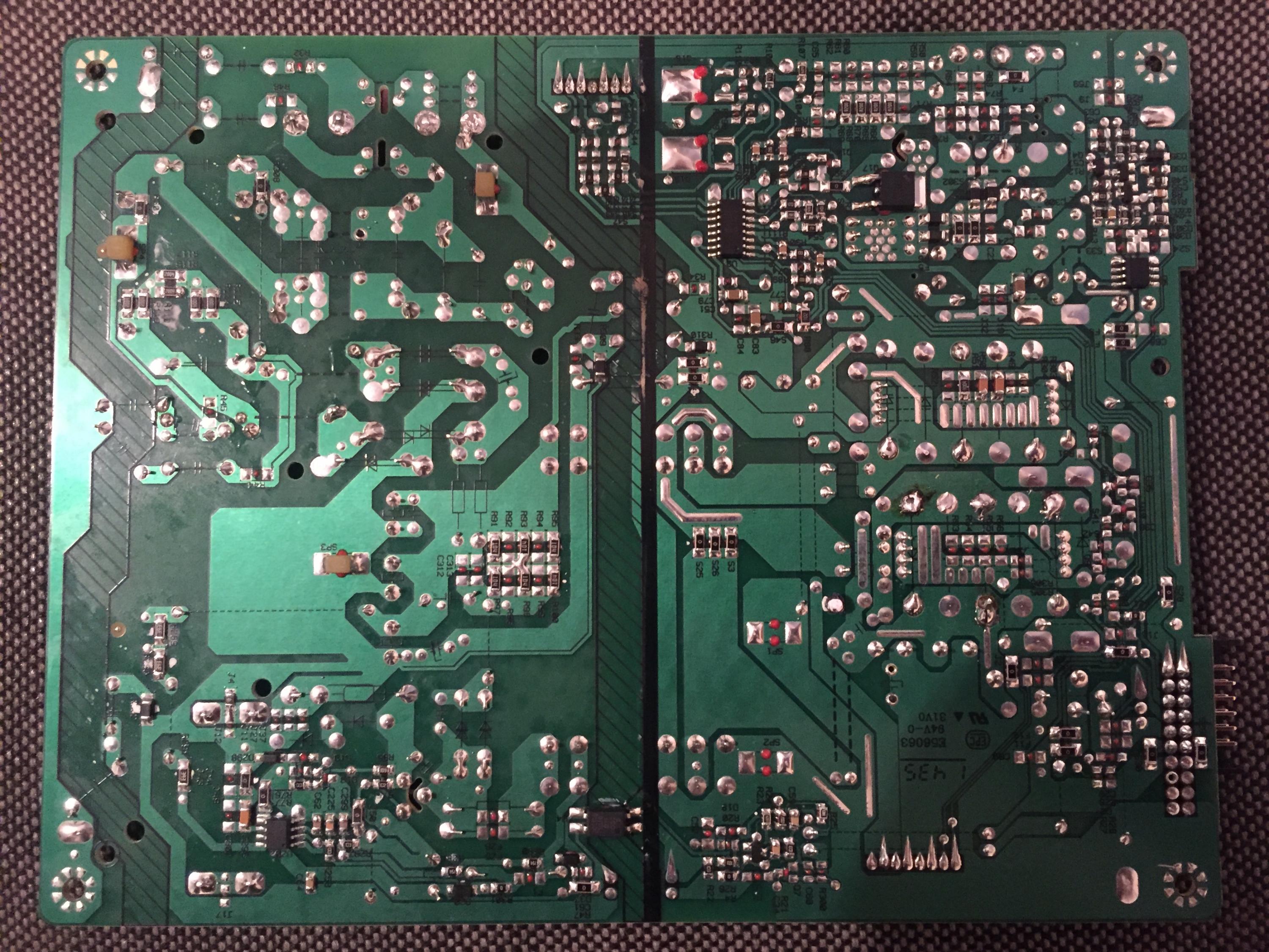

    This set came to me DEAD, after checking 17IPS71 diodes and volts, i have 330v on main caps, no stand by light, but have 12v and 24v from cn4 connecter, so im a bit stuck here, unless its the main board that gives the 5v stand by, if this is the case, then it looks like a yet another main fail, 17MB95M,
    anyone got any ideas, i have read the results of a search on here for these boards, but these are a year old, and someone may know better now.

    You didn't need a thread really, diagnoses is spot on so have some confidence ! Mainboard is failed bloody shit, what panel is it ? Try sub it with a Mb82 or Mb55 or 97 (for smart Tv) they last alot longer than MB95 shit

        Re: Digihome 32278hddledcntd
        It looks as though there's no 5V on the power supply. Q1 is not installed so Pin 9 of CN4 is connected to 12V.
        Have you tried freezing/heating the EEprom to see if you can get it to boot up.
