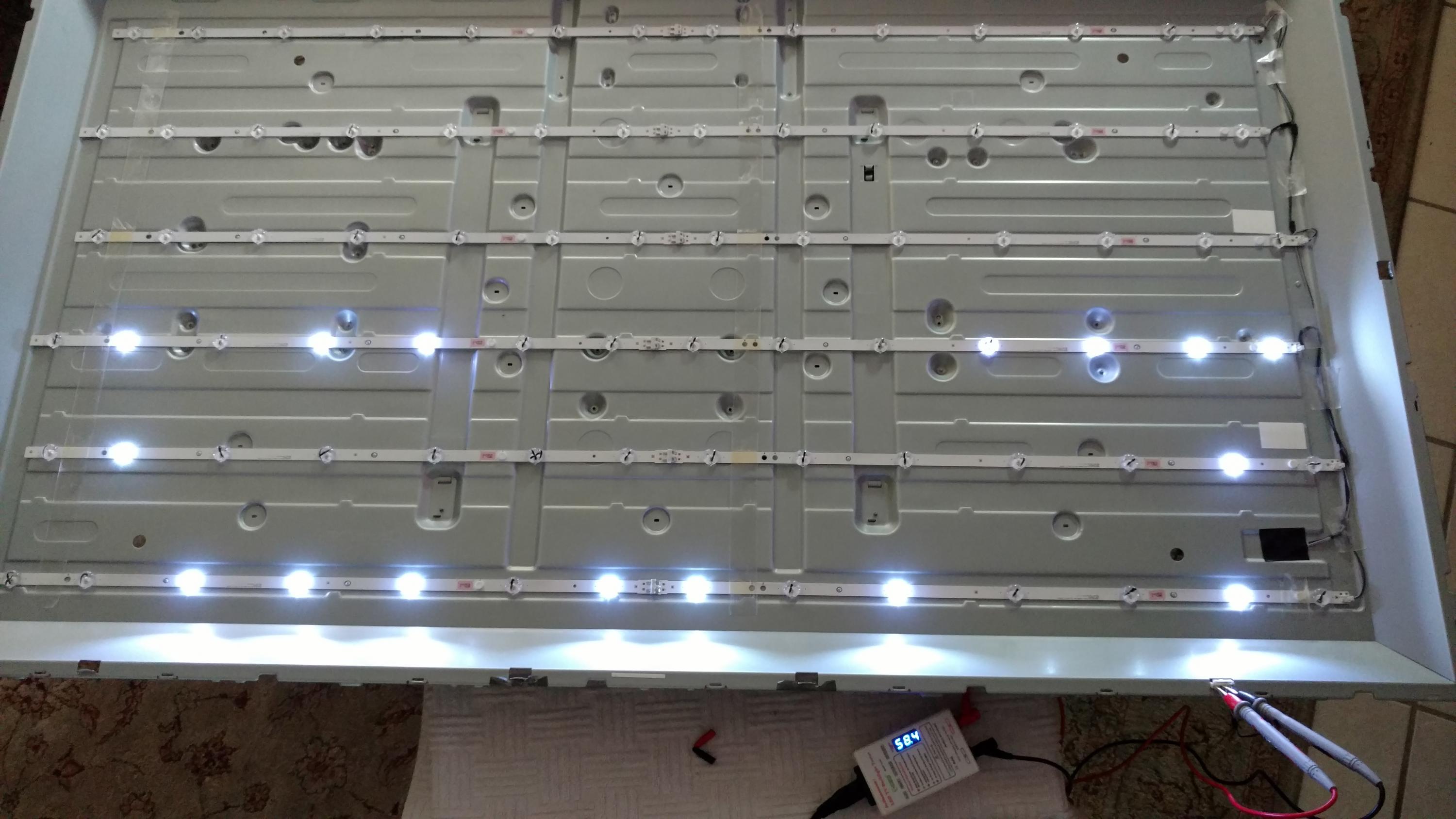

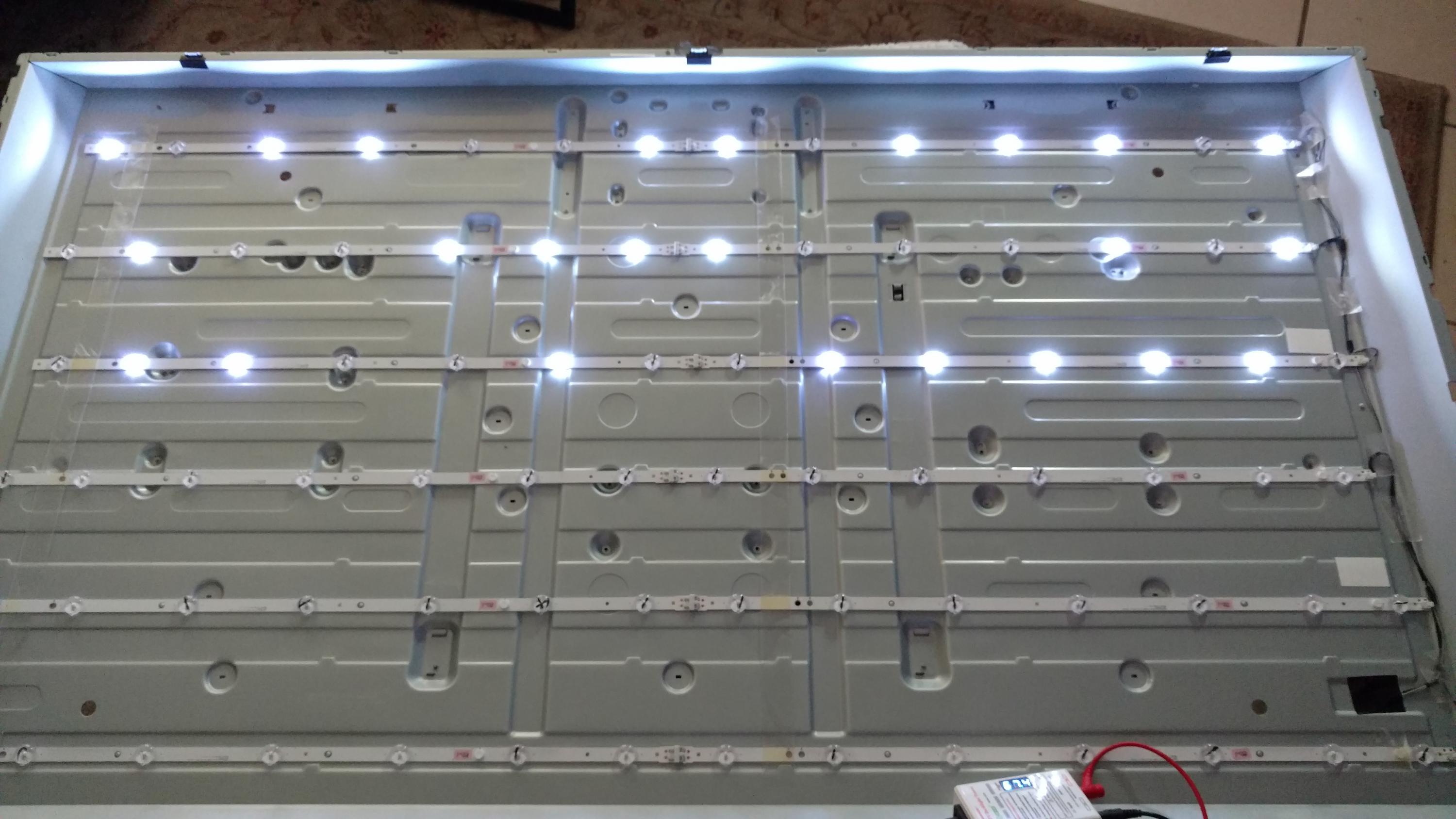

    Samsung UN60FH6200FXZA just flashes LED backlights rapidly.
    Problem again is bad LEDs, but didn't expect every strip to be bad. Very disappointing considering I had only 2 new strips ready to go when opening it up.
    Panel # CY-DF600CGSV2H
    LED strip part #s BN96-29074A, BN96-29075A
    This model is relatively easy to get to the LEDs, but I'd recommend having a full set of 12 strips ready before opening up.

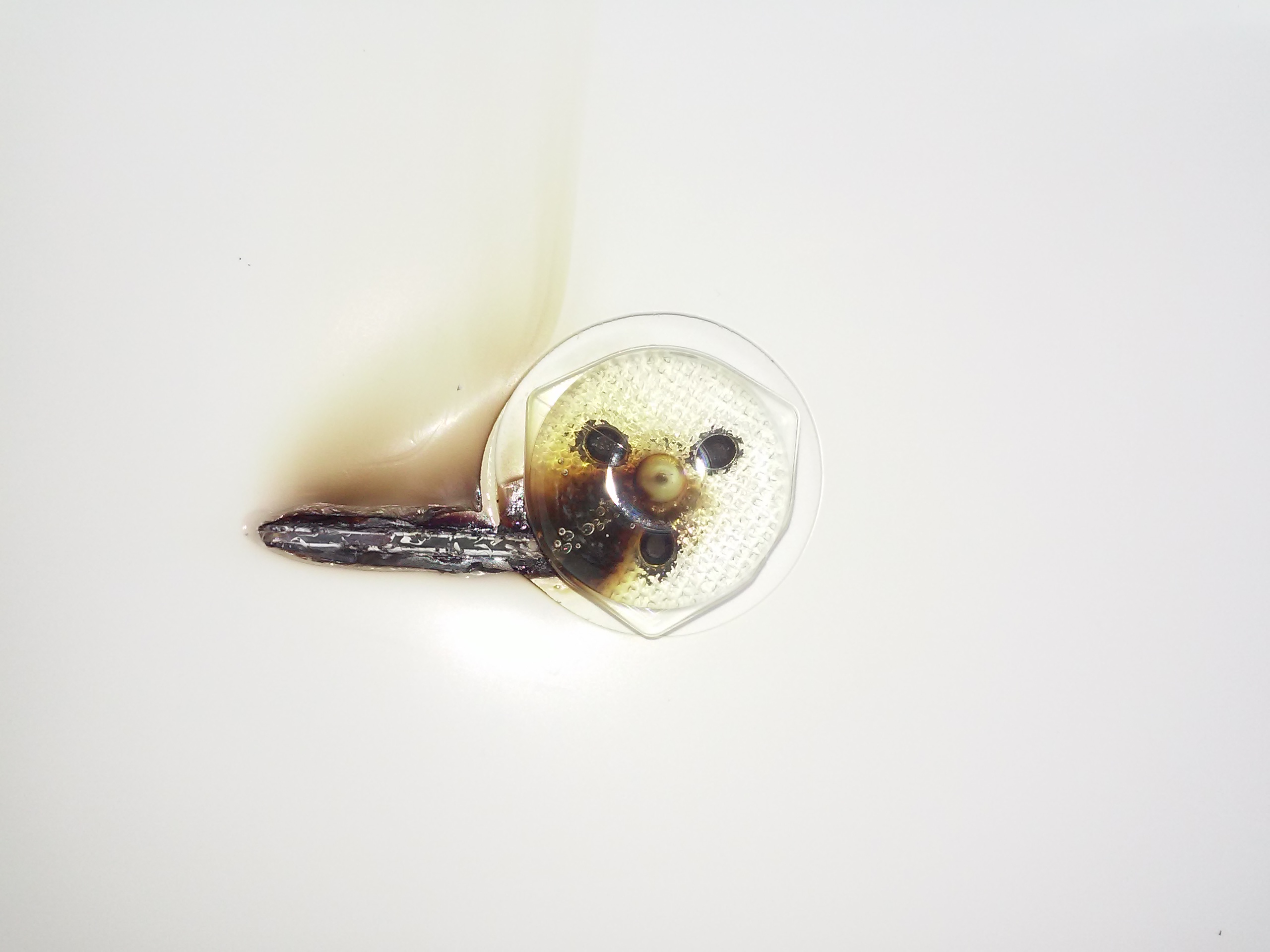

          Oh my god, that is terrible Samsung. How many of these sets have bad LED strips? They all seem to be of the same design. Vestel use similar LEDs and some LG sets using these LEDs seem to catch fire!

            This 47" LG I had looked like it caught a little fire.

              Yeah... there are few threads and pictures about LG's catiching fire like this. However, I find it sad that Samsung is going lower in the quality department, while still charging more than LG for example. That really sux.

                To top it off the full replacement set I ordered and just received from jimmy had 6 bad LEDs too.

                    Crist thats bad, Ive had 14 out on a 50" Toshiba recently. I think 3 were open rest shorted was a bitch to do used Lg panel. Beyond a joke and design flaw. Just counted yours and thats 41 Leds gone on it yours going to be having a long day when you change them out

                          I would do the stacking method if 1 or 2 were out but not 41
