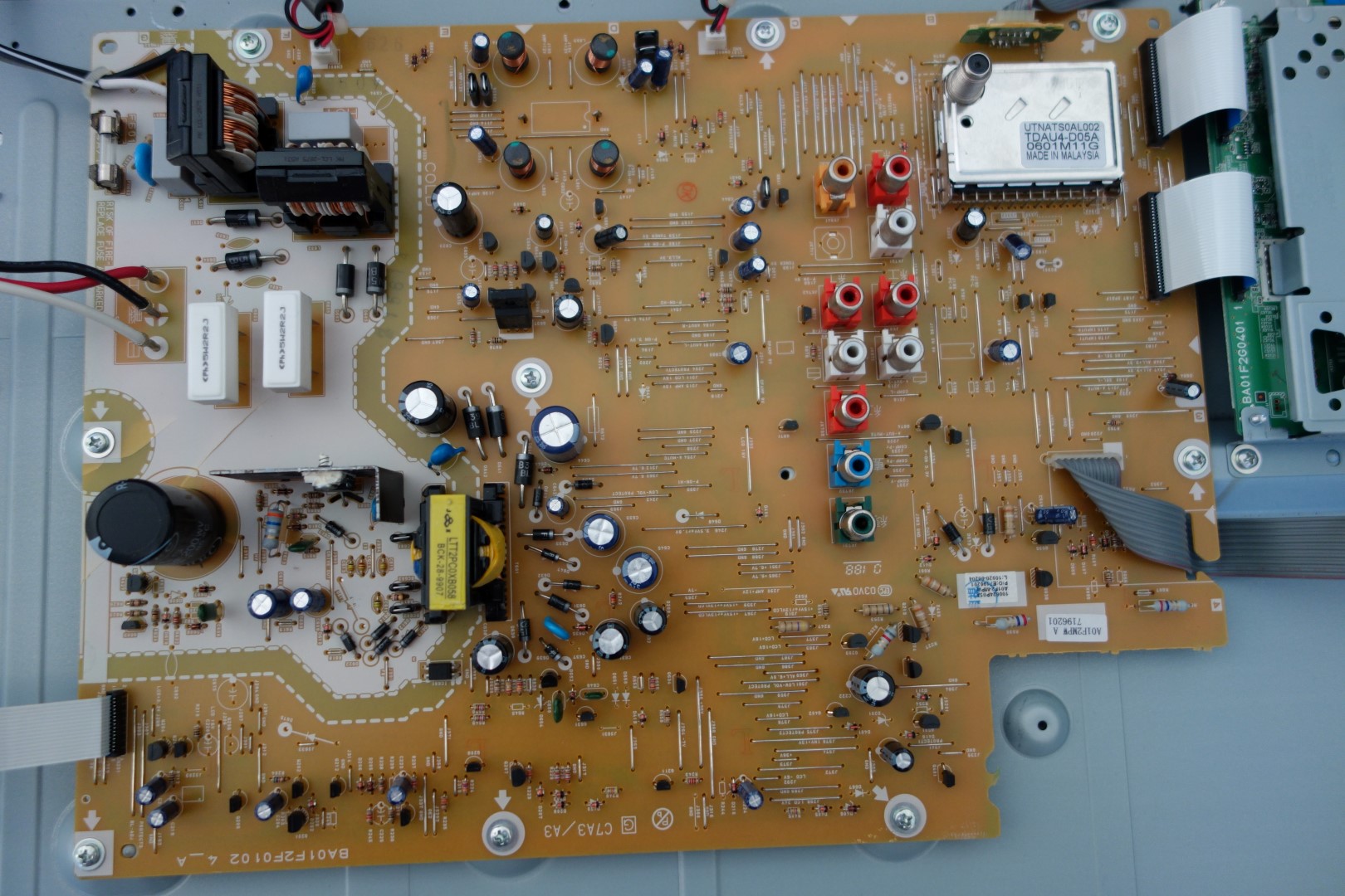

Philips 32PFL3505D/F7 No Power
    Shares boards with 32PFL3515D/F7 Power board is A01F2MPW
    Service manual with schematics available https://www.manualslib.com/download/...l3505d-F7.html
    Fuse is not blown. No 34VDC at the output of the transformer.
    Diodes D601-604 not shorted on primary side. D638 not shorted as mentioned here on previous thread here https://www.badcaps.net/forum/showth...2pfl3505d%2Ff7
    Checked a few diodes around the transformer and not shorted. I should check every one.
    I am open to replacing the whole board but nothing available on SJ or ebay. Any suggestions? Are the usual suspects shorted diodes?

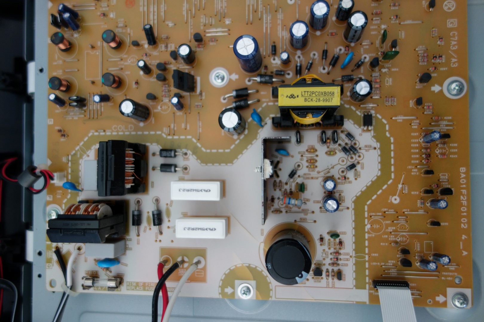

    Is there power reaching the big fat capacitor on the hot side?
      Re: Philips 32PFL3505D/F7 No Power
      I was checking continuity on some traces and found an open circuit between the pin 1 connector going to the inverter board and the big cap. I then notice the PCB is actually cracked in that section. You can see some cracks in the pic between the power resistors and big cap. Since it is a single sided board, I will bridge some connections with wires to see if it can be fixed without replacing the whole board.
      Edit: The jumpers worked. I had to jumper all three lines on the inverter power connection to the lower part of the board acrosss the crack. The reason there was no power is because the ground had been broken between two parts of the primary circuit.

        I didn't notice the crack till you mentioned it, thats odd, must have had some trauma?

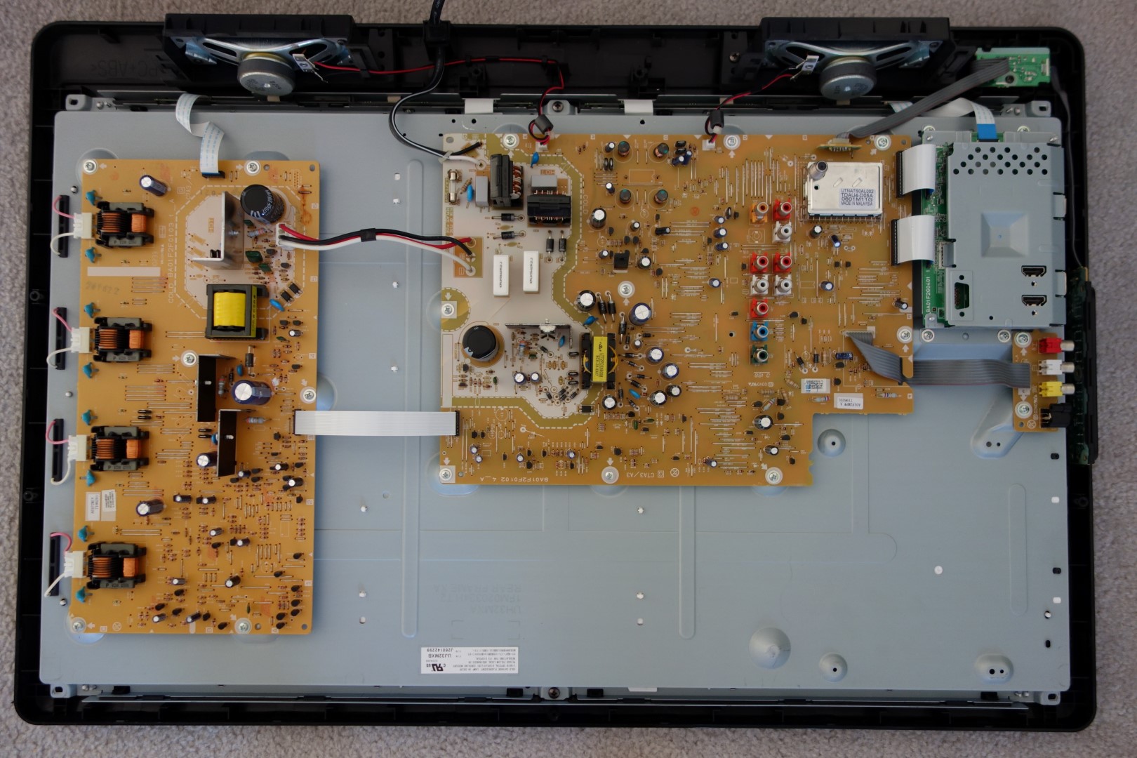

          I let it run for a couple of hours, turned it off and when I turned it back on, the logo came up and it shut off. There is another thread on this problem in this forum without a solution.

            I took some measurements and confirmed the PROTECT3 line goes from 0V when the backlight is on to 0.9V when it shuts down. The power rail is set on the inverter with a 100V zener so the post I quoted confuses me. There should be 82V on an optoisolator dropped down with a resistor as marked on the schematic.
