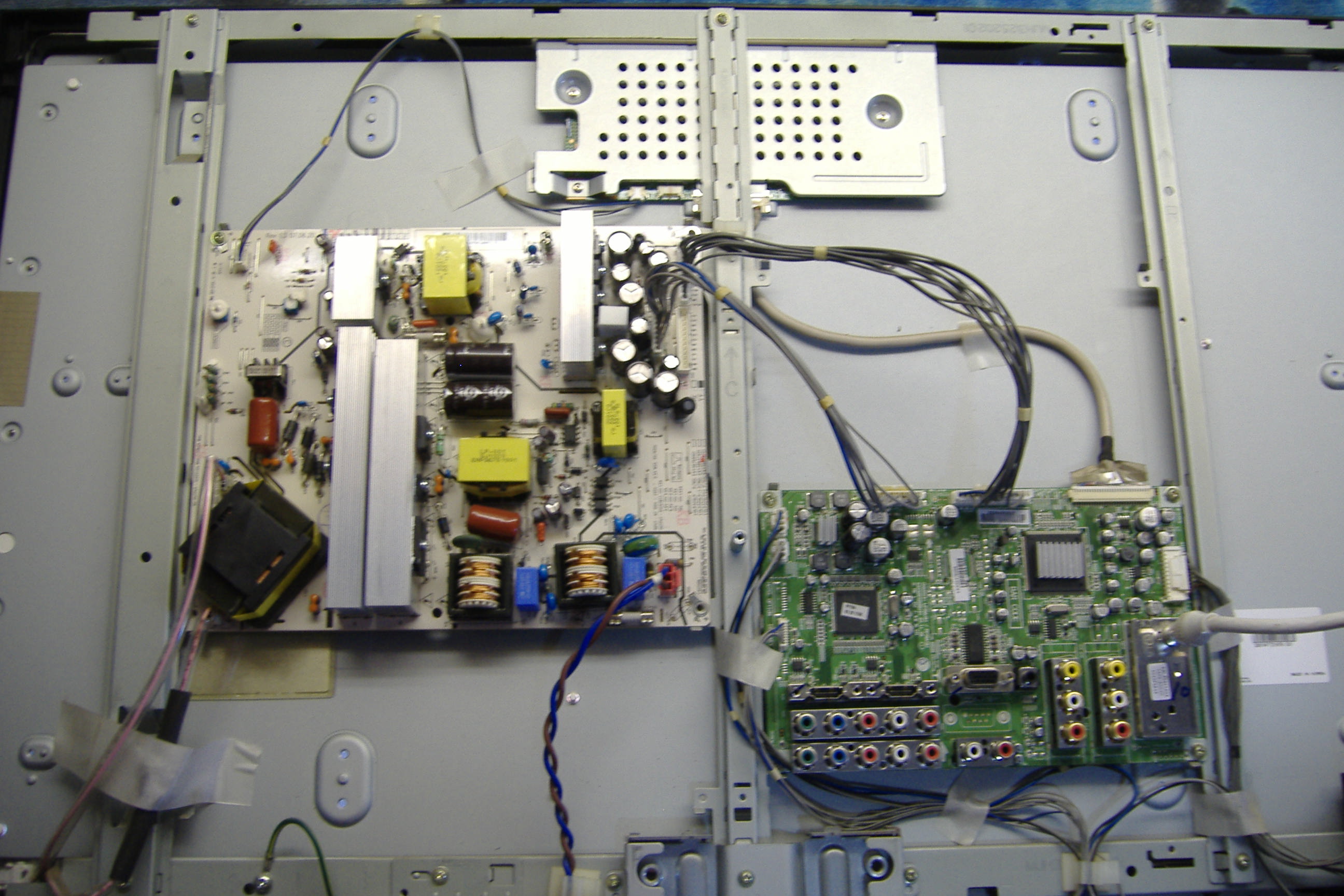

    Hi, please if somebody could help. my LG32LC4R has good picture, but no audio.
    I've measured all the marked voltages, and all but two are missing:
    The 3v4 rail from the psu pcb, and
    The "3v4-on" from the cpu pcb.
    Is the missing 3v4 responsible for my audio loss or am I barking up the wrong tree?
    The "psu on" from cpu measures 2v1, and the "inv on" measure's 4v4.
    Could I use one of these two "on commands" to switch the 3v4 on?
    (hoping to link "psu-on" to "3v4-on"?)
    I have checked all the usual, like speakers on and selected PAL I, and made sure its not a user setting.

      What is the number of the power supply. Can you provide a sharper picture of it showing voltage labels.

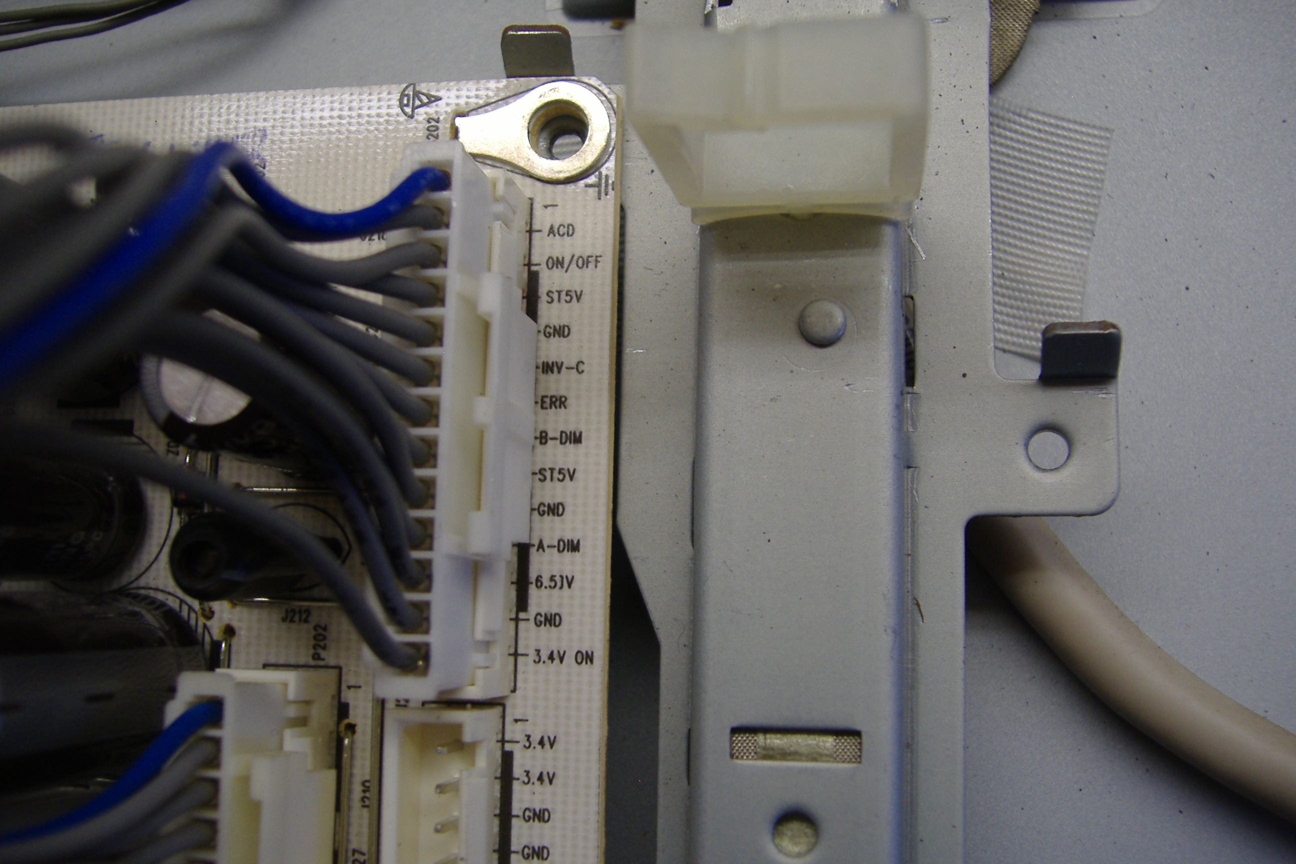

        If you want to force on the 3V4 power supply, you MUST disconnect the 3V4-ON wire going back to the main board first and then you can jump the 3V4-ON pin of the power supply to the psu-on using 100 Ohms resistor for safety.

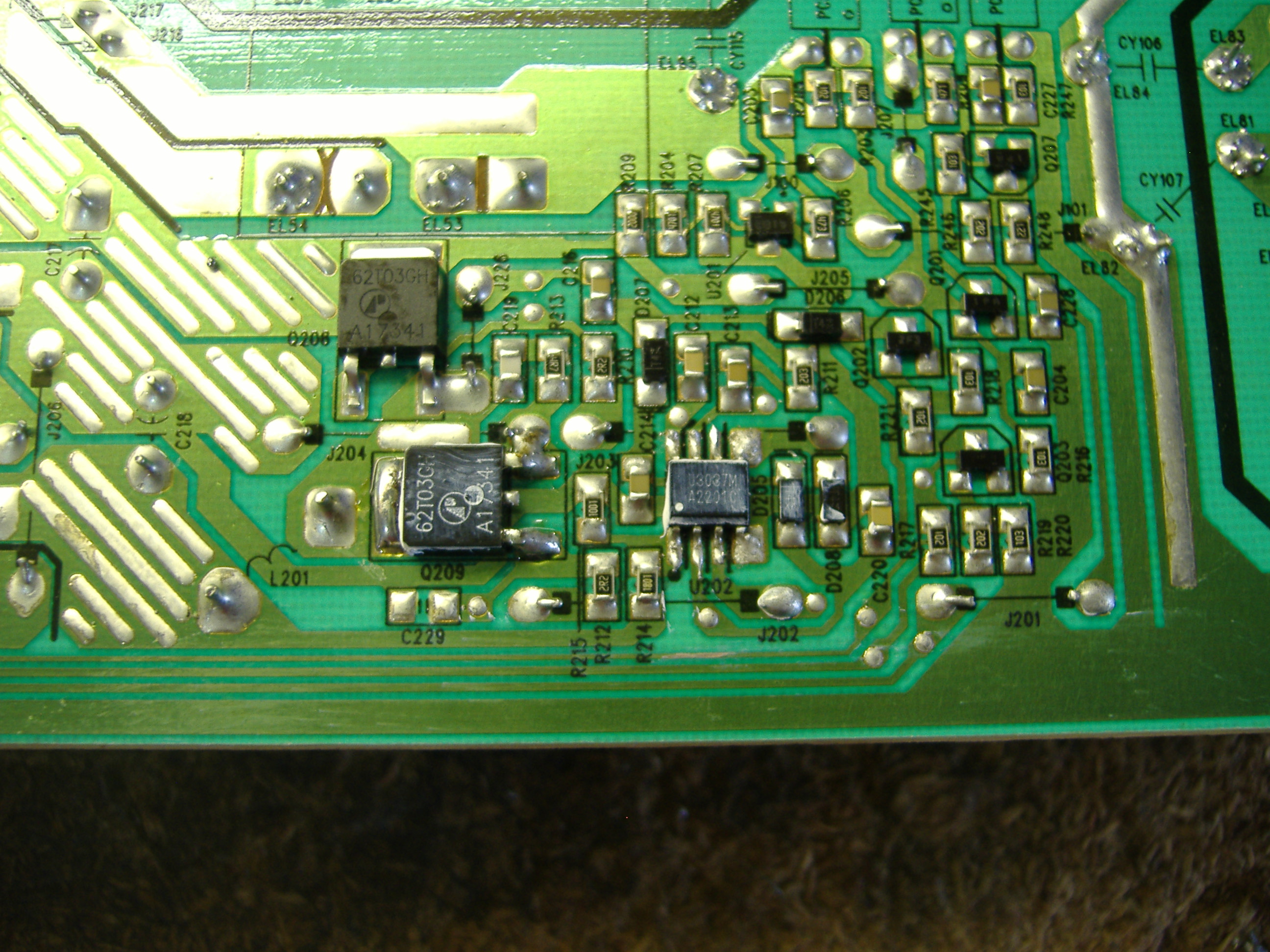

          I took closer photos of the Psu which I studied, and see they use a U3037 as a pwm controller driving two nchannel fets supplied from the 5v rail to achieve the 3v4.
          The layout looks identical to the typical configuration supplied with the pdf for the U3037.
          This set use two transistors Q202 (pnp) & Q203 (npn) to switch the 5v vcc to the U3037 (see photo). The 5v vcc (pin 2) supply for the U3037 isn't there.

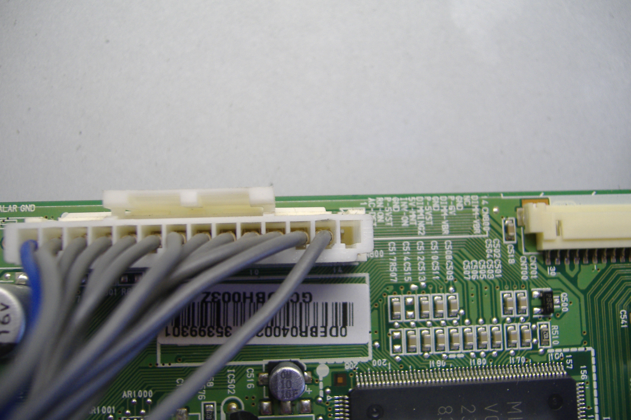

          The 3v4 "on" lead from the cpu connects to the base of Q203 (npn), so I guess it's waiting for a "high" from the cpu?
          NOW THE STRANGE PART: when you trace the 3v4 "on" lead back to the cpu board, it gets to the plug, and is marked NC (no connection?). see photo
          Using my meter on ohms, I tried to find where the lead goes to, but like they say..NC ?
          I see that the emmiter of Q202 picks up the 5v rail, and it's collector goes to pin 2 of the U3037. Being a PNP transistor I reckon it needs to be grounded by Q203.
          I am going to try taking Q202's base to ground. It would be grounded by Q203 anyway, when Q203 was switched.
          Will report back later, thanks.
