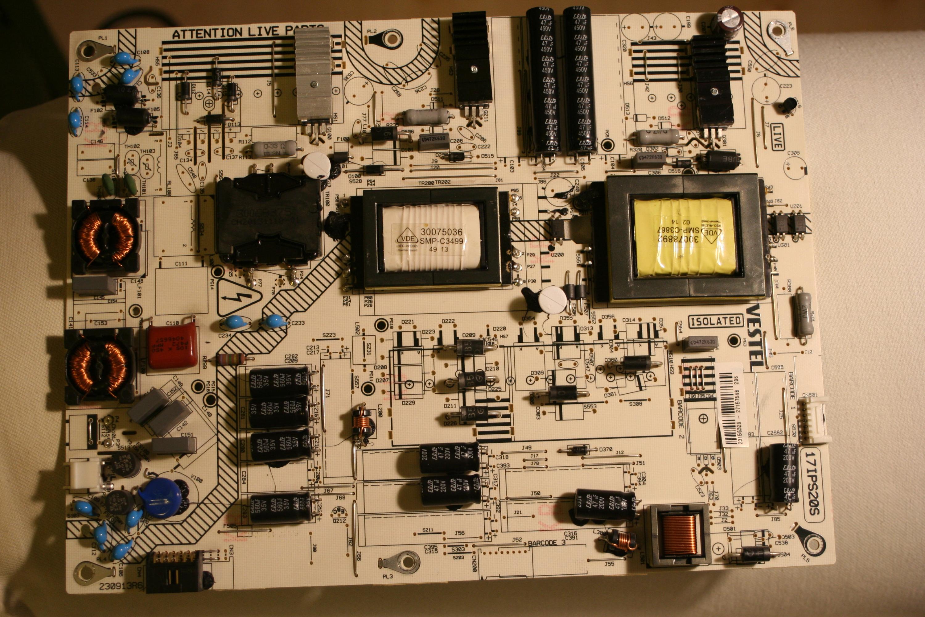

    I have a problem with this LED TV power supply. Sometimes it powers down LED backlight. There is no way to predict when it is going to happen. Sometimes it works 5 hours. Sometimes backlight switches off after 10 minutes. Switching it off and on again solves the problem for some time (sometimes for few minutes, sometimes for few seconds and sometimes for few hours).
    I cannot reproduce the problem when needed… I have to wait for it.

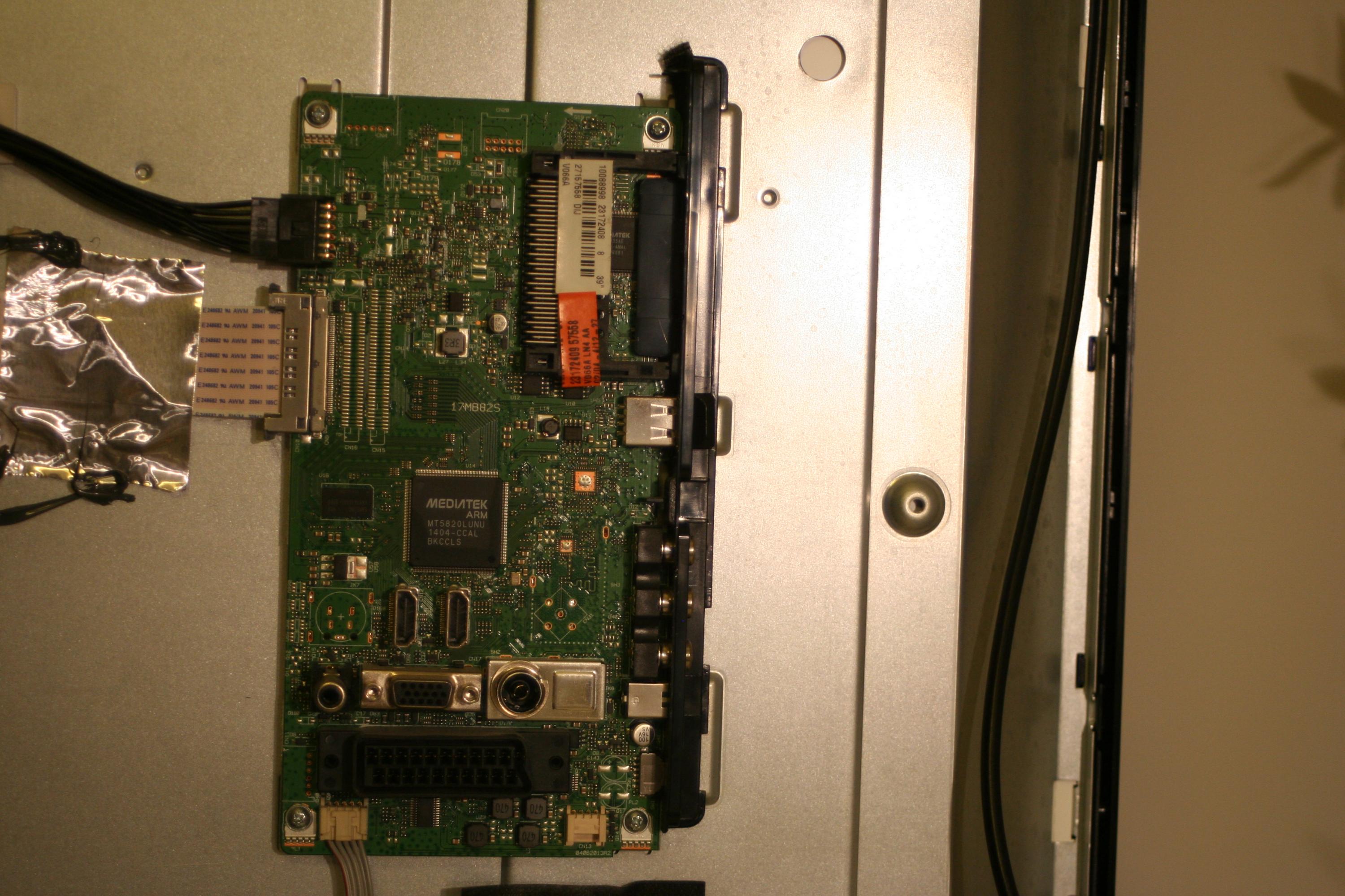

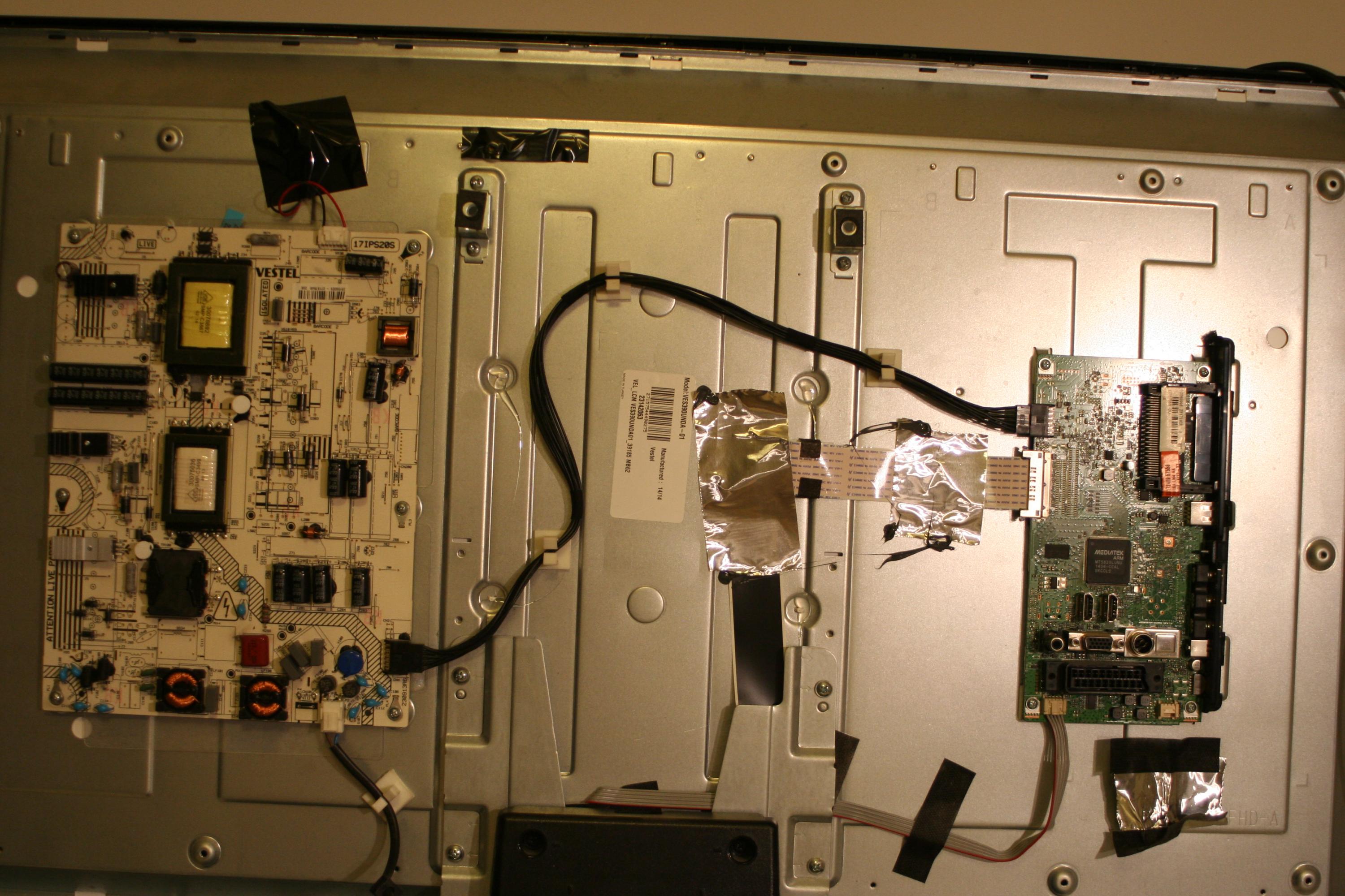

    I've made some photos of the layout, Vestel power board and main board.
    I've also measured voltages on same points when the backlight is on and when it's off.
    Measurements were made only on the non-SMD side as I could easily access it.
    The radings of voltages betwen chasis and some points (https://docs.google.com/spreadsheets...it?usp=sharing):

    Re: Sharp LCD LED TV LC-39LD145V [C] - Vestel 17IPS20S, problem with backlight
    Connectors that link led strings are breaking down, open panel and bridge over them with solid wire.
          The voltage across C105 should be 400V otherwise the FAN7529 is not operating.
          Check diodes D101, D102, D506, Q100
          What DC voltage do you have (carefully) between pins 8 & 6 of FAN7529. Check C127
            I dont think he measured across the caps right DB thats why he has a low reading. These sets wont run if the fan Ic isnt working.
                                        Ok... I soldered all the joints. I'll post the photos of what it looked like. Now I'll wait to see if this solved my problem.
