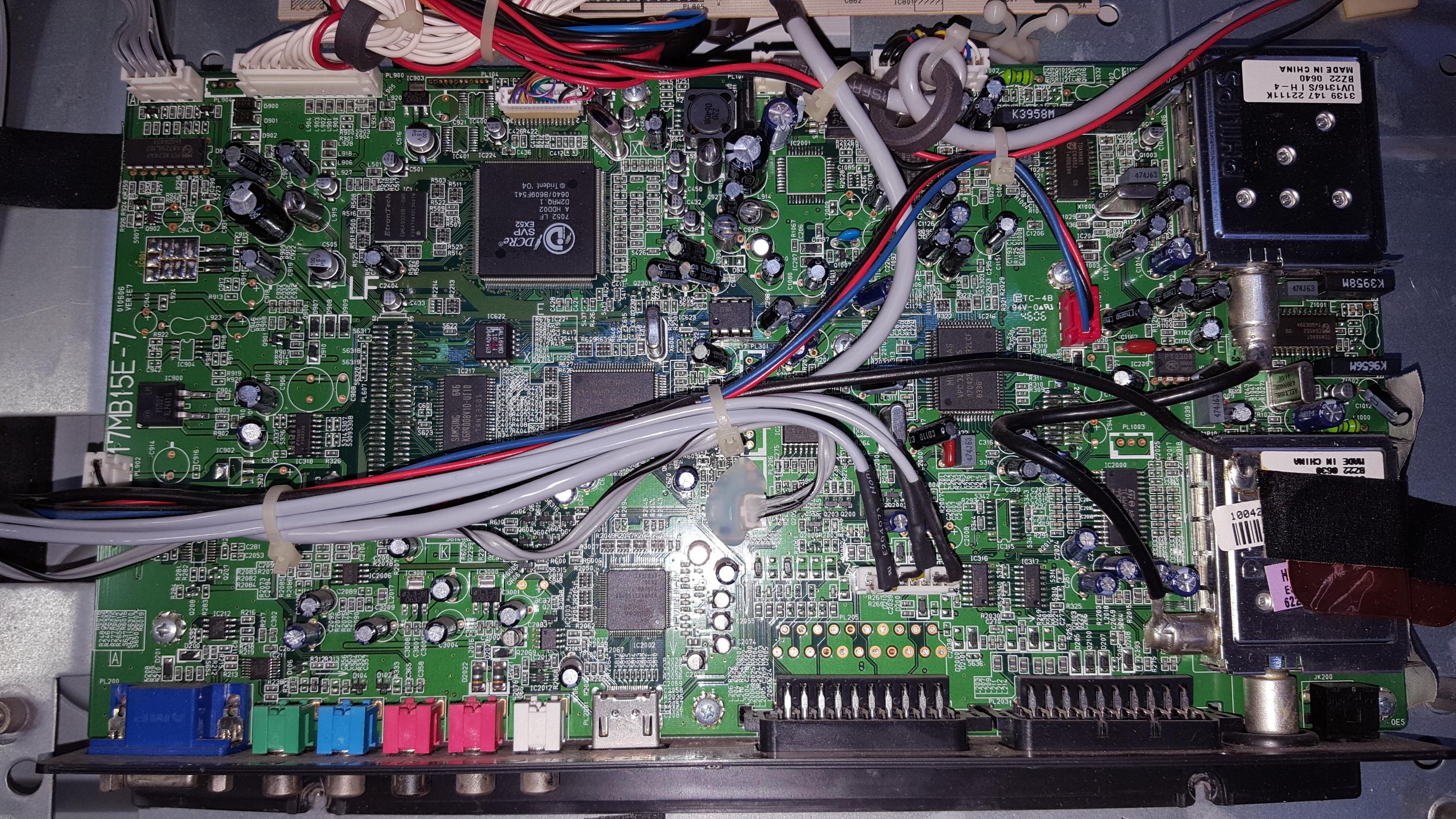

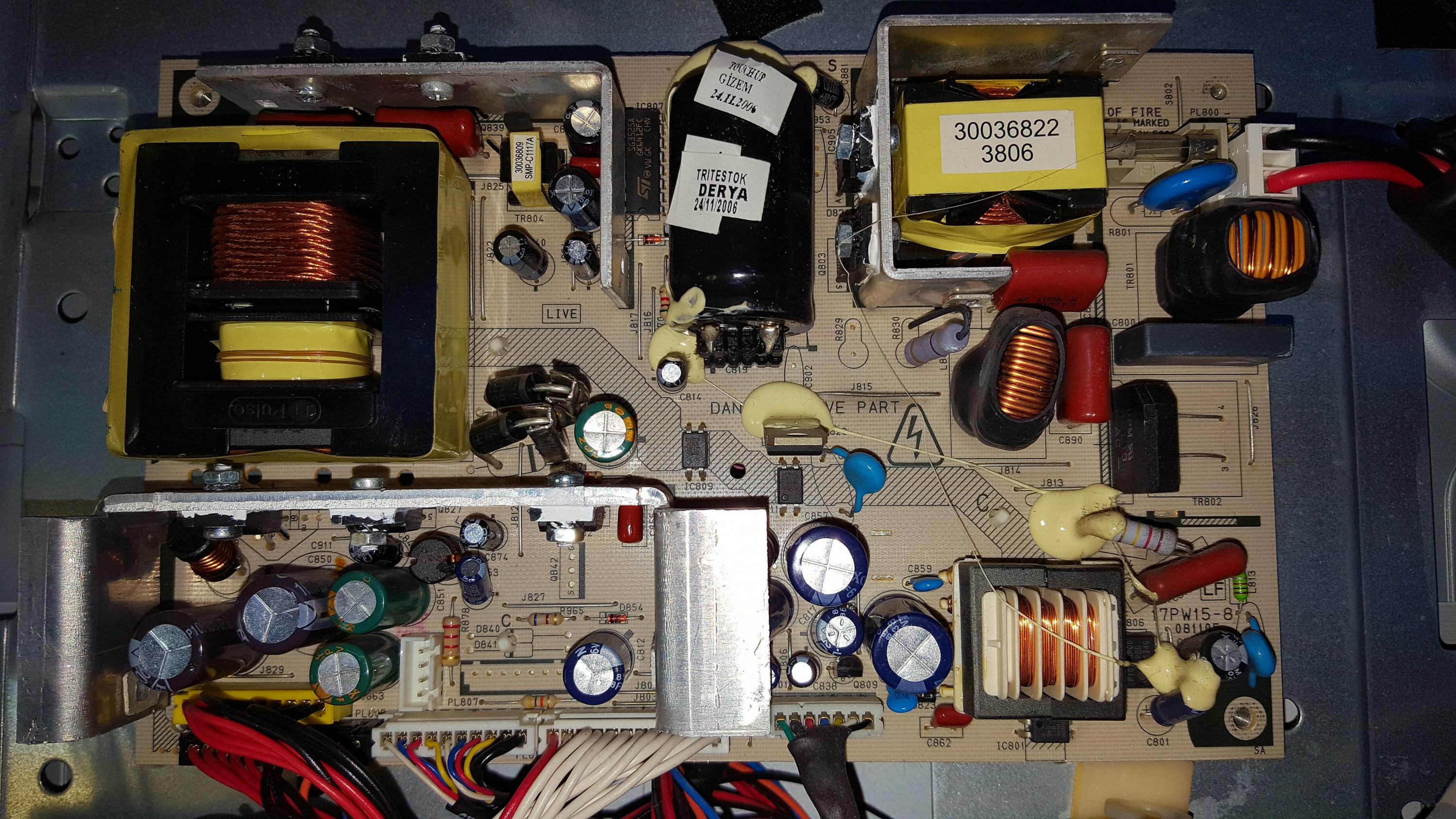

    A friend has given me this old set to have a look at. It is old, but owner would like it fixed if poss, so I said I'd give it a try.
    It has the 17PW15-8 power supply and the main board is a 17MB15E-7. It doesn't look like anyone has had the back off before.
    It appears to be stuck in standby, the blue standby LED stays lit.
    First thing I did was replace the two cap's 877 & 878 but still the same. Can't see any bulging electrolytics, it doesn't look like the set has had much use in fact, it's all very clean.
    I checked the voltage on the 24V rail to the inverter and it does increase somewhat when trying to start up the set but it trips and returns to 0V after about 1s. Same with the 5V rail. C819 sits at 325V in standby, rises to about 390V when attempting to start then returns to 325V.
    As the set's not worth much I thought I'd ask if anyone has had the same fault, or could suggest things to check rather than waste much time on a possibly fruitless mission.
    Any help greatly appreciated.
    TIA.

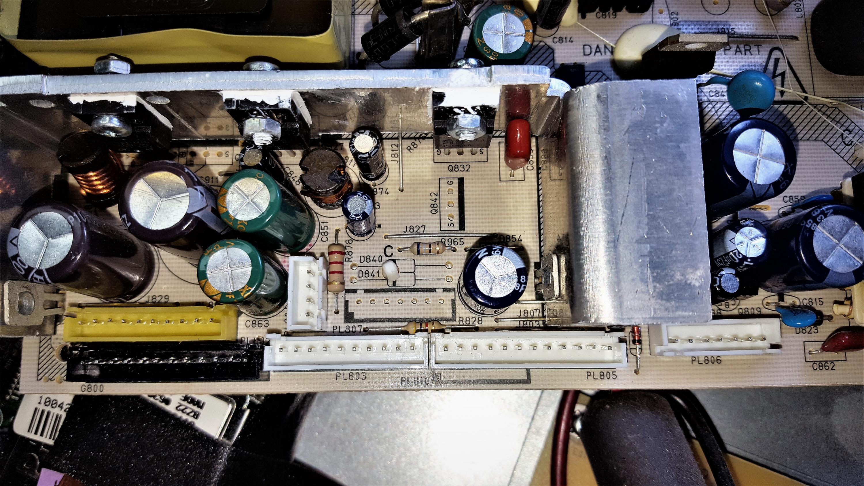

                if you can post a clear picture of the connectors on the psu and any writing by them we should be able to advise you then im sure reece will have a idea on what to check on the psu and also if you need to force on the psu on these sets to test all voltages as its vestel im never 100% sure but im sure reece will advise.

                  Re: Sanyo (Vestel) CE26HW03 with 17PW15-8
                  Thanks mate, here is another of the front edge of the board showing (most of) the socket numbers.
                  NB The vertically orientated socket (next to the 2k2) resistor was vacant.
                                OK, a bit of progress- but it's still dead.
                                First off- it's definitely the PSU that's faulty, I 'borrowed' one off another set & everything works as it should. Unfortunately I had to give it back!
                                So, original board back in. With only the mains plug on, there was no voltage on any pin on PL803. But with plugs 803 & 806 in, the 3V3 was up on pin 6 of 803. But pulling it down to 0V with a 1k2 resistor didn't do anything besides giving a slight buzz/hiss from the top RH corner. Even C819 remained steady at 325V.

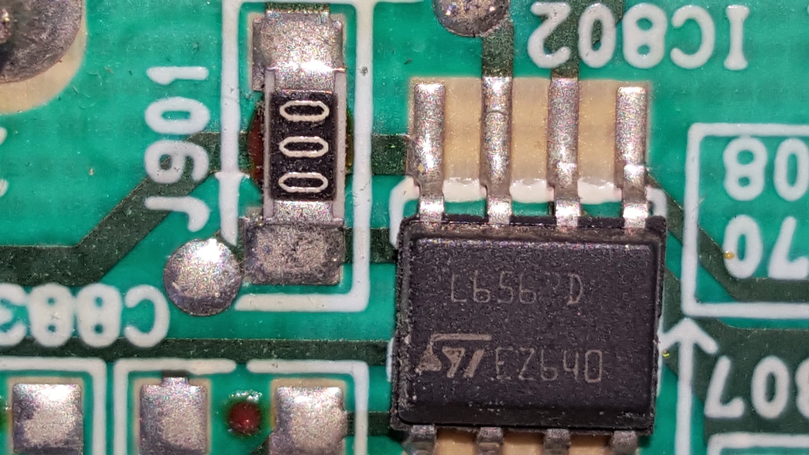

                                To answer Agent24, here is IC802.
                                  I can't see what the last digit is properly, but it's very likely either an L6561 or L6562 PFC controller, which makes sense. Certainly NOT a dual-MOSFET as the schematic says
                                  I am not sure why you don't get standby voltage without the mainboard connected. Does the working PSU have the same behaviour?
                                  The buzz\hiss from top right of PSU sounds like the PFC transformer running when the PSU is told to start up.
                                    L6568d
                                        Good question, the answer is definitely NO! The good supply has lot more life to it, though that pin 6 on PL803 is still low. However it does have 24V on the yellow & black sockets which the dead board doesn't, and also various other live pins where the dead one didn't. In fact the only output from the dead board is 3.4V & 5V on PL806.
                                        So this gives me some homework to do this weekend- or perhaps next week- I'm fed up going to bed with little green tracks in my eyes!
                                        PS IC802 is a L6562 on the 'good' board
