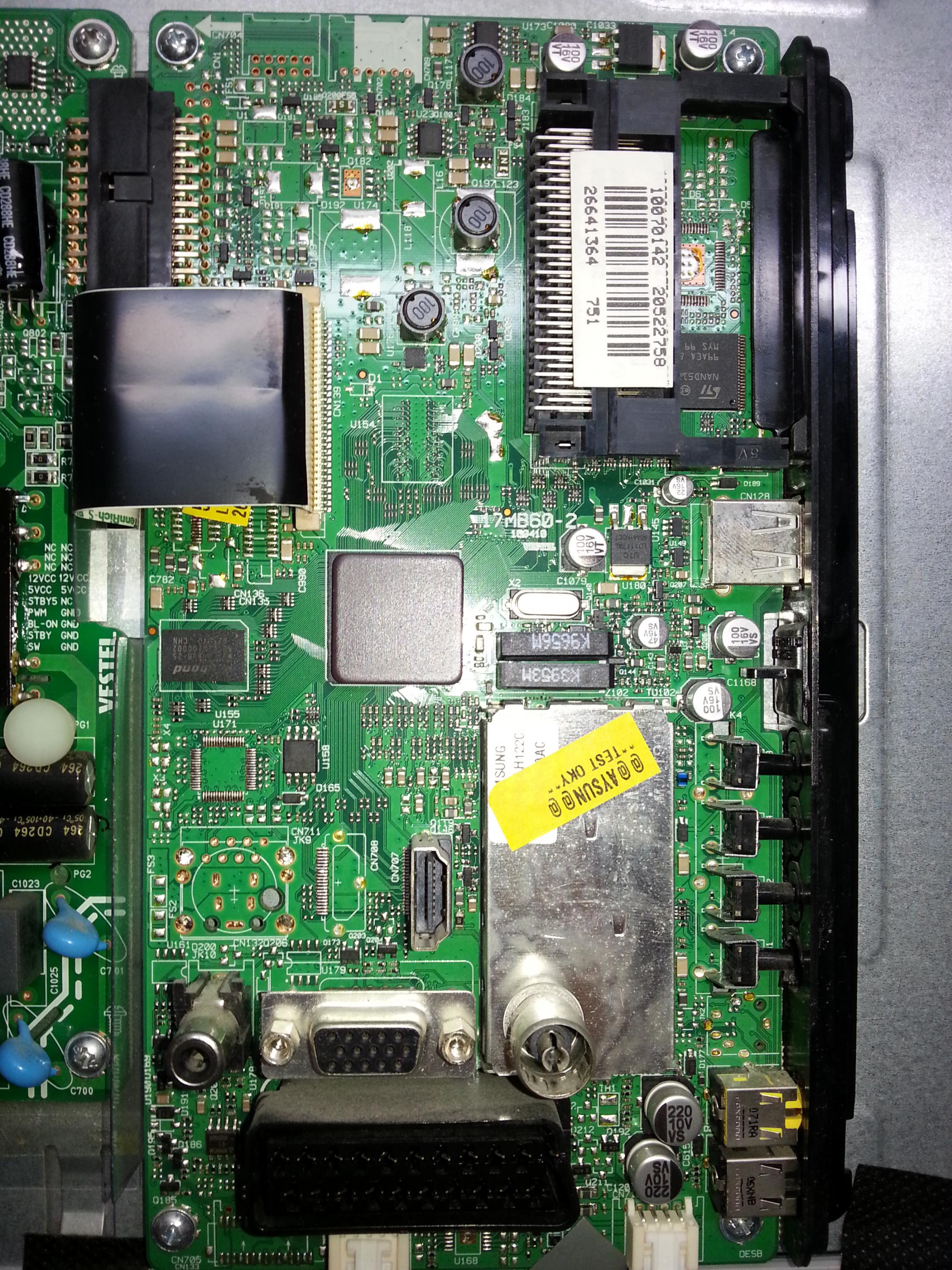

    Good day folks. As the title suggests, I've got this cheapy Finlux 22F905FHD LED TV which doesn't turn on. When you plug it in, the white led at the front begins flashing non-stop. I believe it's not a power supply issue, since measuring the outputs with a multimeter shows both 12v and 5v on their respective pins. I tried unplugging the flex cable that goes to the LEDs, but that didn't change anything either. I believe it's a bad motherboard I'm dealing with, more specifically a corrupt firmware, since I read in many places that firmware corruption is the most common reason for blinking power lights on these Vestel-based TVs. The MB is a 17MB60-2. I haven't actually done any "software repairs" on TVs before, though I've read about what should be going on: find the right firmware, place it on an USB drive, plug USB drive in, plug TV while holding in the OK key on the remote and it SHOULD flash the firwmare...or something along those lines. Could someone perhaps help me with this issue ? Feel free to correct me, of course...I can provide pictures too if need be.

    maybe this?
    http://files.elektroda.net/702162,fi..._17mb60-2.html

      Re: Finlux 22F905FHD power LED blinks continuously (possibly bad firmware?)
      Did run across that one, but I thought it's for a F906, whereas mine's an F905...might as well try it I guess
            Just tried the file suggested and unfortunately it didn't seem to do anything: I formatted the USB drive, copied the 3 files to it, plugged it into the TV, held down the OK key, plugged the TV in and it seemed to flash just like before. I read somewhere that the LED should blink faster if done right....I either got the wrong files, or there's a dead component indeed, in which case it's going in the bin, since the time/effort required to work it out doesn't make it worthwhile.
              freeze the eeprom/spi flash chip on the mainboard does the set come on?
                I can't say I'm too sure which one the Flash is, though I imagine it's the SOIC at the bottom left of the main IC. I'll try it as soon as I get hold of my trusty can of air which is at home right now
                  u158 i think i have attached a schematic if you have not already got it
                    I just tried that and no, it doesn't.
                      not sure what to suggest now unless you can remove the ic and program the files you downloaded on to it as it may work that way but as such a small tv, i dont usually bother repairing less than 26in sets no one seems to want any smaller sets nowadays.
