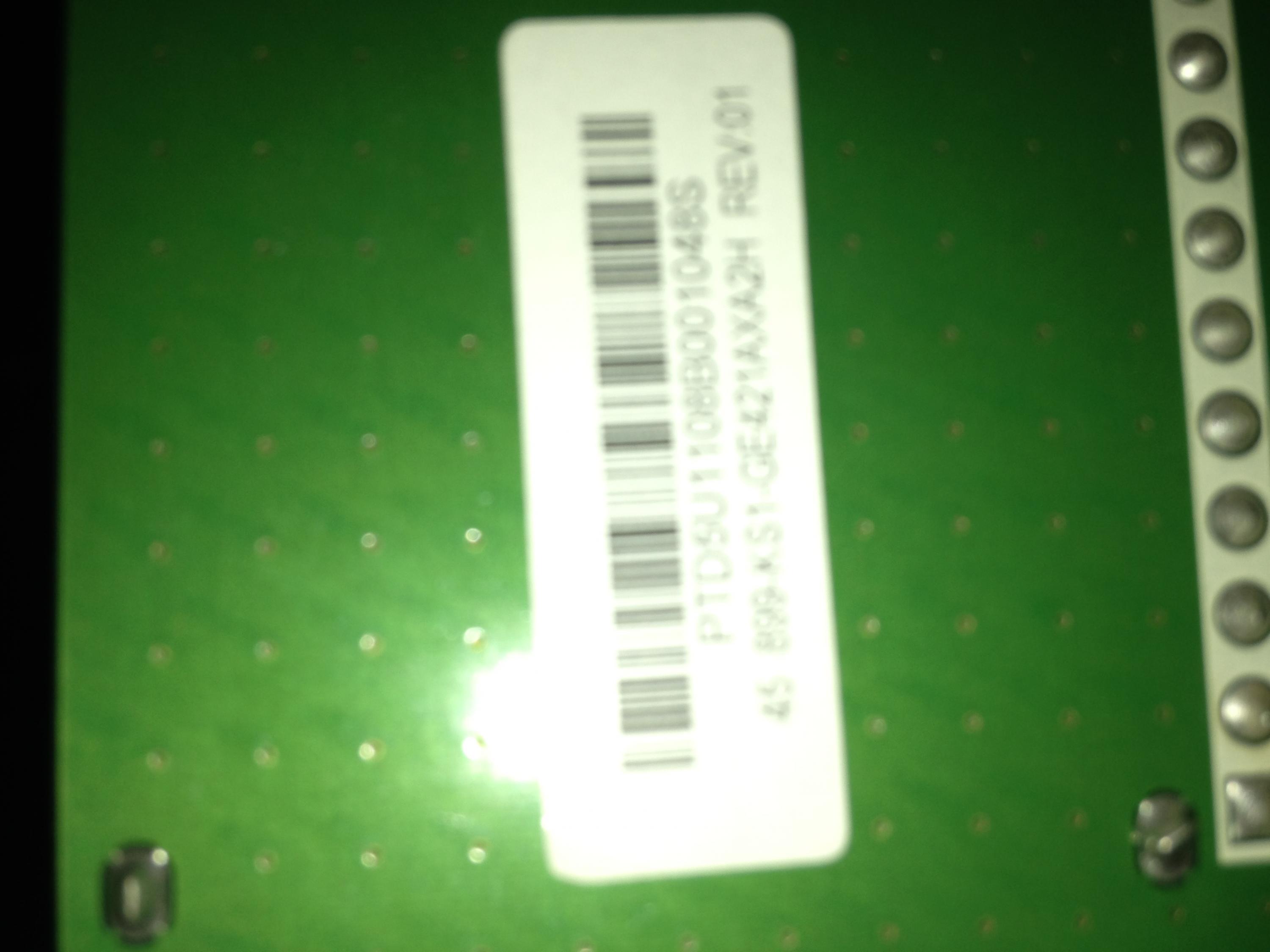

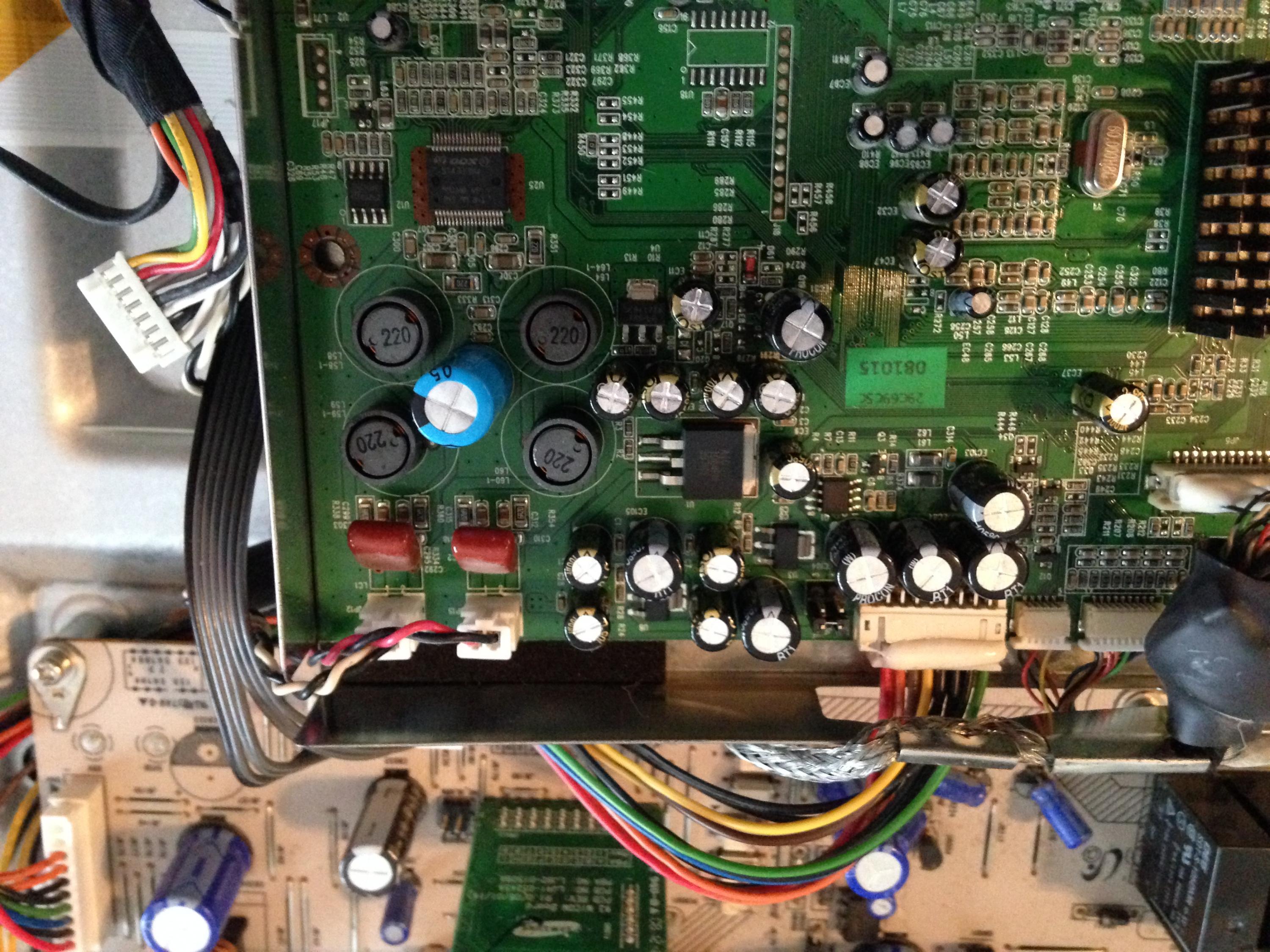

    i wasnt on about the circle more the tuner looks soldered to that board is that the board you have now ordered to swop?
    No, It's the logic board mounted underneath th 1 shown.

      Re: 42"Fluid plasma tv Mod#(Samsung)pn50b550t2f
      the board you was jumping the pins on? just trying to make sure you have ordered the right board you need

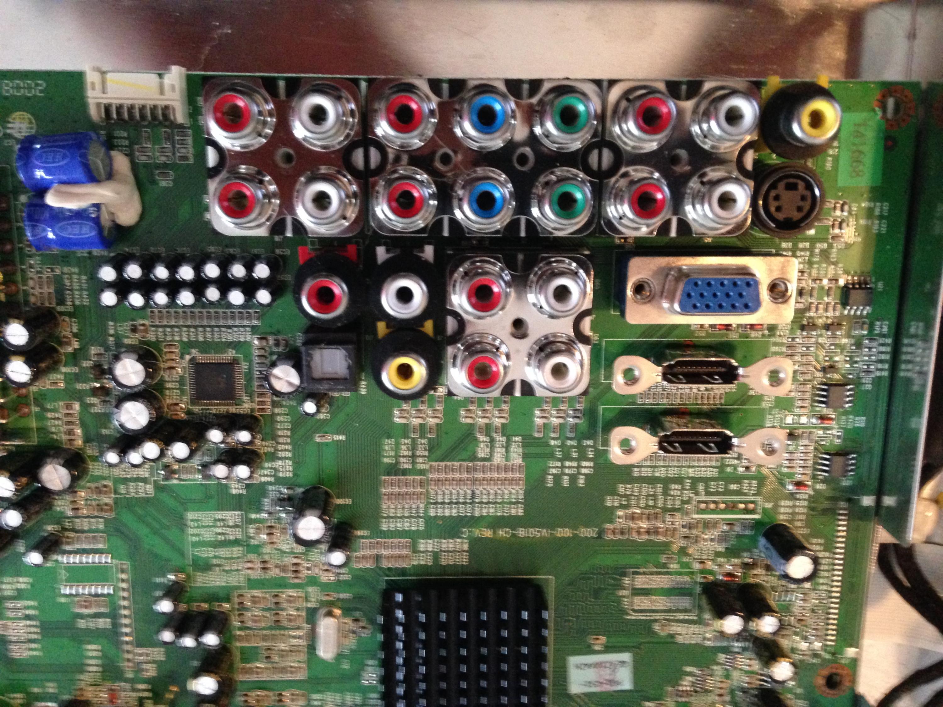

                post 12 reece mentions mainboard? i class the logic board/tcon,the mainboard i class is the one with inputs ie tuner/hdmi scarts etc im only trying too make sure its the correct board saves you wasting time reece may see this thread soon and assure us which board needs to be replaced it maybe me wrong so dont order one just yet.
                      Mainboard-hdmi inputs etc.
                            the picture you circled that wrong lead in blue thats the board you need with the hdmi ports on (post 36) whats the part number from that board? we need the part number from the board in your tv so we know its the right one

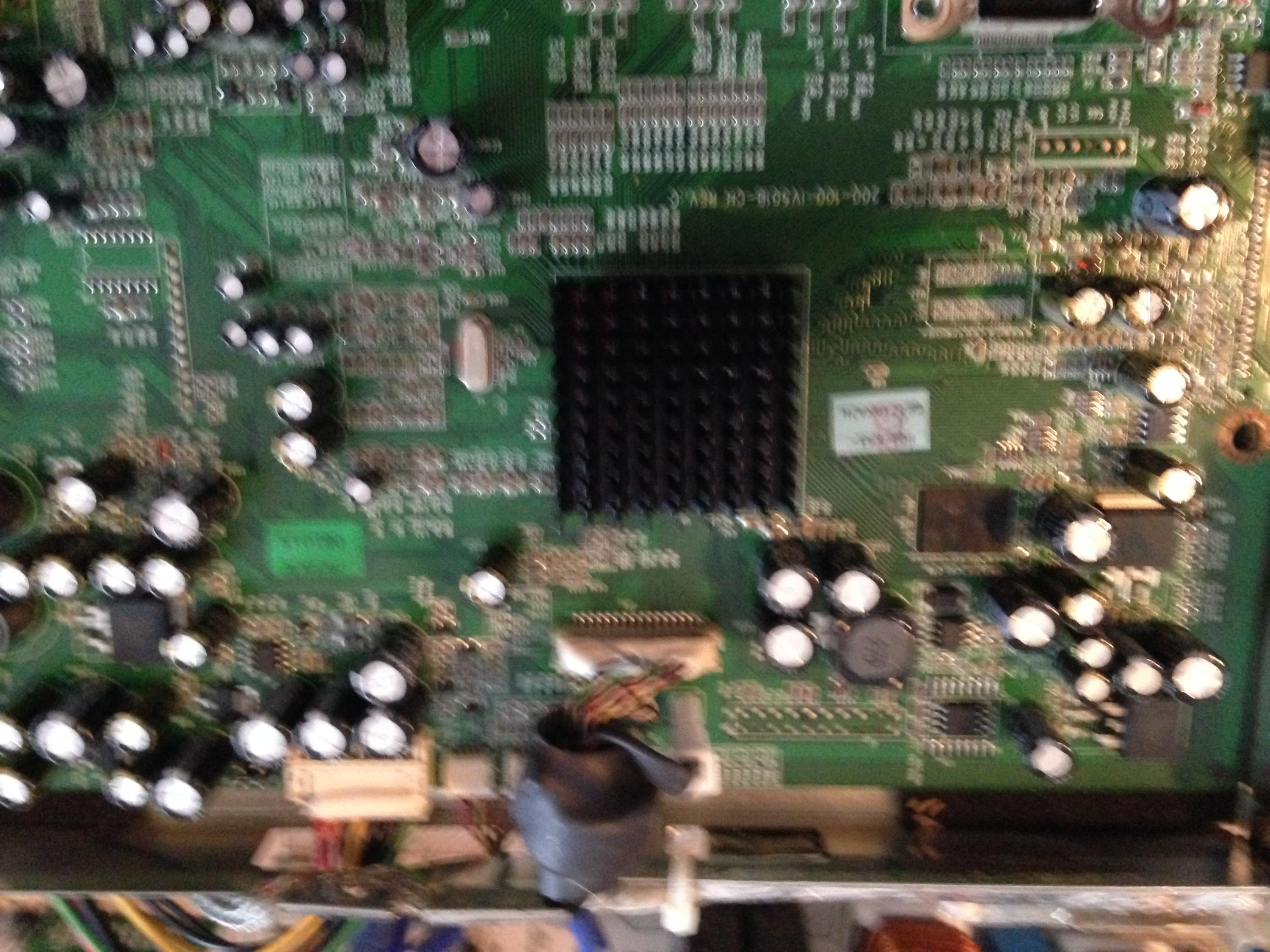

                                      pic 1 above the black heat sink whats that long number?
                                      • rich-t
                                        • Dec 2016
                                        • 70
                                        #79
                                        That no. is 200-100-iv501b-ch rev c.

                                          on the top right main logic board it has the following no's
                                          model no. 42 hd wd w3 lm
                                          pcb no. LJ41-05078
                                          REV. R1.729 (08 03 26
                                          NO'S ON MAIN BOARD- TAG ON CABLE TUNER
                                          TD 1636EF / FGMP-2
                                          3139 147 269819
                                          0818 SV20 000000
                                          SMALL GREEN TAG 29C69C5C
                                          O81015
                                          SMALL BLUE TAG P0151-
                                          ge421axa2h
                                          bottom small green tag
                                          141668
                                          Tag under bar code bottom of main(tuner board)
                                          ptd5u1108b00104
                                          45 899 ksige21axa2h rev.01
