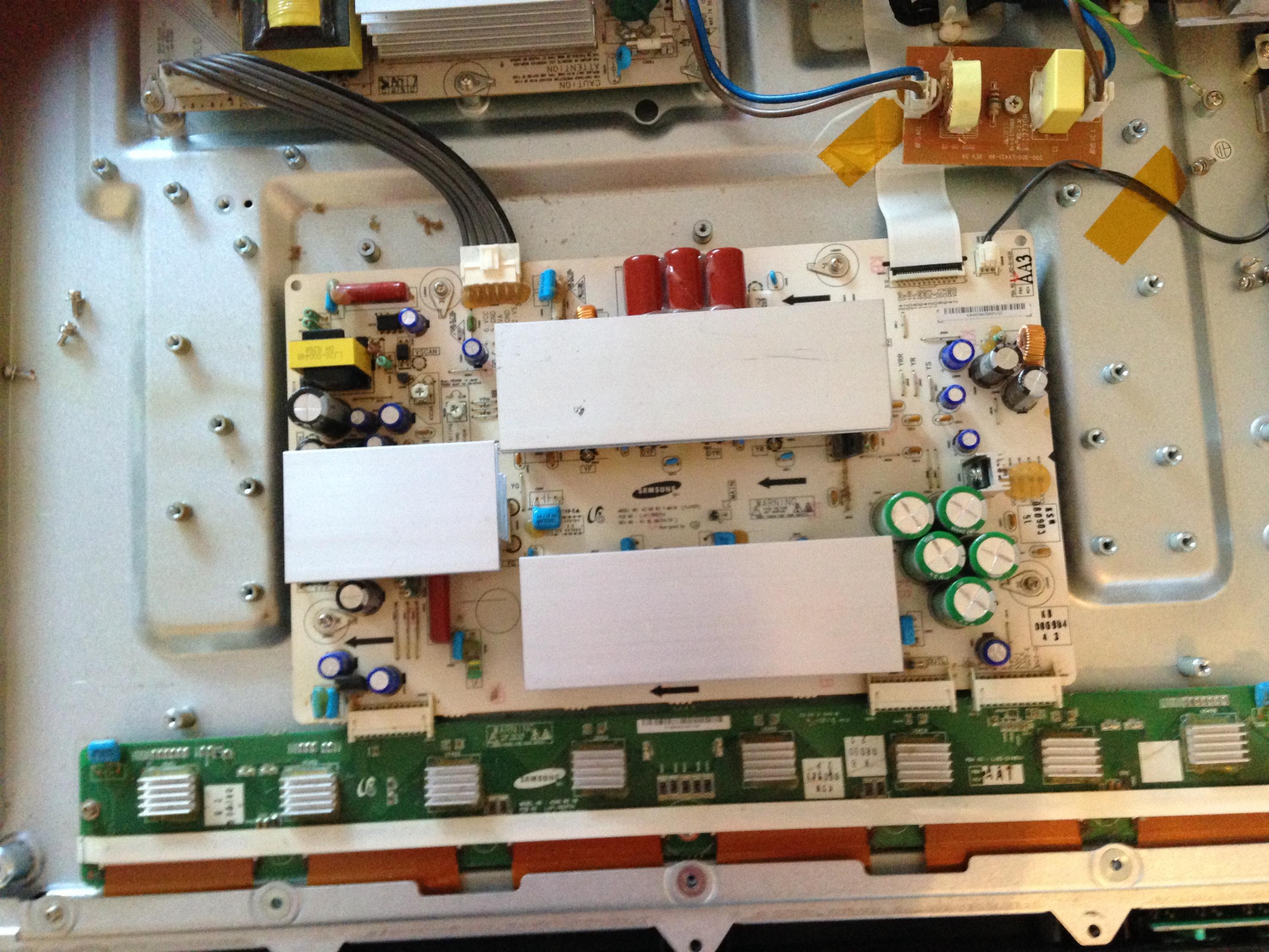

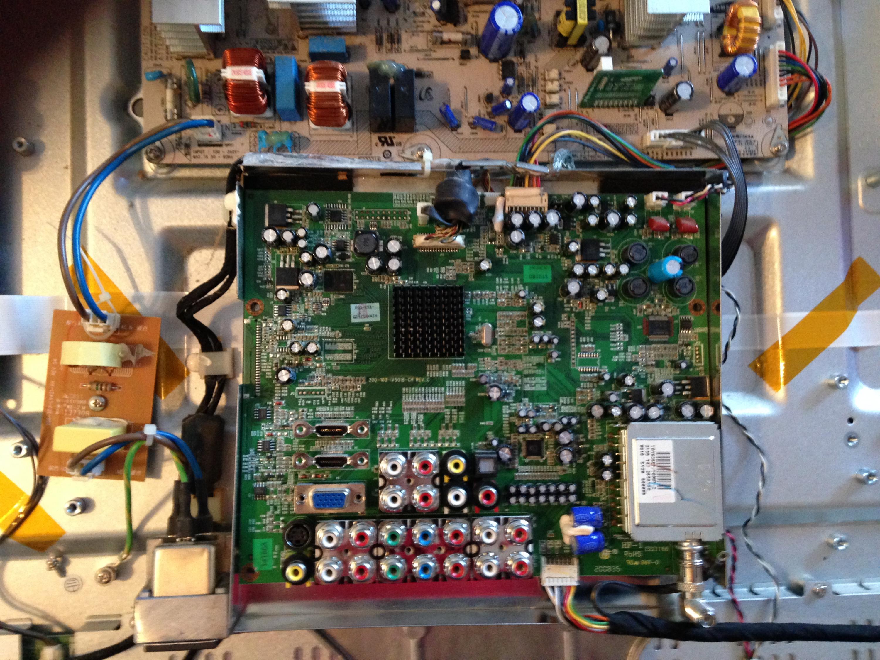

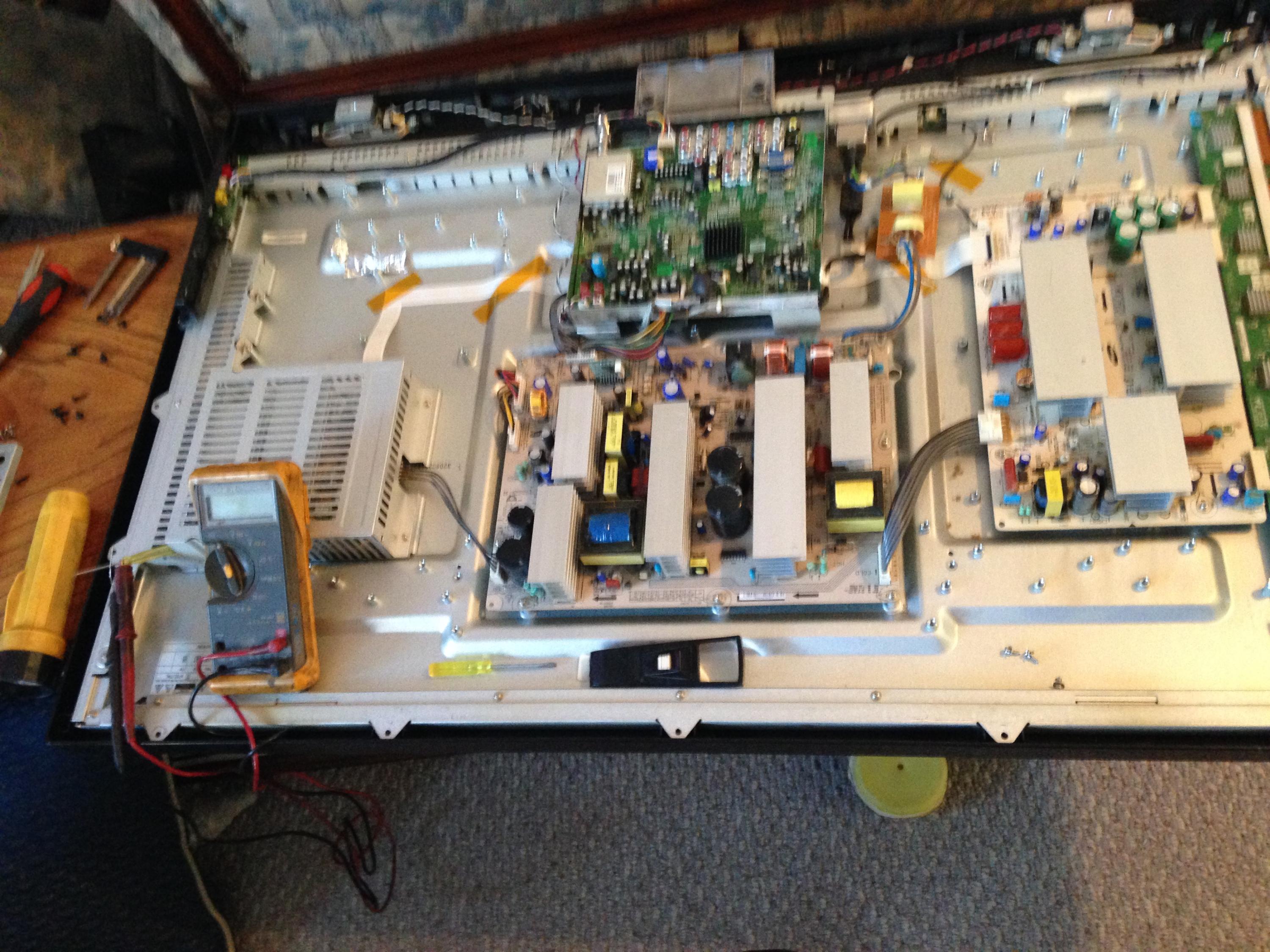

          Re: 42"Fluid plasma tv Mod#(Samsung)pn50b550t2f
          Here are some pic's of the boards,I've removed the cover from the left X? board and the I/O board, I think the logic/control is the 1 that's underneath it.
          I'm going to try to get the voltages listed on the sticker.
            Here are the voltages as read from the ps board and sticker values.
            Va-54, actual=54,Vs-207,actual=206,Vso-190,actual=191, Ve-95, actual=15 x
            It looks like Ve is the problem but I don't know how to fix it..
              Ok seems there is a problem on the Xmain as Ve only 15v. Have you tested the pcb for short circuits L
                        Well seems like your mainboard is the fault, have you ran the Samsung test patterns ?

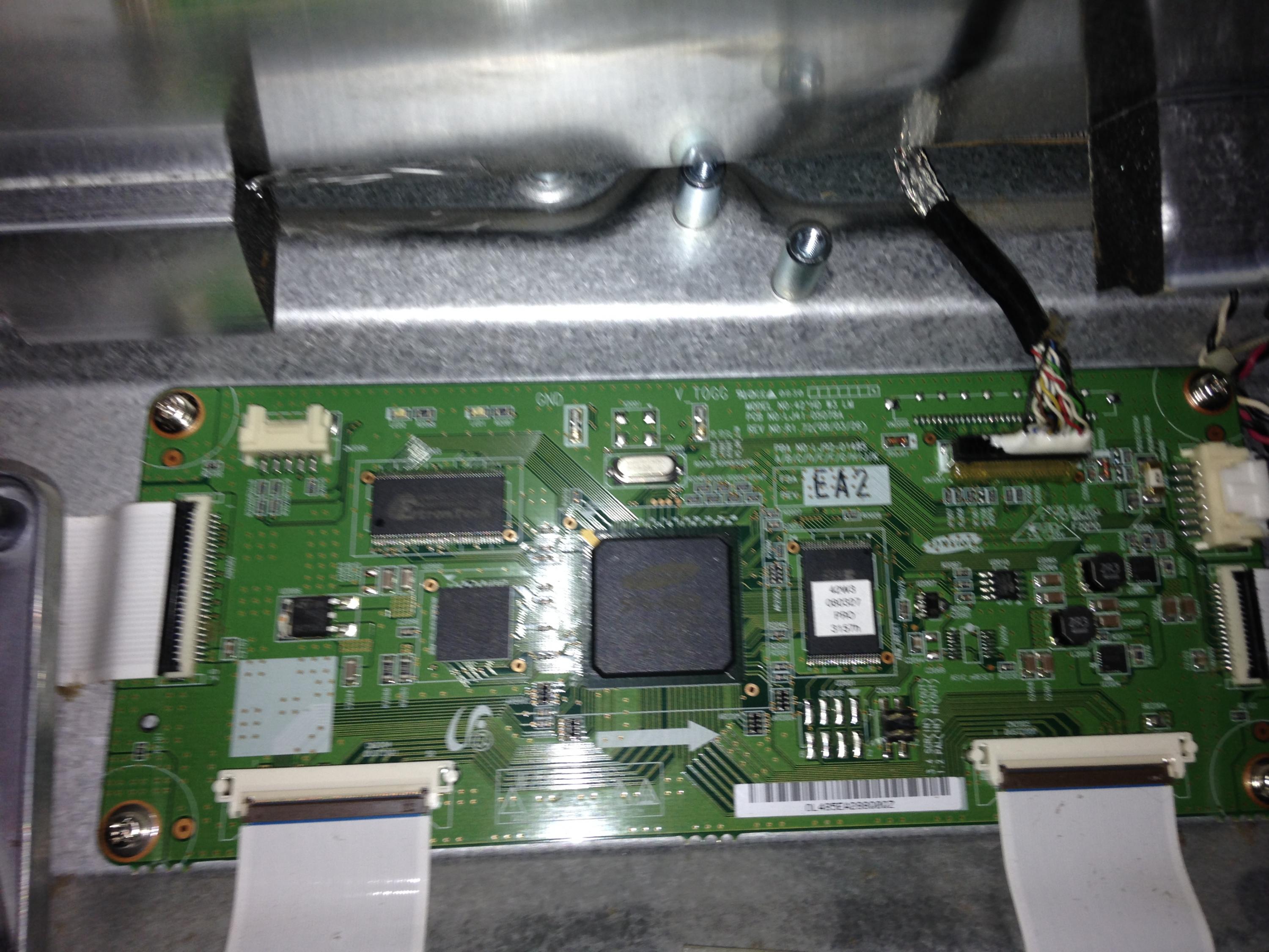

                            Ahh dont worry, also remove the mainboard tray out of the Tv and there should be a board under that if so can you get us a picture of it please ?
                              this is logic/control board ??
                              It's got a green flashing light, about 1 per sec.

                                • rich-t
                                  • Dec 2016
                                  • 70
                                  hello Reeceyburger123, I think this is the board where I jump a couple of terminals to get the test patterns, can you tell me how it goes?? Thanks.
                                    Jump the pins that say Pal 1-2 and or 4-5 apply power to the Tv. Not got time to reply quick atm sorry.
