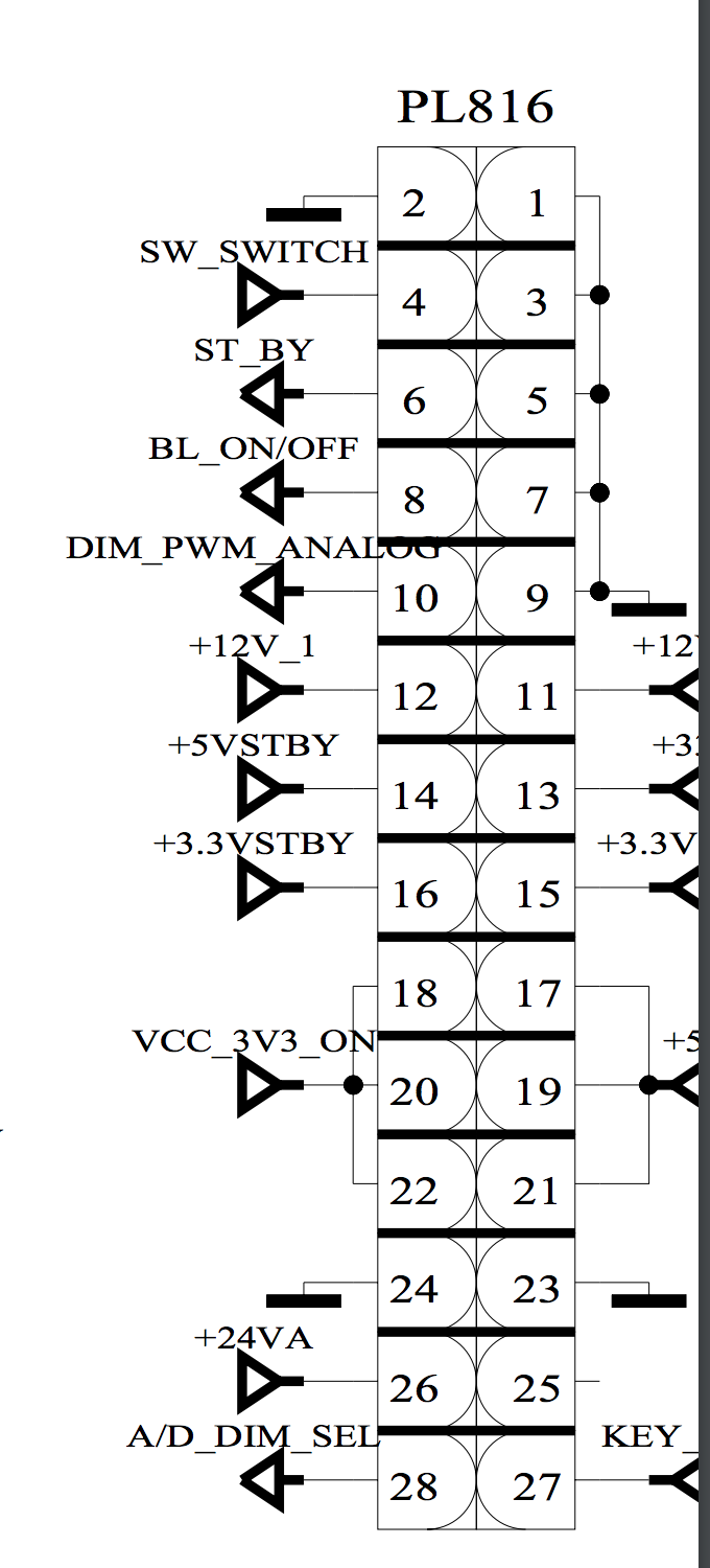

I've replaced the main board with one bought off ebay. I see same issue. This made me believe it's a psu issue? I know these 17PW26-4 board has many issues but I see no physical faults; no swollen caps, or any faulty fets.

Voltages tested at all ? Remove Mb connector and connect Psu if its working it will bring up all voltage rails 24v, 12v, 5v, 3.3v. Cant help further until you help us, what you expect us to list every fault with this set with no voltages lolPlease Do Not PM My Page Asking For Help Badcaps Is The Place For Advise, Page Linked For Business Reasons Only. Anyone Doing So Will Be Banned Instantly !

Based on the schematics at PL816, Im not getting those voltages. Bad transformer? The main huge cap is making a humming sound -- seems normal.

Heres a schematic but im sure reece has mentioned in the past you just measure at the diodes? not sure if this scematic will match your board as they do alter them etcAttached FilesComment

Thanks but I've found the schematic. Just not getting those voltage.Full-time computer repair tech (10am - 6pm) and full-time, (8am - 11pm), Ruby on Rails DeveloperComment

But I tried a main board, not psu, off ebay and same?
Pin / Voltage:
1: 0
2: 0
3: 0
4: 7.8v
5: 0
6: 0
7: 0
8: 0
9: 0
10: 0
11: 11.87v
12: 11.87
13: 0
14: 4.99
15: 3.4
16: 3.4
17: 5.13
18: 3.4
19: 5.13
20: 3.4
21: 5.13
22: 3.4
23: 0
24: 0
25: 0
26: 24v
27: 0
28: 0
Would the inverter board plays a role with the flashing blue led?Last edited by speedypro; 12-10-2016, 07:08 AM.Full-time computer repair tech (10am - 6pm) and full-time, (8am - 11pm), Ruby on Rails DeveloperComment

Im still learning so bear with me but what do pins 1/3/5/7/9 do? as 12v is missing too themComment

just found a better schematic it dosnt look like those pins are used i wonder if you have another bad mainboard?Comment
