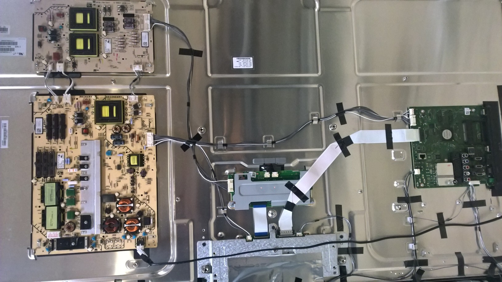

    I got a Sony KDL-55EX723 with 4 blinks.
    It starts up with proper picture for two seconds, then 4 blink code.
    0 no red standby light-check powercord or bad main logic board or power board, check standby volts
    1 red blink not used
    2 red flashes is bad power board, solution replace power board
    3 red flashes is bad main logic or power board, check for standby volts if ok replace main logic board
    4 red blinks- can be LD board or main logic board, check inverter board wires for arcing to ground
    5 red flashes- bad lcd panel connection or internal lcd short- squeeze bezel to locate bad connection
    6 red flashes- backlight issue, bad main board, or power board or inverter boards- check standby volts on power board. "backlight on" volts should be 3-5v from main logic board then 24v to inverter
    7 red flashes- main board over heating, can be short on power board or main logic board
    8 red flashes- main board sp prot, try power reset, update with usb, or replace main logic board
    9 blinks- check fan error, * if TV has fans
    10 blinks- digital board or tuner board * some Sony TVs may not have this board
    11 red flashes- bad main board, bad IC, replace main logic board
    12 red light flashes is tcon error bad T-con board or bad LCD panel, replace tcon board usually
    13 red flashing is backlight balance error bad lcd panel or inverter boards (common) or bal board on kdl-52v4100 only, replace inverter board usually then main logic board
    14 red flashes HFR- bad TCON or Bad LCD panel, replace tcon board. unplug tcon board if tv stays on without tcon board replace tcon board. "como sony tv reparación"
    No arcing can be seen, but I am not sure what to check on LD board ??

    I changed the LD board from another working set, but that didn't cure the 4-blink code.
    I also changed the PSU and LED supply board from the same working set, no change.

      It's an edge lit set. Are you confident that there is not an led problem?
      • PowerAmpFreak
        • 982
        • Sweden
        Re: Sony KDL-55EX723 4 blinks...
        Of course not sure.
        So the problem is within the panel which makes it hardly worth fixing ?
