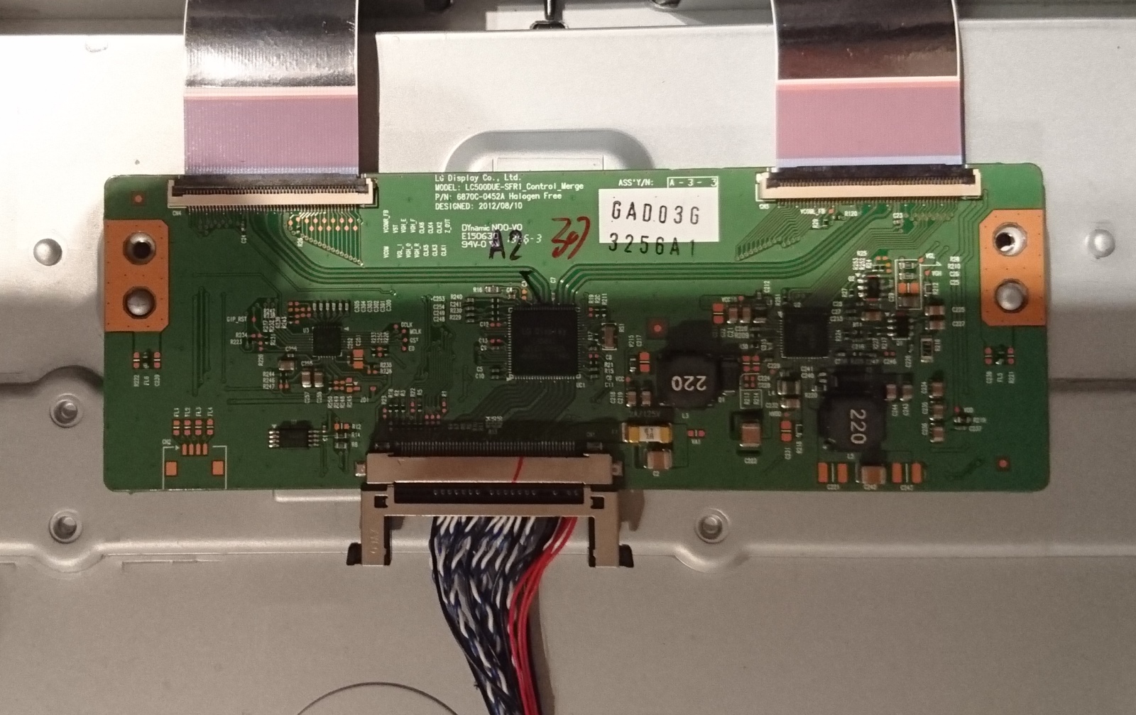

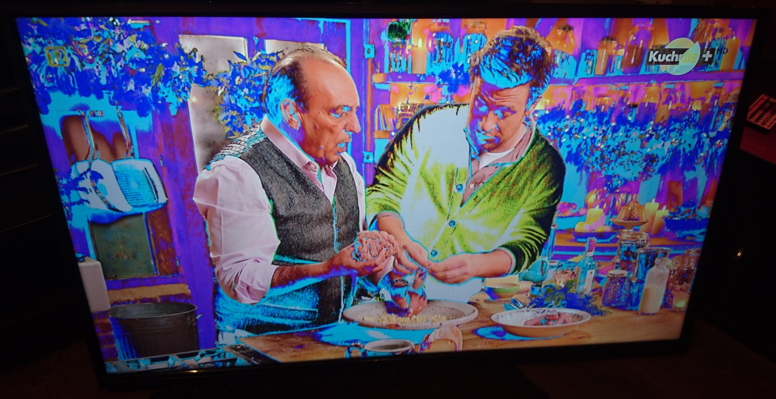

    I've got now 50" LED TV.
    See pictures for color problems.

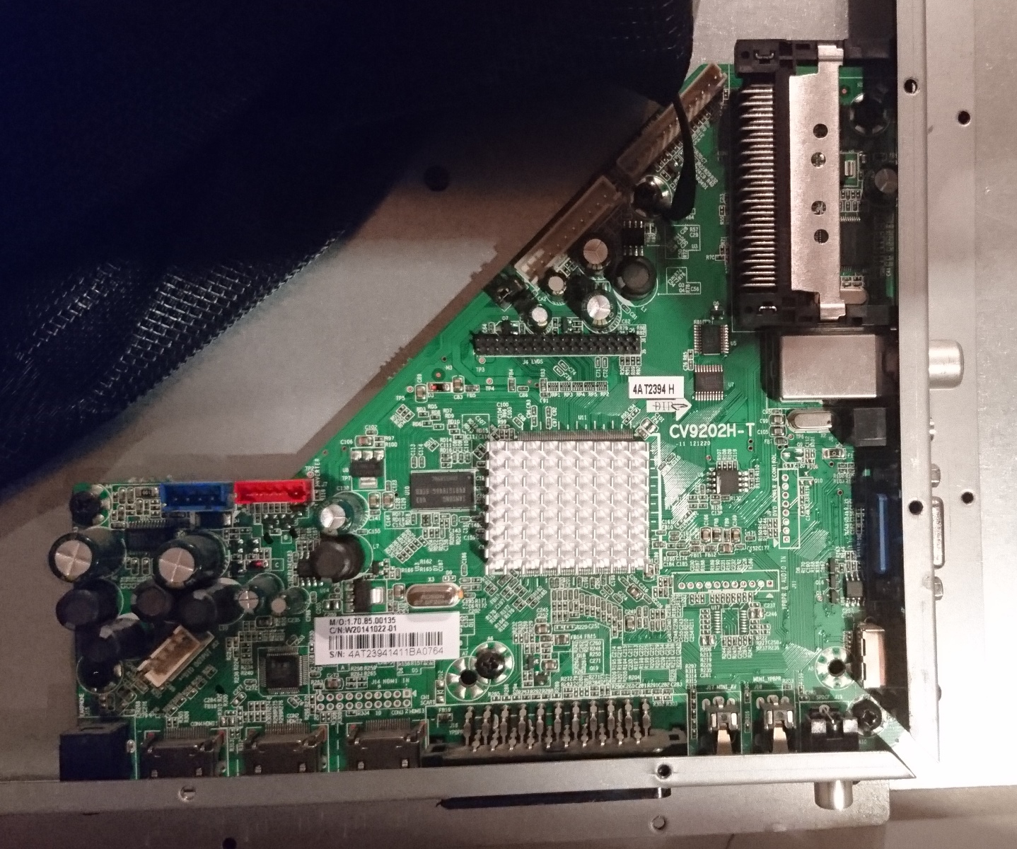

    LVDS / T-CON board and main board has been replaced, still same problem.
    Ain't got clue what's wrong.
    Thank you for any help.

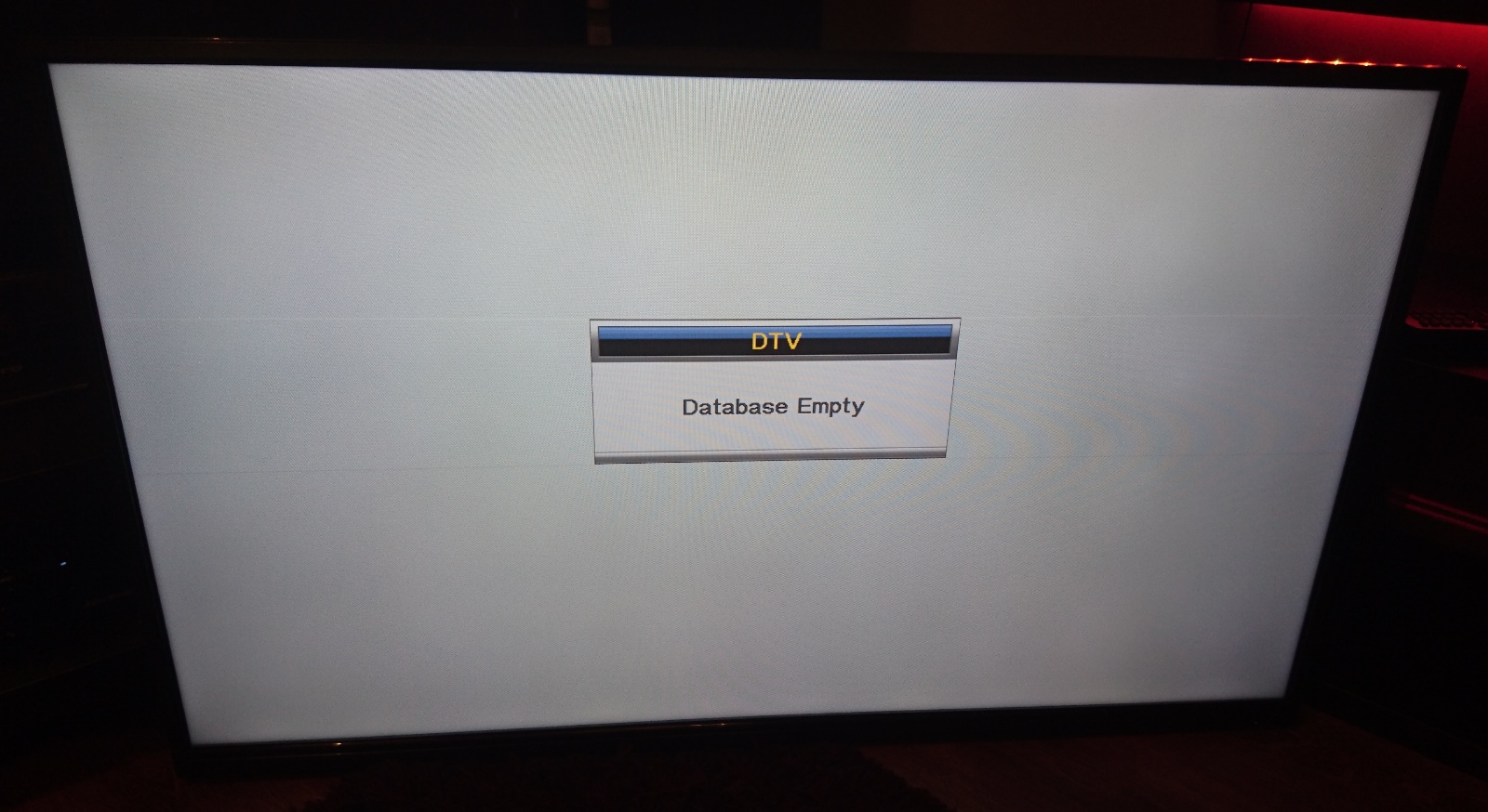

    Re: GOODMANS / CELLO G50238DVBT2 50" LED TV, solarized picture.
    Background on the second picture was black when TV was OK.
      It certainly looks like a solarized picture. Have you selected the correct Panel from the service menu. The replacement mainboard could have been set up for a different panel. I see that there's also a jumper link close to the LVDS socket on the main board for what purpose though I don't know.
