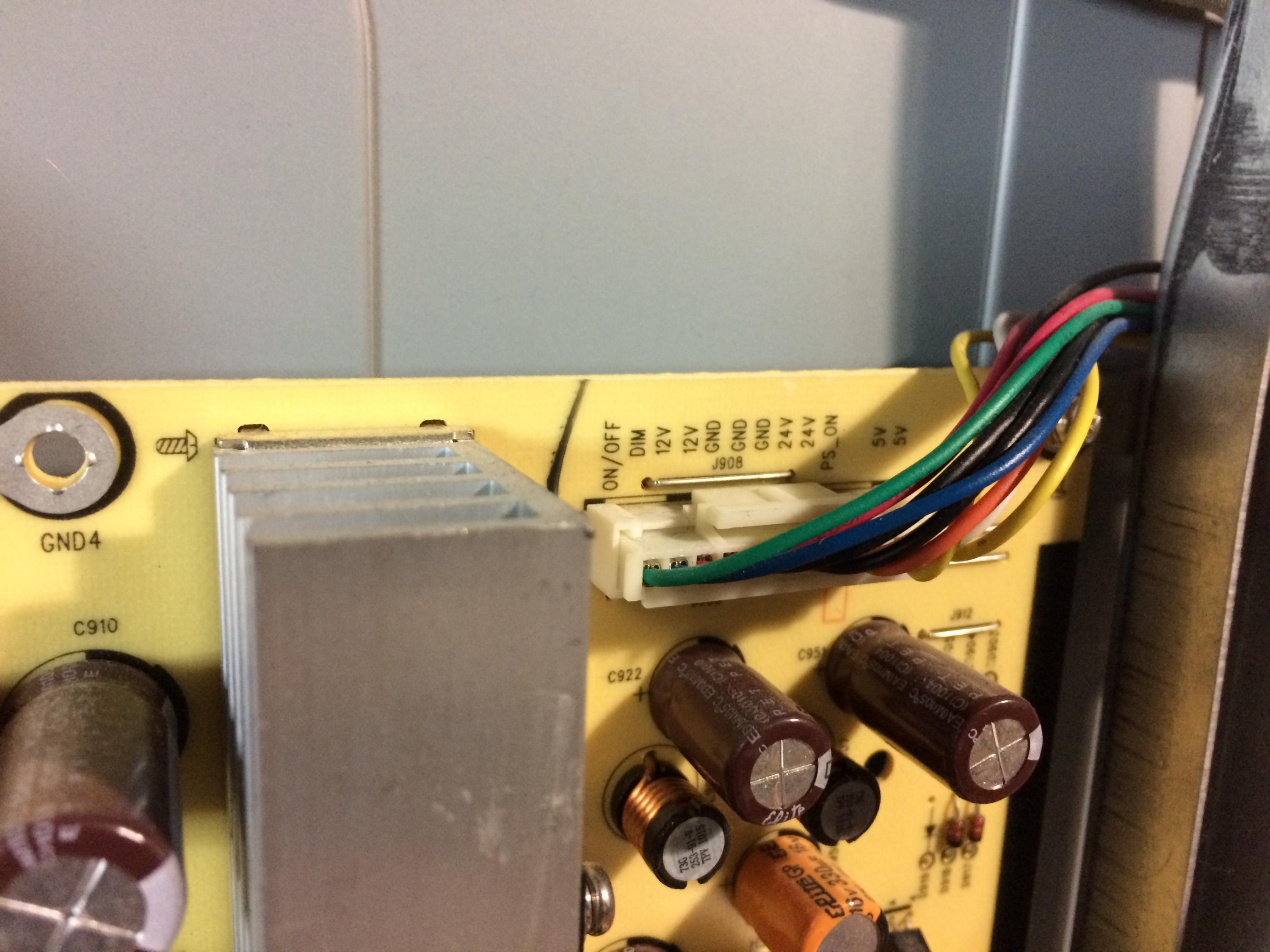

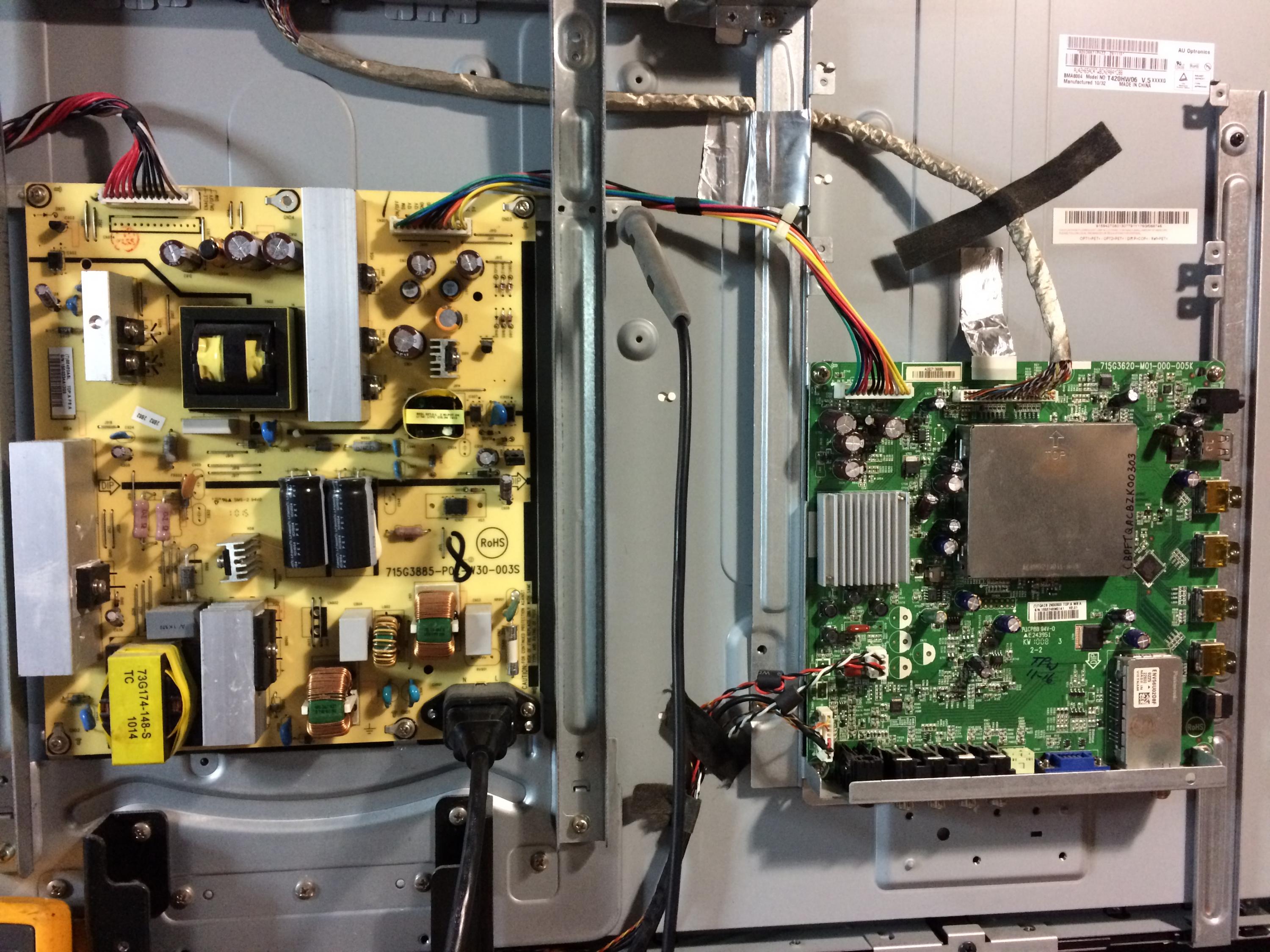

    I have this Insignia TV model number NS-42L550A11 that doesn't turn on. The front led looks red which means off, I press the power button and it doesn't change to blue (which indicates on).
    I ordered a new main board from Tri State module but Im still having same problem. If I jumped the PS-ON with 5V pin the backlight turns on, which makes me believe the power board is good.
    Any help is appreciated. Did I get a defective main board from this "reliable" tv parts provider?
    Thanks. Pictures attached

      So what DCV do you have on those pins when TV is OFF and when the power switch is activated?

        Measure the PS_ON pin voltage as you press the "ON" button to see if it varies.

          As soon as I plug in the power cord I get these voltages:
          on/off: 0.13v
          DIM: 0.16
          12v: 12v
          12v: 12v
          GND: 0v
          GND: 0V
          GND: 0V
          24v: 24V
          24v: 24v
          PS-ON: 2.3V
          5v: 3V
          5V: 3V
          LEd in front shows red color.
          When I press power button, nothing changes. PS-ON remains exactly the same. It doesn't fluctuates.
          Now when I check voltages on power button itself, I get 2.9v and it drops to 0.9v when I press button.
            Re: Insignia NS-42L550A11 No turning on
            The main board is not sending these two signals: the BL-ON (ON/OFF), DIMMING.
              Thanks Budm. TSM Module not reliable as it used to be.
