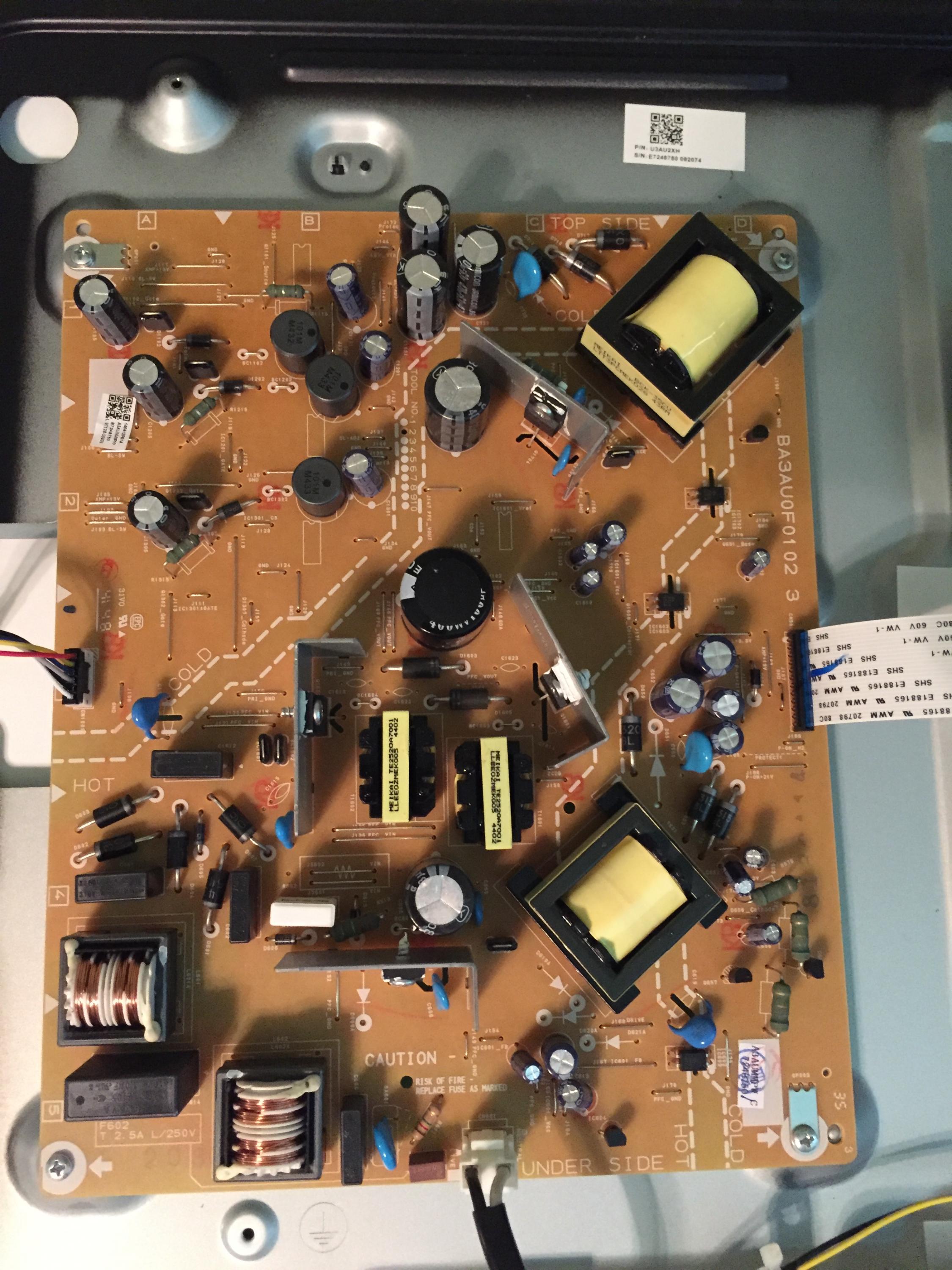

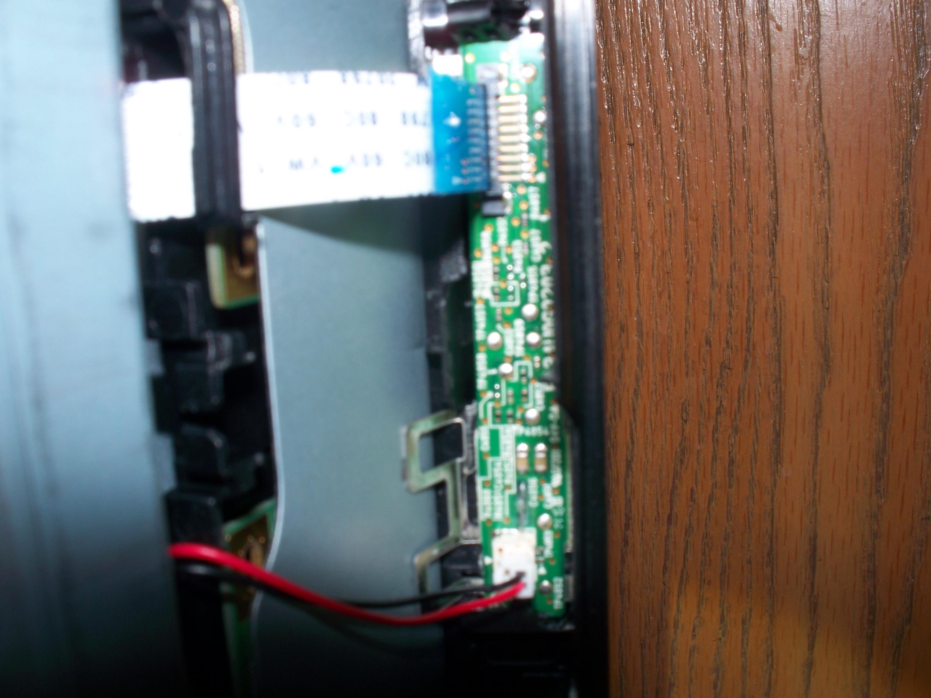

    I have been troubleshooting this tv for a little while, and now I need some expert help. It was working fine for about 10 minutes one morning and then just went dead, with no standby light. After doing some research, I replaced the main board, which didn't help. I then ordered a replacement ps board, but was shipped a different version than I ordered. I couldn't see any difference between my ps board and the replacement, so I tried it in the tv. The standby light came on, and it would try to turn on, but then the red light would flash a few times. I tried the ps with both main boards to see if I would get the same result, and I did. So now I'm pretty sure its the ps board, and the replacement just wouldn't work with my tv. It has been hard trying to find a replacement ps board, so I am trying to repair the board myself. I've taken many of the components that I've read fail often out of the circuit and tested them and have found all of them good, although I just checked the caps with a dvm and not a ESR.
    Some details:
    I have 160v at pfc_vin
    I have 11v at the p-on+21v
    I have 3v at the all+3.3v
    I have 3v at the p-on_h2
    I have 6v at the amp+13v.

        I've read through the other post and here are my findings so far. I've put a 1k resistor across the 3.3v and p-on-h2, with 2.5v on p-on-h2. I still have only 11v at the p-on+21v, and 6v at the amp+13v. I've jumpered across the 3.3v to the j106/bl-sw with a 1k resistor and the display did not come on. I've checked the voltage at the protect 1 and protect 3 and get <1v on each.

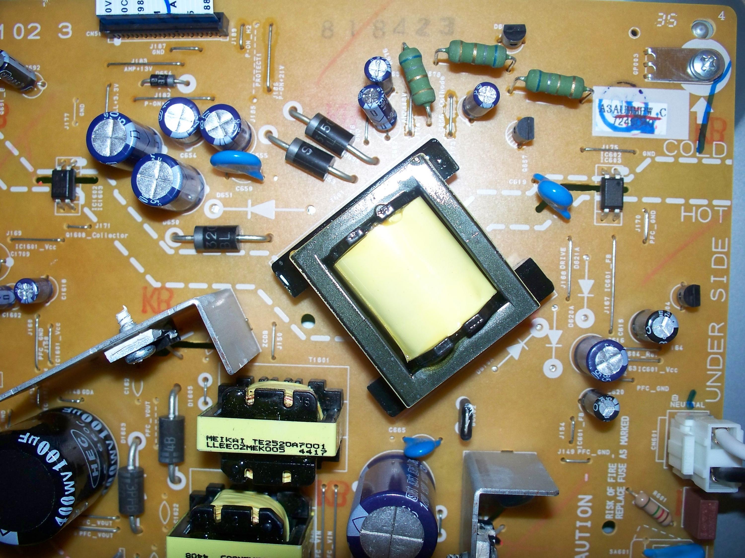

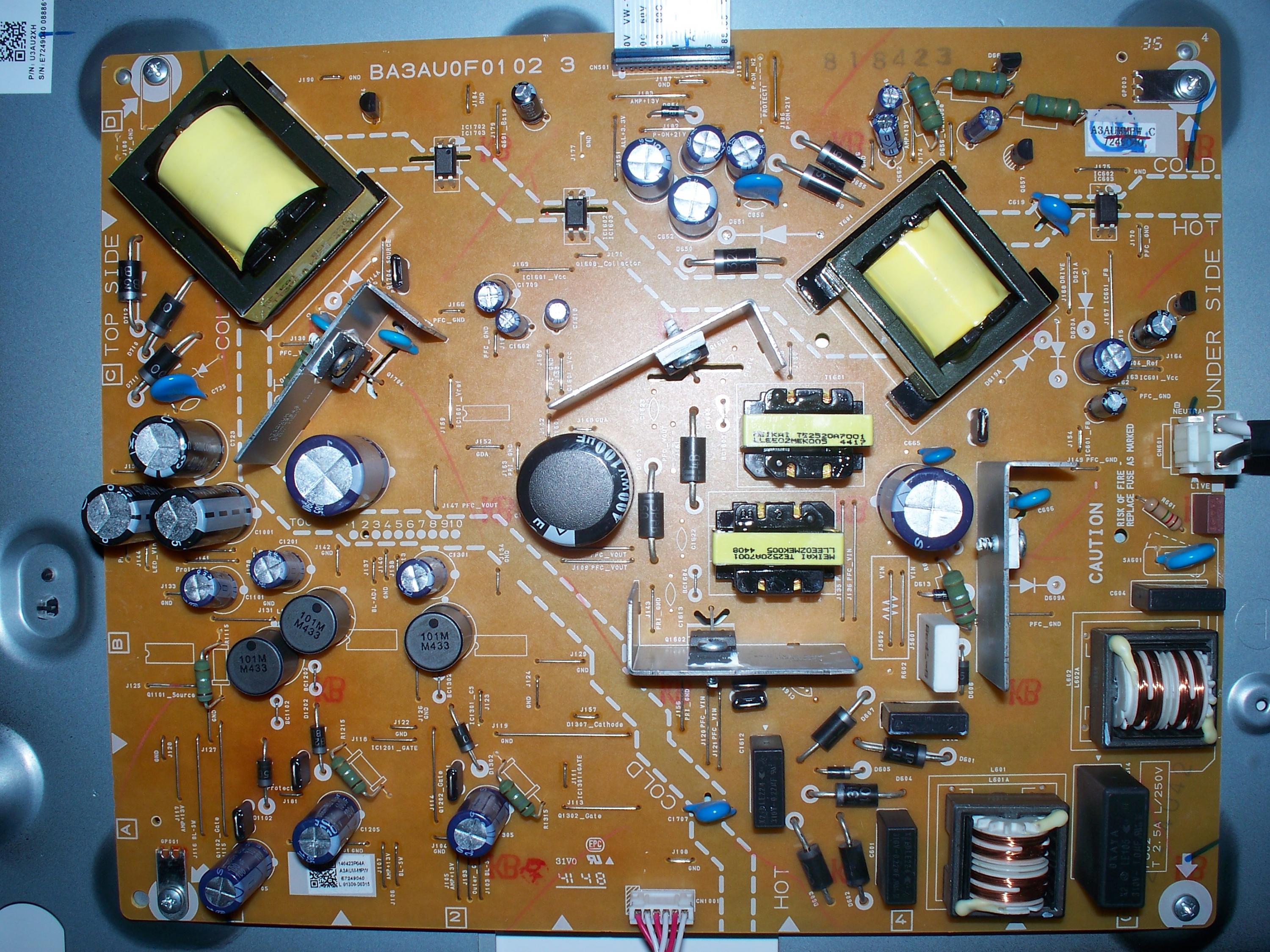

          I have this exact set on the bench at present, showing the exact same symptoms. And low and behold the exact voltages listed in the above post. I have followed the service manual to try to track down the culprit to no avail. Nothing Ive tried will bring it to life. All I get is a red standby light after its unplugged for about a half hour. Ive tried jumping resistors resetting ribbon cbls. Heat, Im stuck on this one. Anyone feeling they might have a clue please post.Im at wits end.Post some pics of all 2 boards may help. Thanks guys.

              It looks as though the PFC operates by driving two mosfets to produce the 395V. Check Q1601 and Q1602. I think only one of them is working which is why you have half the output voltages. If you give the DC voltage across C605 it may provide a clue.

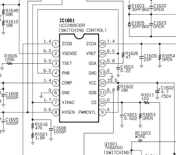

                        Did you download the diagram from the link to the other post. You will need to find out if the PFC IC is getting the switched VCC to run or not.

                          Do you have the voltages given especially at VCC (Pin 12)

                            I'm getting 8v at IC1601 vcc. Should I be getting around 15.6v?

                              Should be getting 15.6V according to the manual which is attached. That is with P-ON-H2 connected to AL+3.3v using your 1K resistor and mainboard disconnected.
                              Check components highlighted in the flow chart on page 24 of manual
