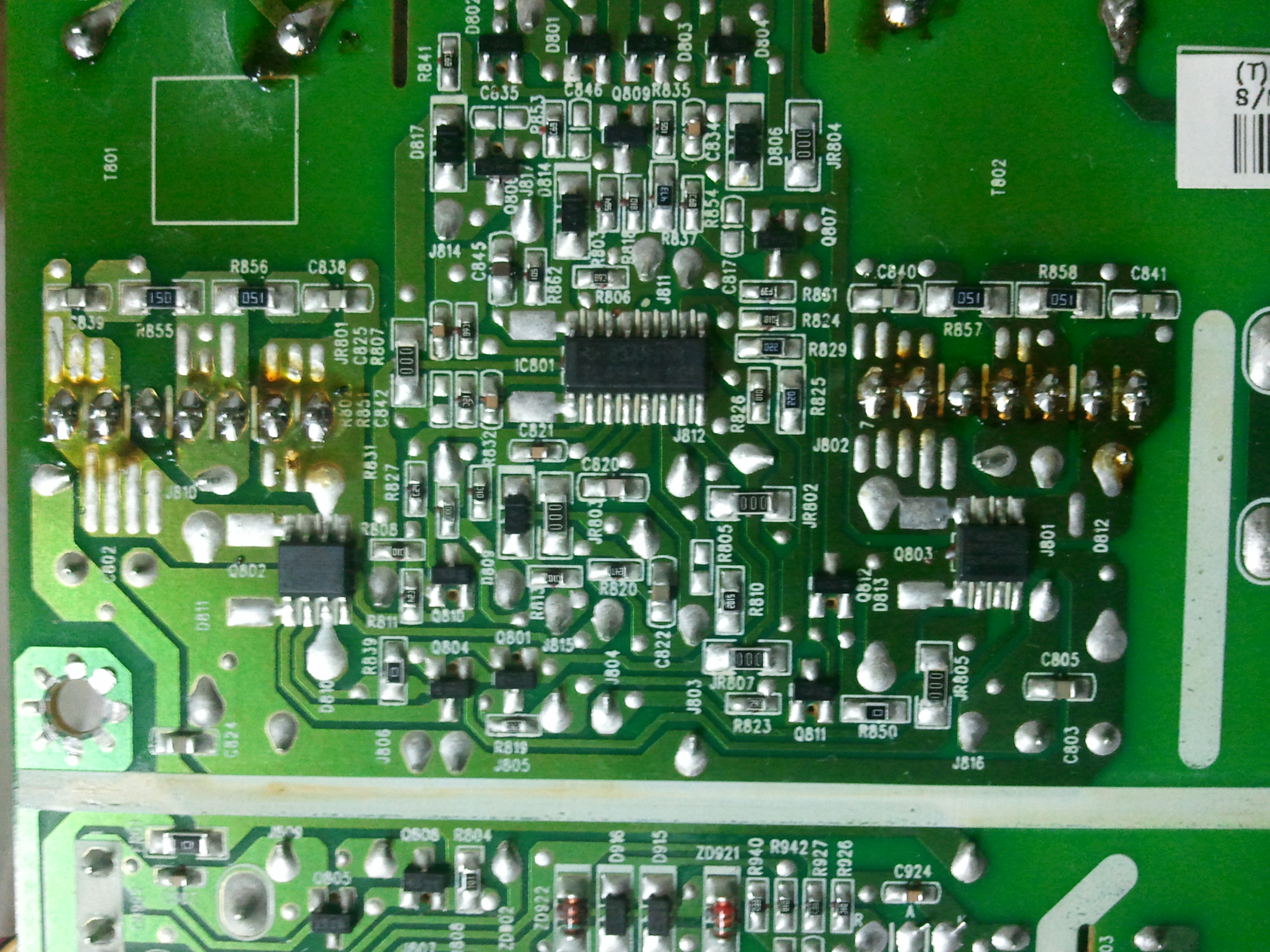

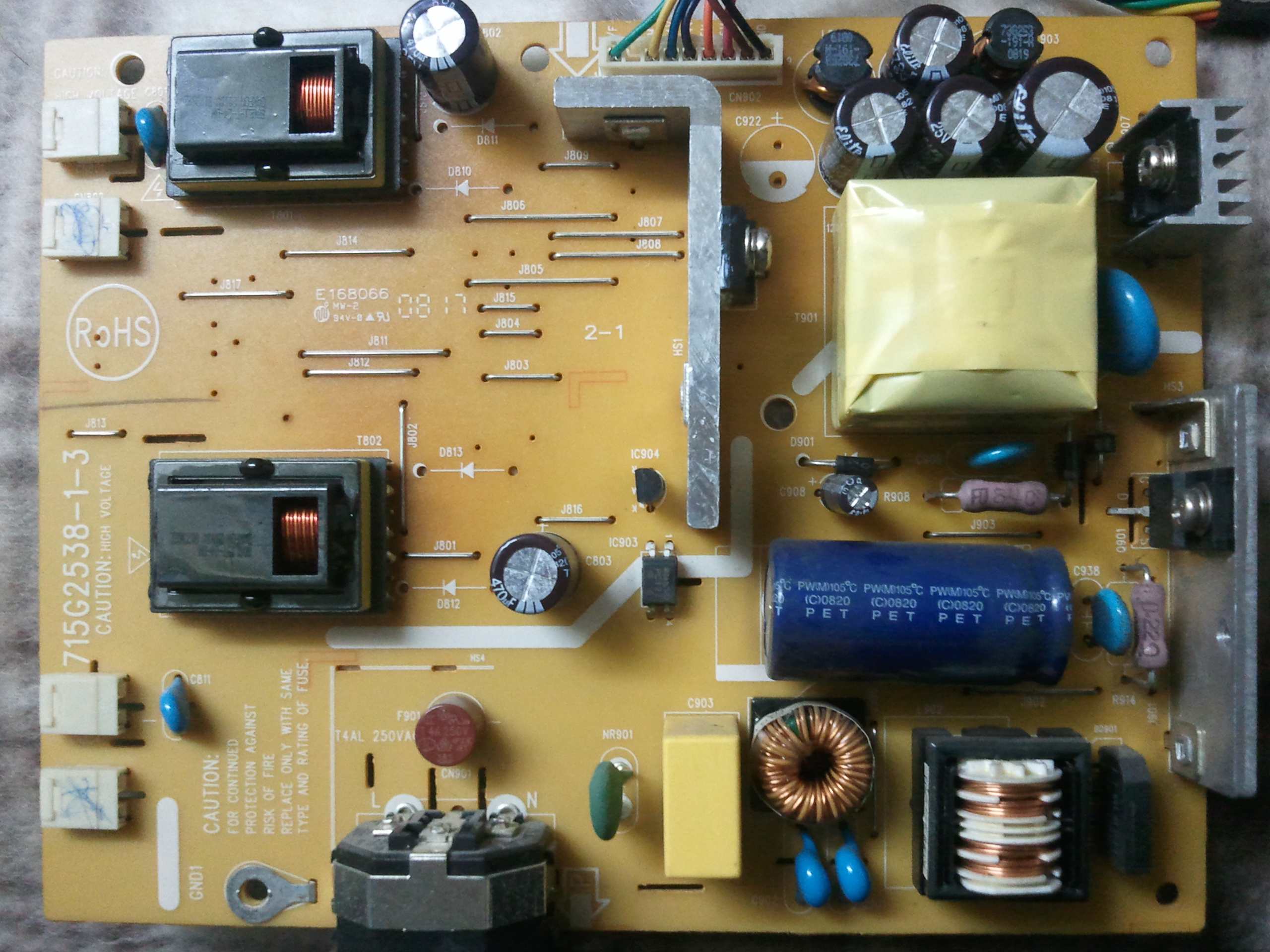

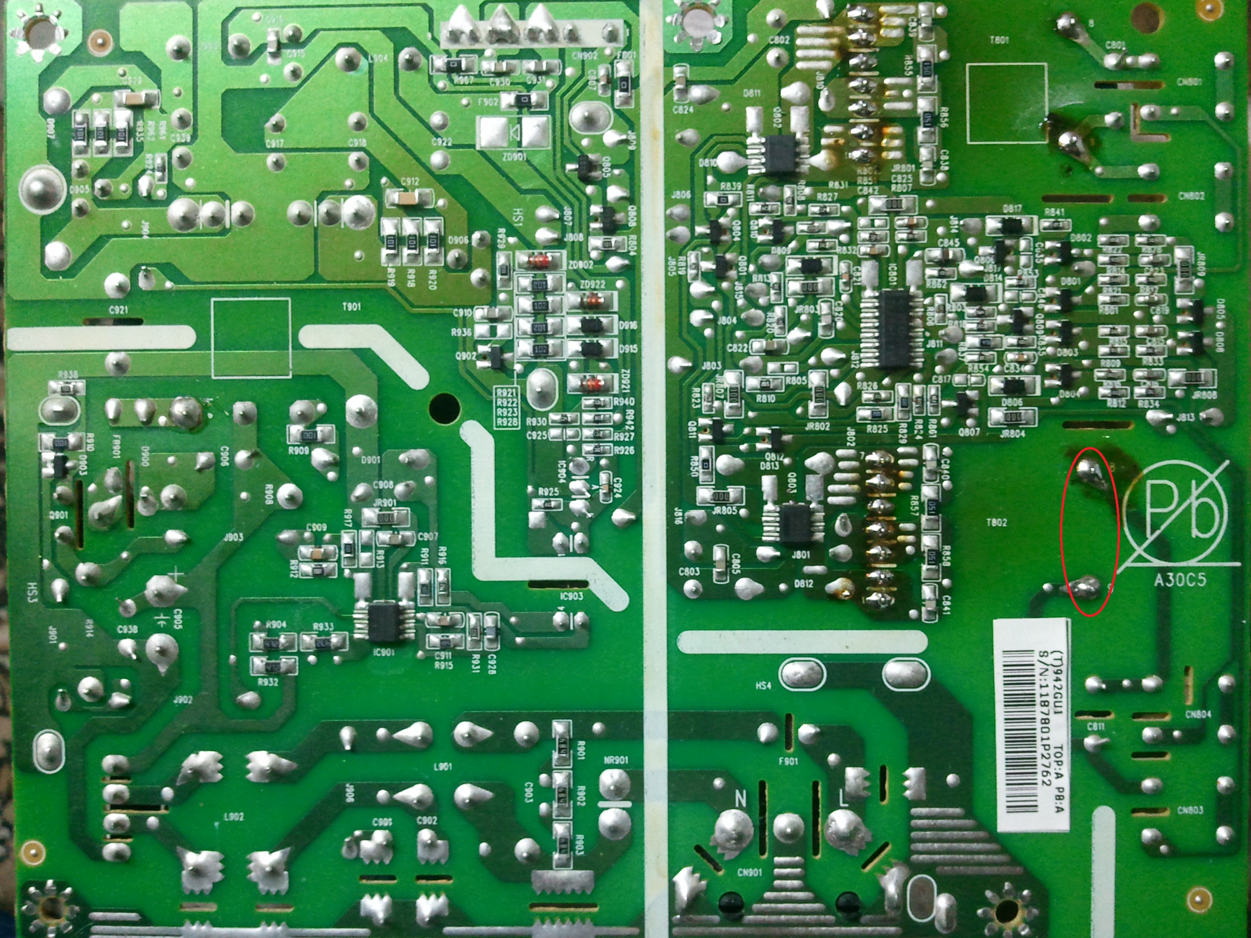

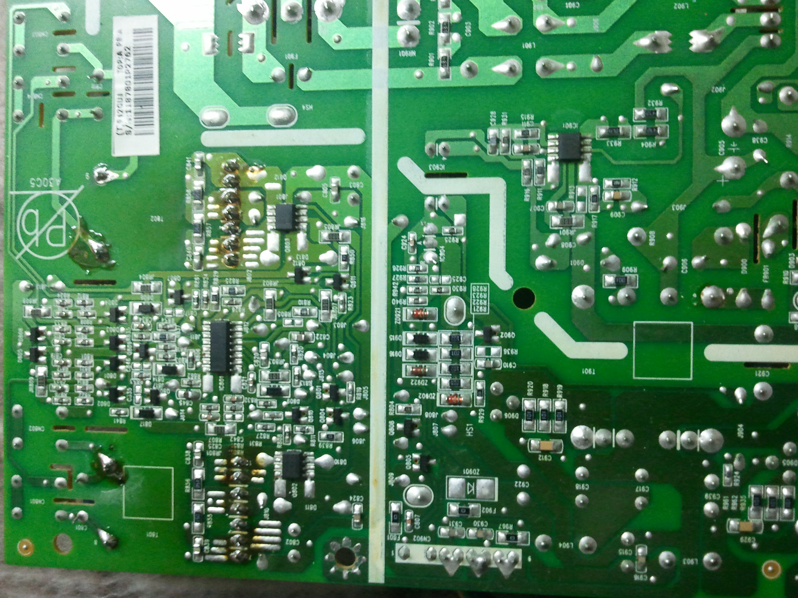

    Hello forum
    I have an asus monitor who turns off right after 1 sec, i went to see whats going on and i found nothing unusual on the caps. then i found out some "burning" at the soldering points of the inverters
    Pics below
    Help

    Re: Asus monitor turns on and off
    On the last 3 pics I just see excess flux. With alcohol and a toothbrush it will clean right off.
      • 31289
      there are a number of joints that need to be resoldered, and i dont mean the ones with flux on them.
      also the caps are crap (Elite brand!)
        The problem is most likely located at the CFFL tubes in the LCD panel. Maybe one of the wires is loose (it got desoldered from the cffl tube due to excess heat) or maybe one of the cffl tubes is too old and uses too much current (normal as they age, the use more power) and the power supply stops itself to prevent overheating.
        In order to inspect the cffl tubes, you'd have to be very careful opening up the lcd panel, it's made up of several layers of glass and plastic sheets and the lcd glass itself is very sensitive to pressure and can crack if you don't handle it properly.
          Yes i will do that for sure, but i think there is excess heat that caused that
            Can you point the ones you think to work on ?
                  Ive inspected the tubes and all looks ok ...
                  • Venomus28
                    • Oct 2016
                    • 38
                    • Albania
                    So I've tested the tubes in another monitor and they work good.
                    Then tried the same monitor with the tube wires not connected and the monitor turned off again.
                    So I think the problem is the power supply.
                    What should I check ?
                      Check the resistance of the transformer's coils.
                      You should remove them from the board.
                        Grazie
                        I've measured the 2 transformers of the inverter and one of them doesnt shows signs or life at the part pointed in red lol
                        I'll take it out of the board and power it up and check if the monitor goes off again
                          So I took out both transformers and powered up the monitor, same as before. Shut down itself.
                          What could be ?
                            Check Q803 Q802, the mosfet which feeds that transformer, compare the working side with the non working side.
                              and IC801
