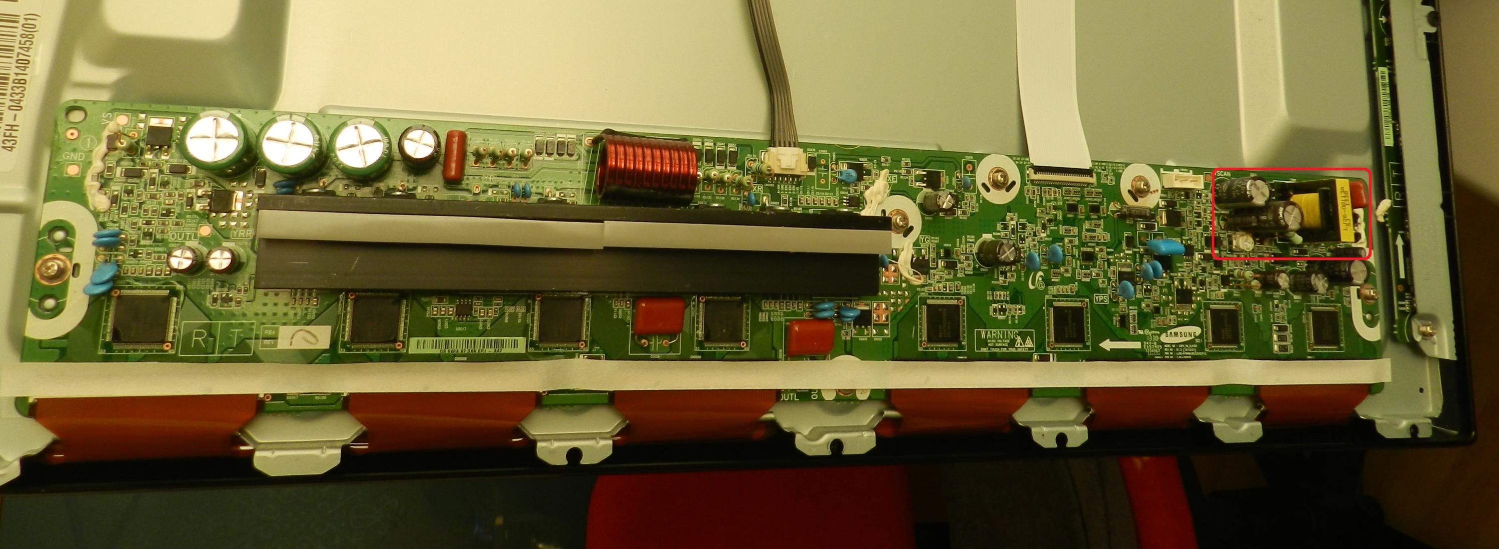

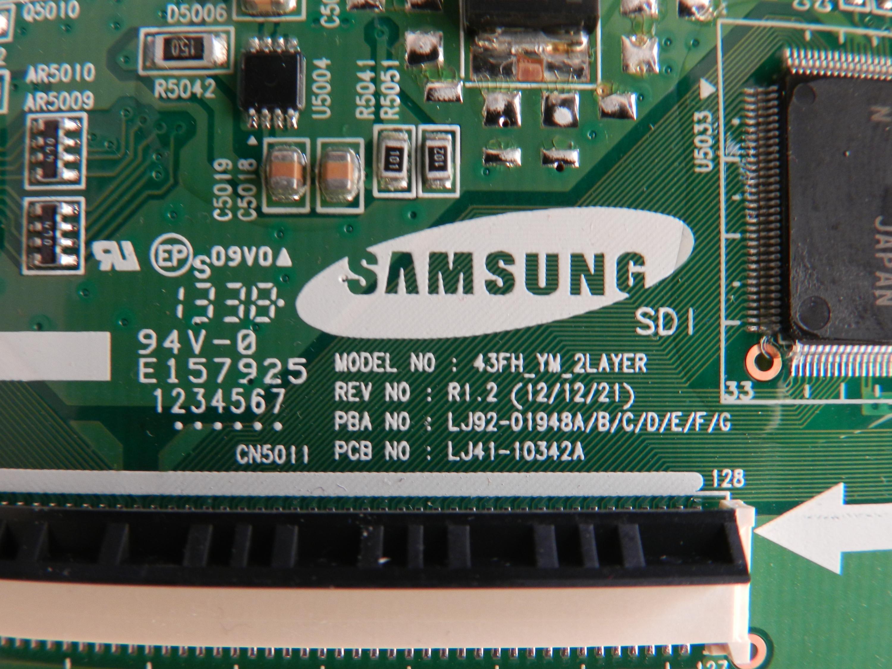

    I would very much appreciate your help in obtaining the service manual for this model.

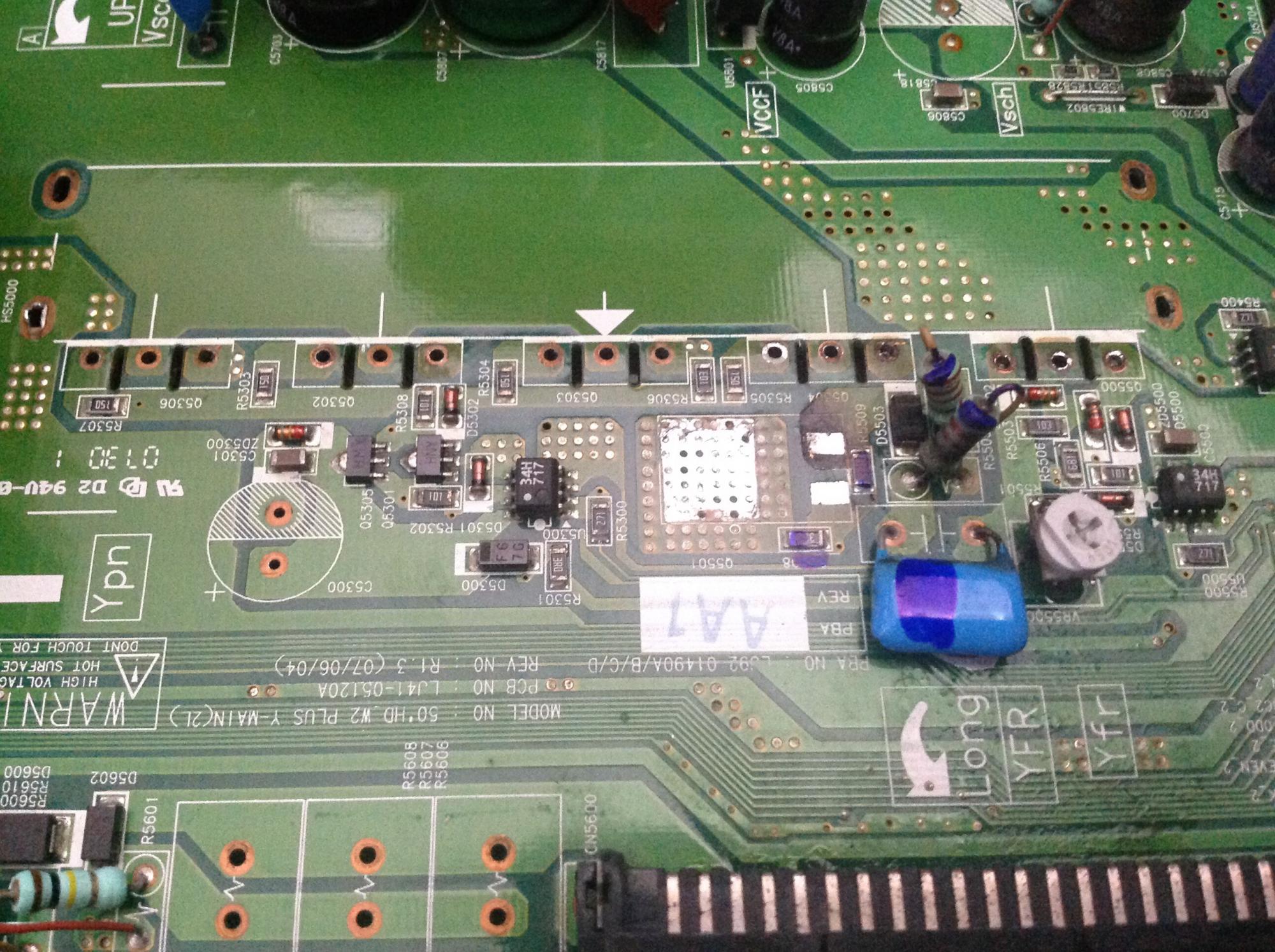

    There is a fault on the combined Y(Buffer/Main) board with a R5080 burning up and its solder pads overheating and starting to carbonise the circuit board. I cannot read the resistor's original value.
    Even if I replace R5080 the chances are that there is likely to be other problems causing it to overheat which will need to be found and so a diagram would be extremely useful.
    Vscan = 80 ohms to ground so suspect there is an issue here.
    Many thanks in advance.

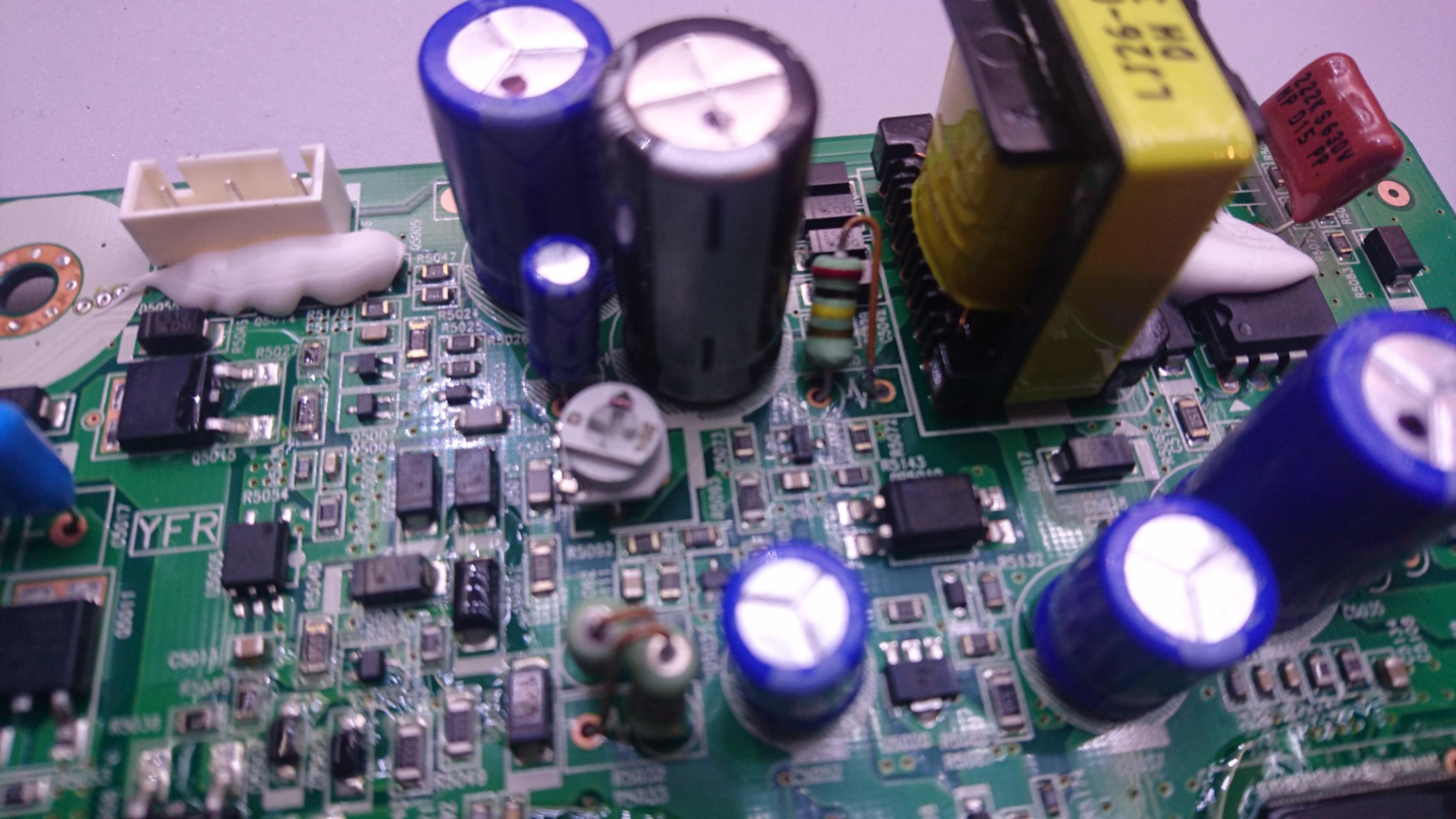

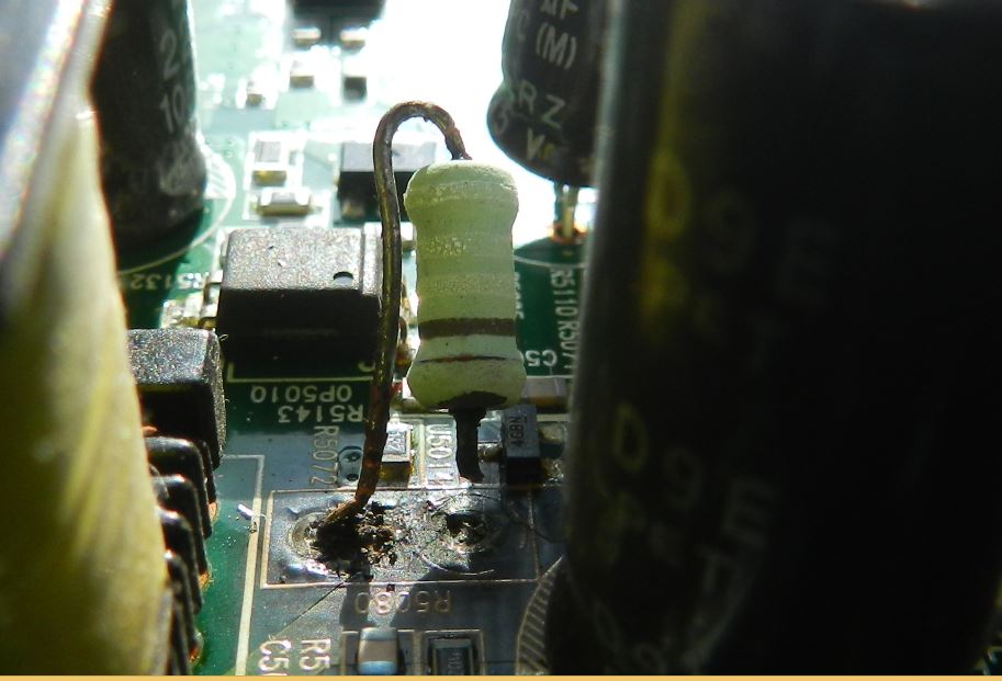

    Close up of the resistor bud ? Cant seem to find the Dia for this board.
    • dick_barton
      • Aug 2015
      • 6643
      • Wales
      Re: Samsung PS43F4500 - Identify Component
      Here it is, the heat has faded the colour banding.
        Does it go into the adjustment pot ? Cant find a thing for this board ?
        • dick_barton
          • Aug 2015
          • 6643
          • Wales
          Hello ReeceyBurger123,
          One end of the resistor connects to the ground plane and the other end to one pin of the transformer alongside.
            I've got one of these boards. Give me a minute.
            • Hamie
              • Apr 2014
              • 1383
              Red, black, yellow, gold.

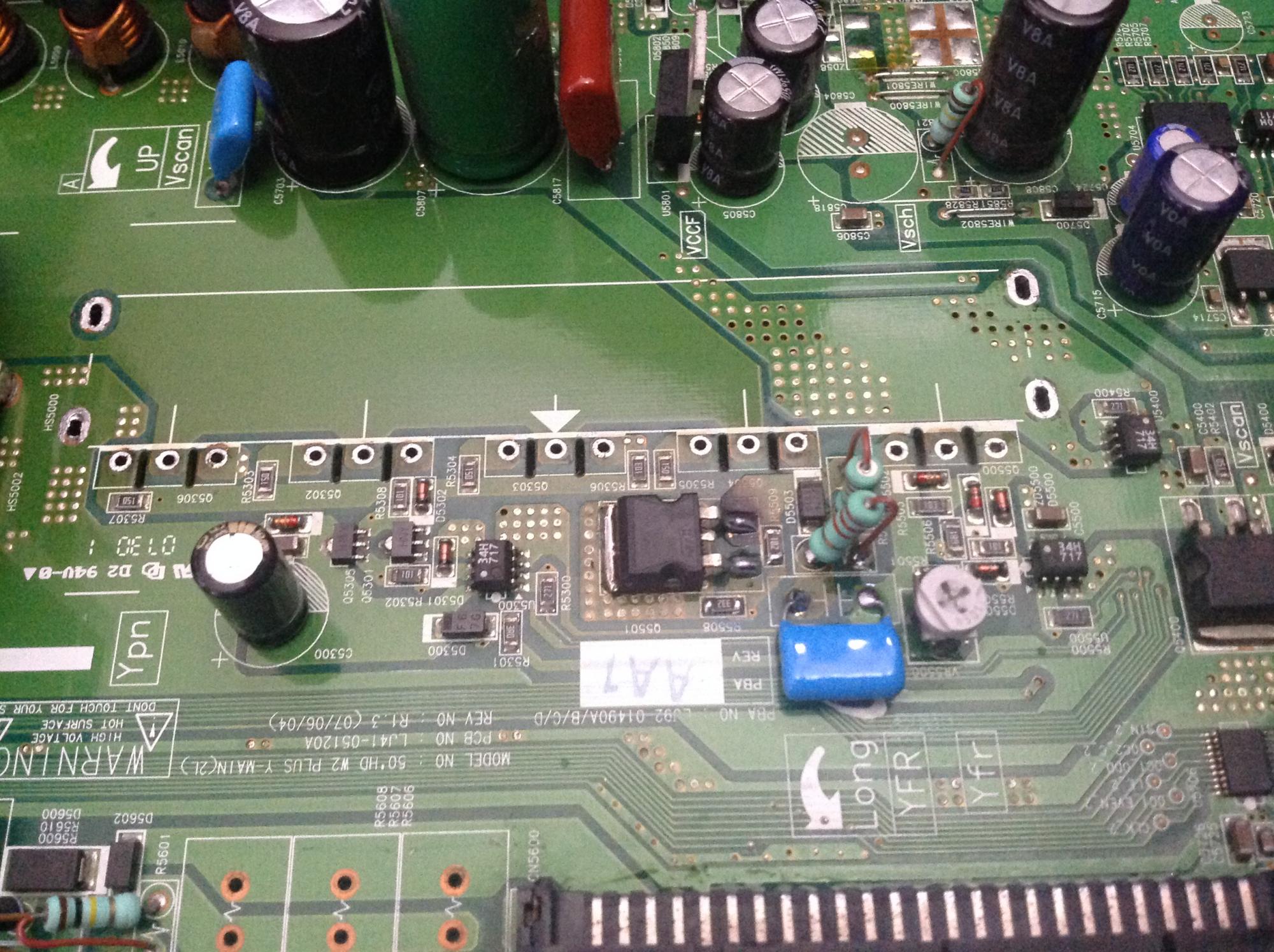

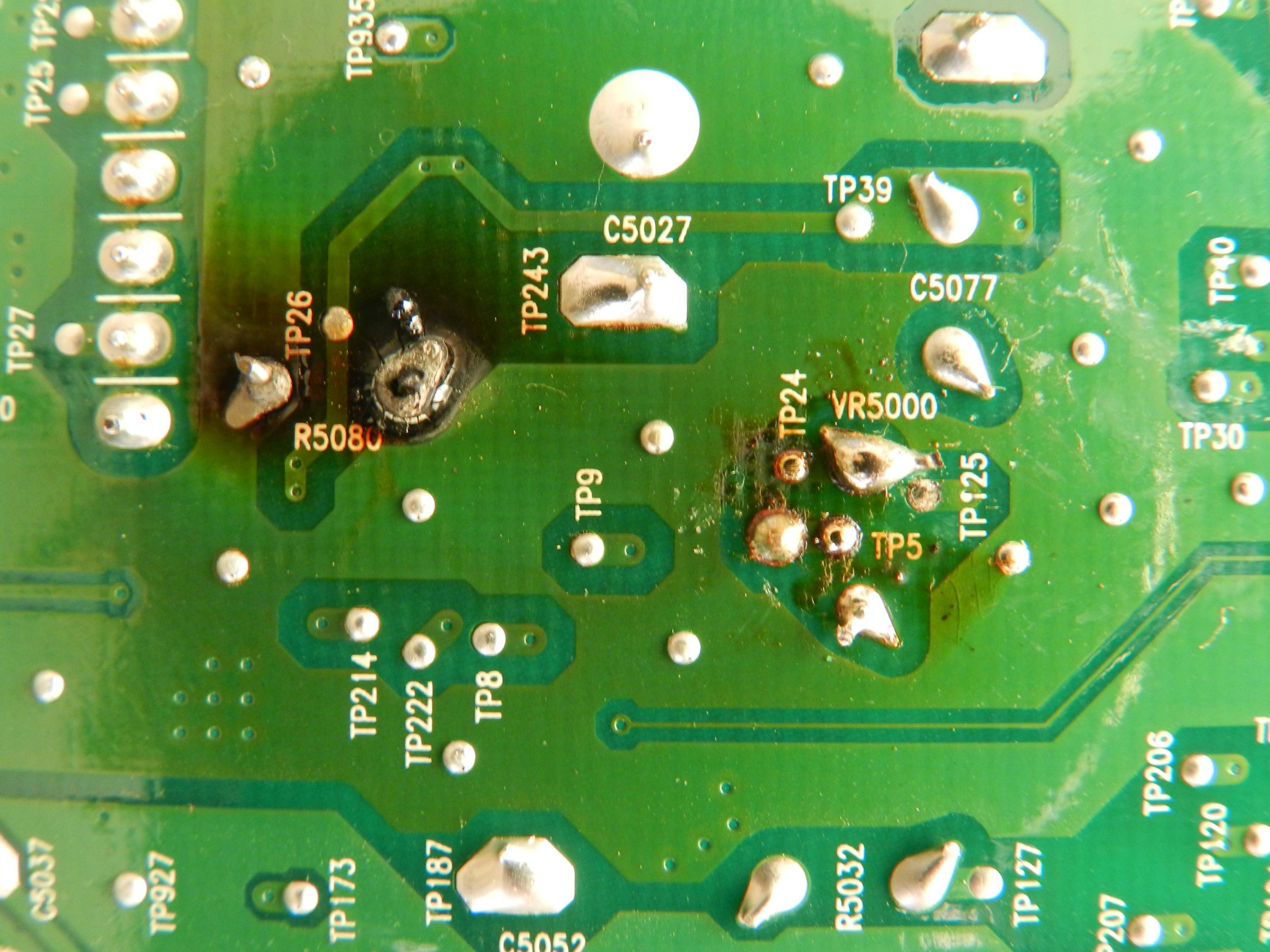

                              Just a quick suggestion. Looking at the ends of the resistor, one leg is becoming quite tarnished and it would be worth cleaning and soldering the top solder pads so it doesn't burn through as it has on my board.
                              • ReeceyBurger123
                                Never Give Up !
                                • May 2014
                                • 7325
                                • Britain
                                Yes solder the top pads, I had to do so on a burnt sammy sustain board as well,helps the solder flow through better. Will post image db.
                                • ReeceyBurger123
                                  Never Give Up !
                                  • May 2014
                                  • 7325
                                  • Britain
                                  Before soldering on a Q96 Ysus board I did ages ago:
                                    After, looks loads better good solder joint as well. Might be best to do Db:

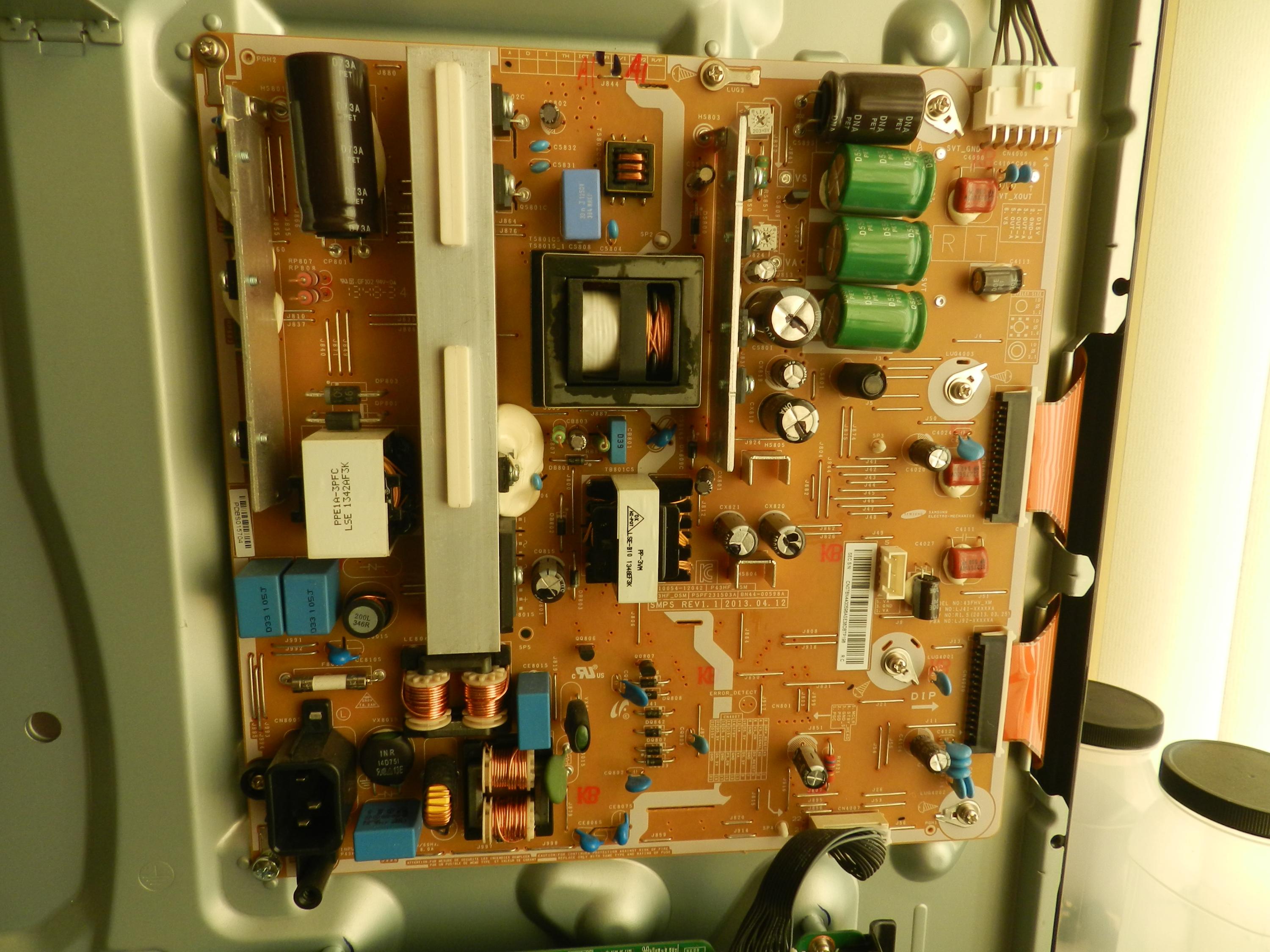

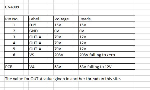

                                      Would anyone have the schematic for the power supply in this set which is BN44-00598A Rev 1.1
                                      I have the following voltages on CN4009.
                                      The OUT-A voltage of 79V was given in another thread on this site for this set, however it measures only 12V on this power supply.
                                      VA & VS both start at their correct values as given on the panel label and then drop towards 0V.
                                      Sound plays fine and set responds to remote control.
                                      • flocko
                                        • Nov 2012
                                        • 1121
                                        • uk
                                        Check across the three green caps for shorts and the four SMD Fets to the rear of board . If found to be shorted a new board could workout cheaper than repair ? pick them up for under £20
