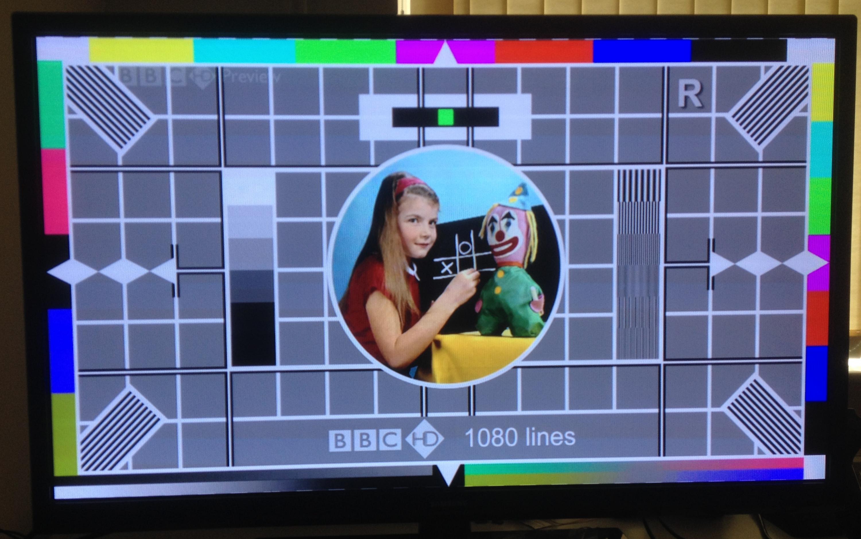

                              Replacement board arrived, slow delivery however checked out OK. Soldered the resistors so that the same problem should not occur with this board and all up and running.

                                Glad its all fixed.How is the back? better I hope. It always pays to fully test all S/H boards as most will come from sets with damaged screens.
