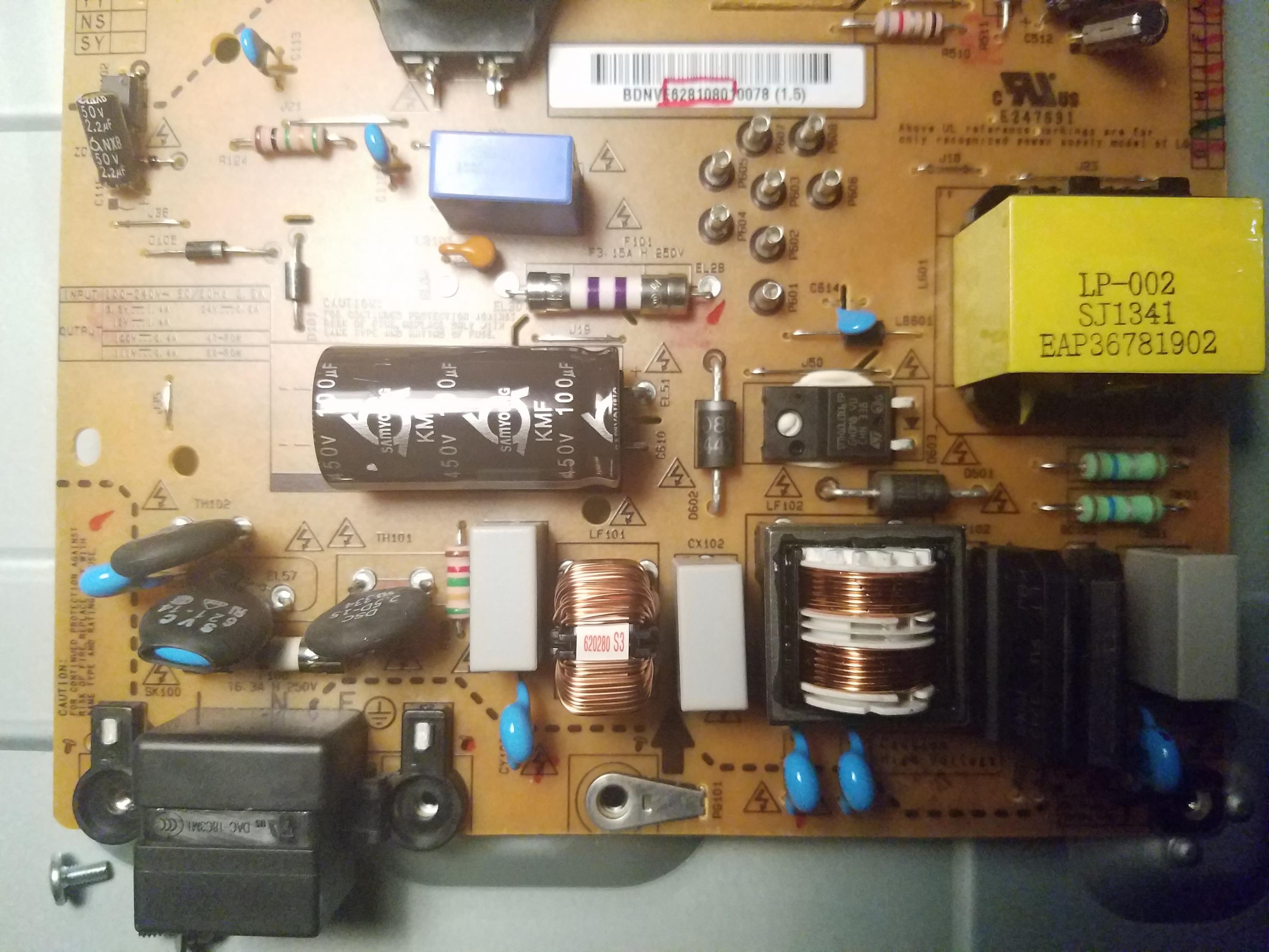

    What voltages do you have on connector P201 and led connector P801 and do you have a sharp photo of the power supply?

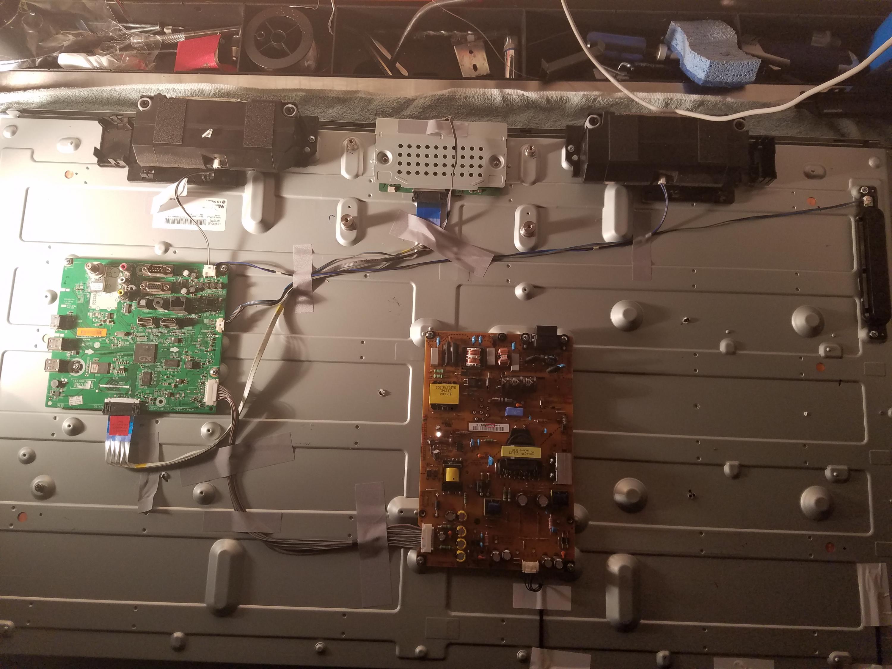

        We need good clear pictures of how all the boards are connected together and the details DCV readings of the power supply board connectors.
