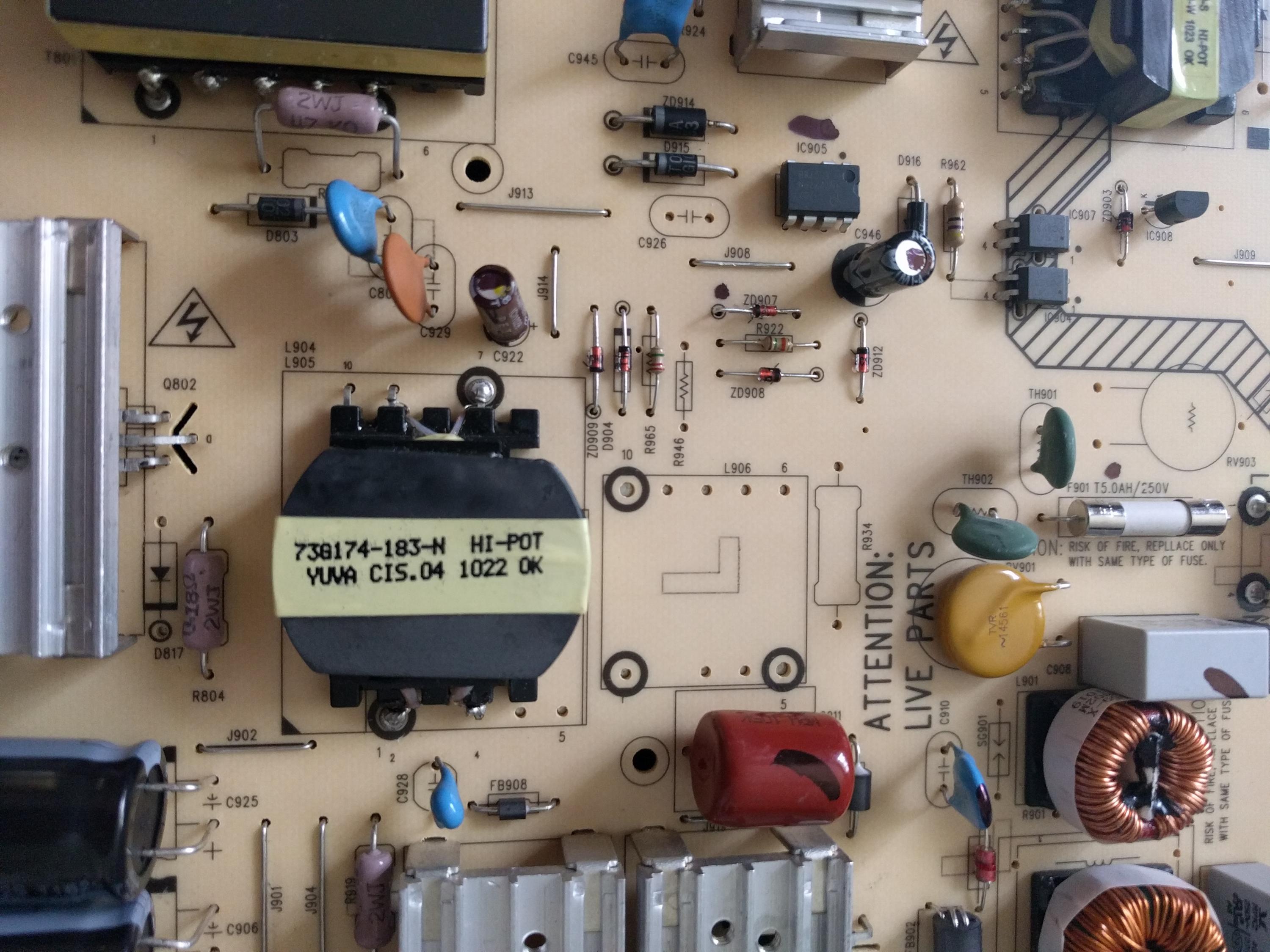

                    Re: Hannspree HSG1143 repair, no power, blown IC905
                    The whistling is coming from this thing, 738174-183N etc etc.
                    See the photo.
                      Update, TV working perfect now.
                      I put it all back together was just about to go buy a new one and said I'll leave it on while I was cleaning up all my testing gear. It was on for about 5 mins with the bad whistle, then there was a pop and the whistle stopped. TV 100% now
                        Not sure if that pop was a good thing, but whatever works
                          That is the inductor for the PFC, I wonder if the PFC boosted Voltage is still present after the 'POP'.
                                After replacement IC905 and ZD907 i had the same problem wisting sound. I found that D991 ( 2A05 ) leaky! I put MUR460 and sound disaperad.
