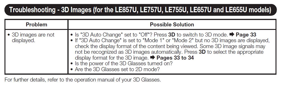

        There's this information

            Thanks. Do you know where I could find the repair manual for the Sharp Aquos LC-70LE757U? I did an internet search but could not find it. I tried the recommendations that were listed on the thumbnail with no success but I do appreciate the link so thanks.

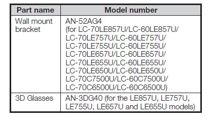

              I found this earlier.

                  Thanks for posting the manual but unfortunately that is the owner's manual that I have with the TV. I am hoping that somewhere there is a link to the technician's service and repair manual. I found that for other models of the TV but not the model of I have.

                        Are the glasses Bluetooth (Sharp AN-3DG40)?

                          I don't believe so. They are model AN-3DG20-B. No mention of Bluetooth on the box.
