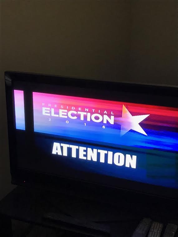

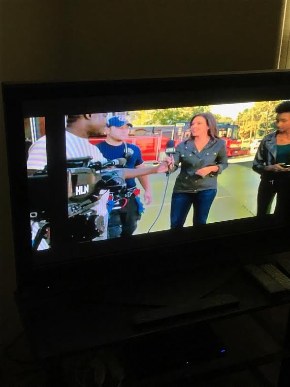

Panasonic TH-42PX75U thick black line down the left side
  • Gadjet
    • Aug 2012
    • 248
    Hey guys looking for advice on what you think this might be Board or Panel?

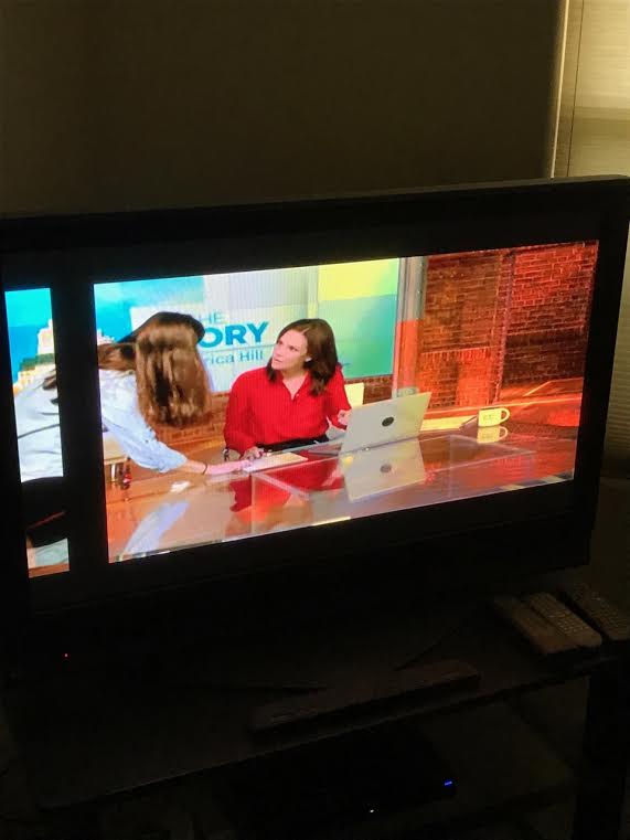

    Re: Panasonic TH-42PX75U thick black line down the left side
    Possible failure of supply to that COF chip responsible for that section of screen (check the series resistors)--Or the chip itself,-- Which is bonded to the FPC and the panel glass ...
      So if it's the resistors it can be fixed, and if it's the chip it can't?
