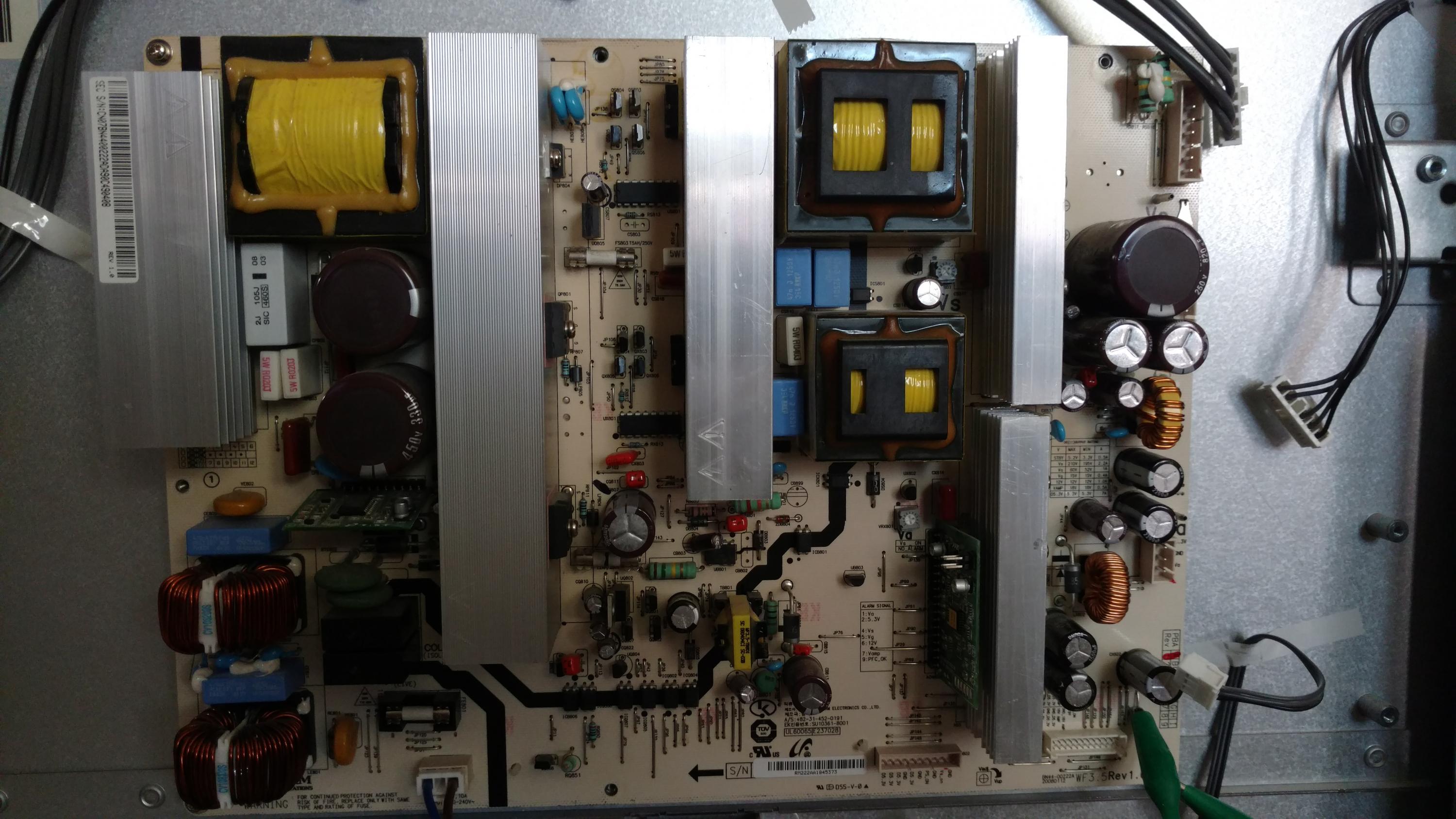

    TV would not power up, had only standby voltage. Found transistor QX807 was shorted (STS2N5H3LL):
    http://www.mouser.com/ProductDetail/...G%2FV3BQ%3D%3D
    Part was discontinued, I ordered (SI7892BDP-T1-E3)
    http://www.mouser.com/Search/Product...I7892BDP-T1-E3
    I tried matching up specs, but can someone more knowledgeable tell me if this is a suitable replacement??

        Pin out matches..
        Here's where I'm at, with X and Y Mains discod, when PS is plugged into A/C power I have only 5V standby. If I ground PS-ON (high when off, low when on), the relays will click but no other voltages come up.
        Also if I apply 5.3V with my bench power supply to VS-ON, nothing changes except the 5.3V line comes up slightly to about 1.4V.
        I found a schematic on Tom66's site for a substitute for this power board.
        Anyone able to help me find where the problem is?? I have found no other obvious shorts on the big transistors..

          Re: PN50A510P3FXZA Power Supply BN44--00222A
          Disconnect all the plugs apart from mains in.With the mains on you should see the LED on the the alarm board come on, this shows you have 5v stby. Jump PSon to ground, do this by shorting JP154 (end jumper to the right of CN801 socket) to ground, you must leave this grounded ,this should bring in relays and low voltages to board,if the relay clicks in then out you can read the blink code on the alarm board,this gives you were the problem can be found,if you have the low voltages you can now with a 470-1k resistor short STby to VSon this will bring up the high VS voltage. there are no schematics for this board. please post your findings
          • kevinm34232
            • May 2012
            • 1884
            I did this process, see above. When ground PS-ON, the relays click on but no other voltages come up..
            The green LED lights up before and after PS-ON is grounded, but never blinks.
            I believe the schematics above are for substitute board BN44-00237A and are similar or same..
            I replaced QX807 with what I believe is a suitable replacement (see above) because it appeared to have G-S short. Before I did this, it would cycle PS on and off.

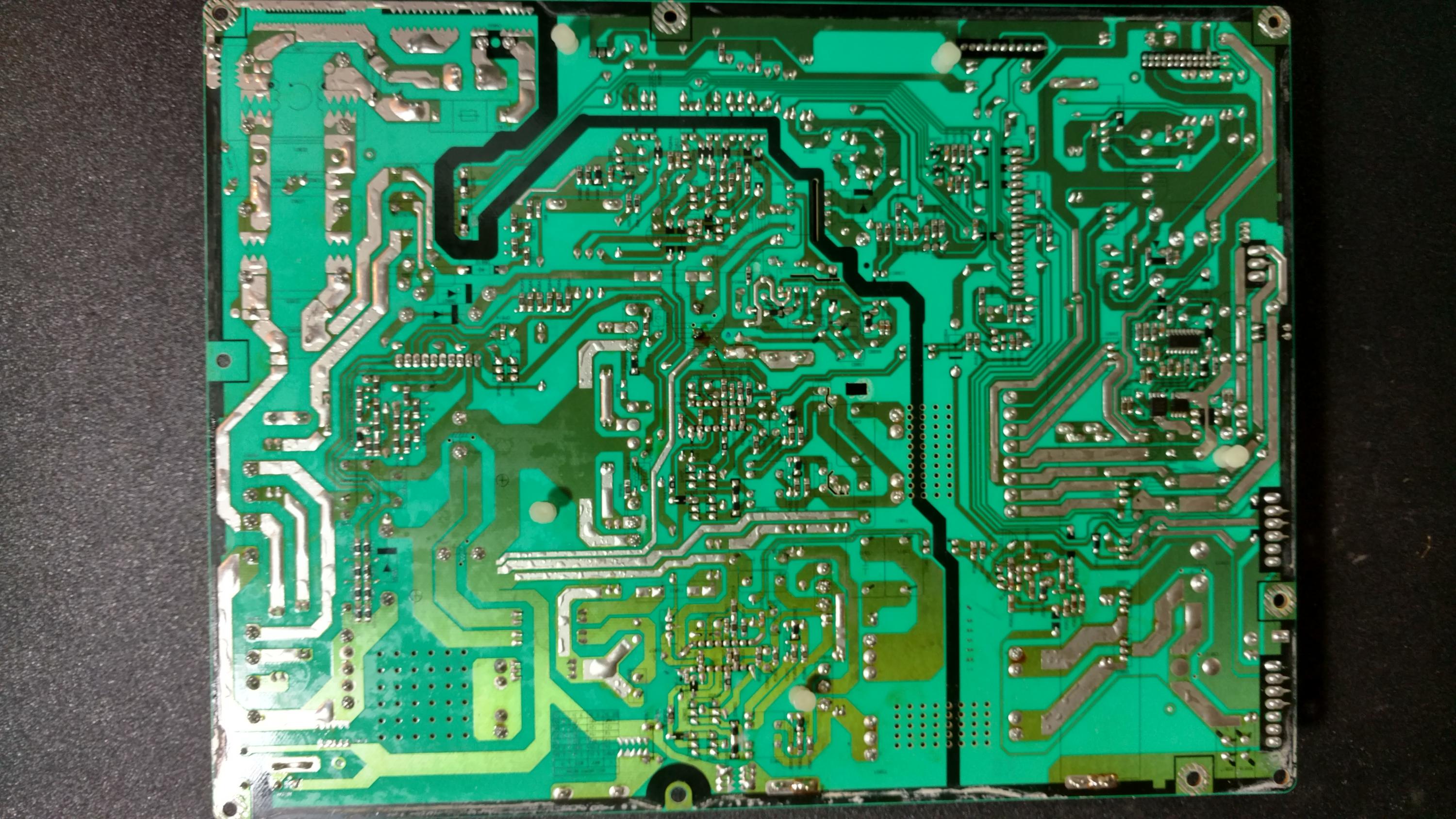

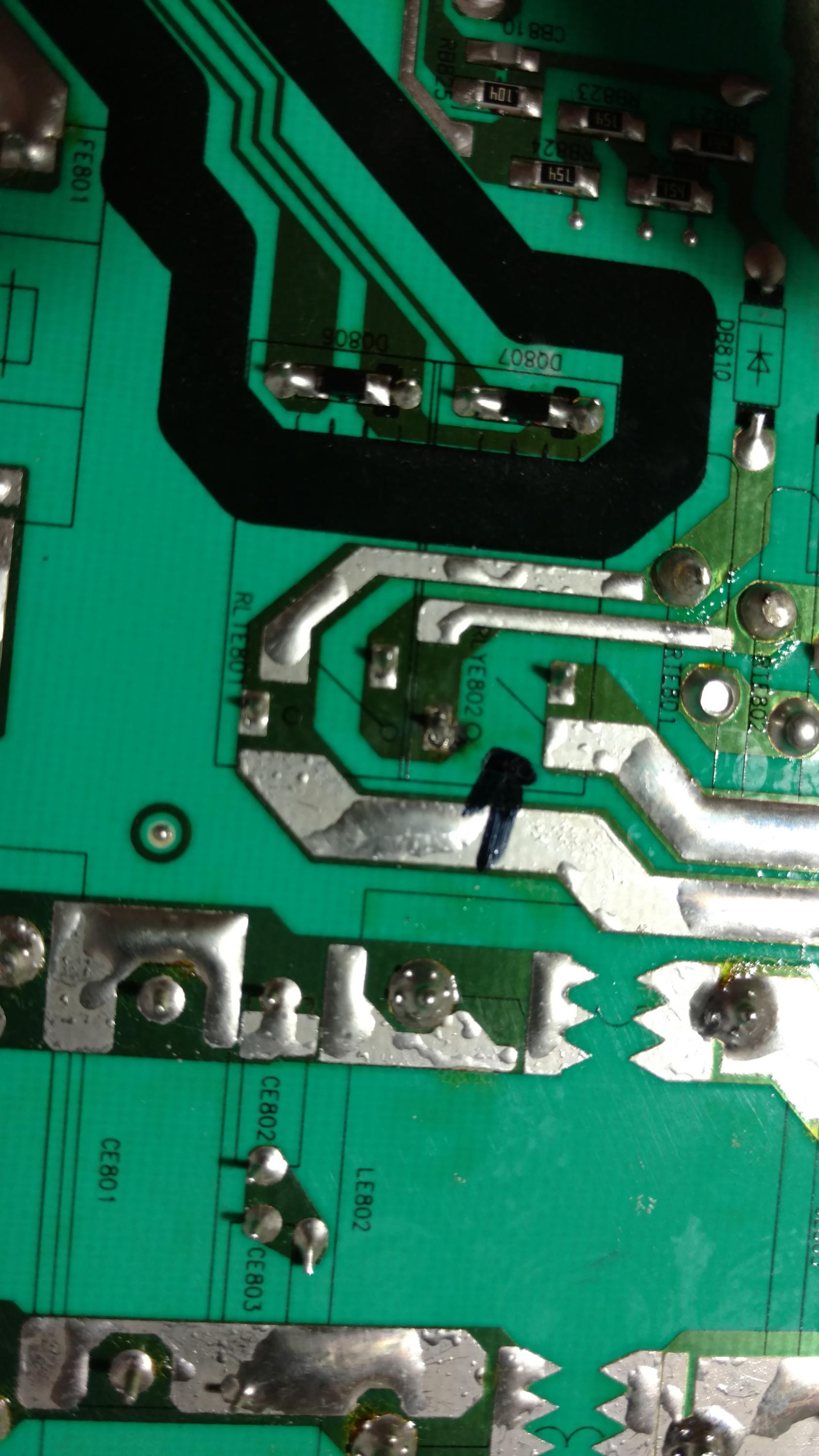

                        start from the 450v caps and work back to the two bridge rectifiers or the other way but also check the soldering and components( resistors/ diodes) as you go. Be safe use your meter set to continuity and no power the board till you find the problem would be my advice
                        I have taken a better look at the photo of the backside of your board and QS801 looks to be problem(burnt) and CB807 also does not look good (but as the STby is working could just be poor soldering)
                        • kevinm34232
                          • May 2012
                          • 1884
                          QS801 is large transistor on top, what are you looking at exactly on the bottom please?
                          • flocko
                            • Nov 2012
                            • 1121
                            • uk
                            what looks to be a big black burn mark on the center leg and the lack of solder on it.
                            • kevinm34232
                              • May 2012
                              • 1884
                              Wow you're good.. QS801 was OK but found several cracked solder joints especially the one on the relay..
