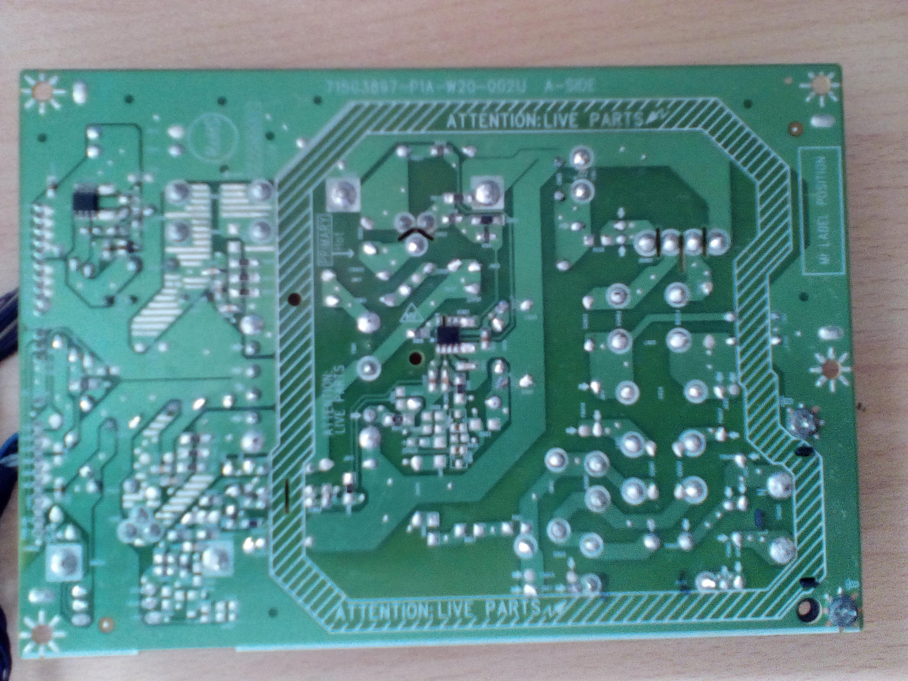

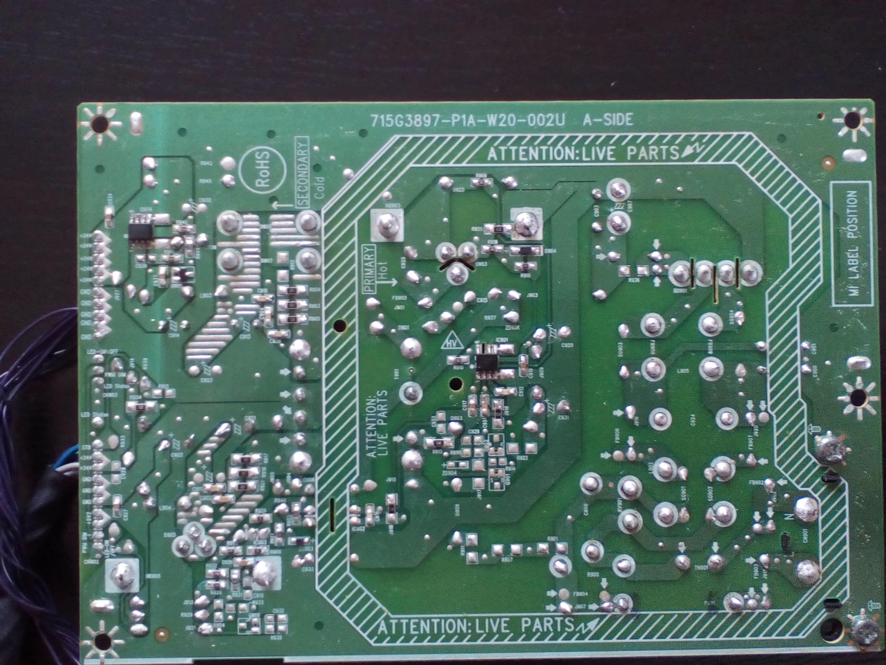

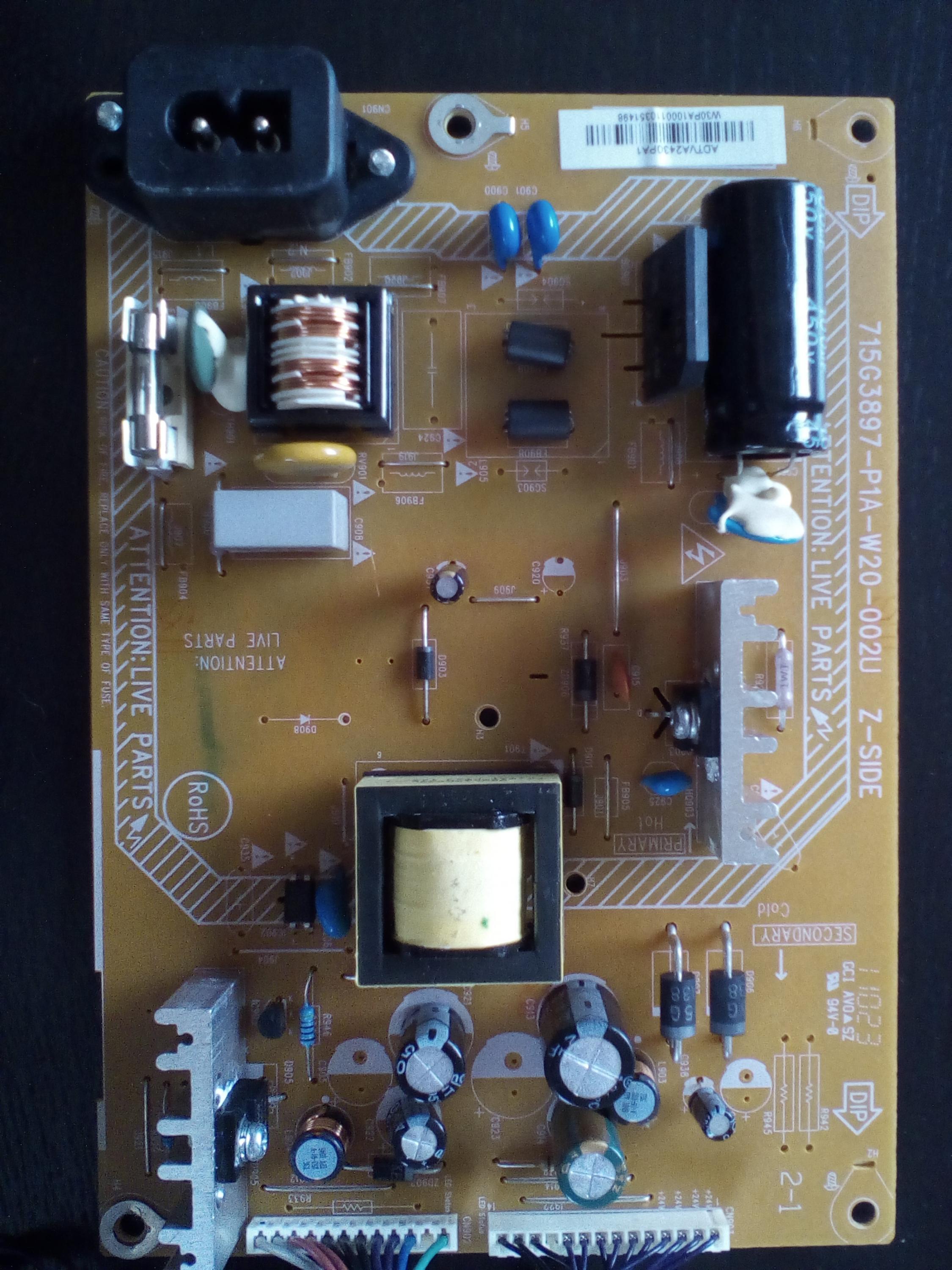

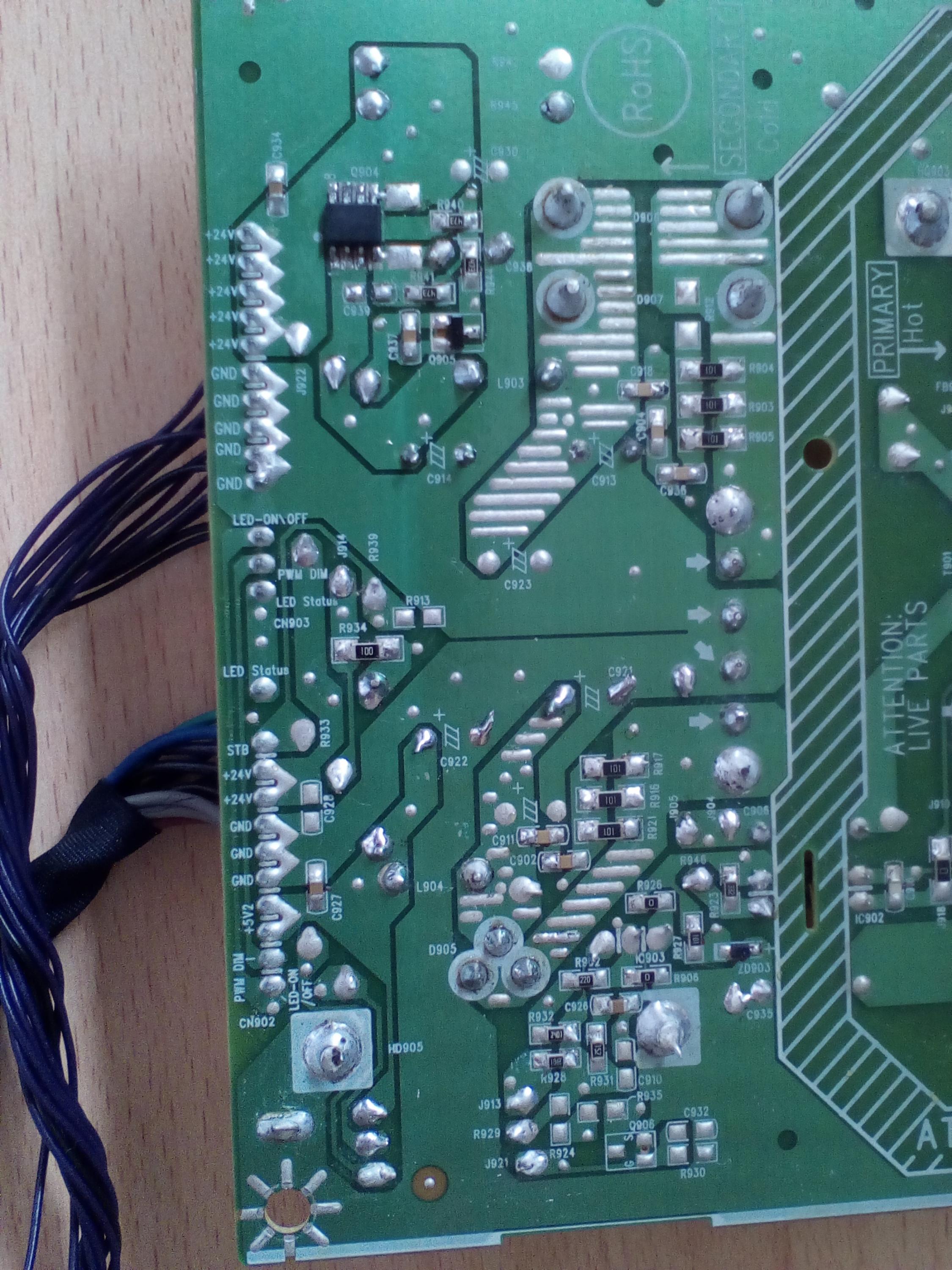

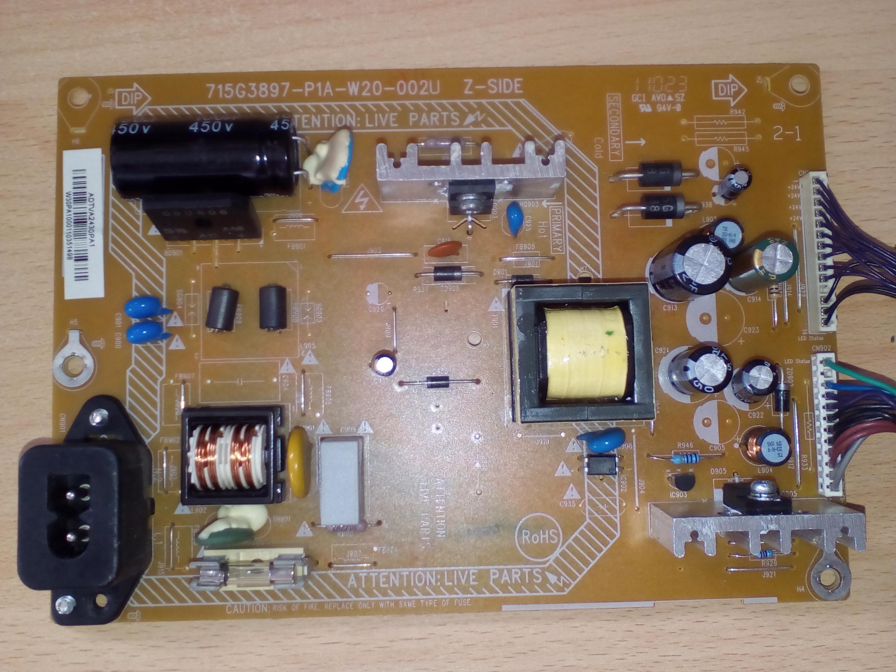

          OK then...Can we get clear pictures of the underside on the main Board??
          • nashagui
            • Jan 2015
            • 19
            • Spain
            Re: PHILIPS 19PFL3405H/12 - How to test Power board 715G3897 ???
            I attach pics agains. thanks.

              Hmmm....I think you posted these already.....This is the Power Board not the Main Board
                https://www.badcaps.net/forum/attach...6&d=1476718068
                STB pin is the PS-ON pin, when it is high (<1V = OFF if it is active high logic) it turns on Q905 which then it turns on the switched Power MOSFET Q904 to supply the switched 24VDC to connector pins.
                Notes: sometimes Philips uses active low logic, LOW = ON.
